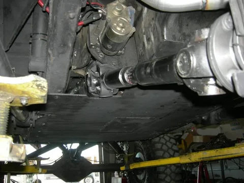

Beautiful build! But I thought for sure someone else would comment on the drive shaft being mounted to the bell housing. Won't that add vibration and angle changes when the engine flexes as the RPM's go up? I know I would worry...
I would be interested to see what effects it would have as well. It seems to me that in most cases, your drive lines see those sort of movements being mounted directly to the t.c. Since the hole drive train should be mounted to allow for flex caused by tourqe. But I really couldn't say if it would increase any of these effects on the driveline.

I must have been sleping when I wrote that. I was reading your response and was thinking "like duh". Of course the drive line flexes at the t-case. I don't know what I was thinking. I guess if everything clears OK... I wonder if this might help with straight line angles. I mean if the drive line is actually straighter than if it were attached to the frame...
Hmm, I'll be very curious to see how it works out.

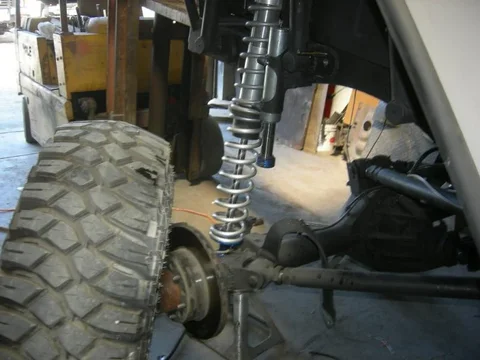

I am not sure if this is my final spring rates but here they are:
front 200 over 300
rear 175 over 200
I think the numbers are right
which it's your new spring rate .. or of those new coils that you choose ?
I will start by saying that I am no expert in any of this fabrication business and often times I dont have a second opinion and end up going down the wrong fabrication road. I was originaly going to mount the carrier bearing on the frame but the bellhousing puts the the driveline in the best angle. I believe the rotational force of the drive train should not interfere with the driveline flex. I am going to run it and see what happens.

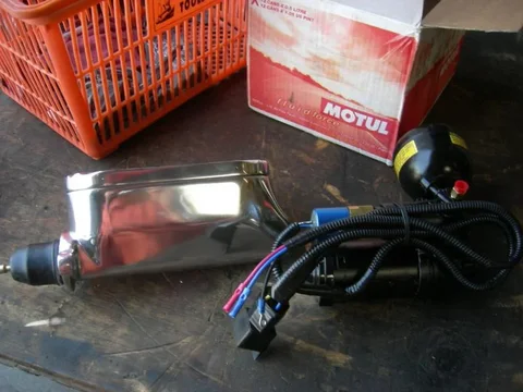

When I had the master cylinder rebuilt they wanted to update it so they kept the old one and gave me the new one..
installed
once I built up pressure and was loading the rig on the trailer I had brake failure.

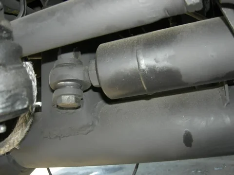

The one line I did not replace during this build
scarfing on something in the frame rail
new line

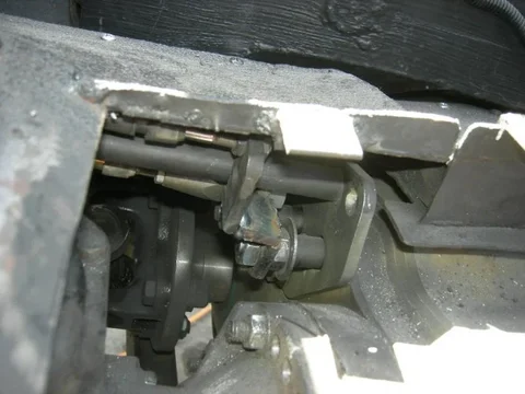

once I got the rig moving I couldnt get the tcase to cycle thru all 3 speeds
Realized the cable shifters did not have enough travel due to the mounting points
had to make new mounting brackets at the tcase and due some adjustment at the shifters
