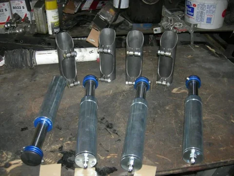

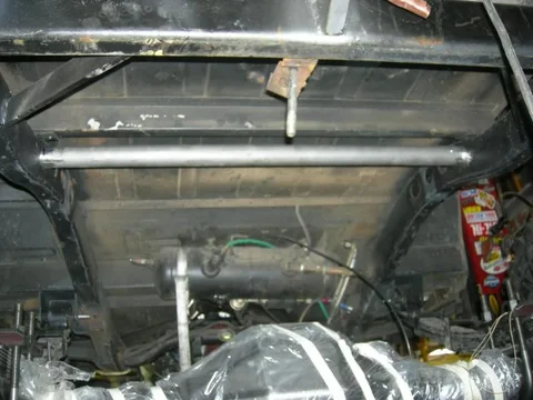

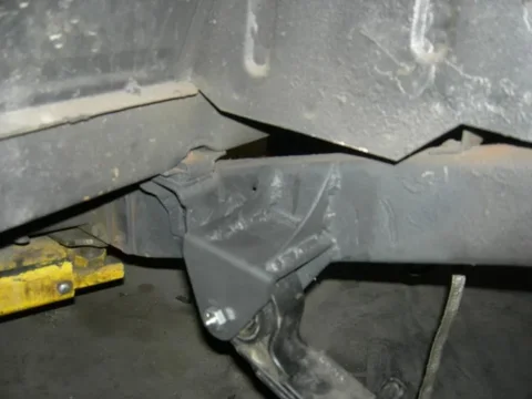

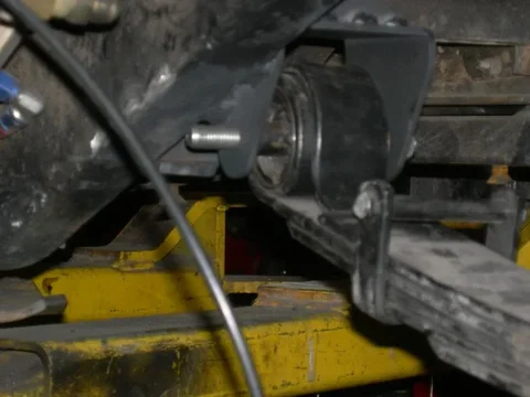

skipped welded hangers..
more pics
I am much happier that I cut off the old brackets/hangers and raised them on the frame

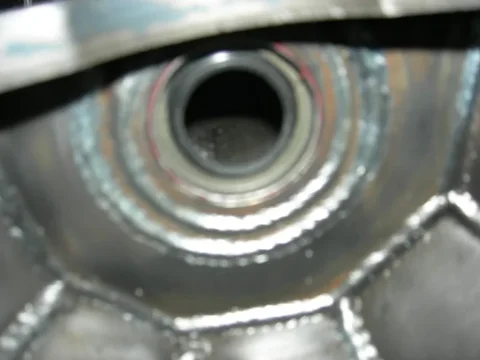

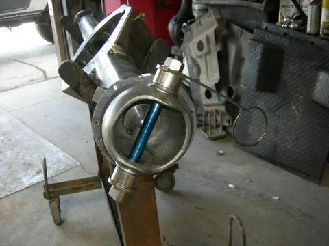

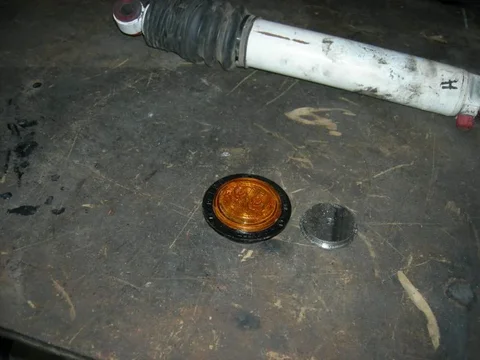

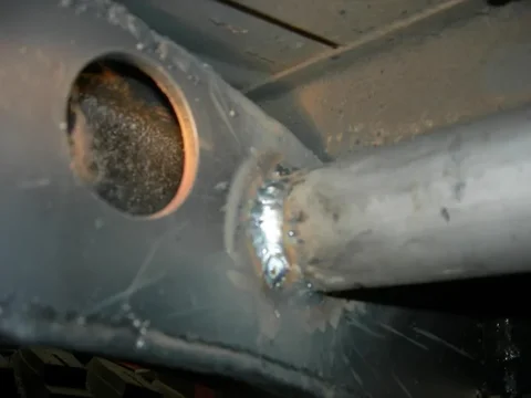

decided to mount the new LED lights in the bottom of the bib. Problem, the hole in the bib is 1/4 inch smaller then the LED light. I used a old 2" cut out.
welded the cut out in the whole
hole saw

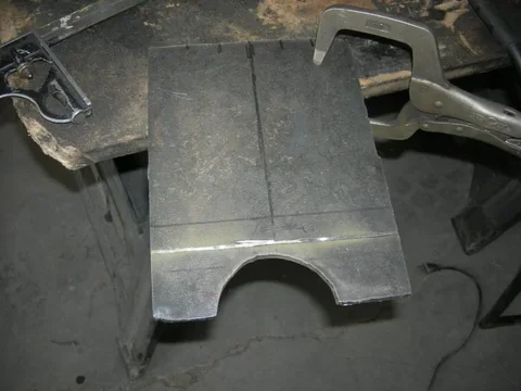

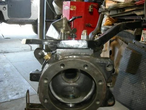

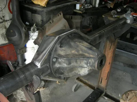

decided to make some 3rd member protection
Cut a hole in the plate to fit the radius of the pinion. slightly offset

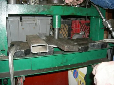

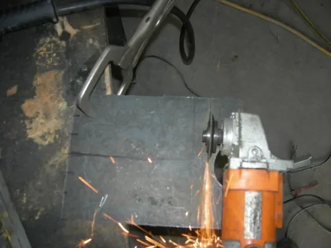

I don't have a break, so I use a grinder and vice to make bends.
