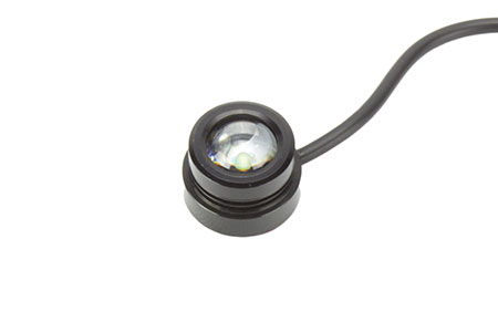

RuffStuff has these little guys for $25 ea.

I bought these: Amazon.com: RGB LED Rock Light with Bluetooth RGB Controller - Neon Lights Replacement Multicolor Super Bright CREE PODs - Under Vehicle Cars Interior and Exterior - Waterproof Shockproof (MULTICOLOR): Automotive. Well, basically. I can't find the specific ones I bought now, but no bluetooth control, and mine are white. Still waterproof, shockproof, rustproof, etc...

OK, got 'em today. Got all excited about installing them, then decided, I'd better check them out first.
Because Chinese.
Glad I did. Two of the eight connections on the distribution block didn't work right from the get-go. And there is no way that thing is weatherproof.
