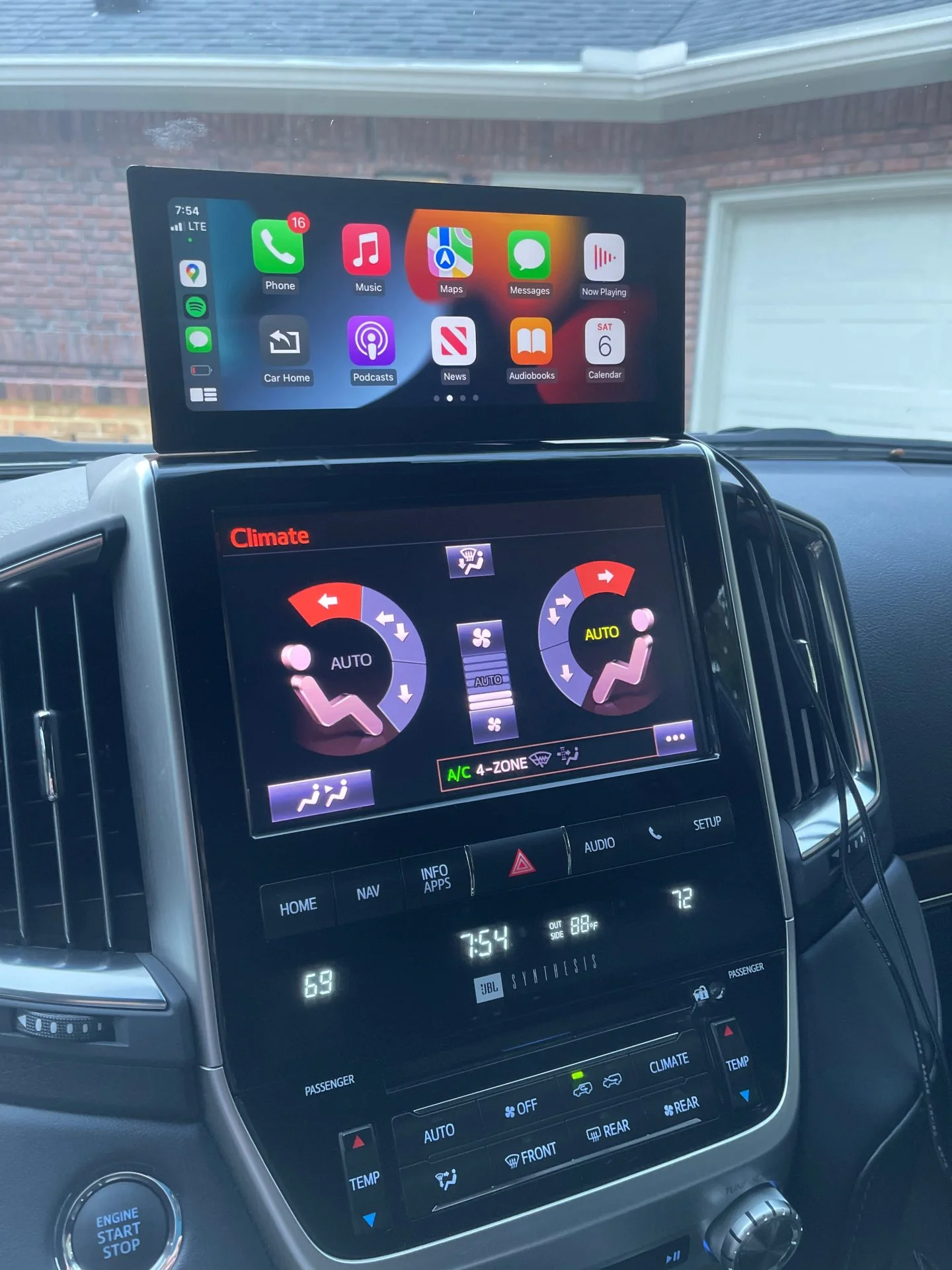

No doubt that a fully integrated OEM looking thing is the best. But for $300 this was a great second option.
I used to have my iPad over the screen, really nice setup but I needed to flip the iPad every time to back up and every once in a while the magnetic charger would need to be changed out. Also, I paid $10 a month for iPad service. Lastly the phone calls were always sketchy when using The iPad to communicate. Lastly on sunny days, the iPad would overheat or just dim to the point I couldn’t see. For all these reasons I was exploring the option to install beatsonic’s CarPlay solution, but I was staring at about $1,000 installed. Then I saw the Road Top unit a few months ago and started thinking about it…
Pros:
- price ($300)
- wide screen/low profile (10 icons) - which is better than OEM setup, 8 icons
- comes with tons of accessories including backup camera - I did not use but I am open to ideas of how to take advantage of extra camera
- connect to car stereo via Bluetooth/aux/FM, of course I used Bluetooth, there is a second bluetooth for the phone handshake
- wireless CarPlay ( more reliable than the one in my ‘22 Ford Edge)
- all OEM media controls work
- uses vehicle microphone for Calls
- boot logo is customizable to vehicle mfg
- airplay mirroring/android screen mirroring
- when using Apple Maps, you can search by typing - not forced to use Siri
- settings in device allow for Equalizer adjustments
Cons:
- you have to conceal the wire for maximum OEM look (con vs a CarPlay retrofit module, not vs iPad setup since I had a cable for that)
- you loose access to Toyota Entune apps (I never used)
- OEM phone answer and hang up button don't work - just use the CarPlay Screen
- no auto-brightness - Road top did mention to me that their next version will include
- display settings adjustment screen does not include an image so it takes some menu flipping to get contrast and saturation right
I like the look quite frankly, it looks like many of the new cars nowadays including LX600 which has dual screens with an overlayed widescreen on the dash. I did buy a separate mount on Amazon for allow a little for downward angle which let me rest the screen further down...

I finally found happiness with connecting the phone to both the 200 and the RT and not connecting the RT to the 200. This gives me full OEM capabilities plus CarPlay on RT.
You will hear some Siri commands on RT and map routing but it works just fine because the music pauses when these things occur. Lastly some time if music playback is initiated in RT sound will be routed to the RT speaker but a quick pause and play on the 200’s pause/play button gets it back on track…

I used double side gorilla tape to mount the disc for the suction cup onto the speaker grill
