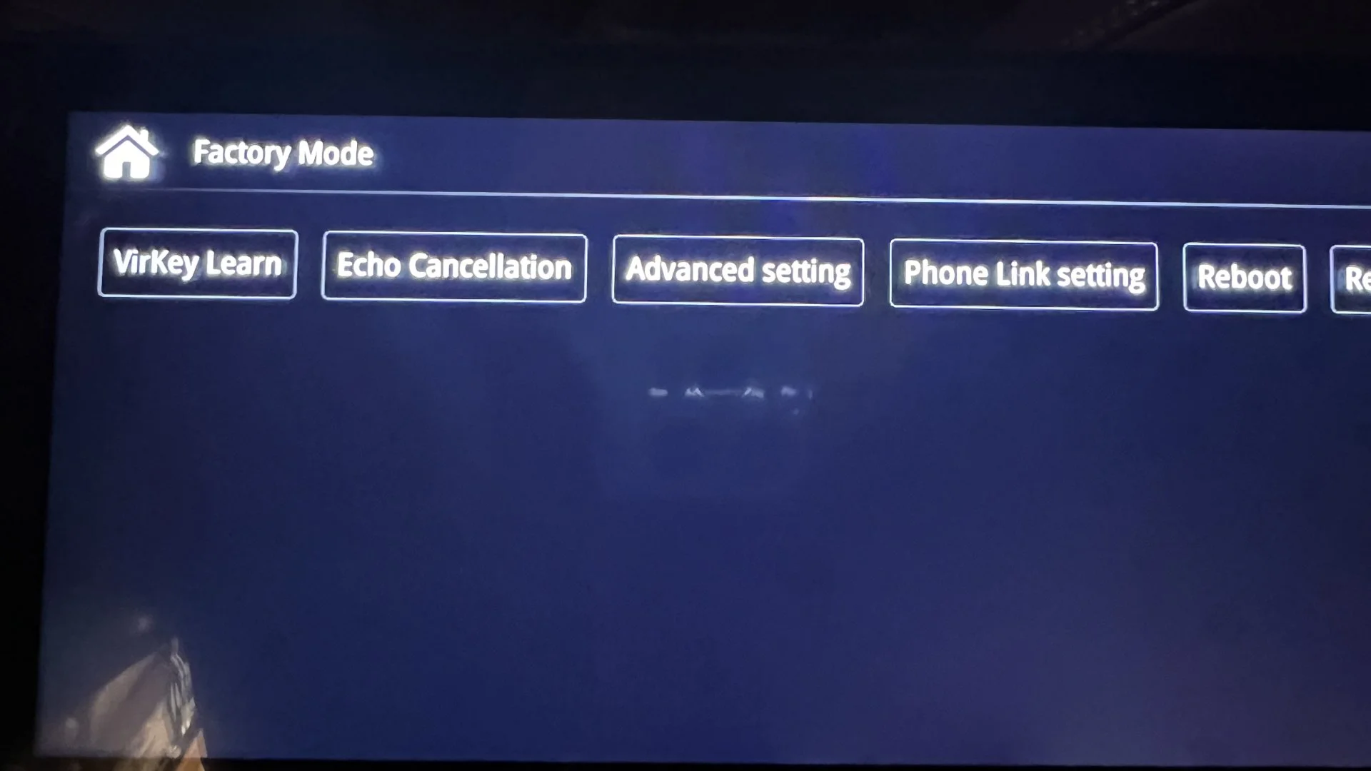

I have a gen 1 and there is an echo cancelation Gen 2 does not have it
However to my earlier point this would not be an issue if the unit was switching the phone call through the Bluetooth “phone” profile because your mic would be the land cruiser’s not the display’s…

Interesting. Seems like the factory menu has more settings you can mess around with.

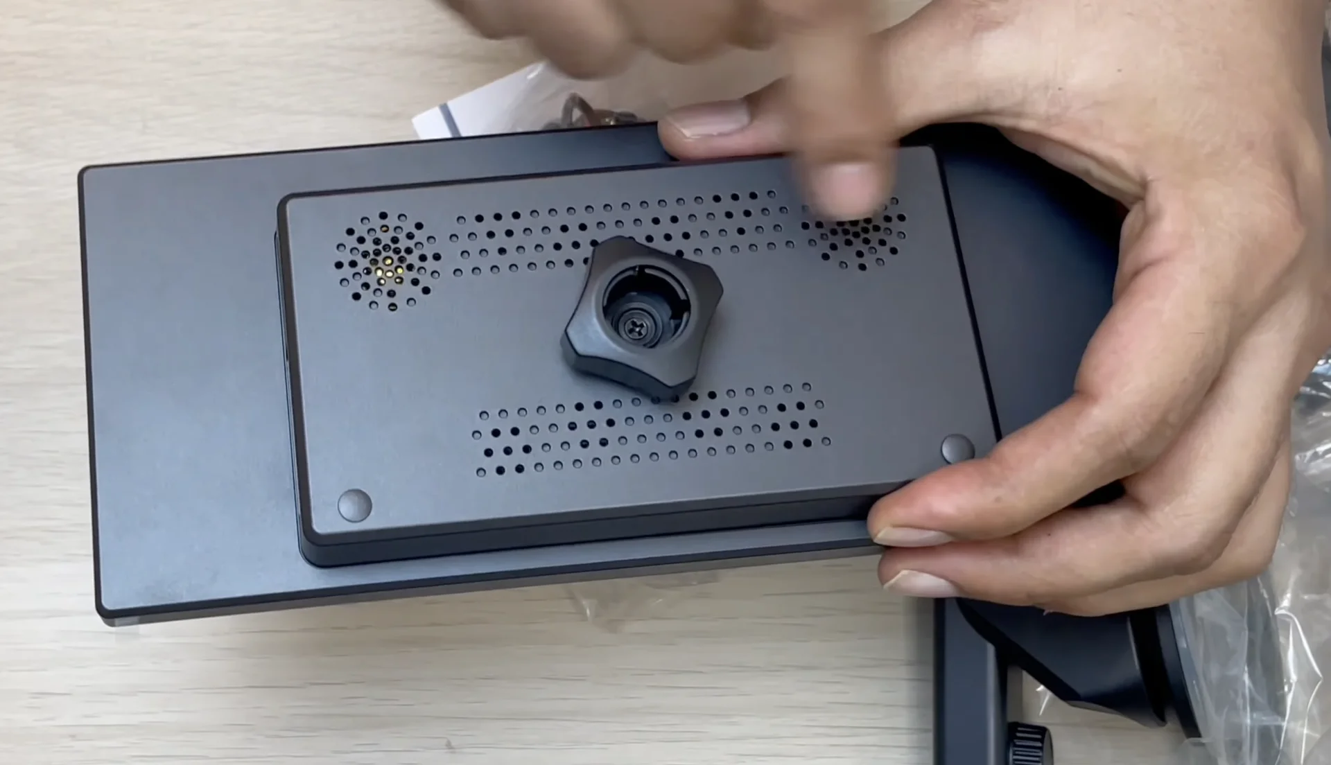

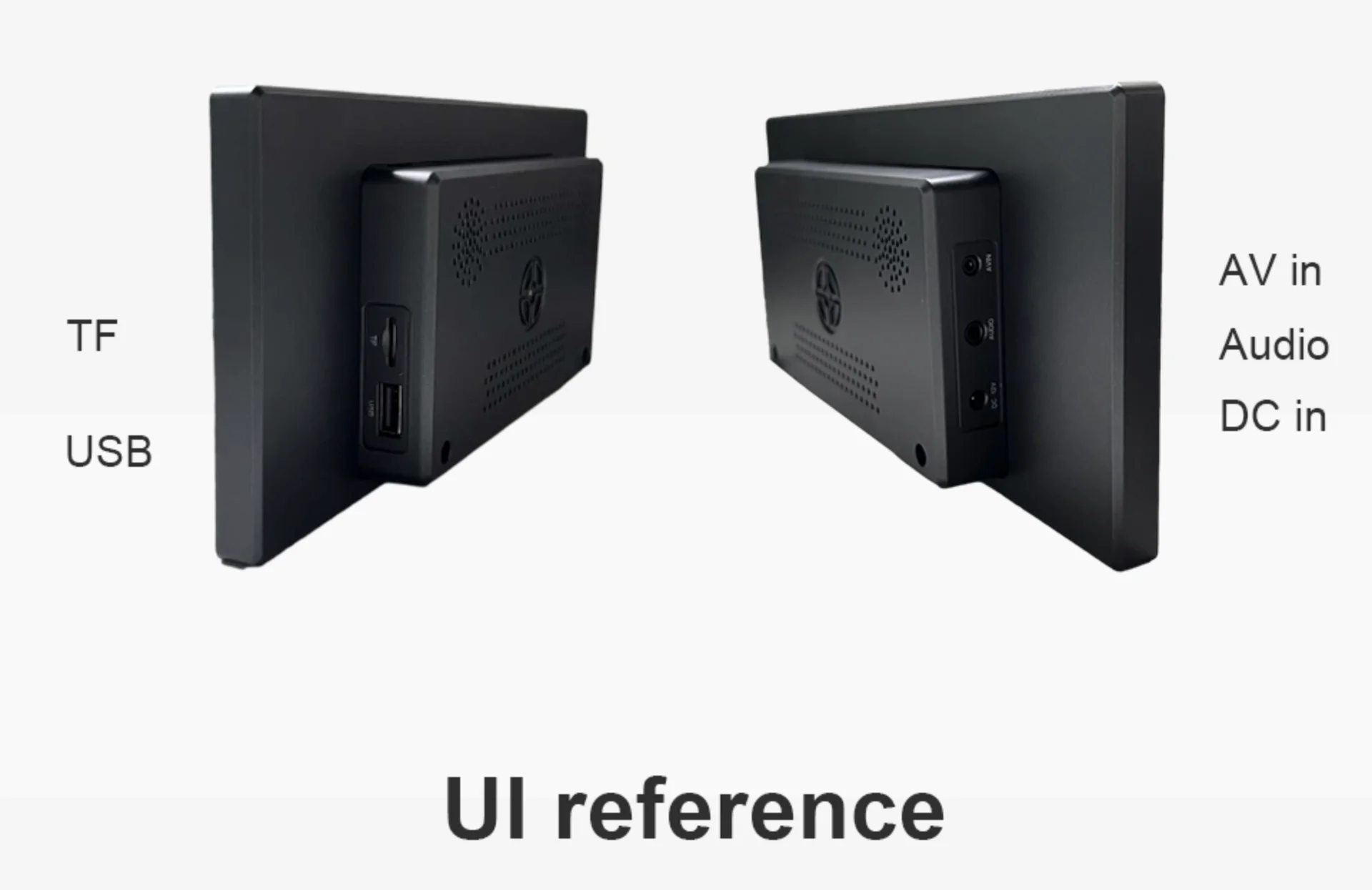

Anyone have an image of the reverse side of the Gen 2 unit? Or, more critically, what the mounting pattern is on one of these - is it a VESA-style with four M4/M6s or something proprietary?
If I can hop directly into my LX and have bluetooth pick up my Pandora without any other steps - I'm in. And if I'm in I'll look at engineering a flush top mount for these, either 3D printed or sheetmetal.
Literally the first thing that popped in my helmet. Er, head.
No VESA or anything like that. It is just a 17mm ball joint socket screwed into the unit. Meaning you can use any mount with a 17mm ball.

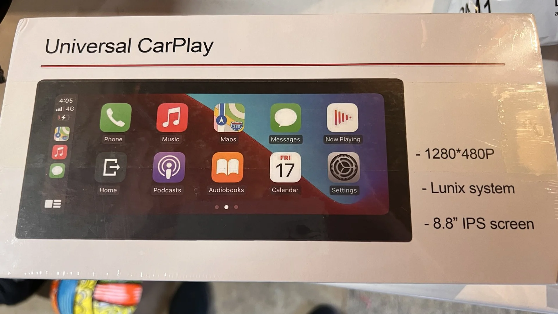

I received the NINETOP unit today, same exact as RT but the box has coloring... Unfortunately it was already a Get 2 until (I was chasing an older unit because of the phone call issue, I'll stick to the workaround already discussed) but I kept it since it was less that the RT... ($260 after coupon)
Same exact box That I received mine in.

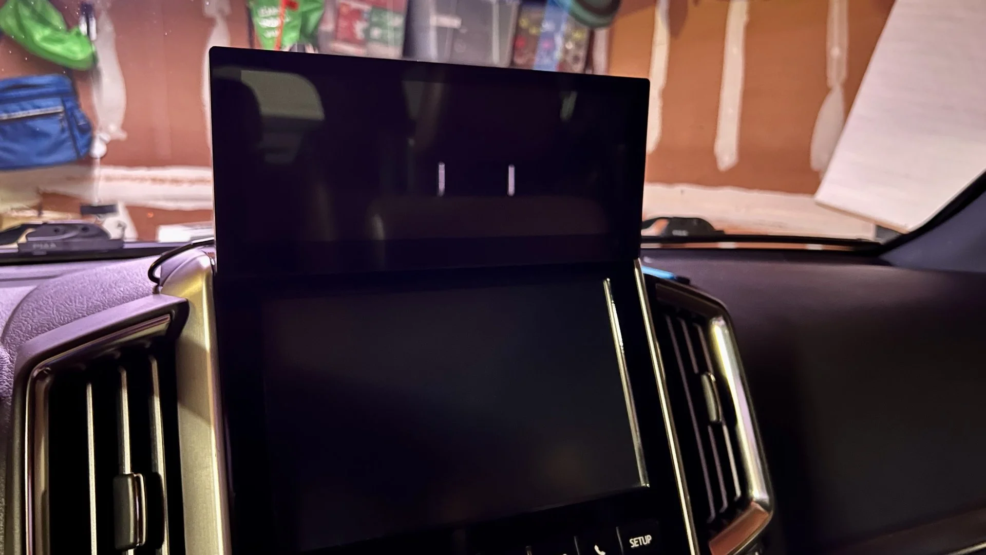

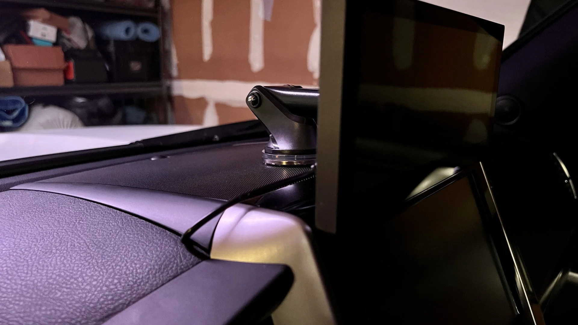

Got a little creative with the wiring today…
Took out the speaker grill and the air vent and routed it behind them…
I wish the wire wasn’t so think I could put it between the grill and the plastic behind… the dash is giving enough that the side works for now. With courage one day I should notch the grill but that’s means real commitment…
For reference this is what happens with the wire between hard plastic and the grill

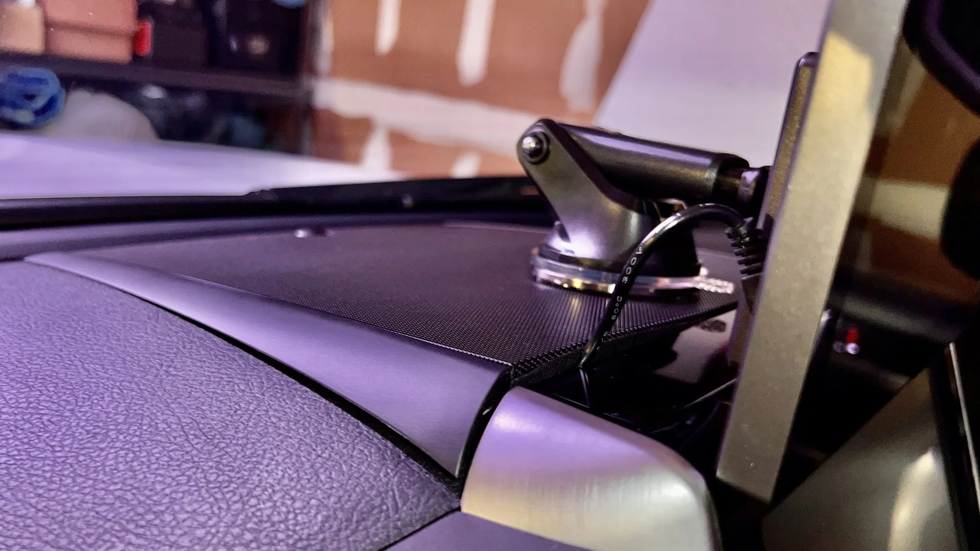

View attachment 3066742View attachment 3066743
