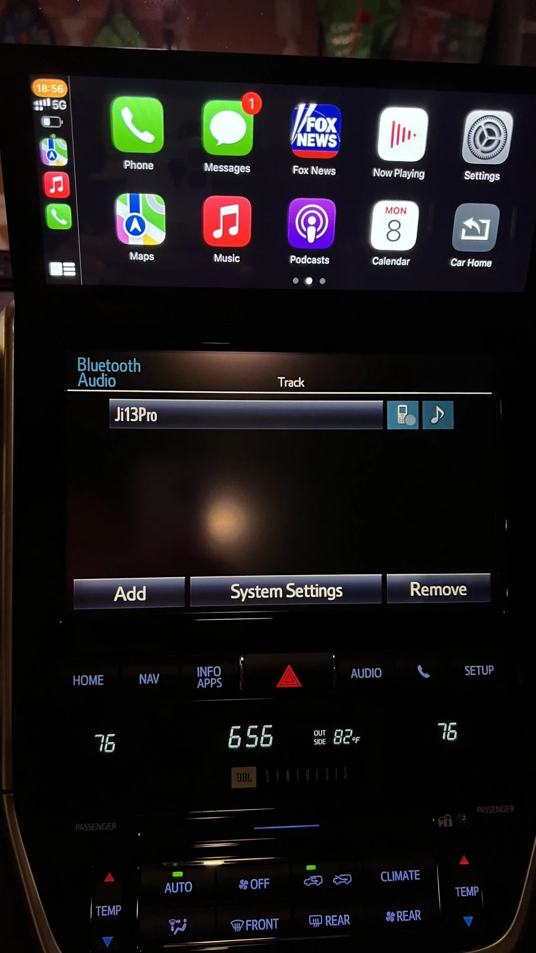

I took some pictures to better describe my setup without connecting RT to the 200.

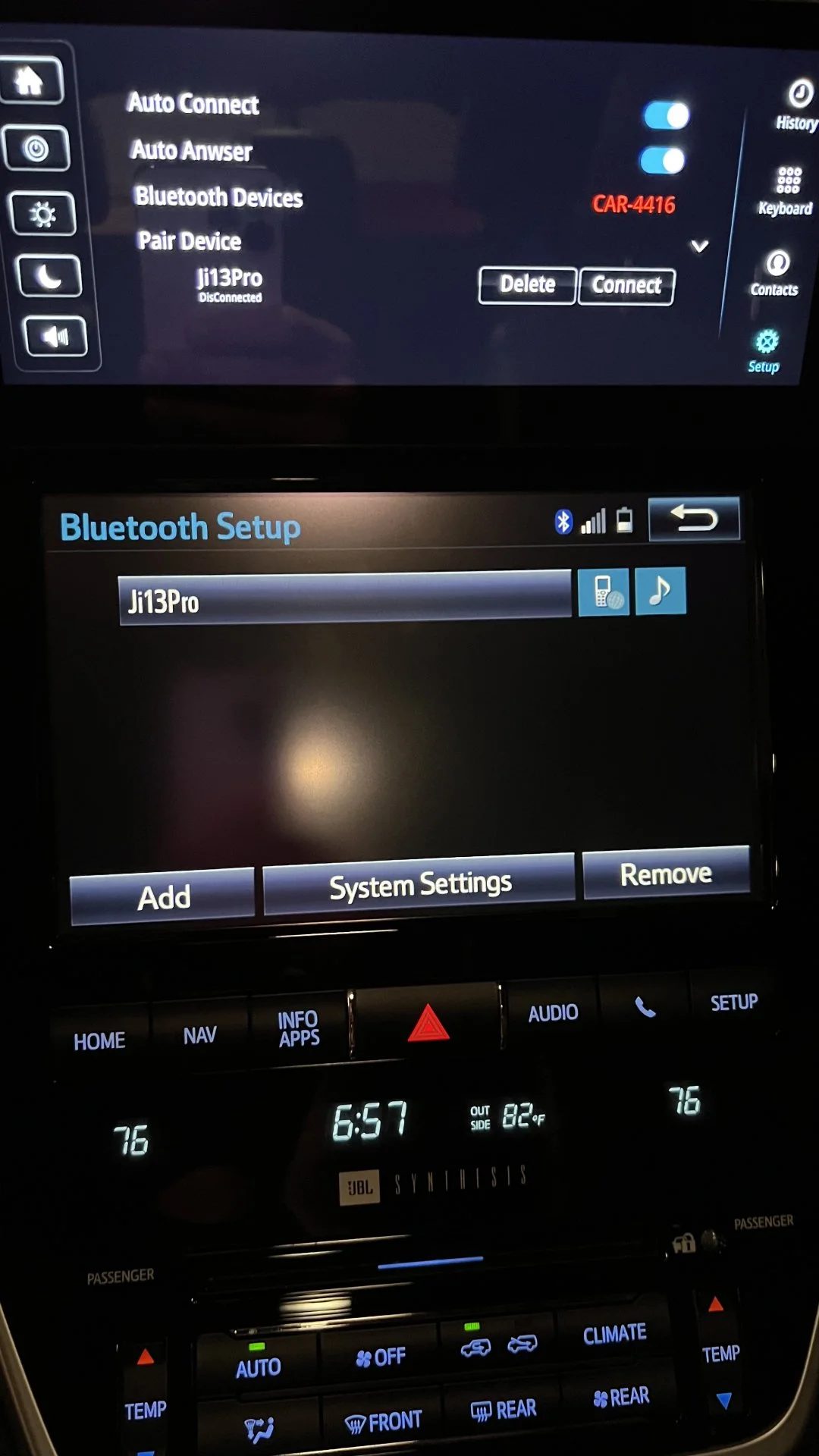

Here is the BT menu on the 200, showing only my phone connected to both phone and media profiles...
Here is the RT showing my phone. This says disconnected because CarPlay only uses BT to "handshake" and it actually connects through Wifi

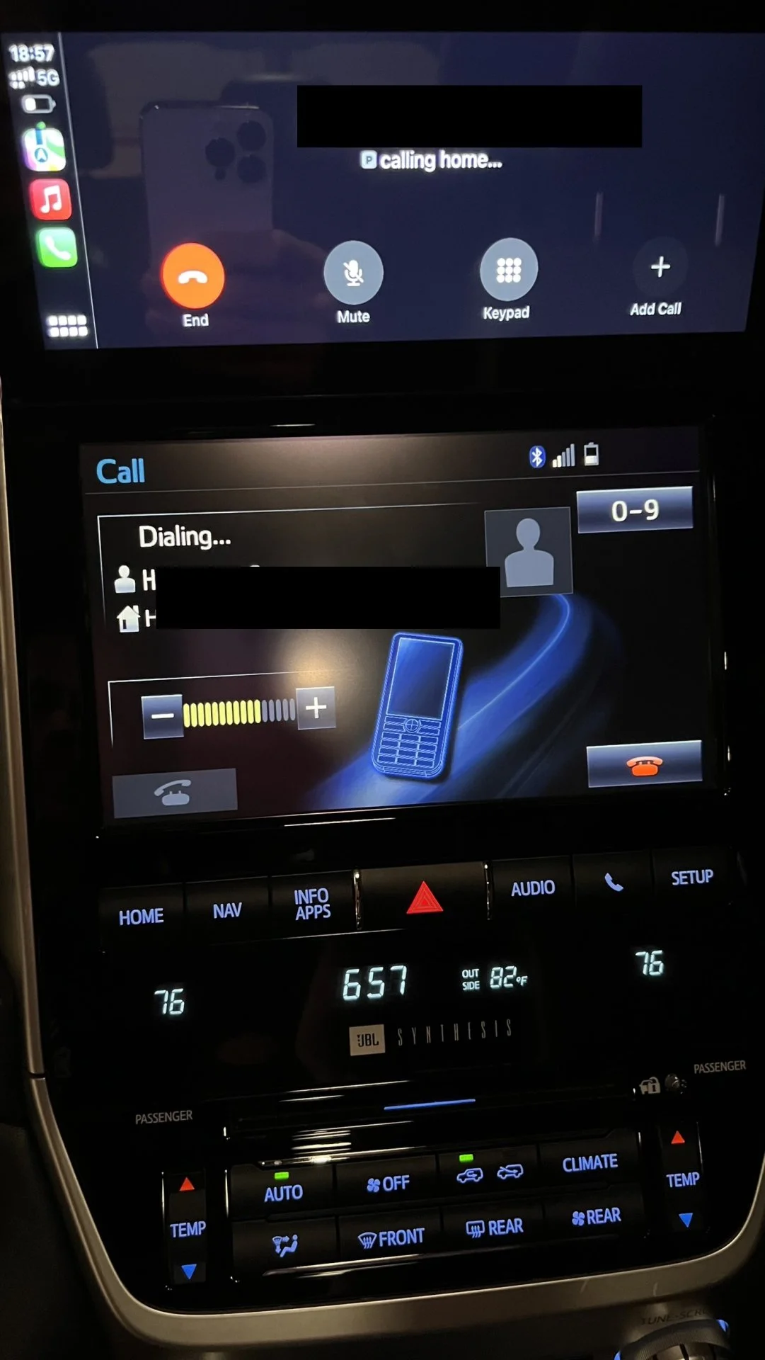

This is what a phone call looks like. No matter how the call is initiated, it routes through the 200's sound system as usual

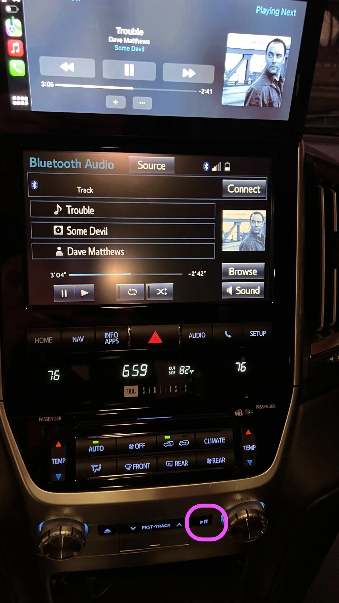

Here is what Media looks like. If new music is initiated on RT through Siri or music app, it may start playing on the RT, all I do to reroute to the sound system is hit the play/pause button. This rarely happens to me as I usually don't initiate Siri via the RT, but by saying Hey Siri or Using Siri eyes free button (hold answer call button on steering wheel)
I hope this makes it more clear.
