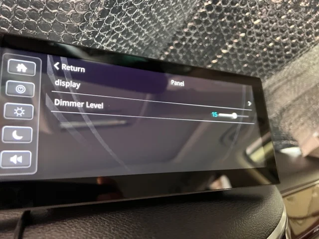

BTW, the only glitch I found so far is that the unit does not keep the Night Brightness selection. As soon you stop the car and the unit switch off, if you turn the car on again, the brightness setting goes back to Day time brightness setting. Would be great if in a new firmware update, Road Top make this setting stored in a non volatile memory or better, set a function where you can set the time of the day you want the unit to switch to Night Brightness setting, like Focus or Sleep on iOS. I already posted this request over YouTube on the video Road Top posted showing how to upgrade the firmware for the Generation 2 units. He is active over there as he already responded to the comment I posted earlier today.

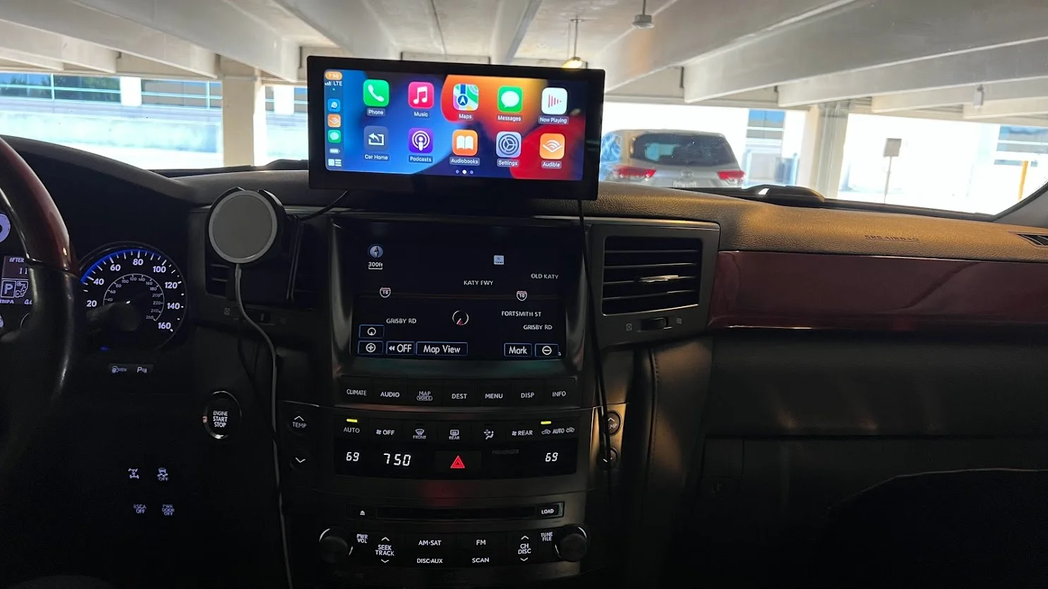

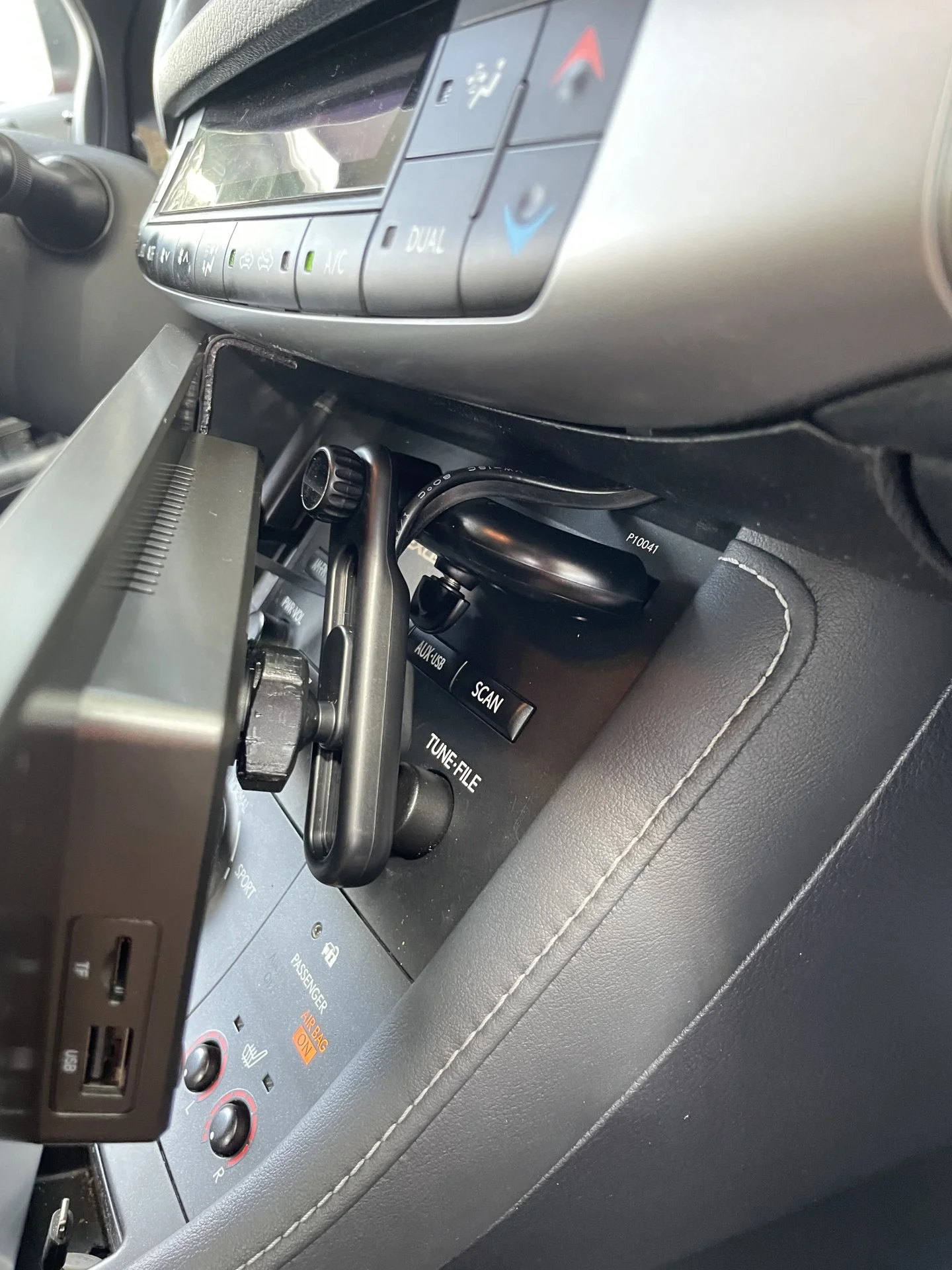

Waiting for someone to post a stacked version on an LX.
I got you!
It's not near as clean looking as the LC but so far it works without issue. I'm gonna run it for a couple weeks to make sure I like it before I re-route cabling behind the dash and remove my MagSafe holder.
I also found a much better phone holder CD mount that adds lot of flexibility regarding positioning. Now I'm totally happy with the way my Road Top looks :)

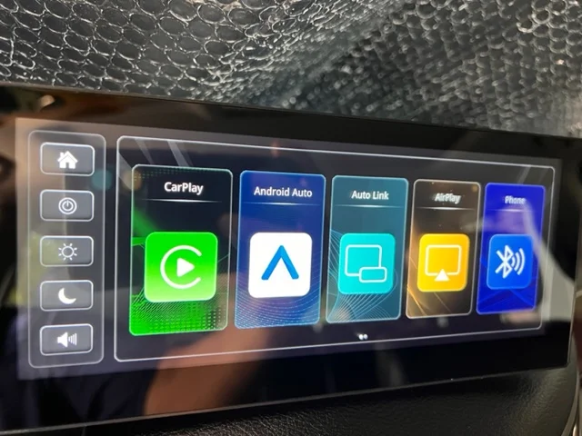

Read all 5 pages of this thread but still couldn't figure out that it's Gen 2 or Gen 1.
I didn't see any auto adjusting feature.
Any thoughts?
That’s gen 2
Wow... glad to know!

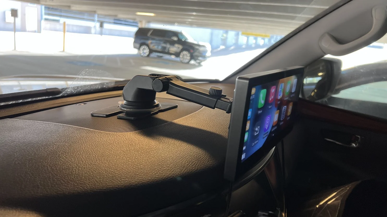

Anyone with better and more secure mounting solution without damaging the truck interior?
I like the look of carplay sitting high on the dashboard like LX600... much easier to glance while driving.

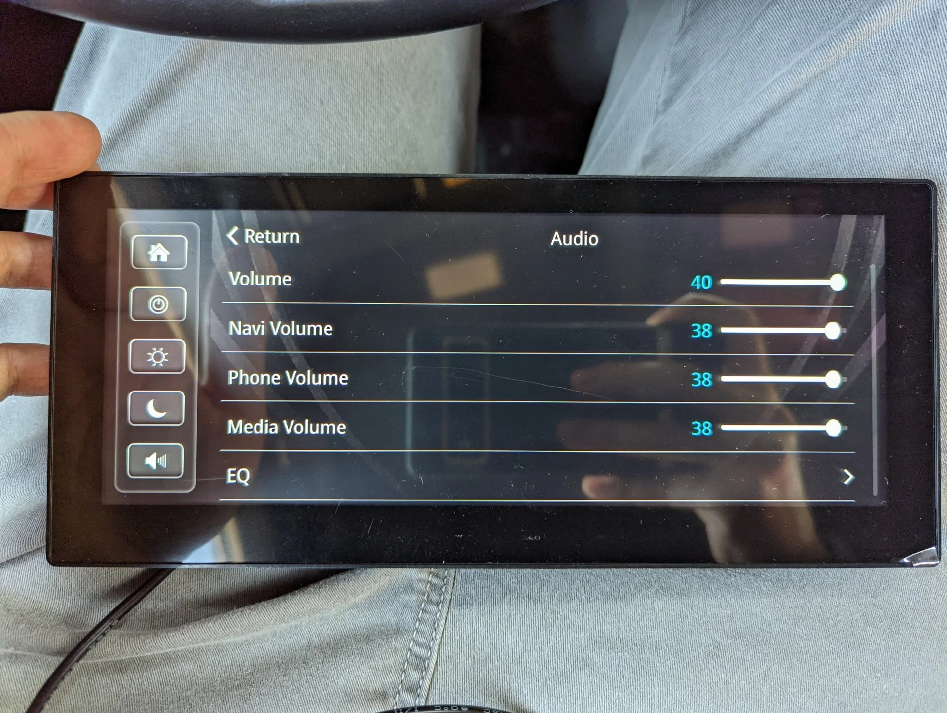

I've received a firmware update from Road Top's reseller and will report back to you guys if it's even worth it. So far with my limited testing, what only changed was the ability to change volume for phone, Navigation, music and etc. Individually. Ran a mic test and the sound went beserk on me and it was not pleasant, probably some setting I didn't switch properly.
How did you contact Road Top? I would like to try that firmware in my unit!!
