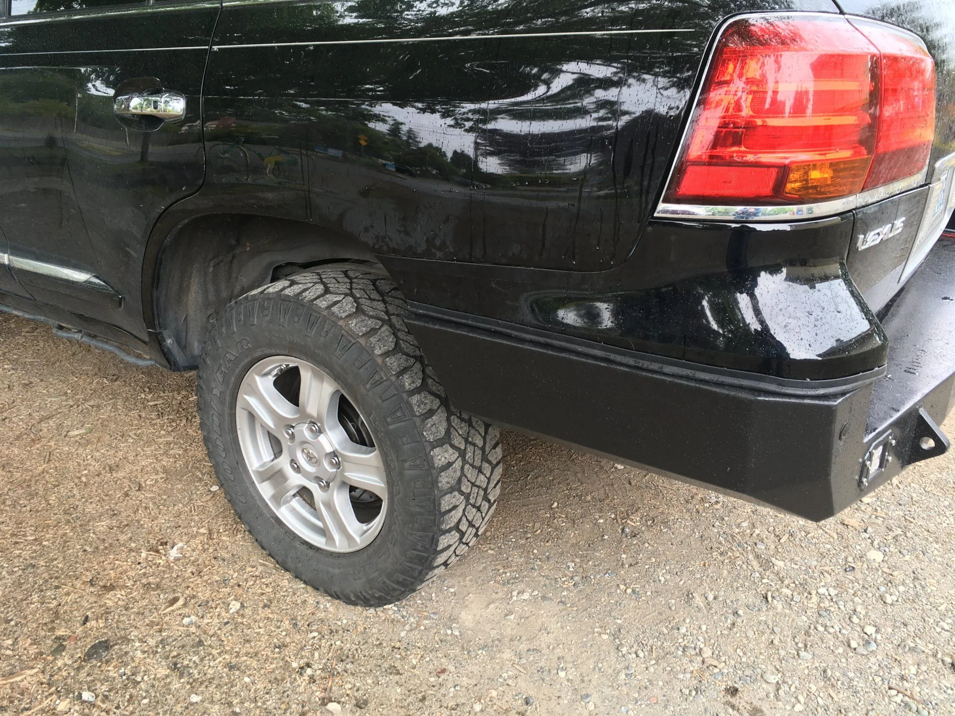

Wrapped up the driver side. It went much faster the second time.
I like it all except the gap between the bumper and the body on the left side of the tailgate. About two inches here that need a plan of some type. I can't see why a vertical fill wasn't included here. I am lucky to have a black paint black body so it isn't very noticeable.

On the LC the plastic extended out so you could cut to fit. You will like that bumper once you get this all wrapped up. I think it's the highest clearance bumper out there right now. 2-1/2 years running so far.
When I get around to it a little sheet metal painted with the bed liner and screwed to the bumper cover bit I kept going down behind the lift gate is a simple fix. If I had a welder easy to tack a piece in too. The real fitment difference is the fact that the passenger wing bracket doesn’t work.
I got this one as I liked the aesthetic, the weight, and the total price for a swingarm solution. James was a pleasure to deal with and worked up some cool rotopax stuff on the swingarm I haven’t even gotten to yet.
As far as departure angle, it’s probably very close to stock. There is much better clearance between the wheel and rear but the stock bumper cover is also tight against the hitch crossmember. I haven’t moved the resonator and that is below the frame, it’s the limiting item at the moment. Yeah, and the tire until I get the swingarm prepped and mounted. Still with the fat a** on these rigs it is basically preventative maintenance to get a bumper you can drag without fear.
