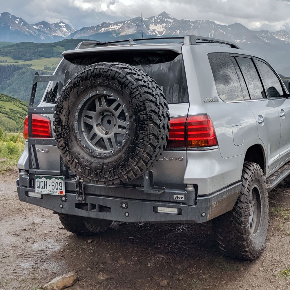

Here are some shots w the plastic trimmed...
Couldn’t help myself. Added just one washer to each flank side - between the bumper and the wing bracket. Doing so leveled out the rear bumper, then I trimmed the plastic just a little more to make it even.
Doubt the difference will come through in pictures, but consider it a couple hours well spent.

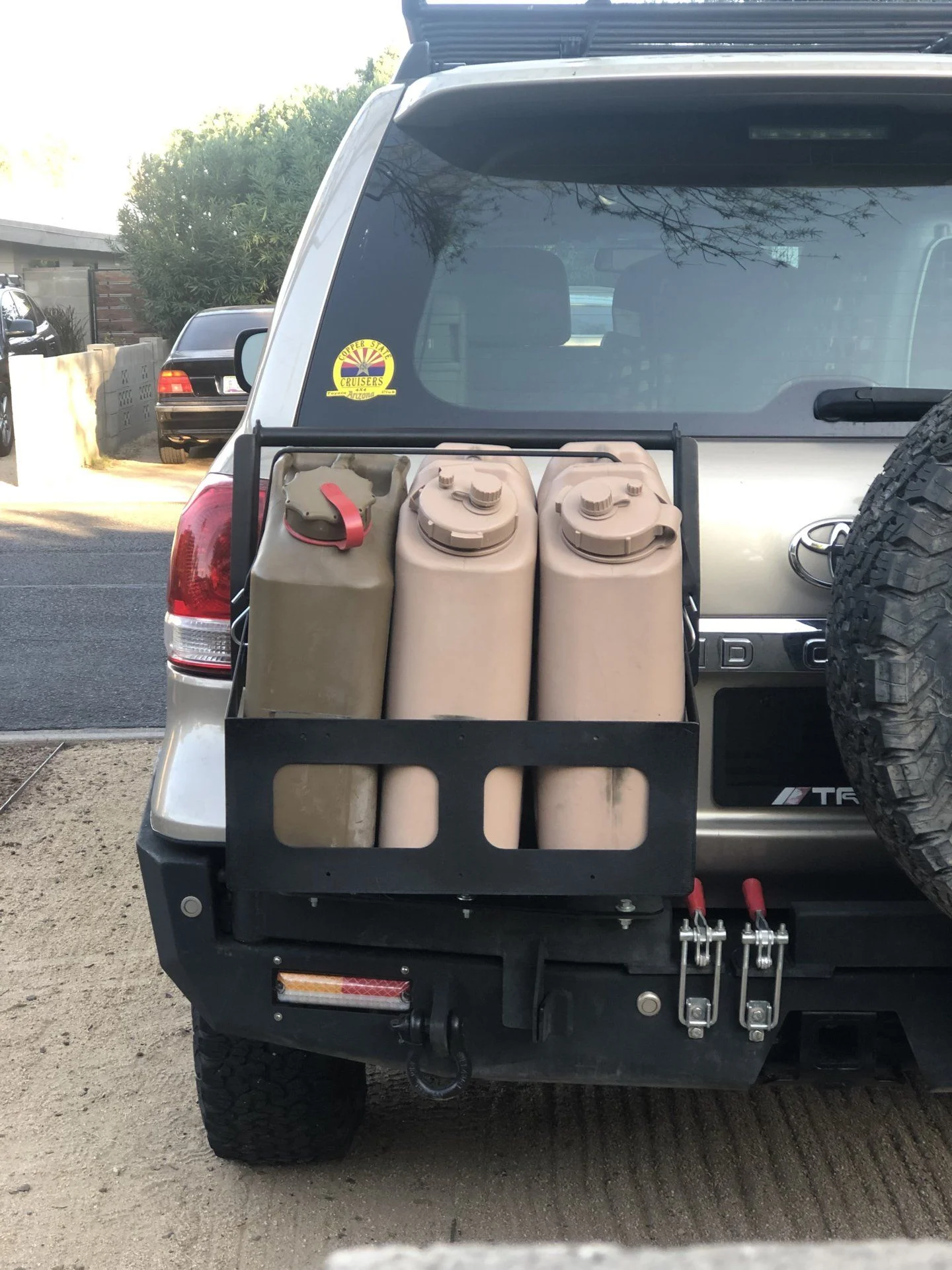

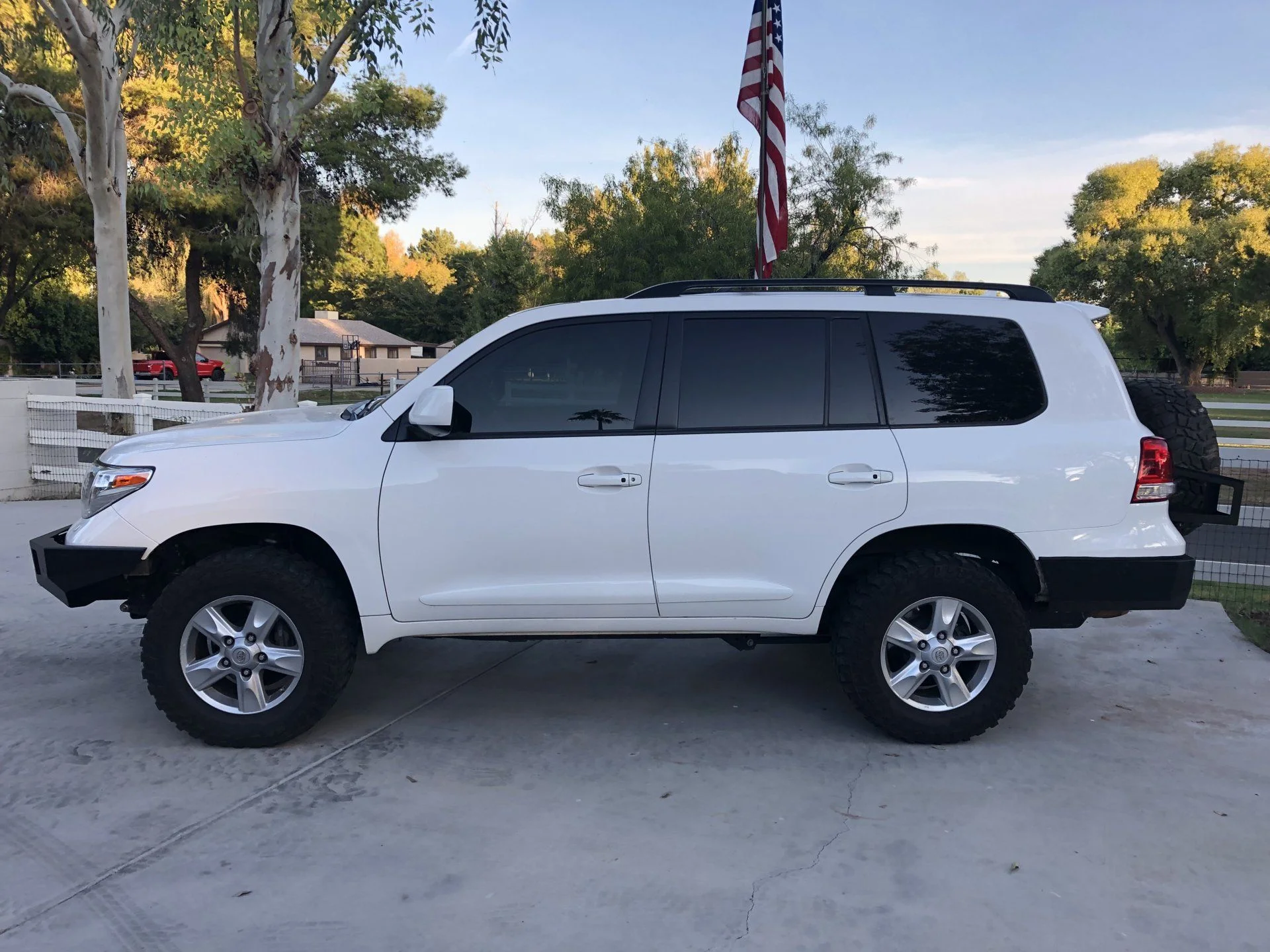

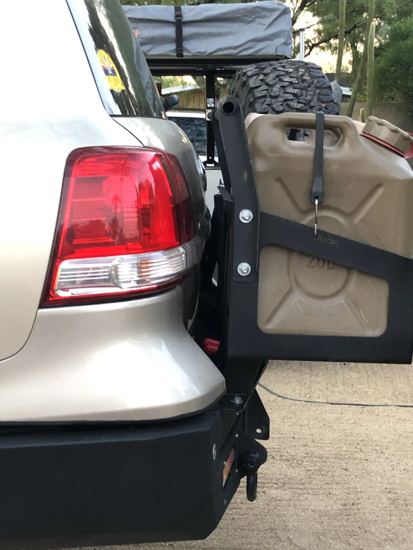

James re-worked my 3 can jerry basket. The original was a 2 piece design, and it was set too close to the tailgate. He now re-designed it as a 3 piece design, set back a bit over 1" and it's just perfect. Just gotta say again it was a real pleasure working with James on this. I think peoples true customer service shines when you actually run into issues. His patience, ideas, and friendliness to fix was a rare customer service experience. Especially since when you go custom with the design like i did, it's not surprising when something doesn't quite fit right with no test truck for the install. Here are some pics of the new design.

Nice design changes - good work! are you going to rework the rear camera or has that already been addressed?
Interesting change to the lower lights. Was that your request? Or all they all like that now?
the lower lights are Roadvision 3-way. Same as Kaymar and Trail Tailor used. I got them from Jason @TRAIL TAILOR . Jason shipped the lights to RLC, and James cut the holes and made a bracket for them. I had to do 3-way lights because of my off-center tire blocks my side lights. The regular bumper James sells has the center tire so they only need the reverse lights.

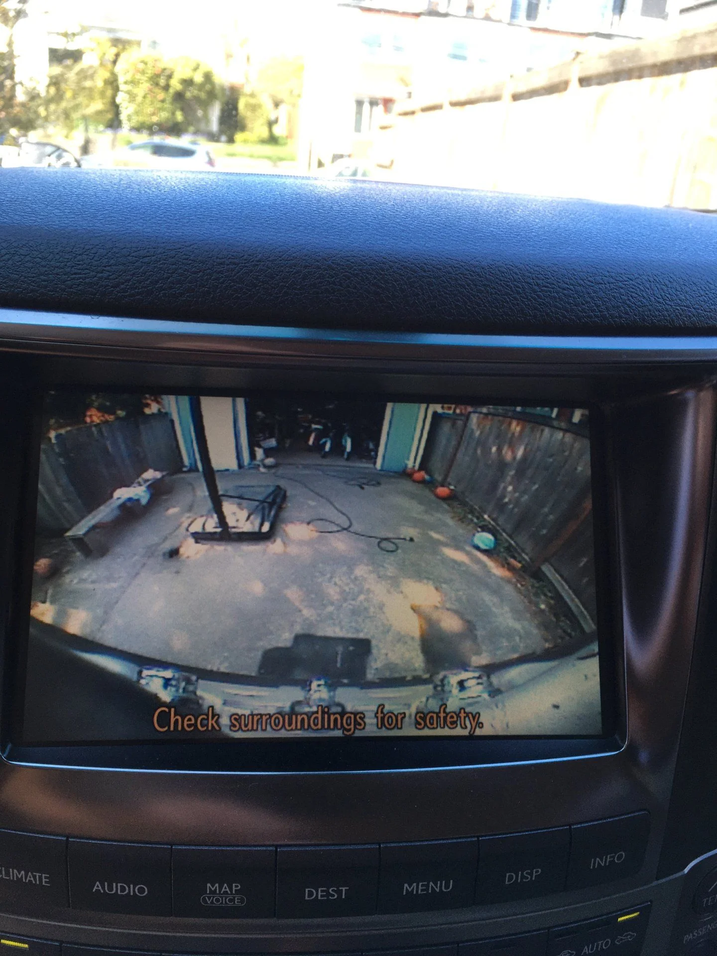

Thanks! Yeah, reverse camera is on my to-do list. Still not sure the best place to mount it. I've had just the single swing arm with the tire on the past few months, and with that the reverse camera was good enough. Now with the jerry cans though it's only a little strip of camera angle.

With IOS 13 the wifi camera I had on the bumper quit working. I had the side panel off to do the subwoofer so I went ahead and killed a few evenings moving the OEM camera.
I have ordered a 6v camera from Aliexpress, but it is somewhere in shipping, so I moved the stock and will put that one in the back door, if it ever shows up.
Anyway, built another galvanized shingle mount which goes up off the spare lugs. Hardest part of the job was running the 7 conductor wire thru the back door to headliner grommet. Use lube. For the 2009 only need four wires for the camera, I used the 7 conductor wire so I could put stuff in the rear door if I want to. I'm considering a room light. This way I won't have to go thru that grommet again.
I put connectors at the camera end and in the back door so I can just plug it in at either location if I need to pull the swingarm for whatever reason.

Good solution, I did the same then realized when changing to RW rims the spokes don't line up with stock so I mounted below the tire. Field of view was the same.
