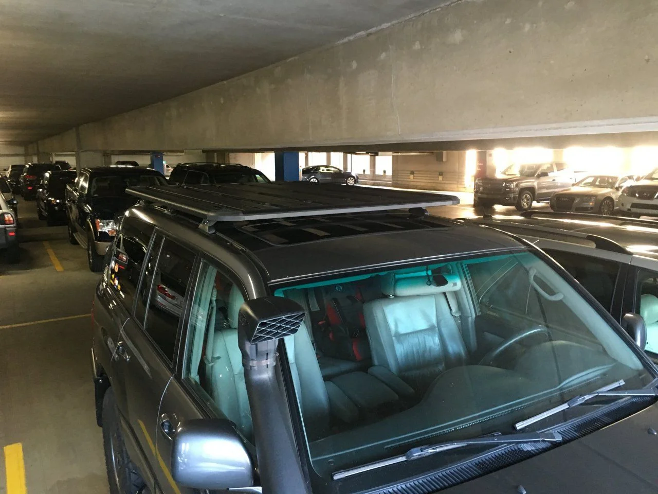

here is steelman's pioneer platform 76X54 (smaller than the one I'm considering)

if anyone has any photos of a 100 with the larger Rhino pioneer platform...84X56....that would be amazing to see.

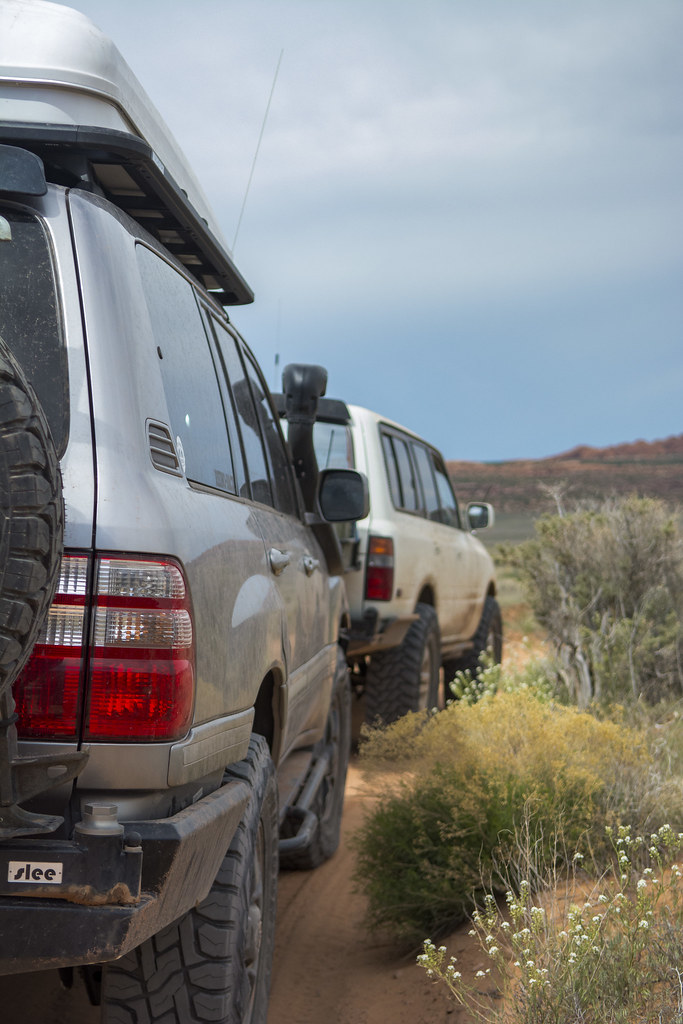

I have a Rhino Rack Pioneer Platform (full length) on my wheeling 100 and a full length Gamiviti Expo on my DD 100. If you're mounting an LED bar to the front of the rack, you get a little more vibration shake from the Rhino than the Gamiviti. I'd be perfectly happy with either rack.
If you're considering a RTT in the future, the full length rack is your option if you'll go with a hardshell RTT. A hardshell RTT will take up all the available space of a full length rack. The smaller RR Platform will fit a fold-over style RTT without issue.
The extra space over the windshield from the full length RR isn't an issue for me, but as mentioned above, it does produce more vibration/shake. You'll only notice that at night with a LED bar on. Otherwise, you'll never notice it. I don't ever hear it shaking.
No issues with weight or structural design. My son and I have stood on top of our closed foldover tent (with other items strapped to the rack) to get a better look at wildlife. Never any issues. Rhino Rack makes attachments for absolutely any piece of gear that you own as well. It's a pretty sweet system.

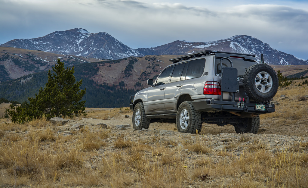

The 1" extra width of the rack took a little bit for me to get used to. I felt that it looked too big at first since the Gamiviti rack basically follows the profile of the 100. Pics for reference.
[URL='https://flic.kr/p/Vhwv9J']
[/URL]
[URL='https://flic.kr/p/MVzS2U'][URL='https://flic.kr/p/Vhwv9J'][/URL]
[URL='https://flic.kr/p/MVzS2U'][URL='https://flic.kr/p/Vhwv9J'][URL='https://flic.kr/p/URSgBc'][/URL][/URL][/URL][/URL]

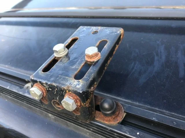

Okay, here's another piece in my garage. Powdercoated steel from a well known, reputable fabricator on mud. Total of 7 days in the sun, the rest in the garage. I don't blame the fabricator, it's just you can't always get everywhere with powder coating.
I'm not going to knock Gamviti because they do make quality steel racks and have been a great supporter of the LC/Mud community. But just as an example of the problem areas...
That triangulated brace/mount can have the same issues on the inside as the piece above....
What if you opt for the mesh? Is anybody really going to grind down all those welds to prevent rusting?
