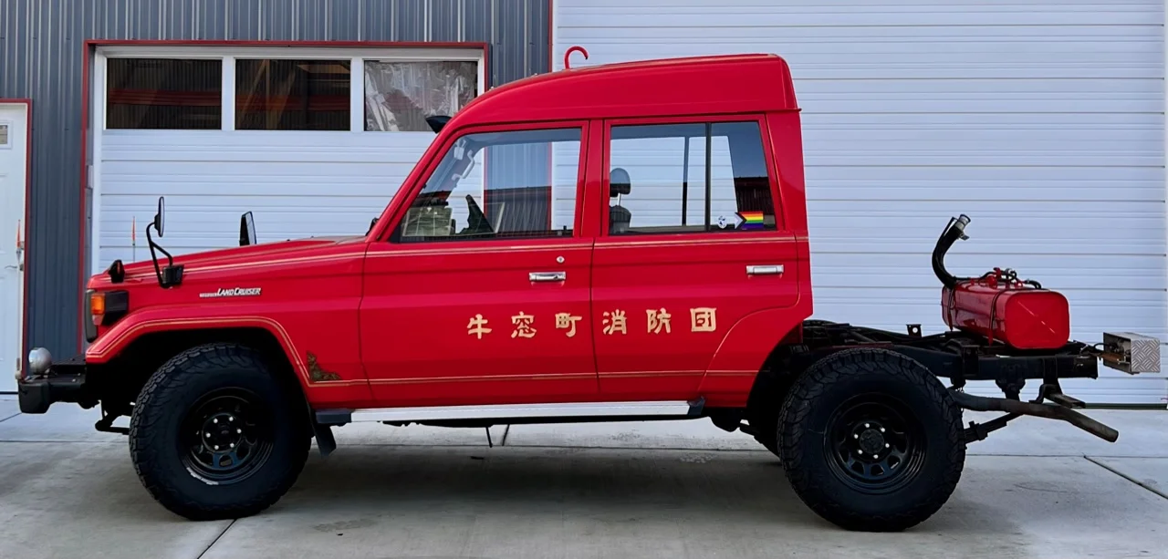

Hi there,
I have a 1993 RHD HZJ75, one of those Japanese Fire Trucks. 3500 miles, just in perfect condition. My plan was to import it to Costa Rica when I retire to use it on the farm and daily driver, converted into a ute. The bummer is I just found out Costa Rica does not allow RHD vehicles into their country... Don't get me started, I would have had no reason to check if the are allowed... I just can't let go of this truck, because its just perfect. So now my brain is spinning, can I convert this truck to LHD? Who has done it and what kind of a nightmare is it?
Or maybe you have some other great ideas? If someone has a LHD Ute who wants to trade?
Thank you!
Guido

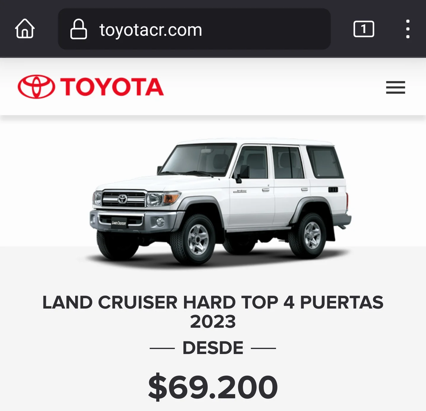

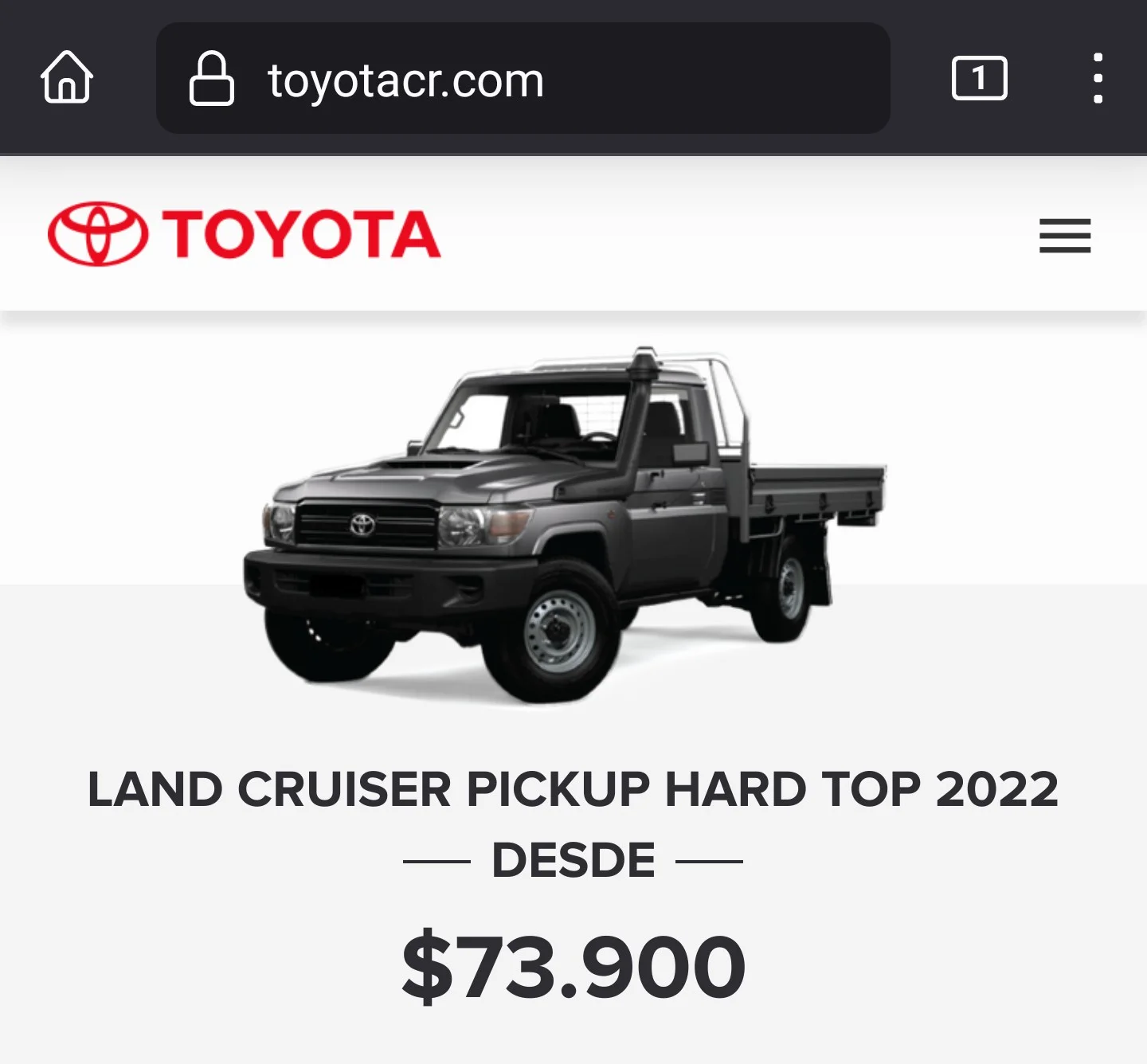

Howdy! Yup... You won't be able to drive a RHD vehicle in Costa Rica... For what is worth you can, either get 70 series directly from the dealership down here (see attachments) or just import one from UAE like I did 🤷🏻‍♂️ Cheers!
PS. Taxes are borderline armed robbery here (not that we see any benefits on paying them!)

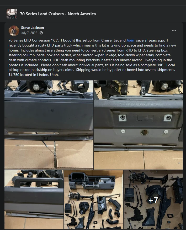

@joekatana had a few of these LHD conversion kits back in the day. I remember Steve Jackson was selling a LHD conversion kit for awhile in the Facebook group.
LHD Conversion Kit - Facebook
I do know that Steve ran into some legal troubles recently, so I don't know if he is still in business or not.
Also, while I was digging through the old Facebook posts, I saw that TorFab had done a few conversions in the past. Not sure if they still do, but it's worth a call, since you're already up that way.

You can buy brand new HZJ79 DC off the Toyota lot in CR. I believe VDJ79’s are available as well but are imported from the Middle East. All the cops in CR use 70-series (76/78/79).
Cheers
Sweet! Thank you! I'll get a hols of Torfab, they're my to go to shop anyways. I am sure it's all a pain in the A**, but i'm thinking about it.
Of course these new ones are amazing, but out of my price range. And I love the simplicity of the '93. Everything is manual and I like the HZ. I hear that when migrating to Costa Rica, I can bring two vehicles tax free, that's why I want to bring them instead of buying there or buying from the UE and importing it.
