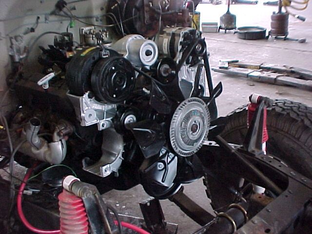

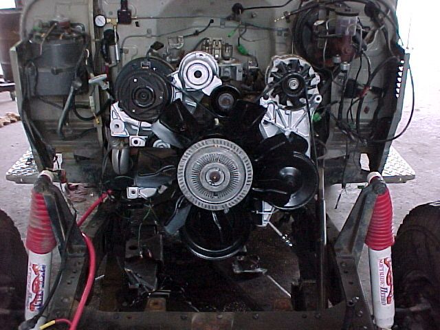

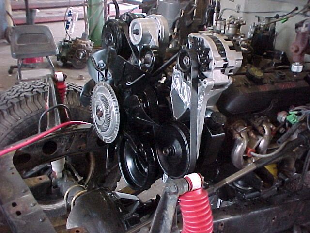

Let me share one of my wrecking yard finds, go source a clutch fan off a 3.8 T bird, late 80's , 7 blades, reverse rotation, 17" I think, and fits the FJ shroud like a glove....... :D :D
HERE IS THE FAN......SWEET.

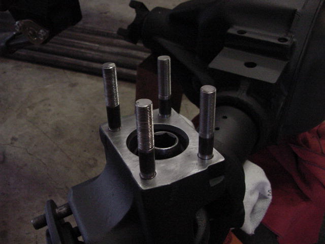

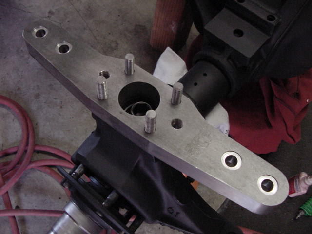

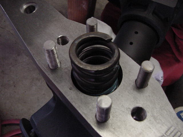

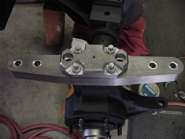

we just got home from rustynut's wedding, great time, still hung over. but right now i'm as happy as a puppy with two peters cause there was a box from BTF waiting for me on my doorstep. finally got my high steer arms and front 60 U-bolt kit so i'll be installing those later today, if i can find the energy to do so. pics to follow soon. :)
and a shot of the finished passenger side. still have to install the grease fitting, but i won't do that until pretty much everything else on the vehicle is done. they break off way too easily while installing the axle in the rig.
and if anybody thinks they can "build" a dana 60 front for under $2-3k, dream on! these suckers add up in a hurry. :eek:
