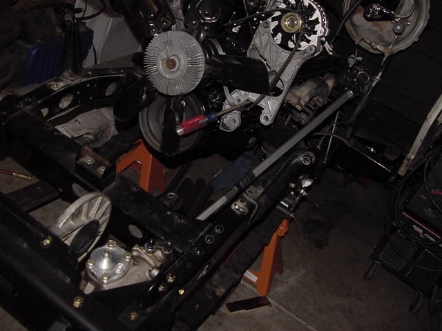

today i had some time left so i figured i'd get the york done. i was initially hoping to run it upright but that became a non-reality as soon as i put the front bib on the cruiser. the head of the york would have stuck right thru the hood. so i pulled it back off the engine, unbolted it from the brackett and removed the head. there is a small vent hole in the case between the crank case and the air cavity under the head. this hole needs to be plugged off or all the oil will pump out in a hurry. to do so, all that needs to be done is to run a self tapping screw into the hole from the top. pretty simple.

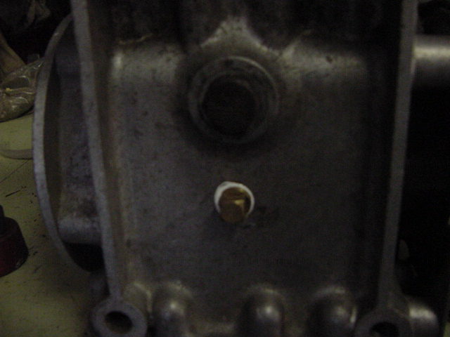

my buddy FC told me about that trick and mentioned that it would be a good idea to incorporate a breather in the york. one of the theories on why yorks blow oil thru the system is that the pressure in the crank case changes depending on temperature and oil expansion caused by higher temps. to prevent this, a small vent can be installed. i tried to figure out what to use for a vent and guess what?! the stock vent on the d60 front looked like it would be perfect. so i unscrewed it from the dana housing, need to run a longer breather on that anyways.
to properly vent the york crank case, i decided to drill and tap a new hole in the case. another option would have been to utilize the factory oil fill plug hole for the vent but then i'd have to unscrew the vent everytime i want to add oil and that's a stripped thread waiting to happen. so i drilled a new hole and ran a 1/8" pipe tap for the proper thread. installed the vent and guess what children? your dimb-assuincle georg forgot to see what side would be up and i promptly vented the now bottom side of the york. yeah, that would have worked really well for about 5 minutes until the compressor seized up.
so i had to pull the vent back out, find a pipe plug and install that with some liquid teflon. now re-drill the case on the opposite side and repeat the process. all this time i did have the bottom crank case cover off to make sure i would'nt have any aluminum chips in the crank case when i was all done with the mods.
finally got the york done and mounted where it needs to be. now i just have to wait for jeepindoug to finish modifying my double v belt pulley to work with my serpentine setup and it'll be done. except for running the air lines of course.
running the york horizontally also meant that i had to move my air intake/air cleaner assembly. the plastic intake was so long that the K&N filter would have hit the hood skirts, so i chopped about 8" of it and now it should work perfect. i'll just have to make a small brackett to help secure it in place and keep it from wanting to move back and forth. i also installed a new belt tensioner and pulley and a new idler pulley since the old ones felt a little chunky. i'll carry them as trail spares just in case.
this is what the engine looks like right now. i don't have the right belt on it yet since i do not have a new PS pump on there yet. but soon. :cool:

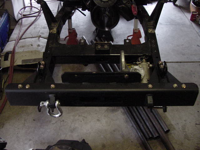

today i wanted to get the bumper mounted so i had to make sure that the AGR box would work and that it would be removable with the bumper in place. had to remove some of the material around the input of the PS box so it would fit into the frame.
after that, the box fit perfect and it's removable with the bumper in place. so i pulled the bumper back off (only had it held in place with 2 bolts anyways). put the new bumper bracketts on, along with the frame bracketts and tow hooks. figured out that i did'nt have enough grade 8 stuff in my "stock" so off to orchard. it's amazing how little hardware it takes to run up a $80 bill. :rolleyes:
at least i have some spare hardware now, i hate running out.
got the bumper back on and all the hardware installed, put the PS box back in with a couple of bolt for mock-up only and then installed the one end cover of my warn 8274 to make sure everything would clear. no problems!!!!!

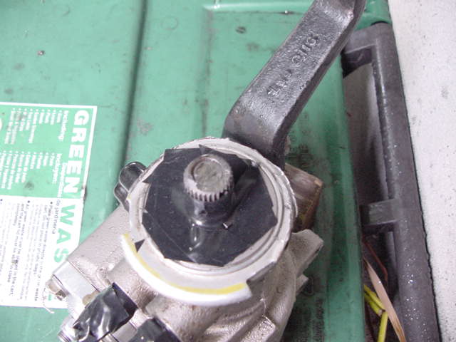

got my borgeson steering shaft in the mail yesterday, so i spent a couple of hours out in the garage installing it. pulled the steering box back out, painted the colapsible shaft and the steering joints to keep all that stuff from rusting. did'nt have to do any trimming, the shaft worked perfect the way it came. installation was a sinch, just add a small amount of loctite, tighten up the allen bolts and lock nuts and you're done! it's slowly starting to look like a cruiser again. :)

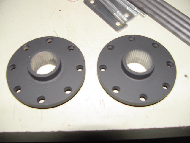

today during my comute to work on my "comuter-scooter" i was thinking of ways to improve the cruiser, as always. the front axle and all the parts still needed were on my mind and i got to thinking about the drive flanges. all the pics i had seen showed them being held in place with a set of bolts. since i want to make them easily removable, i figured it would be a good idea to use studs instead of bolts. the plan is to use the drive flanges on the trail and a set of "dummy flanges" on the road to and from the trail. these dummy flanges would still hold the outer stub in place, but it would be supported by a bearing and not positively locked to the hub. this would eliminate my worries about the front driveshaft constantly spinning when the vehicle is driven on the freeway and around town.
so once i got to work i called the local supply house and had them send over a set of 16 studs. no big deal, they even had them in stock and at 74 cents a piece i could'nt complain.
on my way home i got to thinking again. trying to remove a prefectly machined flat surface from another one on the trail would not be that easy, especially if there is a series of 8 studs loacting them perfectly paralell with each other at all times and angles. trying to seperate them would prove difficult to say the least, especially because there would be a layer of silicone making the job even harder and it would be next to impossible to do so without damaging either mating surface.
the answer was simple: machine a pair of flat reliefs in each flange at opposite ends so it is possible to insert a pair of screw drivers. by twisting them they would start to seperate the 2 parts from each other and the rest won't be a big deal. sounds goo in therory anyways. only one way to find out.
here's a pic of the flanges after my simple mods:
next i installed 2 studs on the hub at opposite ends and slid a drive flange onto it. worked perfect, even a little tight, but that's better than a crummy fit anyday. i grabbed a set of 3/8" grade 8 flat washers and nuts and installed them as well. the flat washers were just plain too big in diameter so the washer hung out over the outside edge of the hub. that neither looked good nor would it prove beneficial on the trail. so i grabbed a set of 5/16" washers and drilled them out to 3/8" one at a time. i like to use a makita with a unabit when drilling out washers because the bit will both center the drill and hole in the washer as well as creating a nice chamfer when it's done. i've done this before to get a good washer to bolt fit. i don't like how loose the washers fit when you use a 3/8" washer on a 3/8" bolt. call me anal, i don't care.
here's a pic to show the difference. it might be a minor detail but it's all part of my "quest". ;p
