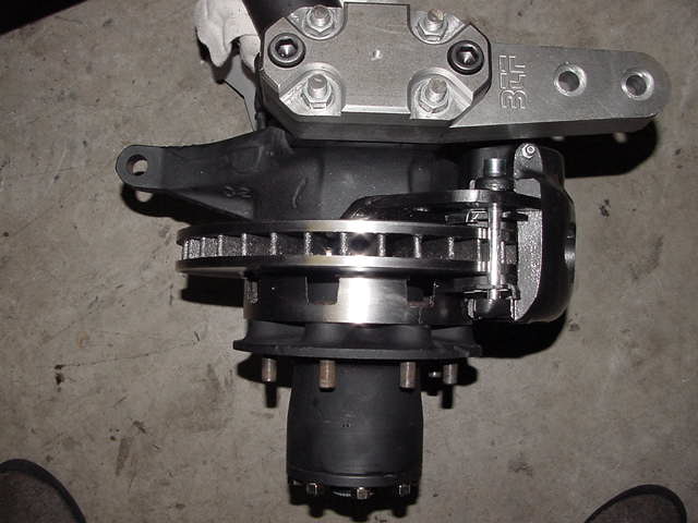

on thursday i got my long awaited caliper mounting bracketts. these were supposed to be the only bracketts available that bolt right on and still allow for proper knuckle and brake geometry. one out of two ain't bad i guess.
the bracketts are definetly beefy (3/8") but the offset for the caliper is'nt quite right. there was no way to get the loaded caliper to mount. first we tried to bend the brackett some to creat more room for the brake pad to slide in between the rotor and brackett, but he needed just over 1/8" and that was'nt gonna happen. now what?! machine down the brake pads, that's what! we ended up chucking up the two inner pads and removing just over 1/8". good thing they don't use asbestos in the pads anynore. that created enough clearance to install the calipers. and this is where we ran into the next problem. the caliper mounting bolt coul'nt be installed cause the high steer arms were right in the way. so loosen up the arms, slide the bolt thru and check everything again. that worked ok except that when we tried on one of the allied beadlock rims i'm gonna run, it rubbed slightly on the caliper. no big deal. get the gringer, smooth out the caliper, try them again and clean them up to get em ready for paint. tis part of the day got a little frustrating but it turned out ok.
after lunch we finished up the brake installation. i had already packed the wheel bearings and installed them along with the seals in the hubs a while ago, so all we had to do was to slide them on and tighten them up. to do so, i had bought a pair of snap on spindle nut sockets on ebay last week. i got them for $1 a piece so the price was right. too bad they were neither snap on nor the correct size for a d60. :rolleyes: but for the price, who cares.
at least we got the rotors on and the axle mounted. i also got some studs for the drive flanges but they were too long. i trimmed about 1/2" off each one and now they work perfect. got the flanges installed, took a couple more pics, put away some of the tools and called it a night. more to come tomorrow.

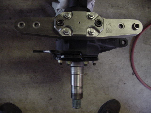

nope, the steering arms are great. the problem i'm having is caused by the brake caliper bracketts. i want to run 15" rims since i'll be on 37s. to do so on a d60f you either haveto grind the hell out of the stock calipers (which i did'nt have) or you can buy conversion kits which allow you to run 3/4 ton rotors and calipers. these are smaller in size and will allow a 15" rim to bolt right up. the problem with the conversion kits is the caliper brackett. the kit i bought included a flat brackett. according to the seller, that BCB (Brake Caliper Brackett) was supposed to be munted between the knuckle and spindle. this would work, but it would move the spindle 3/8" away from the knuckle, thereby not letting the outer stub axle ride where it needs to in conjunction with the spindle (bearing) and it would not allow you to install the outer snap ring (no big deal).
for proper geometry you have to run the BCB at the very end. knuckle, spindle and then the BCB. the problem is that this will move the caliper too far outboard and you won't be able to make it work with the rotor.
so JB's 4wd makes the BCB i ended up using. instead of a flat design like so many others i have since found available, his is a multi piece design that mounts in the right location yet still sets the caliper in the proper location, which is further inboard. well, his is close to the right location anyways.
the BCBs from JB were $150 and were supposed to be the answer to my problems, but i still had to modify parts and waste a bunch of time doing it, so i'm not too happy with them. but it's the nly BCB that "works" so i'm gonna keep em. can't afford to spend any more time on the front brakes.
here's a pic from the top so you can see the clearance issues. if you look closely, you can see the difference in thickness between the outboard brake pad and the inborad one, which we had to shave down.
