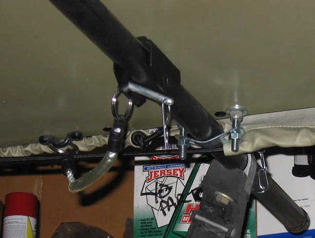

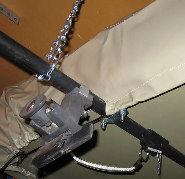

Arrived today. Just got done installing it. Bolted mine straight to the INTI rack.
Drilled out the rivets on the factory mounting brackets and took them off. Also,
removed the eyelits that were on the bottom of the tent too. Drilled straight through
the floor and through the aluminum frame into my aluminum floor. Used two small
plates on the back with some large 3/4" self tappers and drilled them in horizontally.
The tent aint goin' anywhere.
