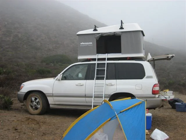

Maggiolina Grand Tour
Worth it. Envied by all who dwelled below.
As far as the ladder goes, I just set it up the height I wanted and then took the bottom section off whole and stuck it on the top of the tent before I put the cover back on.
2 pins to get it on and off. Yeah, I would rather have an better ladder, but once you get the height set it is fine.
I may weld my lower section together.
remember that the height needed will depend on the terrain, right?
