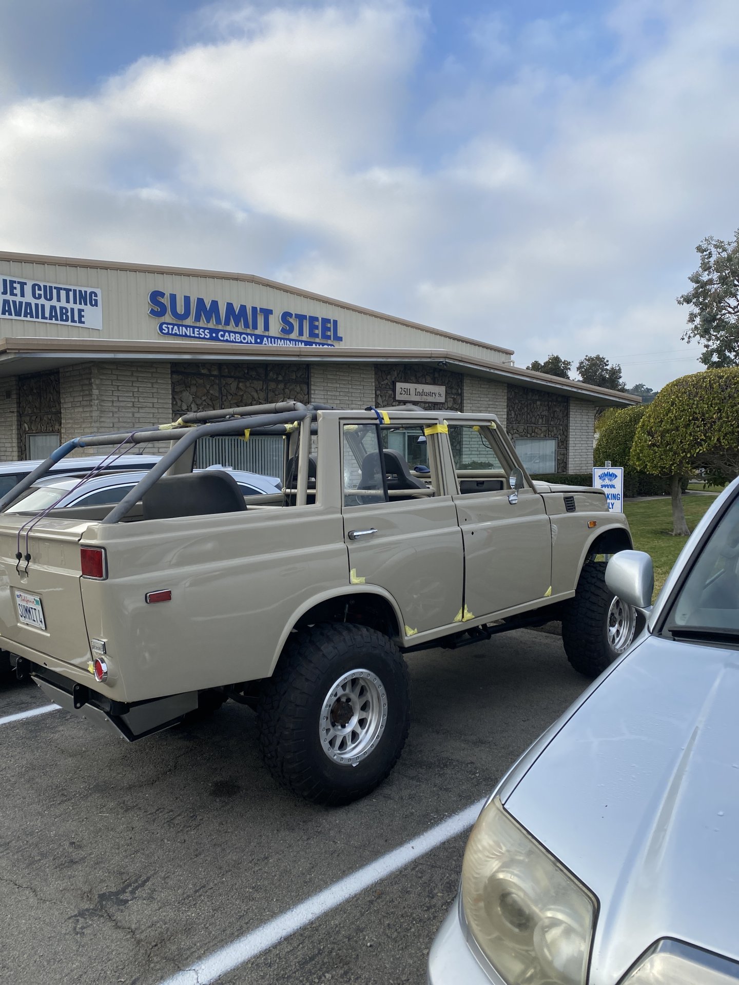

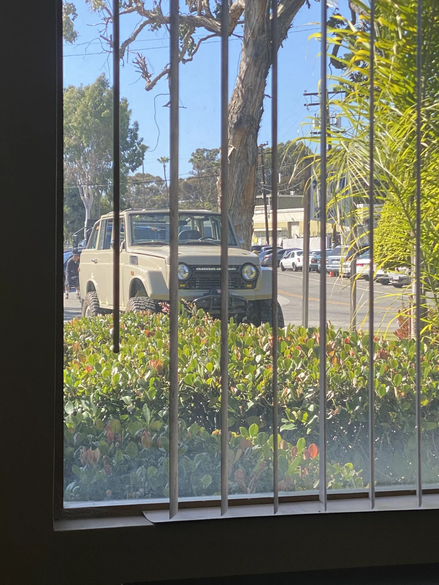

Drove this to work today. 45deg and no door windows. Brrrrrr
How many times did you turn around to look at it while walking into the office? Alternatively, how many big plate glass windows did you cruise past to catch a glimpse of it moving?

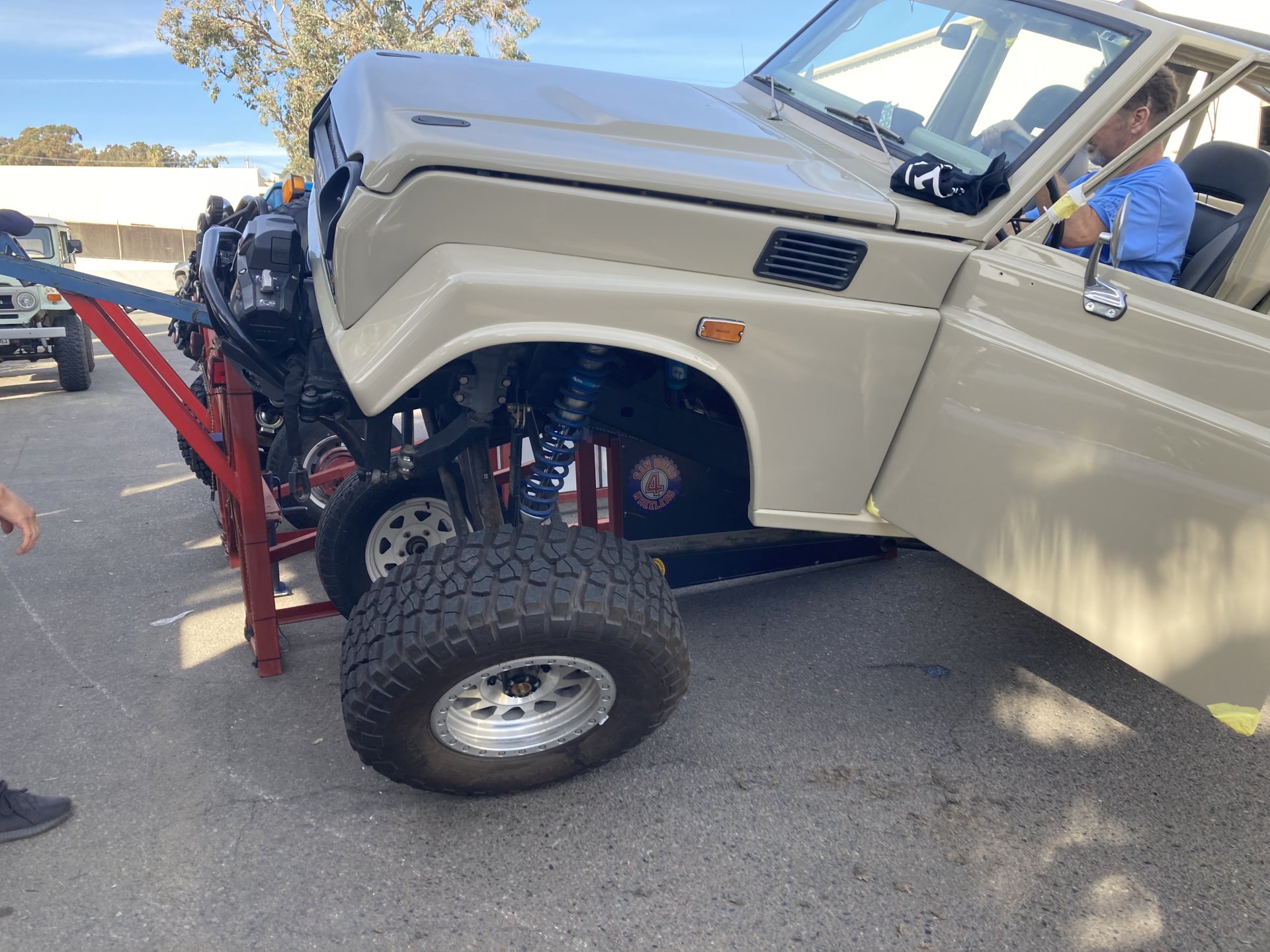

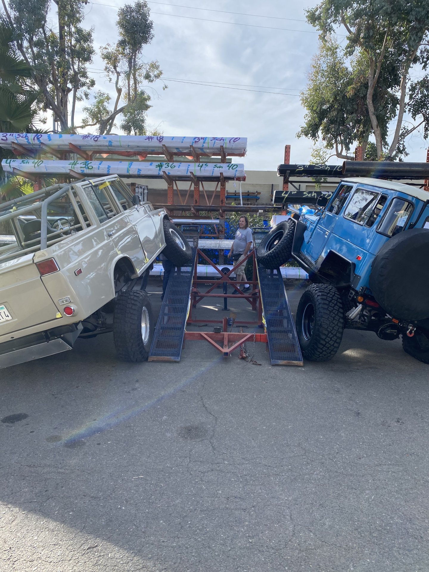

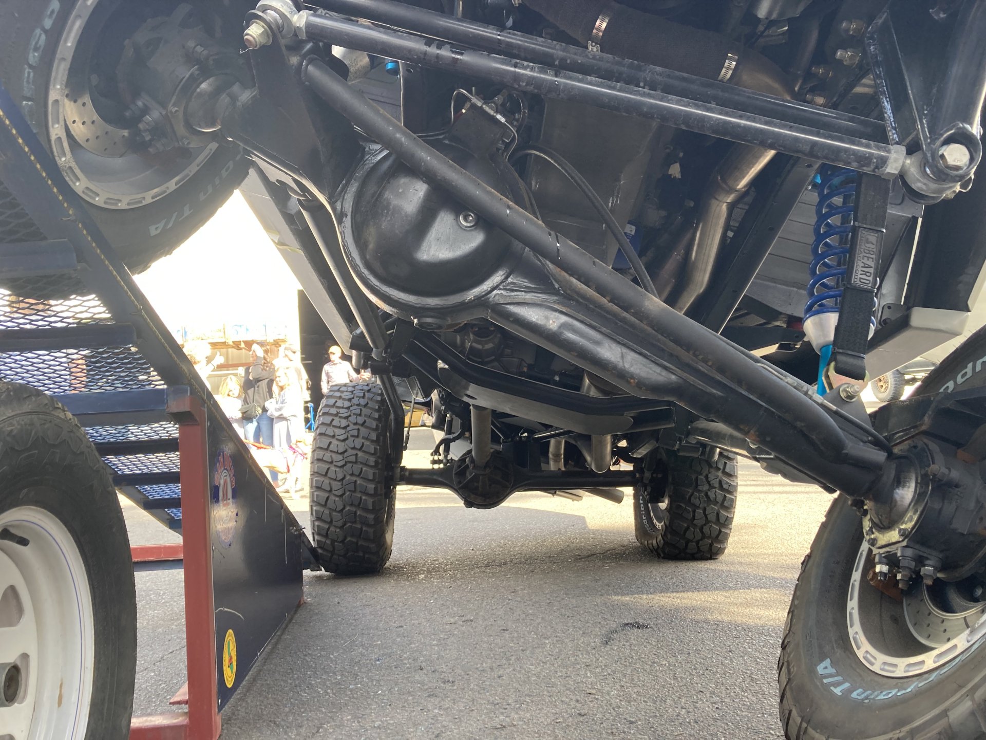

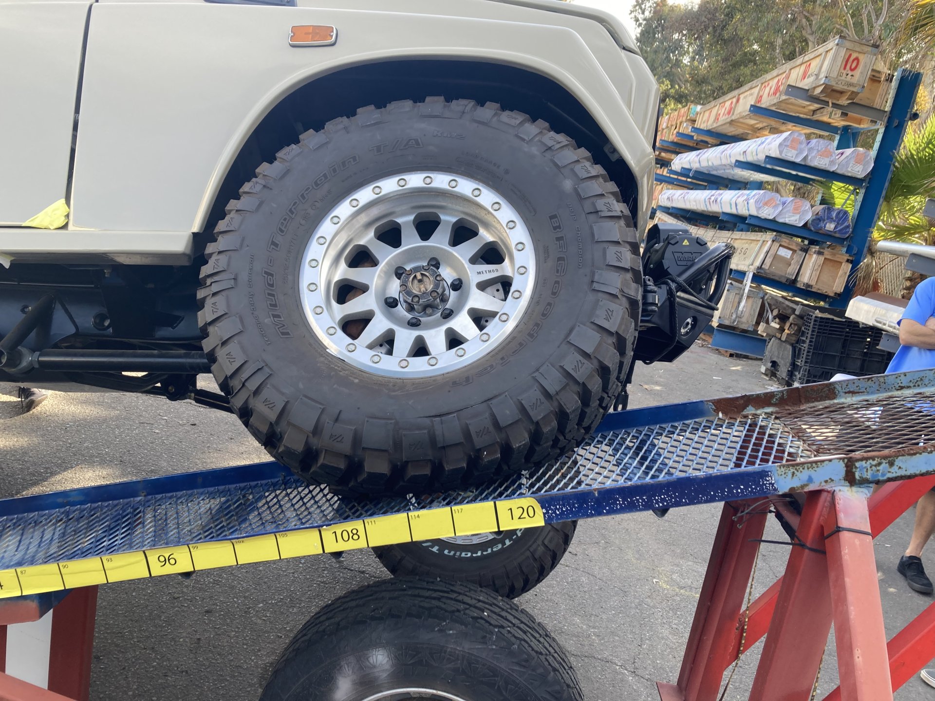

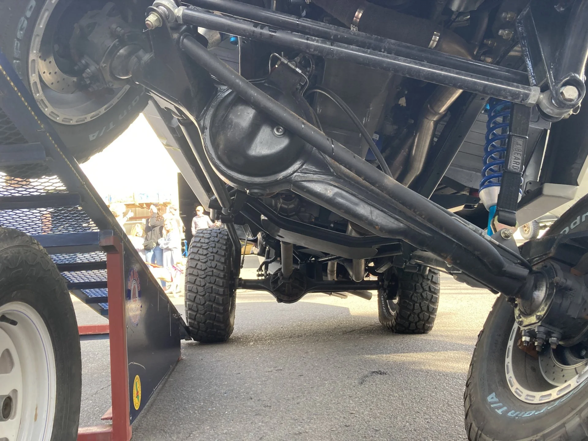

It’s a 62 front housing and the knuckles are flipped in order to fit big brakes. It’s about 2”-3” wider than stock 62. Rear is full float 60 with 1.5” spacers. I guess my RTI ramp score was 1065. The blue 40 barely beat the pig. Can wait to wheel it. Still need lockers installed

How tall of gears are you thinking?
I’ve got 4.88’s I’m putting in with ARB lockers. Putting 37” tires on. I little low right now with 4.10 and 35’s

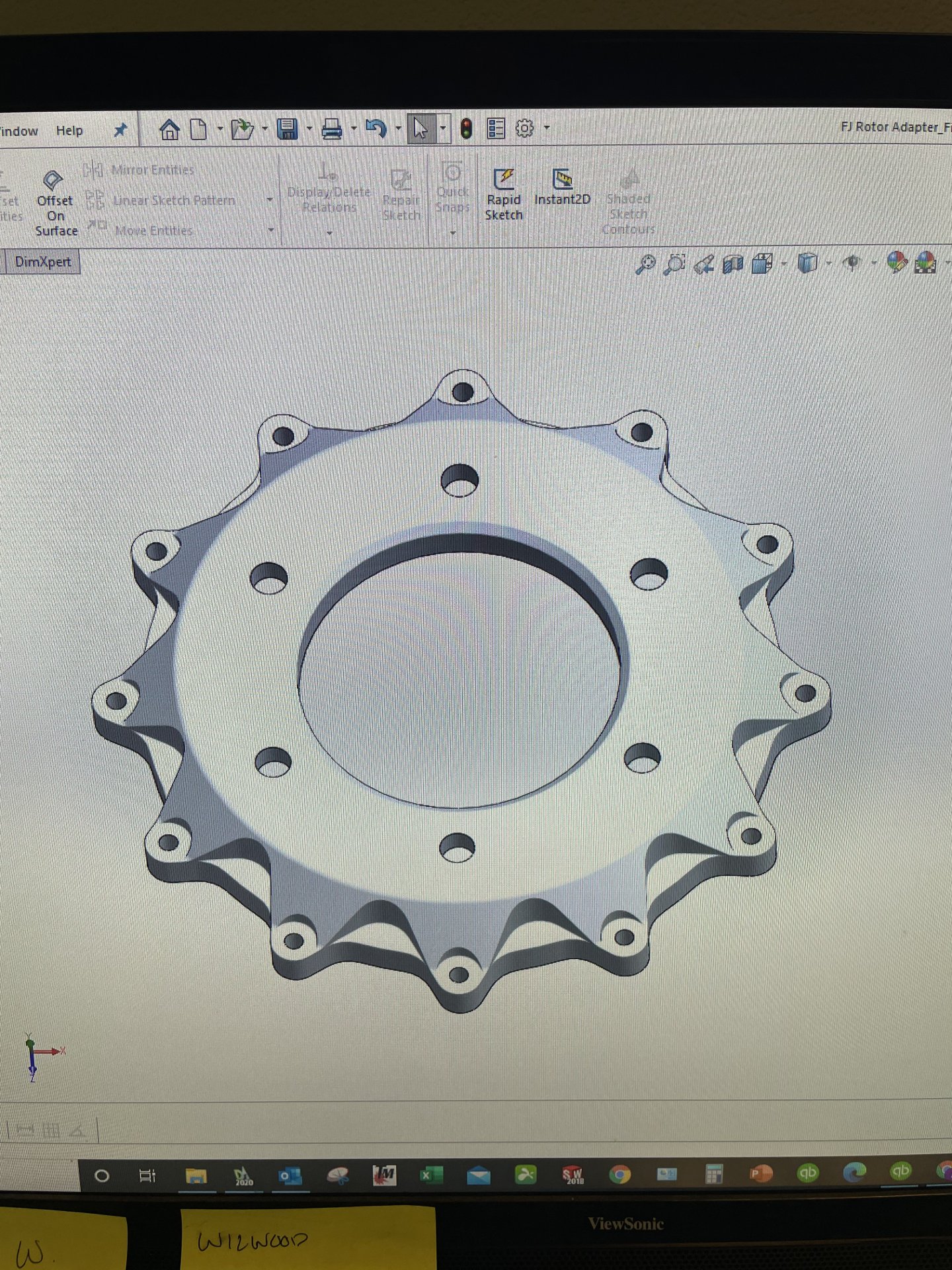

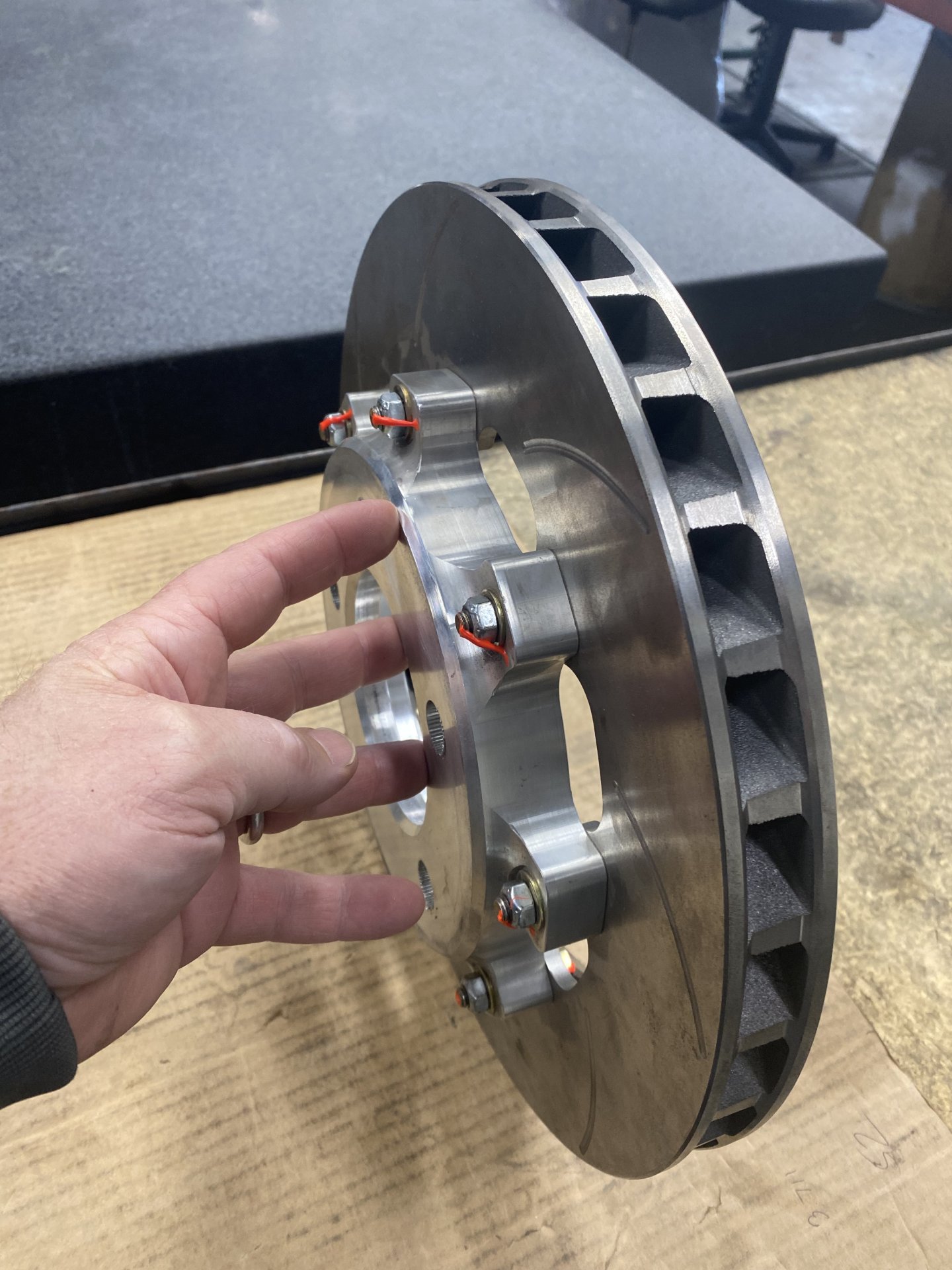

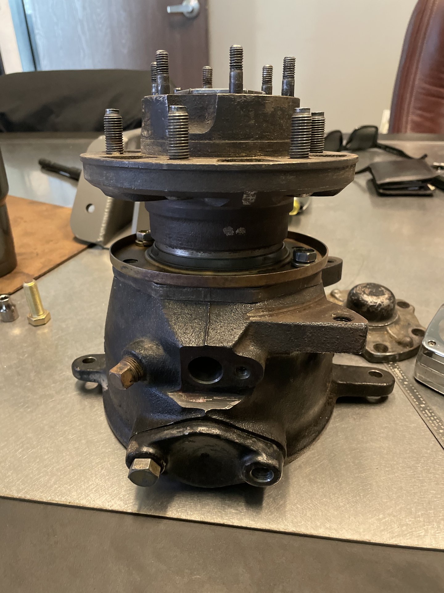

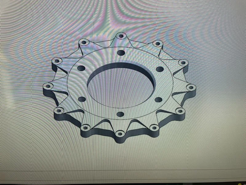

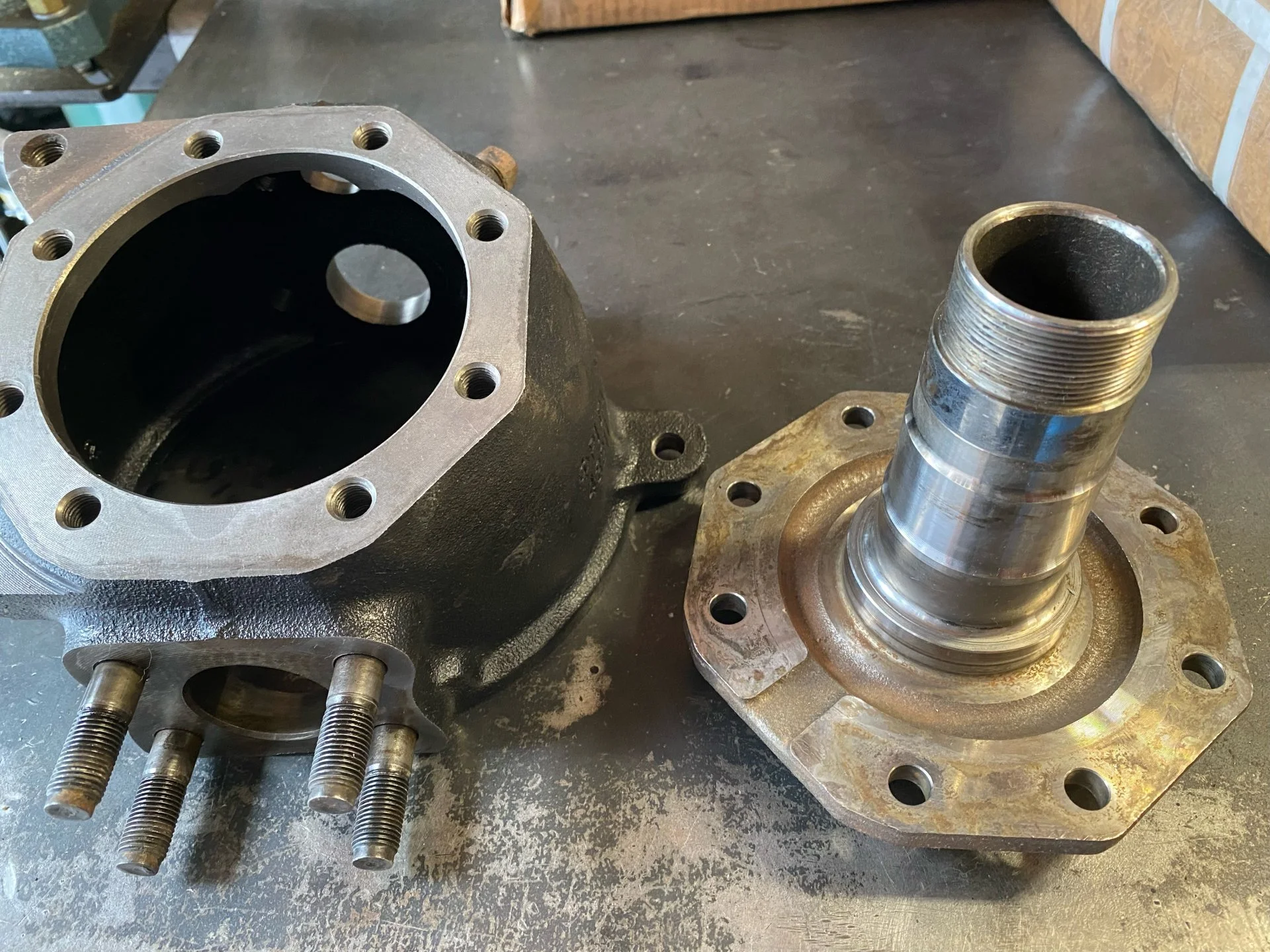

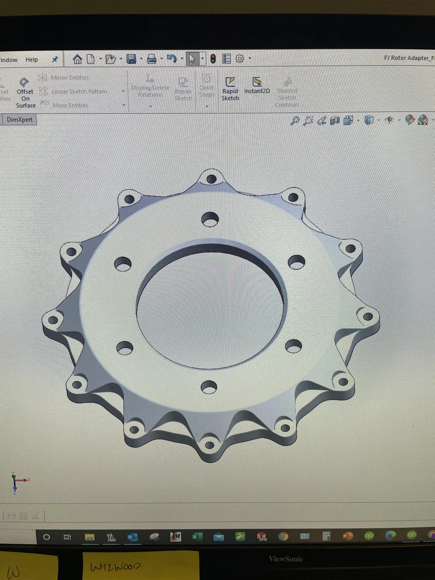

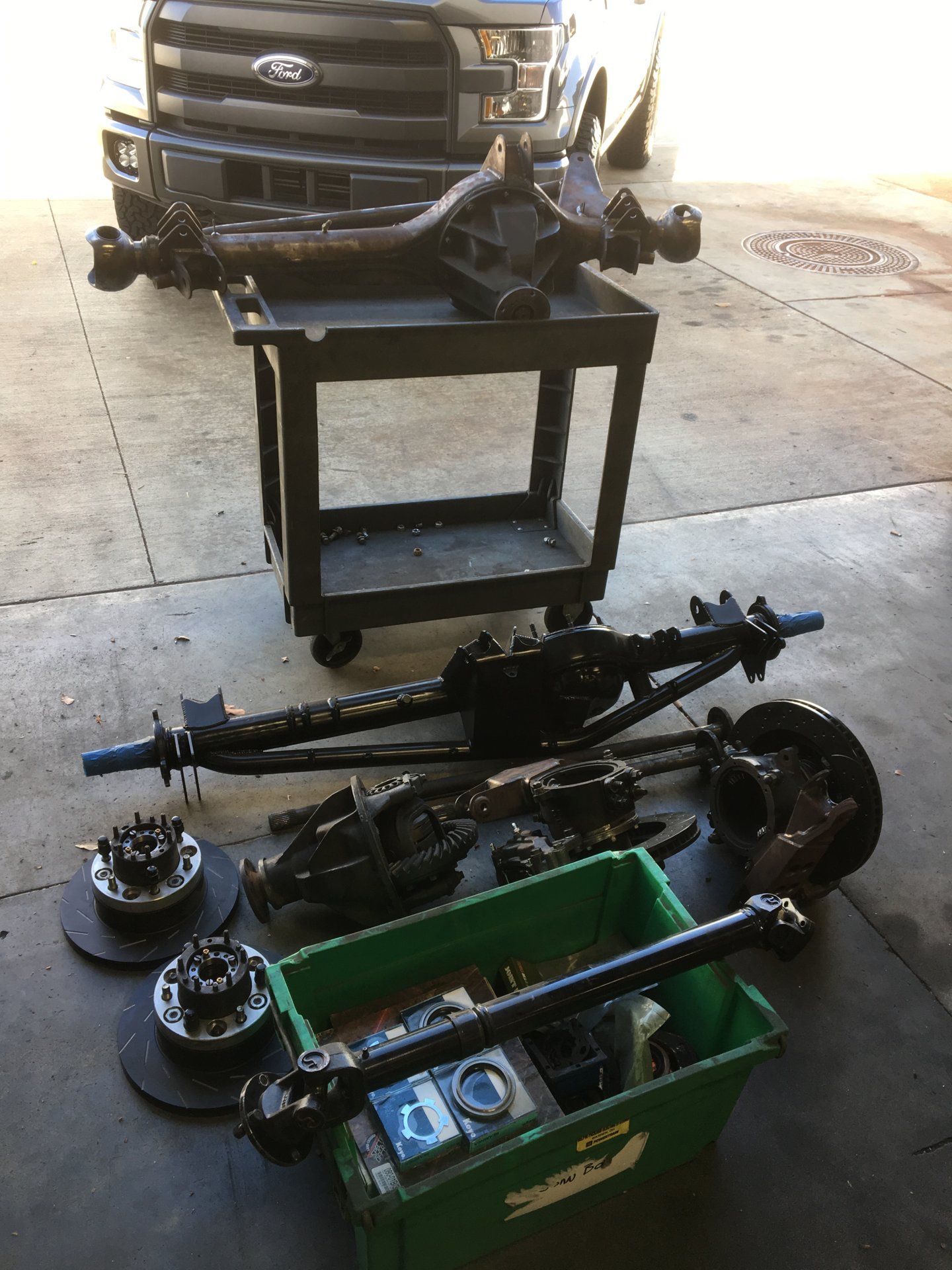

Pat, what are the details on flipping the knuckles and adding width with the big brakes on the front axle? I have never heard of that mod before. I'm waffling between building an 80 axle or modifying my 60 axle for more width to match a narrowed tundra rear axle on my crawler.
Big break kit from Redline. Flipped knuckles to get calipers in correct spot to fit the modified hi-steer. I’d probably do an 80 axle if I were to do it again. High pinion diff more crawl clearance. I’m trying to come up with a big break set up for the 80 axle that I can use on this pig too. 14” rotors.

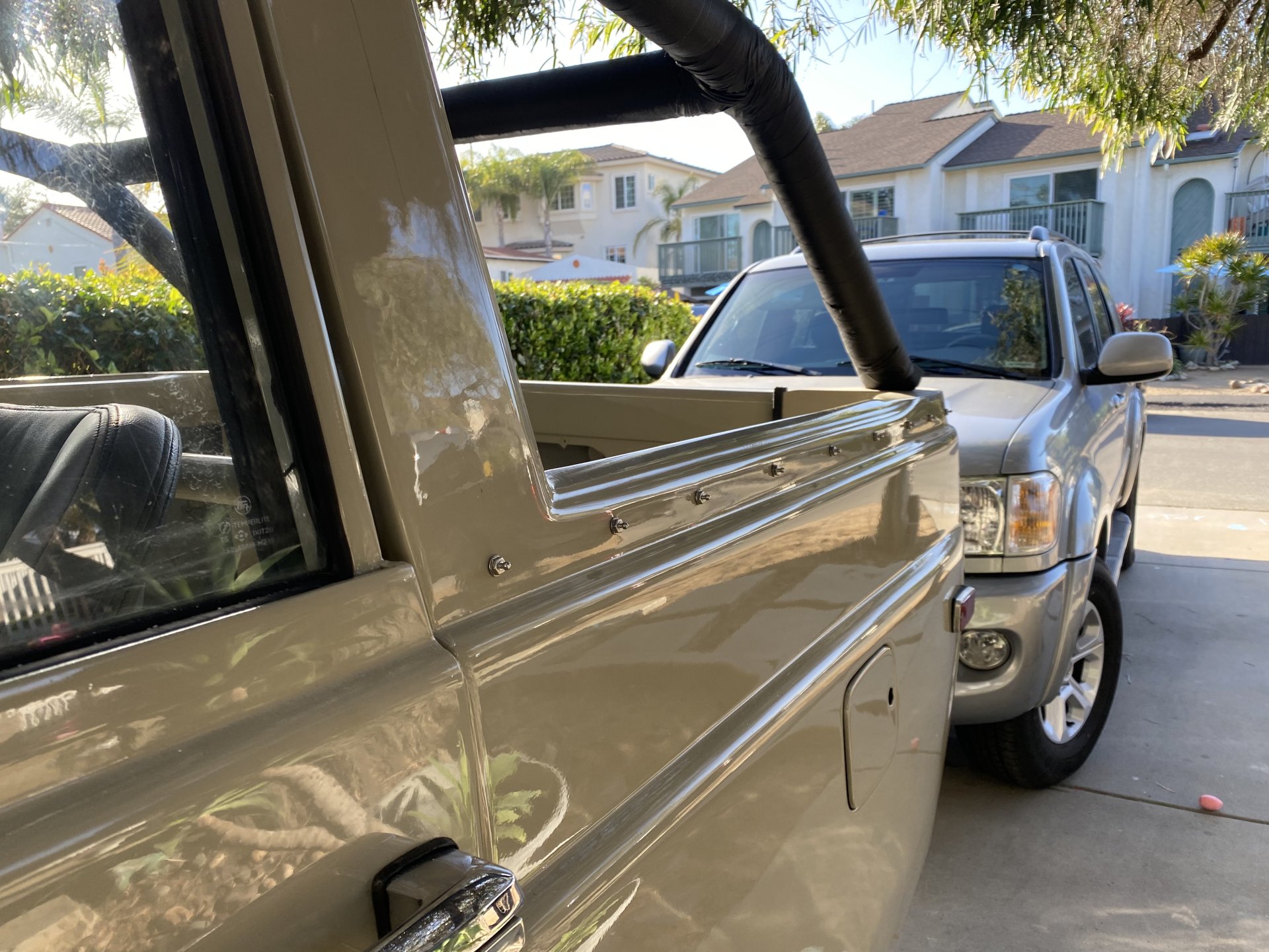

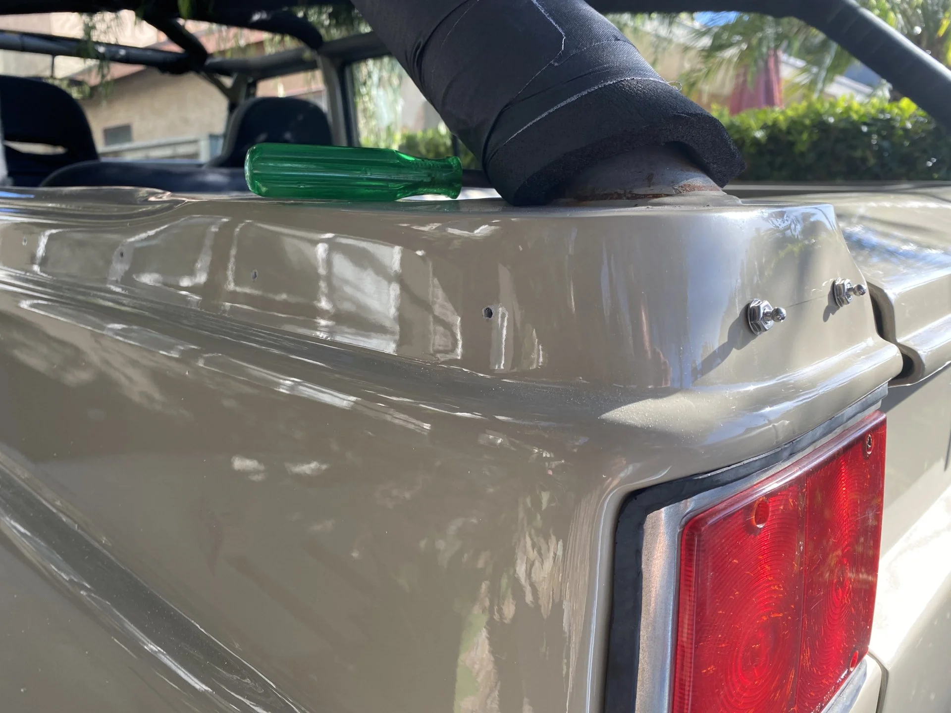

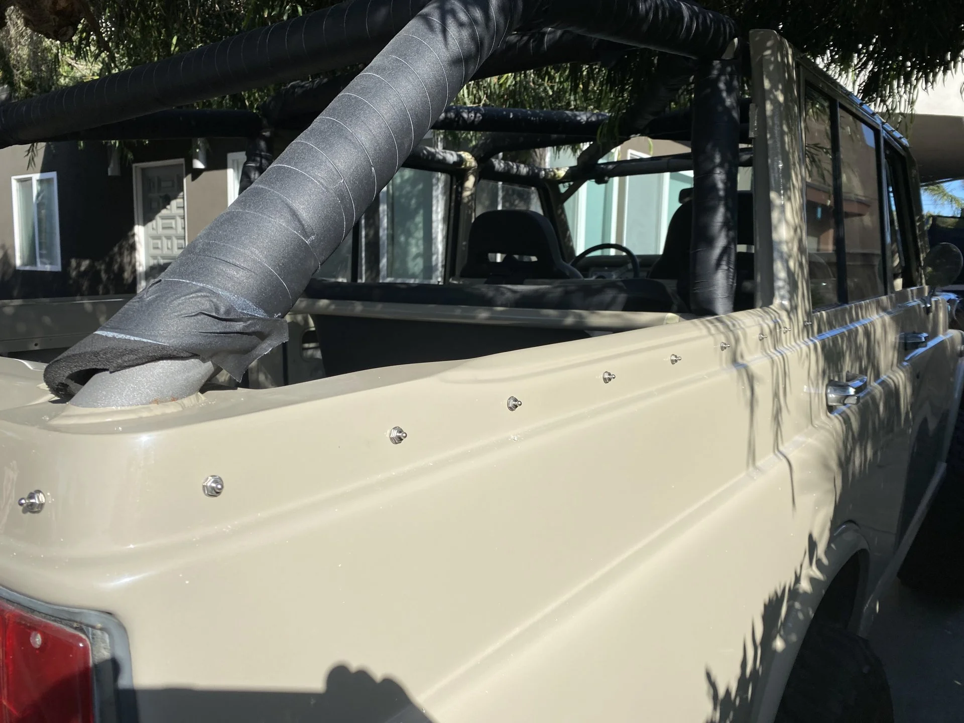

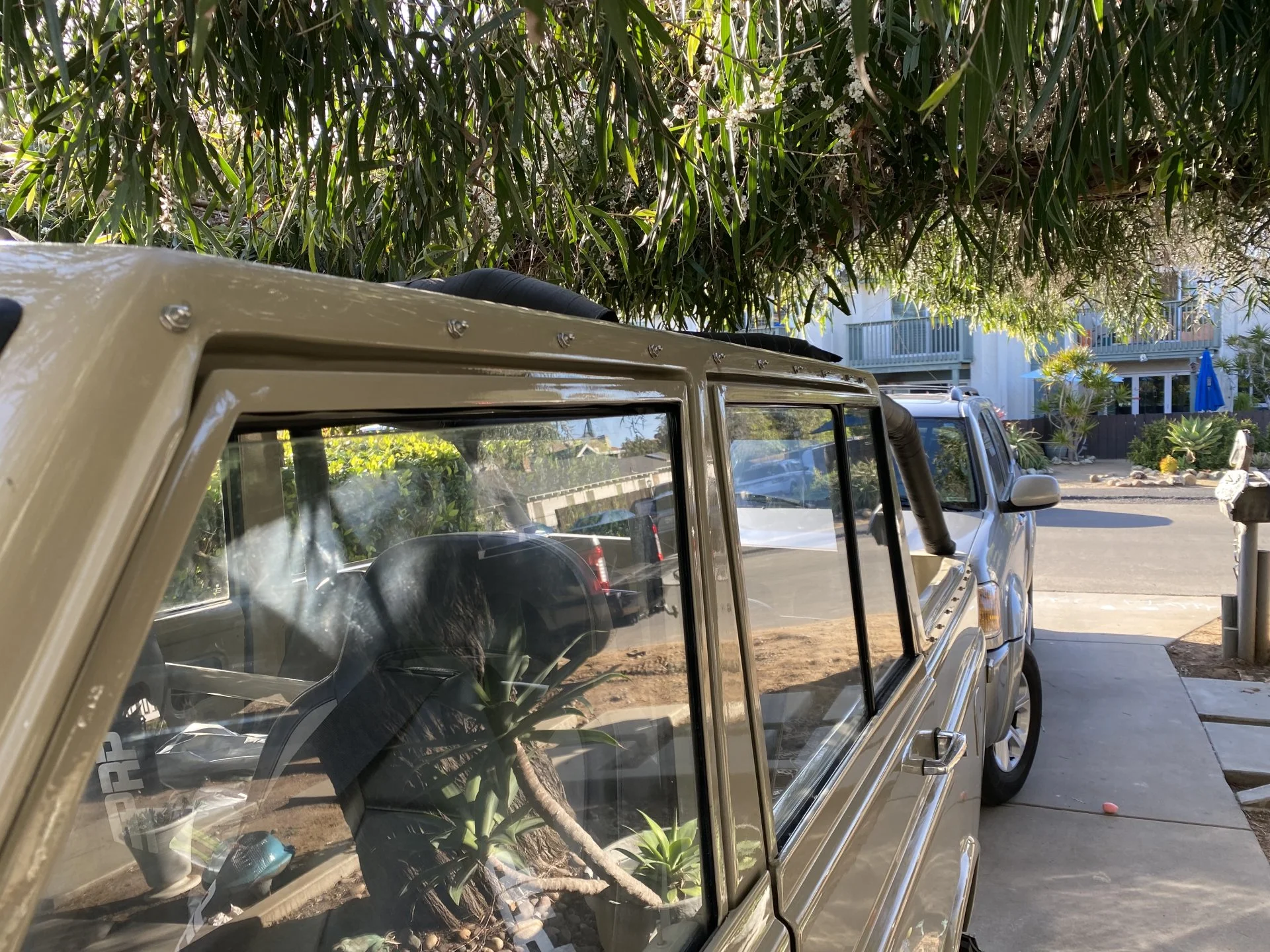

Soft top snaps installed on body. Now the soft top can be made to line up with these.
