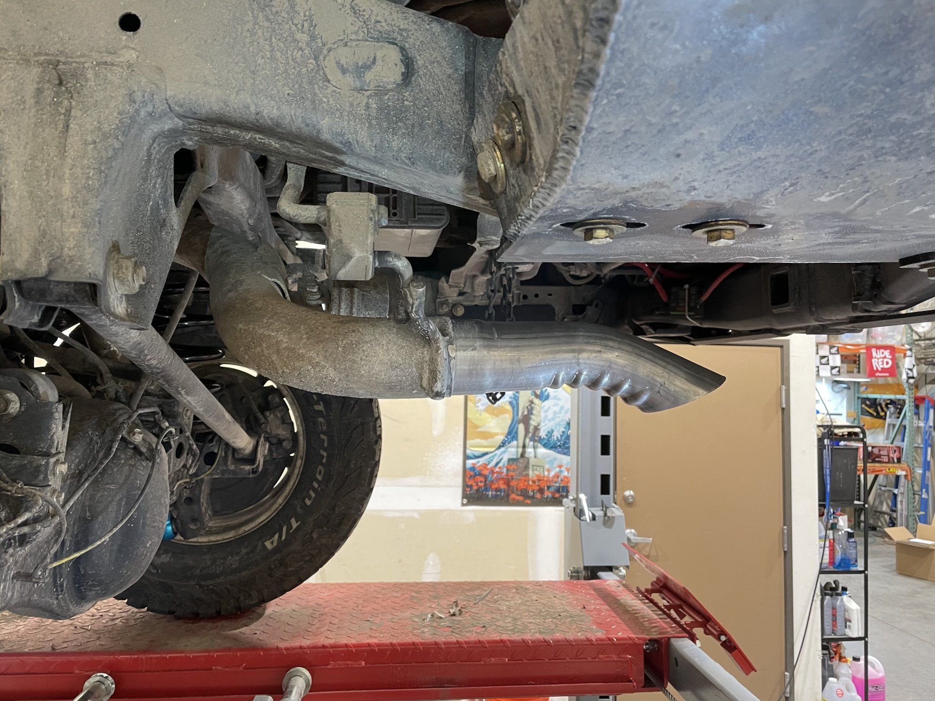

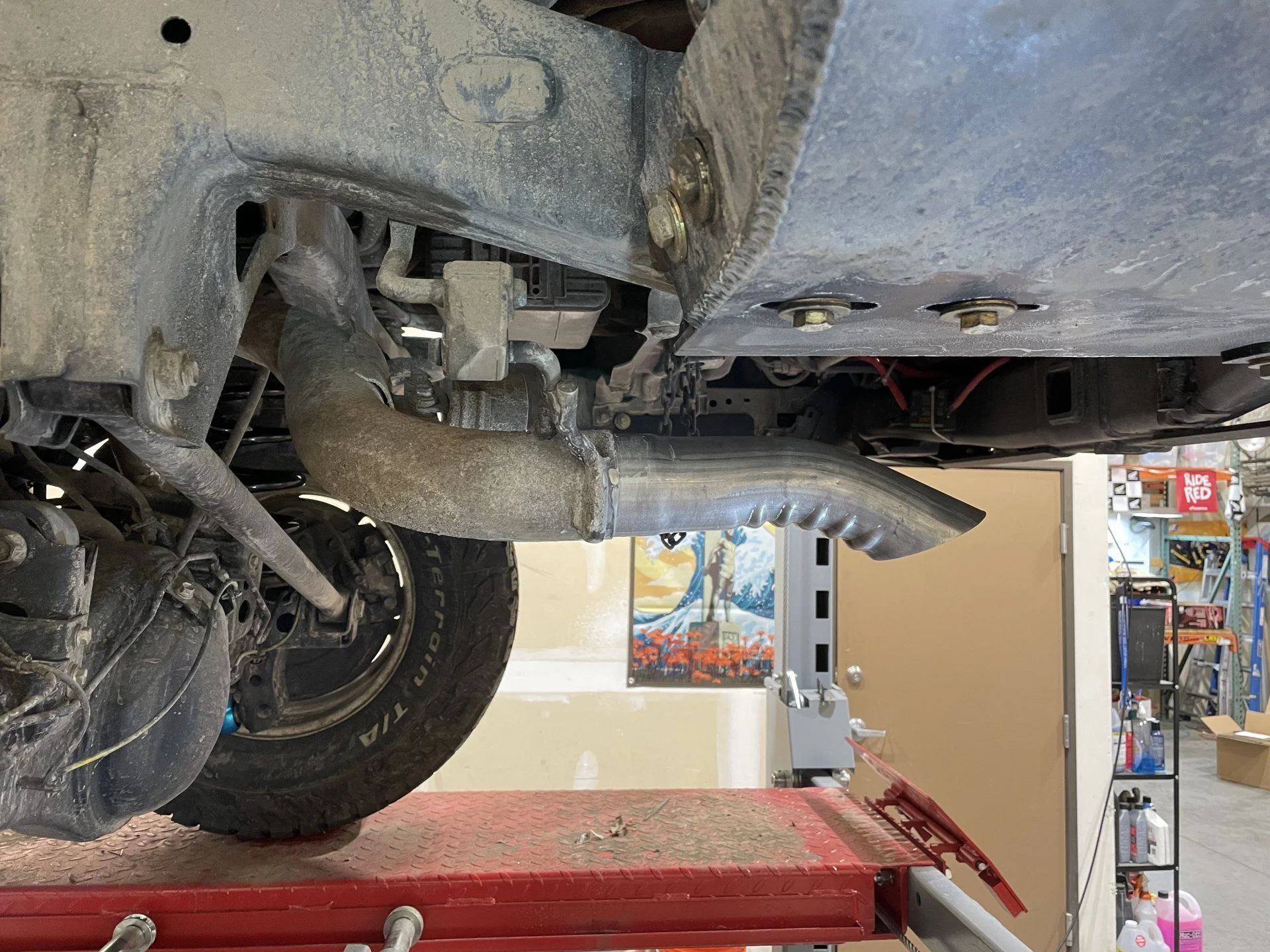

Joined the club a few months ago. I crushed the resonator tip in Moab last year, but it got the axe (technically sawzall) during a Dissent rear bumper and LRA install. There is absolutely zero difference in sound. A lot different than an 80 series, where a resonator delete gives you a very annoying turbo whistle.
I was going to leave it straight cut until I towed a 6000# camper all of a few miles this past weekend. I noticed a burnt rubber/plastic smell and the bumper area directly in the path of the exhaust path was VERY hot. There are a lot of important wires in this area so a turn down tip is needed. Under normal driving, even on 400mi road trips, it never got that hot, but heavy towing is a different story.
I like to DIY everything, but to properly weld stainless, you need a helium based tri mix gas for MIG. I have 100% argon for TIG, but am not great at TIG on a radius and upside down under my truck. I went to the local weld supply shop and they only sell the giant tri mix bottles for like $700. Went to a local exhaust shop and they wanted to MIG on an aluminized steel tip, likely with some ER70s-6, which defeats the whole purpose of a stainless exhaust.
Thanks to a little internet searching and Amazon, it looks like flux cored 308L MIG wire works just fine with the C25 (75% argon, 25% CO2) bottle I have already, giving you a strong and corrosion resistant weld. Probably not as pretty as non flux core 308L using tri-mix gas, but who cares, its an exhaust tip.

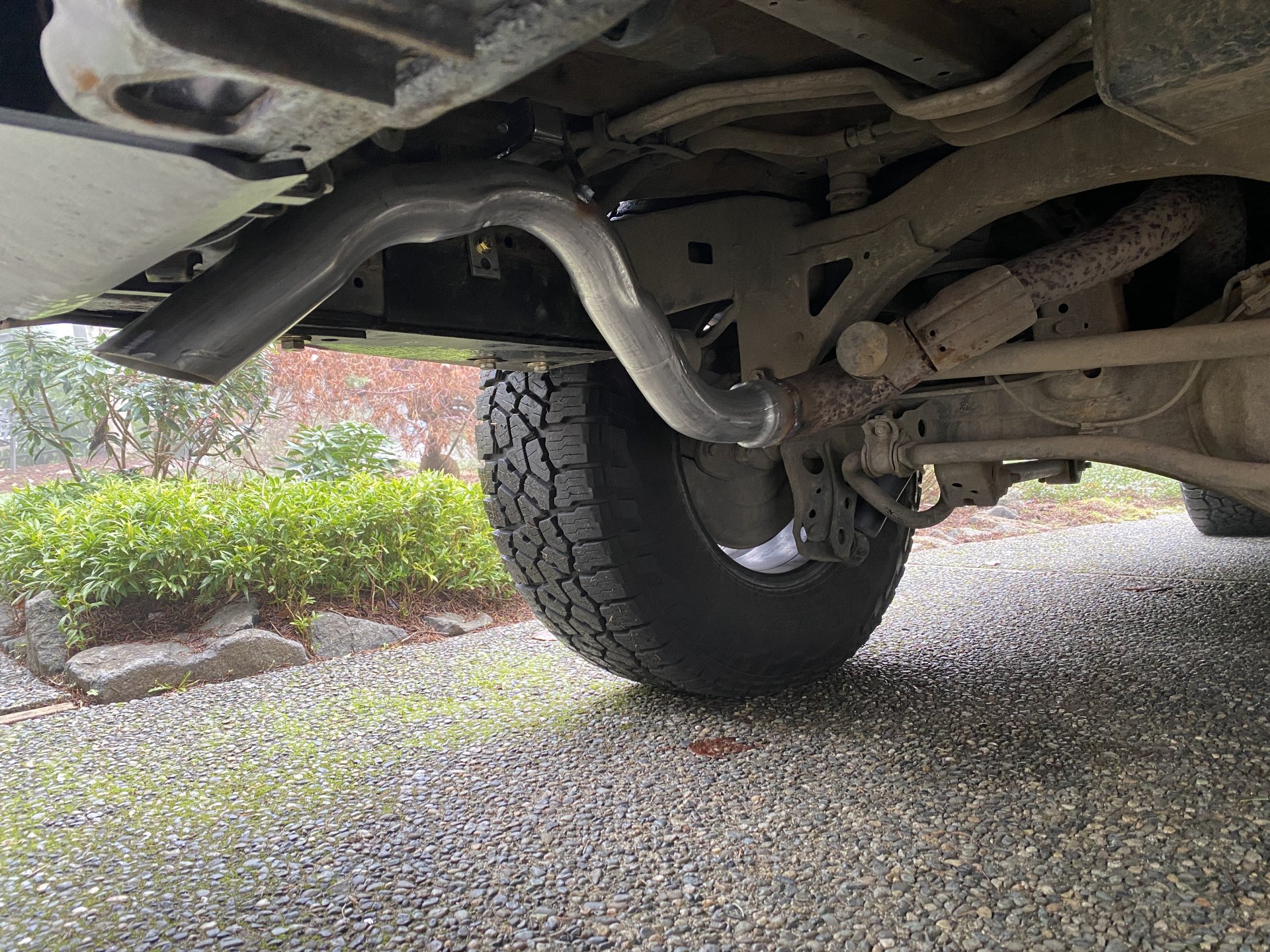

Its done. Stainless is definitely harder to work with than mild steel or even aluminum. Pretty hard and brittle.

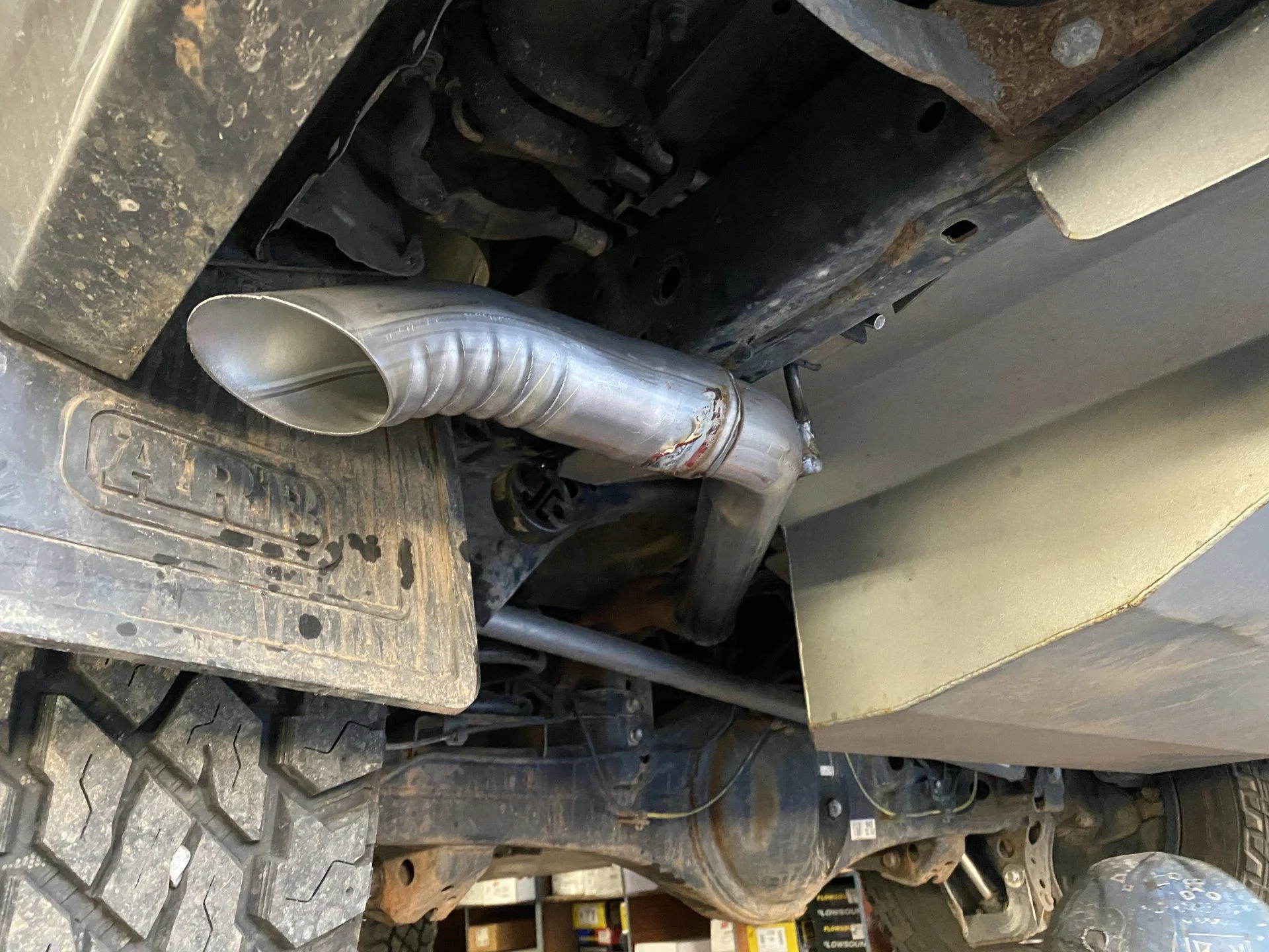

For those who have yet to cut the resonator, see the first photo. Do not cut it this close. It makes attaching a tip harder. I had to remove one of the hanger connections to give me enough room to work with.
Metal chop saw made short work of this.
Even though I was running settings for 16ga metal and going very slow and doing small tacks, then connecting them, I was still burning through. 0.030 wire was not helping, but I could not find any 0.023 flux core. Going to the settings for 18ga made a big difference. No more burn through, but not the prettiest looking welds either. Few minutes with a flap disc took care of that.
I angled the tip down and to the side. It is probably 6 inches past the rear tire. I will monitor its pressure and temp when towing this weekend, but do not think this will create any issues.
Total cost: $70 in parts/materials.

I made that mistake of cutting it too close

Just cut it. I cut mine last year and put the factory tip back on where I cut it to turn it down. 5 minutes of time and $0.. zero effect on noise level towing, zero fumes. Honestly no one has noticed but me.
No more leg on fire as it’s running and I’m at the back. Towed 4500 miles like that in one whack.
The fan is still louder on startup. I would be willing to bet if someone did a decibel test on a start from 3’ behind the tailpipe on the ground that the levels would be 98% the same.
I was skeptical about cutting mine but I 100% do not regret it and am actually 200% satisfied I did. I’ll grab a picture of my free work when it’s daylight enough.

We did about 300mi towing a 6000# trailer and had no issues with either drone or heat. Average elevation was around 6000' and outside air temps varied from 65-75 degrees. I was just slightly concerned that the angle of the tip would heat the DS rear tire, but did not observe that while towing. I did not use a pyrometer, but based this on the TPMS readings, which did not change from DS rear to PS rear. The only change was about 1-2 psi depending on which side was in the sun. I did pull over at the top of a long uphill grade just to feel the rear bumper and both sides felt about the same, neither was uncomfortably hot to the touch.
Conclusion: resonator chop with a redirected tip has almost 0% impact on audible noise or increased temperatures....but chop with no tip does heat up the rear bumper area enough to get a "melting plastic" smell. This was only noticeable to me when towing, before adding the angled tip. Others have also reported issues with lights and wiring melting without a redirected tip.
