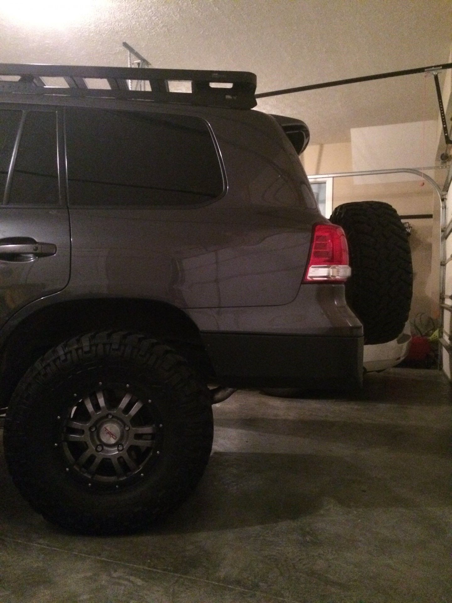

There's a photo of mine in this thread: Builds - indycole's 2016 200 Series Build and Retrospective
I'd echo the point above about having a way to route the exhaust down and toward the side of the vehicle. Otherwise, I'd be concerned about the amount of heat radiating on the bumper. I know it was enough to melt some aftermarket combination lights on TonyP's bumper in Mexico.

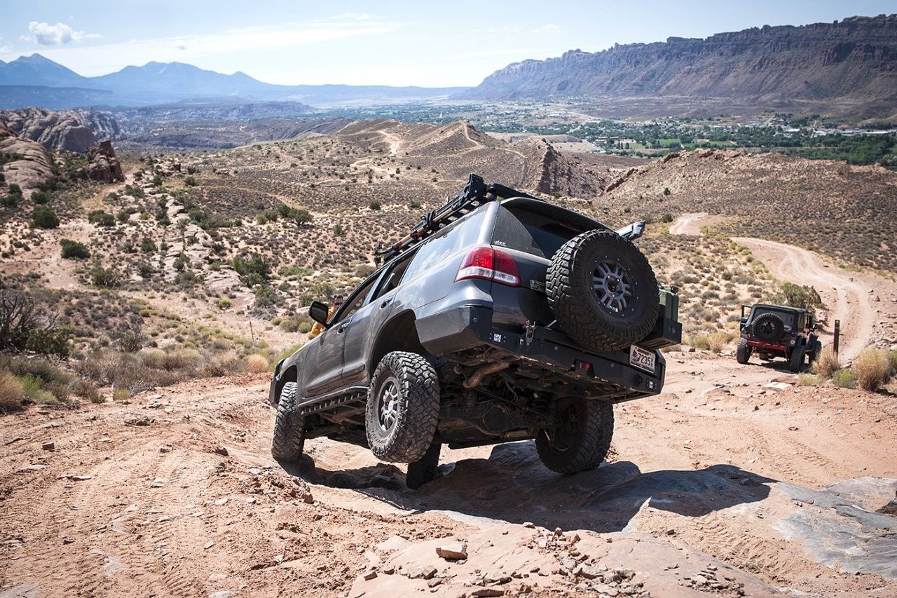

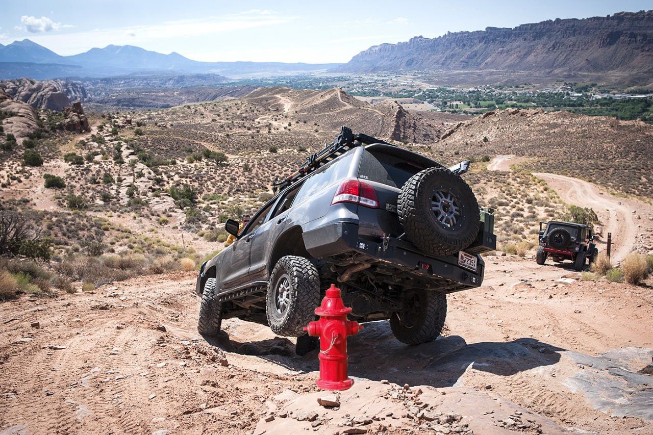

looks way better to if you have a high clearance rear bumper. attached is before and after and then bottoms up shot for a better reveal.

weeeeeeeee!
Nice job fixing the picture
@Willy beamin thanks for the pics!
