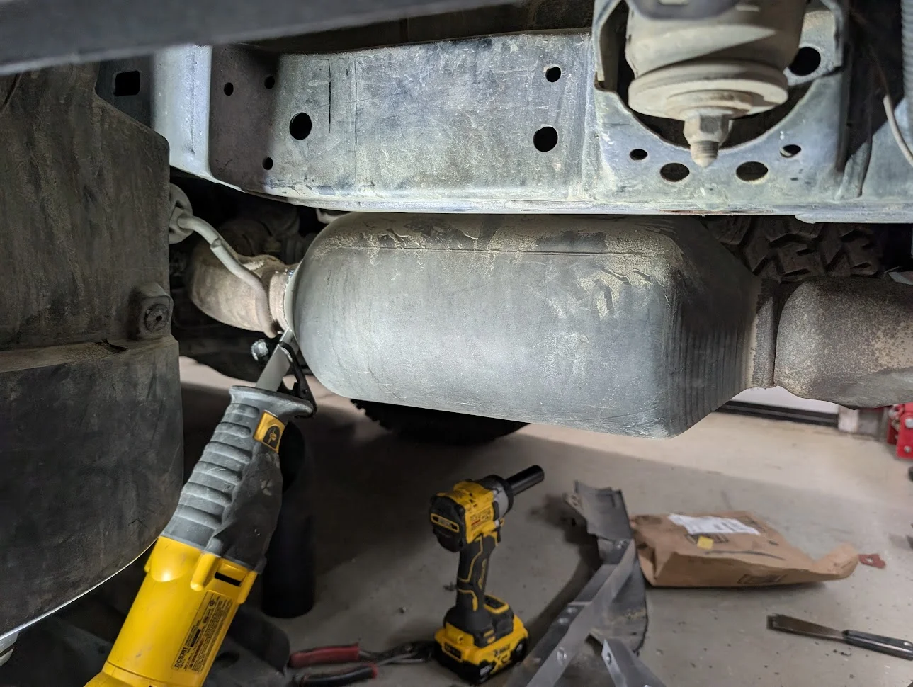

Did you just take a saws-all to it? or a cut off wheel?

I used a sawzall. Super easy no welding necessary way

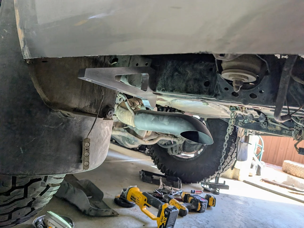

As mentioned, I choose to delete the stock muffler/resonator to save weight but also maximize the newfound clearance. I also destroyed the tip of my OEM muffler so it was already vulnerable. This is a pretty quick install in under 1 hr. Almost zero perceptible sound difference with maybe a bit more airy sound at over 4.5k rpm at high load. Great longer thread here
Cut the stock muffler 3/4" aft of the hanger which is past the weld bead. Use a sawzall with a long metal blade. It'll cut pretty easily. Goal is to leave enough pipe to clamp a 3" aftermarket turndown tip to. This one on Amazon works great - https://www.amazon.com/dp/B07QVCJFYD?tag=ihco-20
Where it's cut, will almost be a double layer as it'll have a portion of the sheetmetal of the muffler. Remove the muffler sheetmetal with a grinding wheel on an angle grinder, which will clean up pretty quick, bringing the OD to 3" so the new muffler tip can slip on.
I opted to clock the top towards the drivers side slightly so the exhaust takes the closest path out from the underbody.

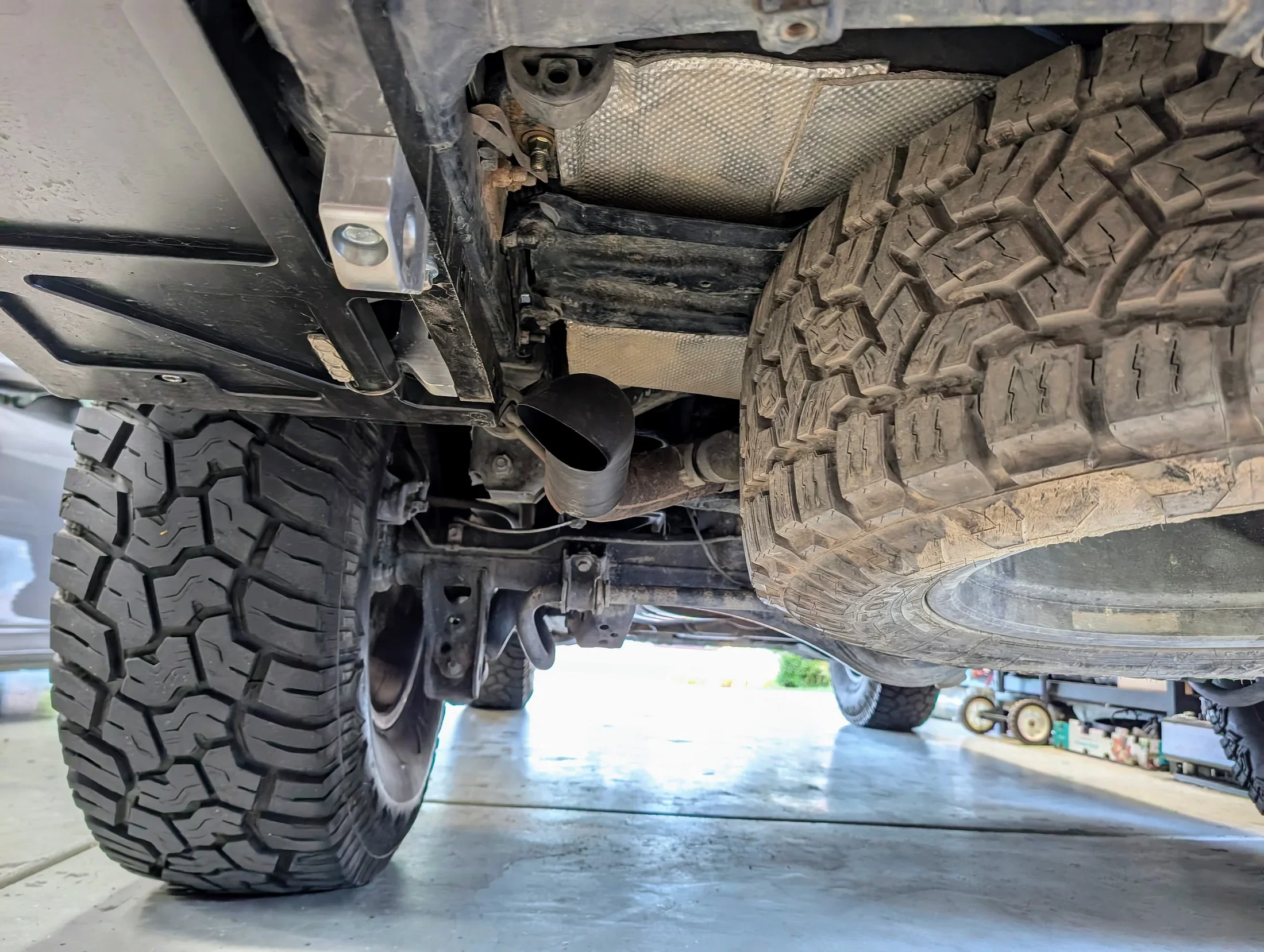

I followed @radman with post #23 to land the exhaust between Dissent bolts and also @DesertLC with post #35 for an extra support hanger. I asked for a little bit of an angle shooting backwards just like @timmbuck2 in post #69 (shout out to him and Radman with Dissent ideas). Thanks all for being trailblazers and offering up pics and guidance. No more burning legs camping, loading bikes, changing out of snowboard gear, and the list keeps going. I hear zero sound difference and goofed around on the drive home to try and analyze noise and nothing.
