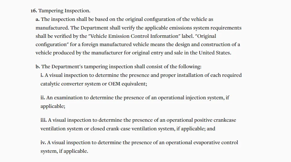

This says that Full Time 4WD vehicles that are not OBD are required to pass the idle test, the gas cap test, and the tampering test. And if we go to C.16 it says this:
Under b) it says that for tampering they look for the i) catalytic converter, the ii) air injection system (if there is one -- and I think this is talking about smog pumps), iii) PCV valves, and iv) evap control systems.
This basically corresponds to what was on the computer screen at the emission test facility.
Now it does reference the emissions label in a), but it doesn't say that they actually look for everything in the label---it only says they look for what is in b)
Jared
So in summary, I still don't see any evidence that Arizona looks for PAIR valves when doing emission tests in OBD1 land cruisers.

PAIR is a type of air injection. Therefore part of the inspection.
sjpitts like Cruiser Dan just told you above, the pair system is a type of air injection system, so that would make it required emission equipment for your truck. But if you really want to find out, why don't you call the Arizona Dept. Of Environmental Quality and ask them this question. Seeing as they are the ones who set the rules and standards for all emission testing done in Arizona. They would be the definitive source to give you the answer you are seeking.
16 a says it all
