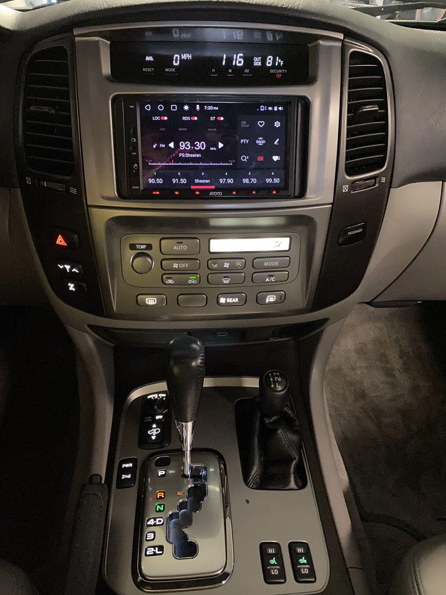

Since I couldn't find a good thread on how to change the micro rectangle dash bulbs, I figured I would do a quick write up. Hopefully the pics will do most of the talking for me.
Carefully pry the brown lights from the control panels. The tabs on the board are pretty strong but they will bend if forced. Straighten the light wires and pull out of the base. Insert the new LEDs, wire first, bend and snip. Reinstall.
These are the bulbs i used. I chose white but they come in many colors. They do dim on demand. The radio lighting is dimmer than everything else due to the design of the plastic beneath the surface.
