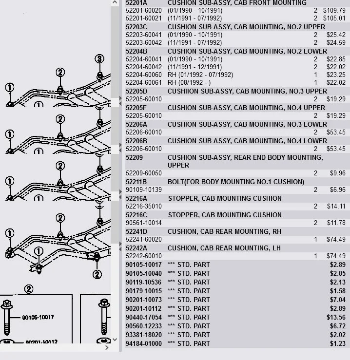

Would appreciate someone double-checking me on the list below:
body mount (under front seat feet)252203-60042
body mount (under front seat feet)252204-60042
body mount (under rear seat feet)452205-60010
body mount (under rear seat)452206-60010
body mount (outboard of rear springs)252209-60050
body mount (rear of frame R HDJ81)152241-60020
body mount (rear of frame L HDJ81)152242-60010
This is a complete list of all mounts and hardware. I replaced mine a week ago.

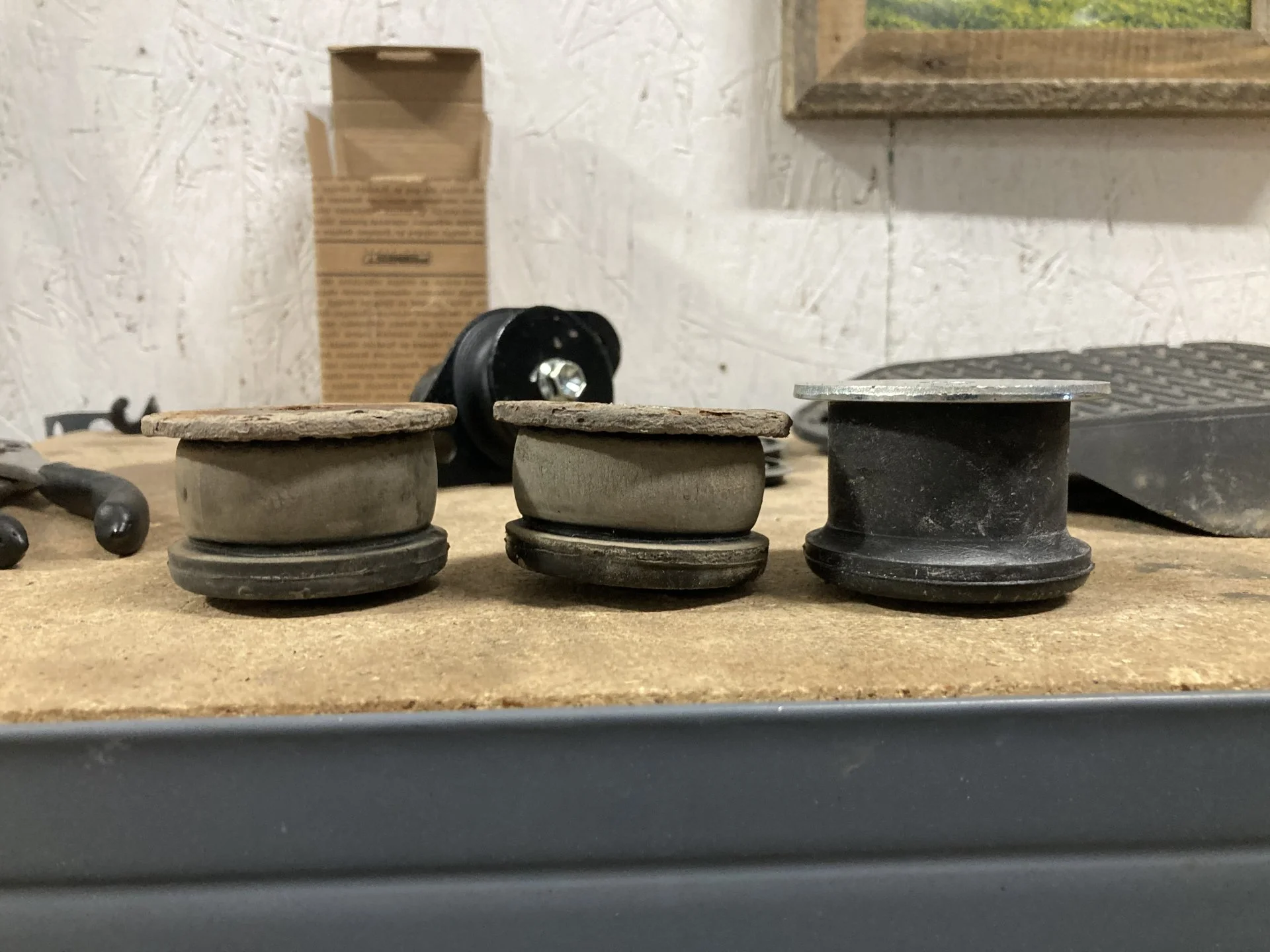

Those do not look like my rear cushions.
My pic is of the ones that are just forward of the ones I assume you’re talking about. They’re close to the middle and front seats. I still need to replace the ‘cushions’(ones that free float and are just sandwiched in between the body and frame with no steel or bolts just forward of the rear body mounts).
Those small cushions are held to the body by a bolt with a 12mm head.
Hmmm. I don’t doubt that. But mine aren’t 😆 there is a bolt screwed into the body, but on mine it just keeps the bushing centered . . .🤷‍♂️
Does this mean you won’t be able to install that cushion? Not really picking up what you are putting down.
