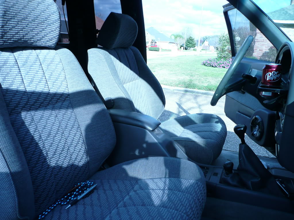

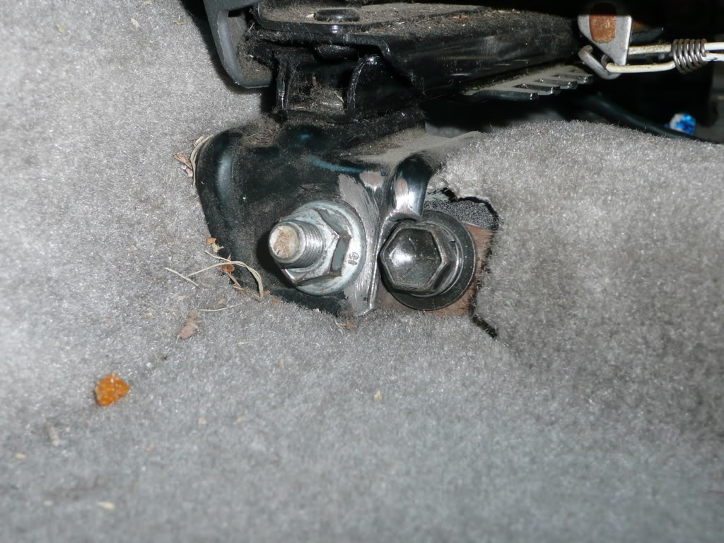

i have done it... i bought some sr5 bucket seats off of ebay i think they were for a fourrunner. the passanger east bolted right in but the driver didnt.
to make it fit all i had to do was make a bracket that was approximatelly 3 inches long. i welded a stud on one end and drilled a hole on the other. because the seat whole and the whole in the body were so close i had to use a die grinder and notch the front bracket so that the seat bracker wouldnt get in the way of the bolt that mounted the 3 inch bracket that i made to the floor. using the end that i had welded the stud on, i slid the seat onto the stud and bolted it down... i had to do this for both front and back. i can get you pictures if you would like. it was very simple and it looks great, it all is hidden under the carpet or under the seat.
oh! i also bought the fourrunner center console to fill the void in between the two seats... once again, bought it on ebay! looks great and wasn't difficult to figure out how to mount.

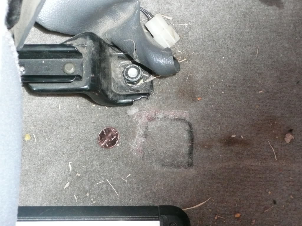

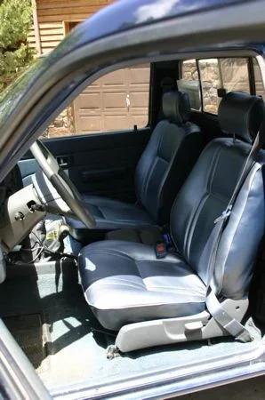

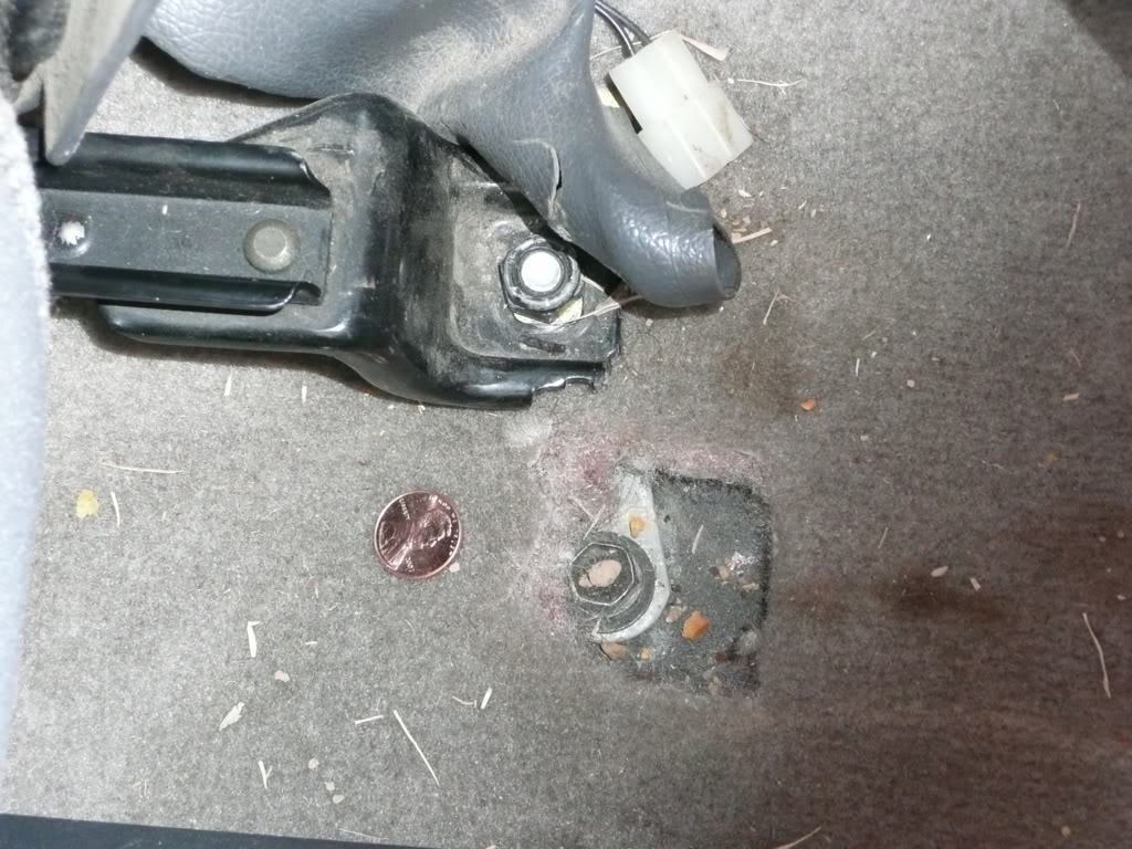

I swapped the bench in my '91 standard cab to buckets from a '92 4-runner.
All 4 bolts will line up on each seat mount, however the inside front hole is a plain hole--and mine did not have the captive nut welded on at the factory. But the bolt hole itself lines up. Easy enough to weld a captive nut back there, or just cut a small hole in the carpet back there and put a standard nut on the bolt.
I love the buckets.
Upholstered by my mother!

sorry about that... well here they are! o and sorry about the really dirty carpet.
Yep, the legroom is pretty much the same. But I've got more than enough (seat all the way back), even with a 10" sub in a box behind each seat. And the jack and tools are in the stock locations. But I don't have an easy place to keep my jumper cables now. :)
T-nick: love the SR5 seats and console. Looks awesome.
