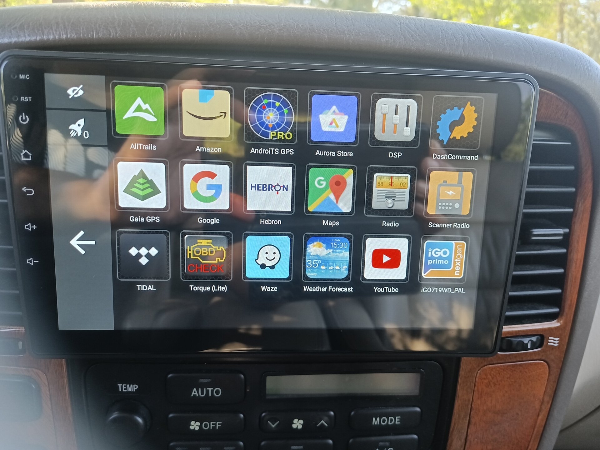

I've got an '01 that came with nav and I went through the conversion process. The only tricky part was sourcing a bezel from a non-nav cruiser. I had to call a couple junkyards to find one that also could come with the wiring harness. I did the actual work in an afternoon while my one-year-old took a nap. All the info you could need is in this thread: Pre-03 Nav delete how-to
It's easier with a non-nav truck, for sure, but if you find something that checks every box except has navigation, I wouldn't let that deter you.
Thanks so much for all the responses!
Plenty of room under passenger seat after i removed factory amp, ran new connections down through center console, reused factory speakers/wires and some others that were already down there. Removed the passenger seat during the process, (be careful not to nick up interior door surfaces when doing so!)
