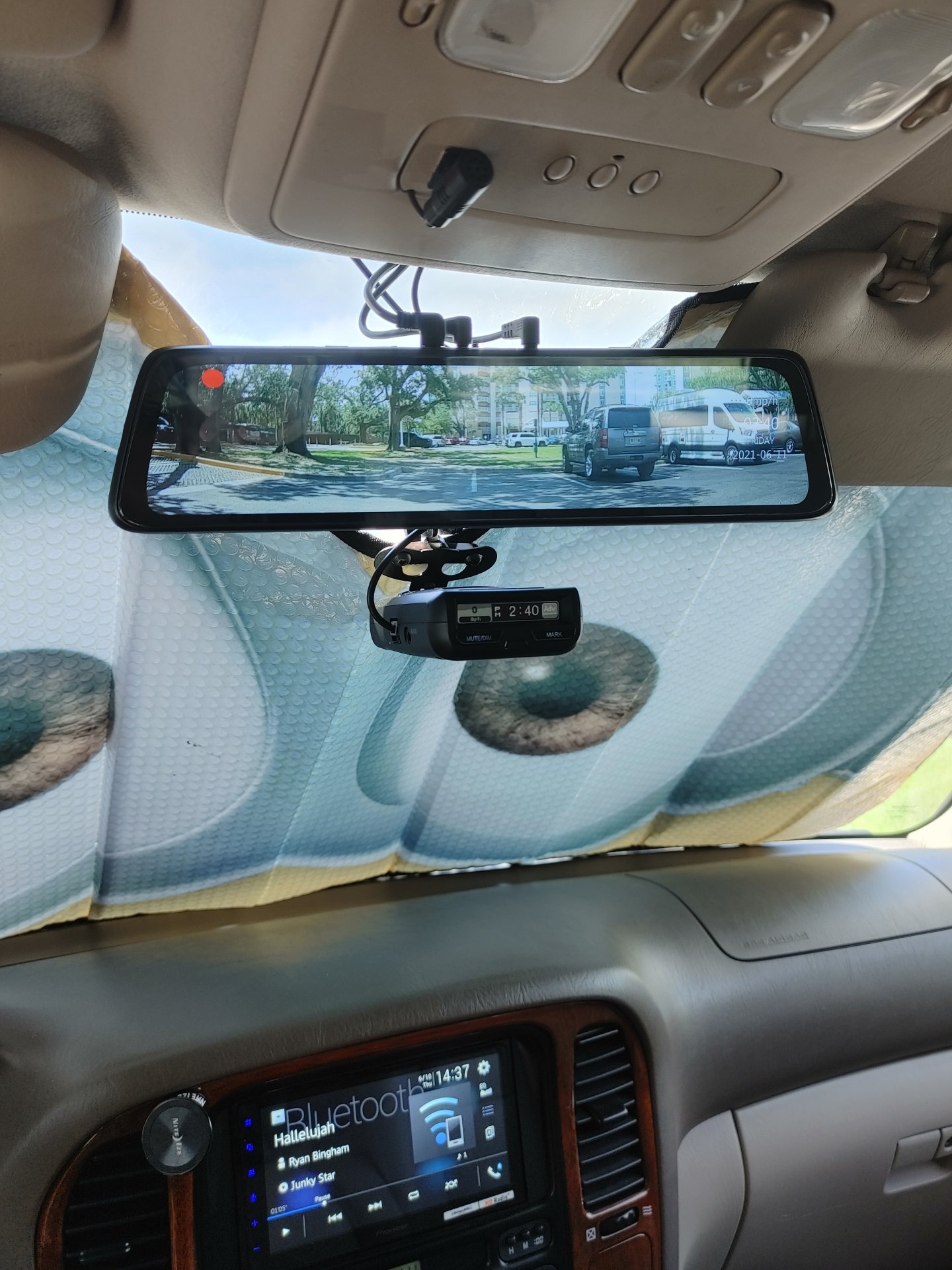

I have an 01' non-nav with ML. Bought this kit Beat-Sonic SLA-100/82AAD - https://www.beatsonicusa.com/stereo/stereo-installation-kits/toyota-lexus/landcruiser-lx-470/1998-2002-landcruiser-lx470/beat-sonic-sla-100-82aad.html and kept all the factory speakers and sub. Just re-coned all the speakers. I'll eventually change them all out with aftermarket amps /speakers ..once I get the drivetrain and suspension up to snuff
