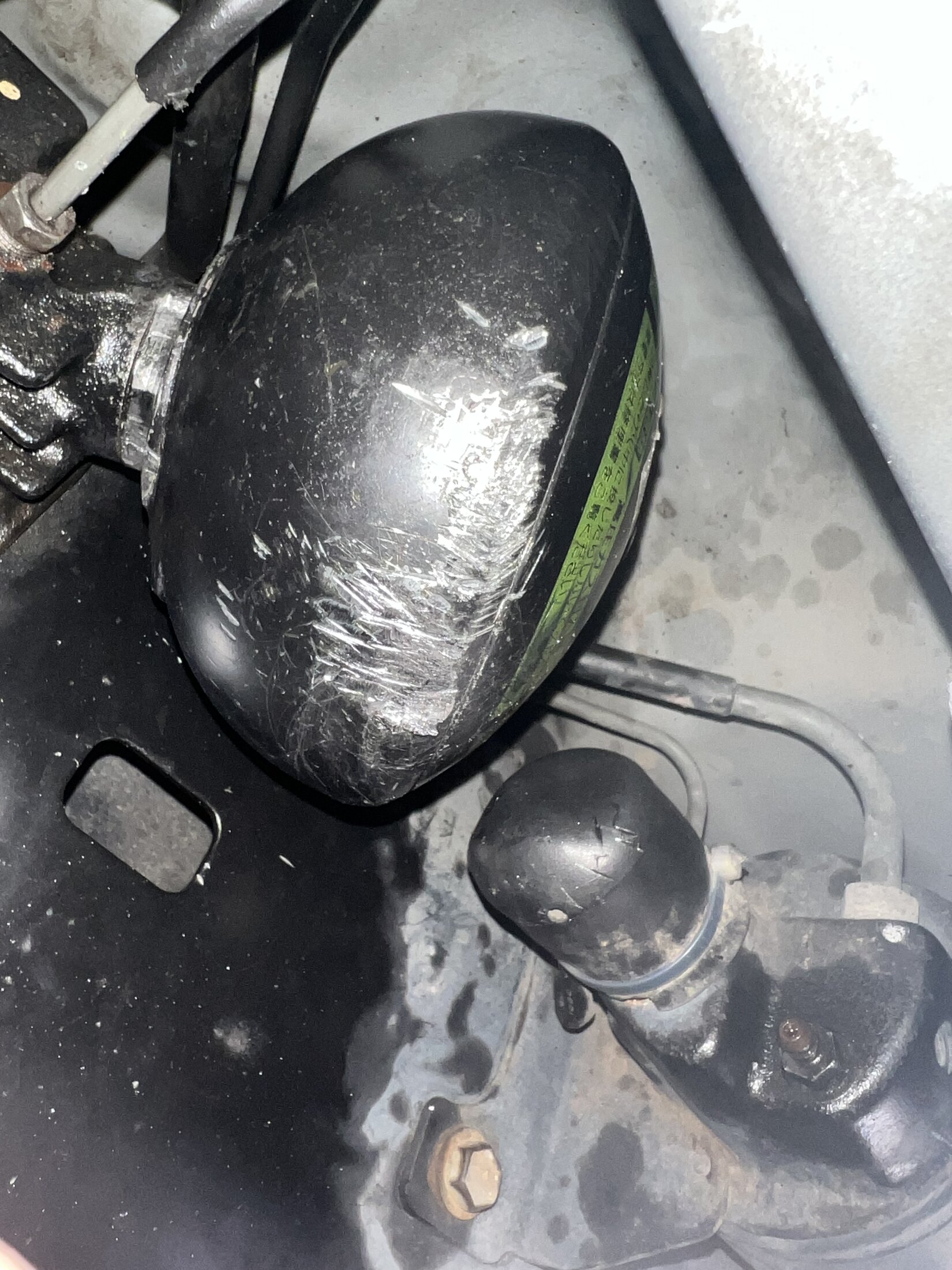

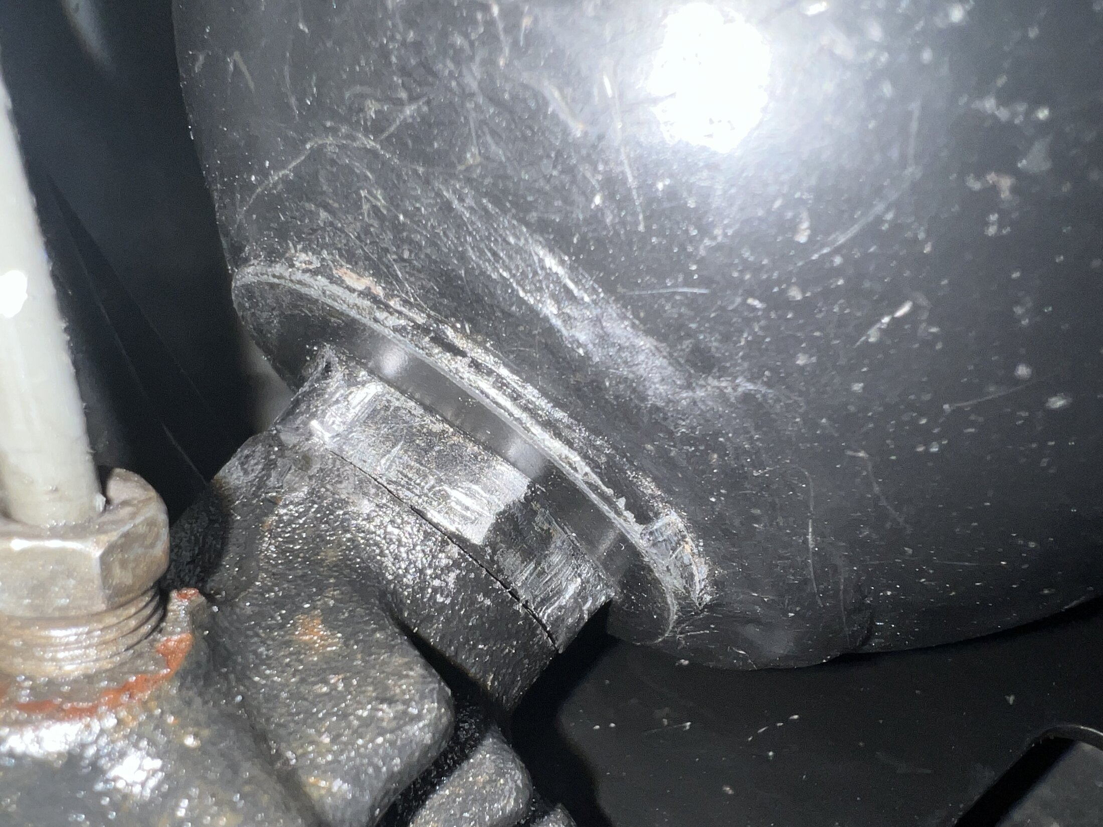

Replacing globes on my 2003 with 183k miles and the last one driver side front is seemingly welded on and completely rounded off. Other three came off easily with just a 36mm wrench. Truck has no rust so most times things just come off. Have been going with hammer and chisel for 2 days with WD40 in between sessions. Any advice?

ClassyJalopy responded to a post I made on Nov. 11th saying that he drilled through the globe and put a screwdriver through it then used a ratchet strap to break it free. He's included a couple of pictures to that post on Nov. 11th. I can't vouch for whether that would work or not, but you may want to reach out to him for pointers. I had a rounded off caliper bolt on my brakes and I had to take a file and file down clean surfaces for a wrench to get purchase on. I wouldn't recommend that. It was an aggravating process, but it worked in the end. Took about 3 or 4 hours of filing.

A good Neighbor saw me struggling and offered to drive me to the hardware store right before it closed and bought a bigger sledgehammer and it came off. If you’re struggling just get a bigger fcking hammer…
Thanks for the help and also I bought one of those chain wrench’s and it doesn’t fit around the driver side front on the back side next to the frame just in case someone was gonna go that route to get it off.

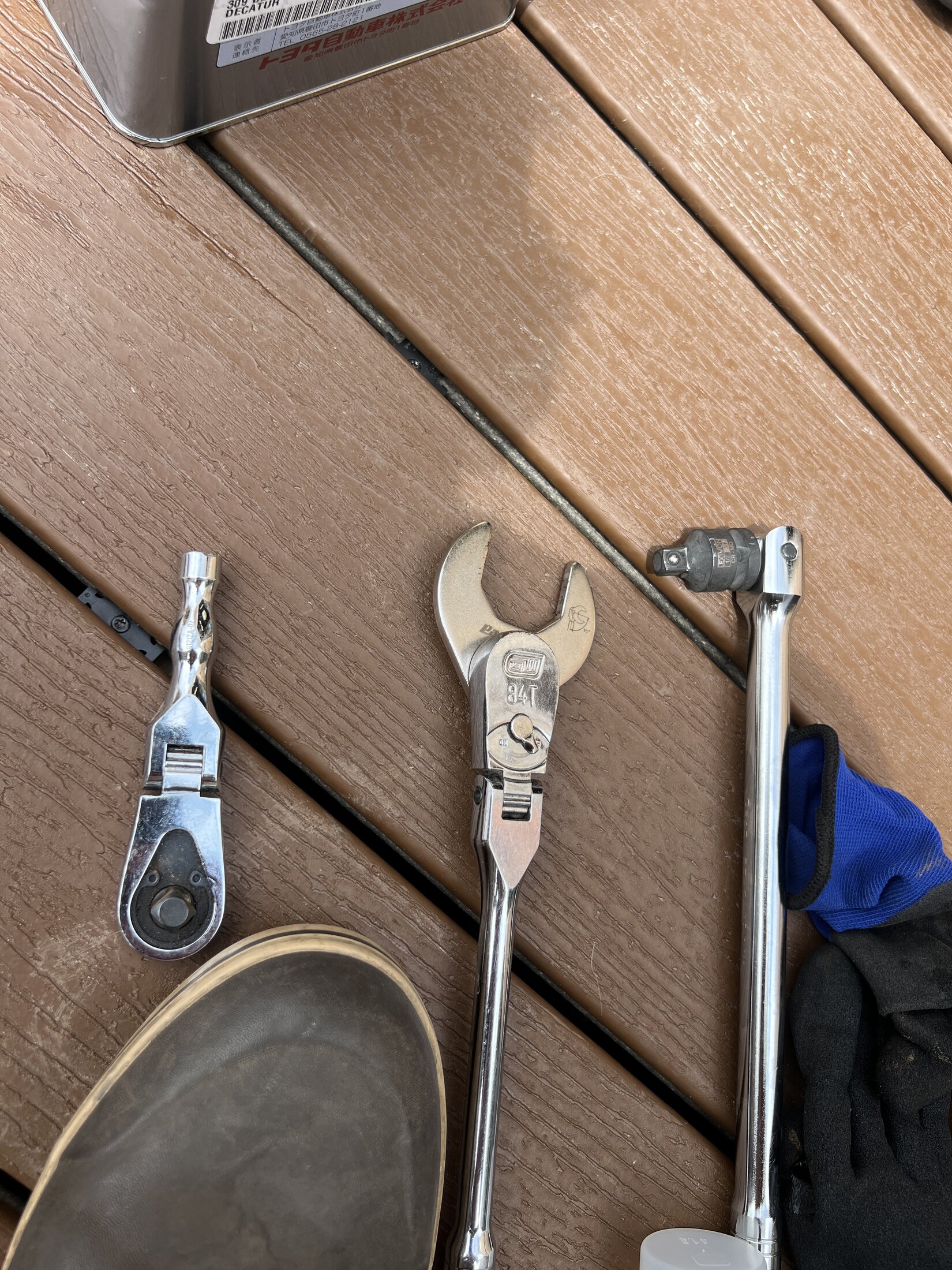

I just wanted to report my globe replacement based on this thread. The 36mm fan wrench worked really well, made the job so easy. None of my globes were hard to unscrew at all. I had them all replaced and bled in less than an hour.
Results: It drives so much better than i was expecting. There is less random rattling from around the vehicle, the suspension feels so much more fresh and solid, and oddly enough even the steering feels different. This was done on an '07 LX470 with 200k and globes were replaced with new OEM parts. Feels like a new vehicle!
I just completed mine a couple days ago. This tool worked like a charm. No strap wrench or chisel needed!
Used a regular 3/8 drive ratchet, I think a standard 3/8 drive breaker bar may have been even better but I didn’t have one on hand.
Had to stop a couple times and triple check I was cranking the correct way to loosen, could see how it would be easy to mix up, depending on your orientation to the globe and your wrench positioning.
Used this to break each globe and then removed by hand.
