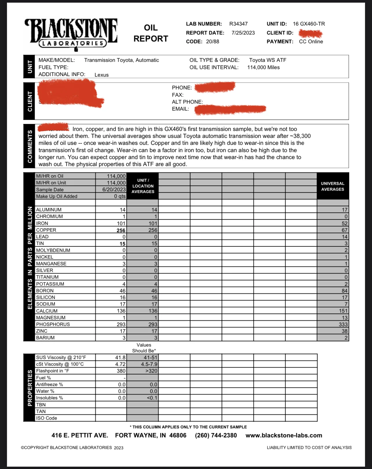

Anyone sharing these in a specific thread? I changed my trans fluid at 114,000 miles for the first time and thought I would share. No problems before or after - feels like smoother gear changes now but could be in my head.
