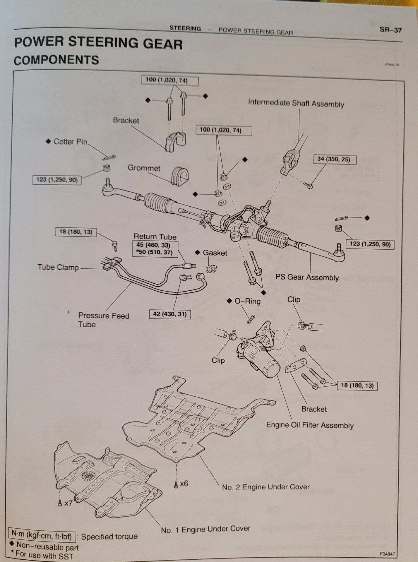

Does anyone have the FSM page for the older style rack with the PS D bushing and the two DS donuts? I only have the 2003+ one and I wanted to confirm the torque value for the 4 bolts on my 2000 year one.
Thanks in advanced.

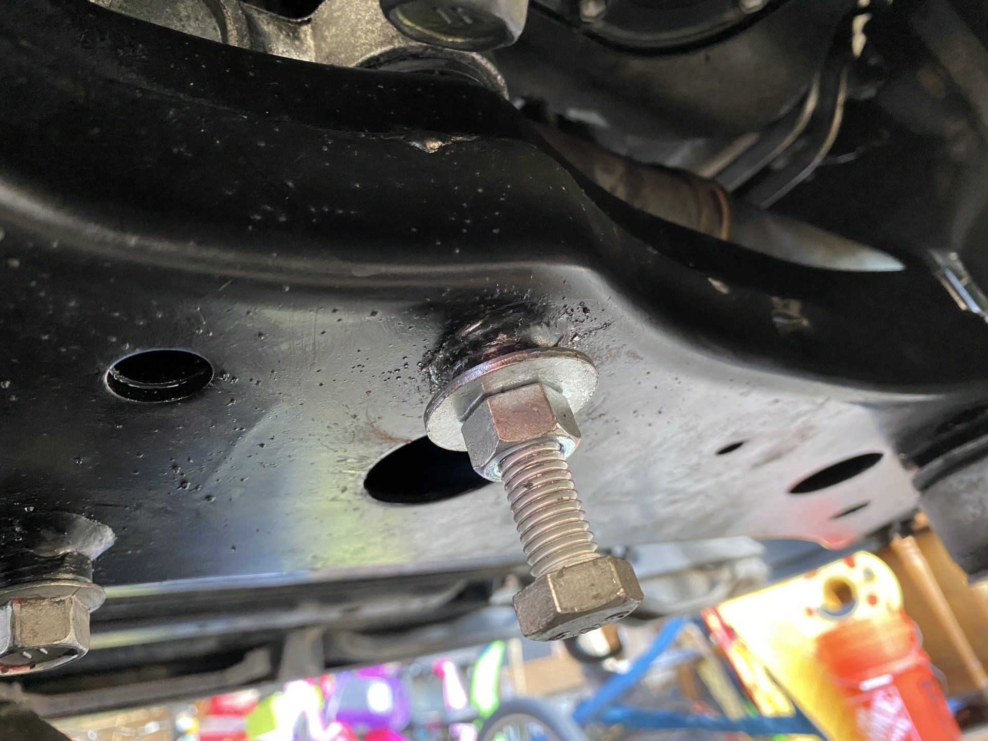

Just wanted to contribute, but I had a hell of time getting the replacement bushing on the DS to pop in, I didn’t have longer bolts that were the correct size but I had a 1/2” 6” long bolt, still not being able to get a wrench on top, I hand threaded the nut a few times and had a second nut on the bottom. Then used this “jig” to press the bushing into place....then just removed the jig and was able to use the existing nut and bolt (I know I should probably replace them, but whole rack will be replaced at some point...
hopefully this helps someone
