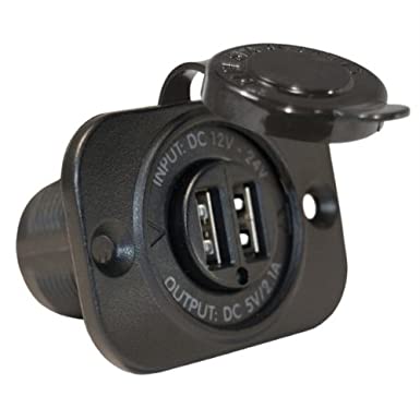

I think I may do the same thing, but has anyone done the USB route. Meaning using the USB as a power charger. Nowadays, all the gadgets the kids have uses a USB to charge them. I know I can buy the plug at Walgreens, but it would be cooler not having to buy an extra plug.
Yep, I'd go for one of these:
http://www.amazon.com/gp/product/B0082CXEI8/ref=ox_sc_sfl_title_5?ie=UTF8&psc=1&smid=A2CK5NG72UVSTT

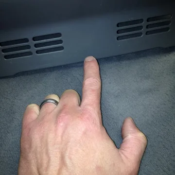

Ya, there isn't much space behind that panel, maybe 1" before you get into the cubby. I actually have the interior out of the 04 right now cleaning the carpets, I'll see if there is maybe space at the bottom between the two vent outlets.

Thanks for the links RR and OLC!

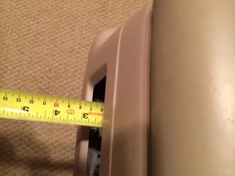

Cool, thanks for all of that. I haven't gone back there, but is that rectangular blank panel removable from the front? I don't want to mar it if it's screwed down from the back like some of the things in the truck.
That rectangular blank just clips into place. You can pry it out very easily. Use a plastic putty knife, or the end of a flathead wrapped in tape. FYI, you've got a bout 2 1/4" of depth to work with behind it.
