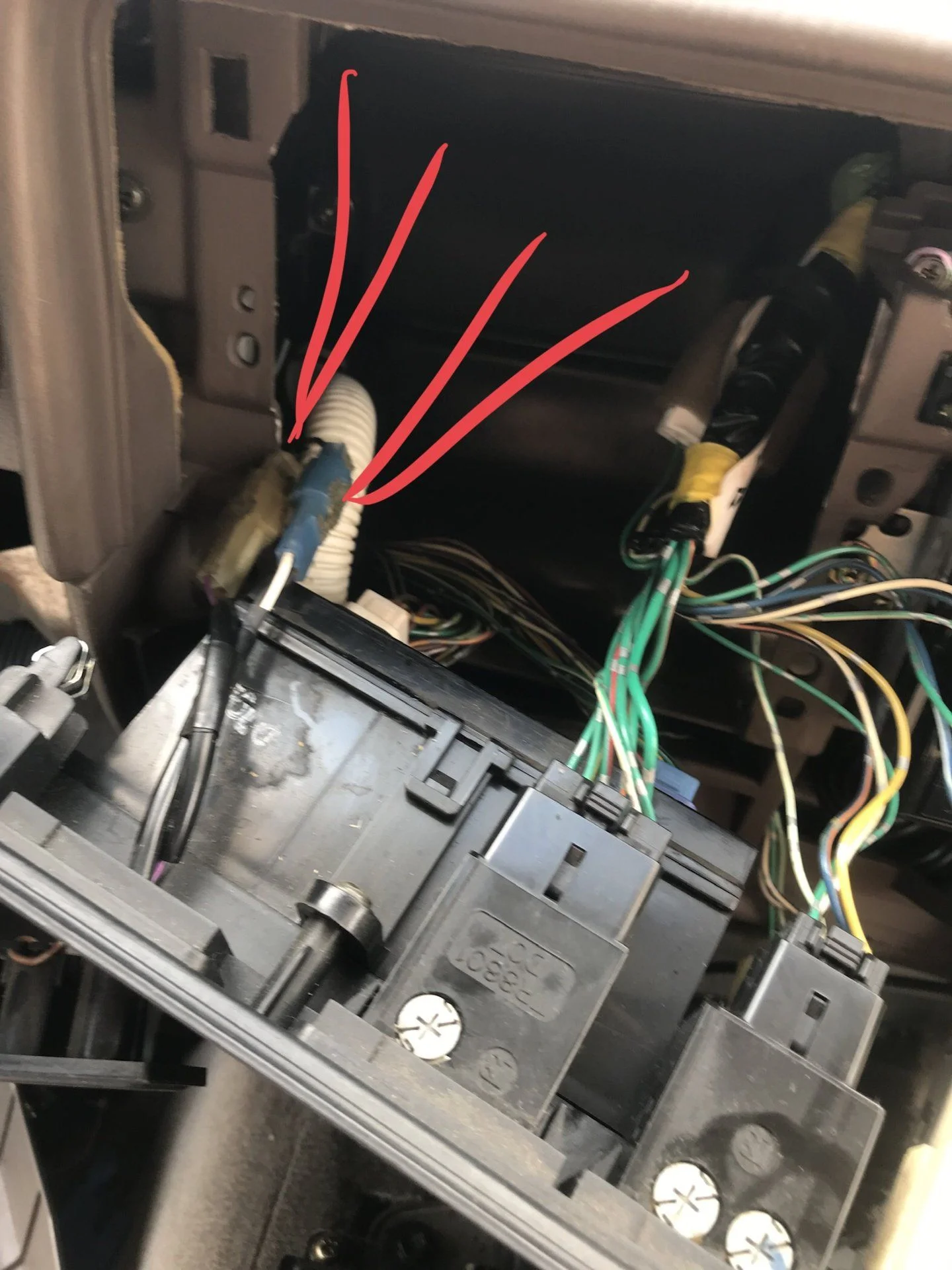

basically there are four places where the TVSS system harness is inserted between two existing plugs in the "normal" harness, three behind the driver kick panel and one just to the right of the steering column up under the dash. In addition, there are two wires spliced in right under the steering column (here they used the crimp on splice things)
I'll try to add circles to the pics to distinguish what is what, but the TVSS connectors are the bright white ones... I have more pics later that show that harness all by itself
first pic is the kick panel, others are under the dash

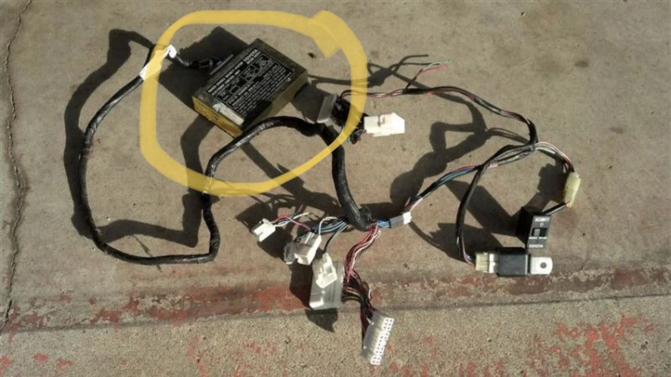

here's what the whole thing looks like out of the truck
second pic is a close up of the TVSS control unit itself and where the remote control antennae attaches to it with an RCA plug. This antennae is not pictured elsewhere had a cable about 6 ft long and the antenna end was shoved up from the kick panel toward/into the driver side A pillar

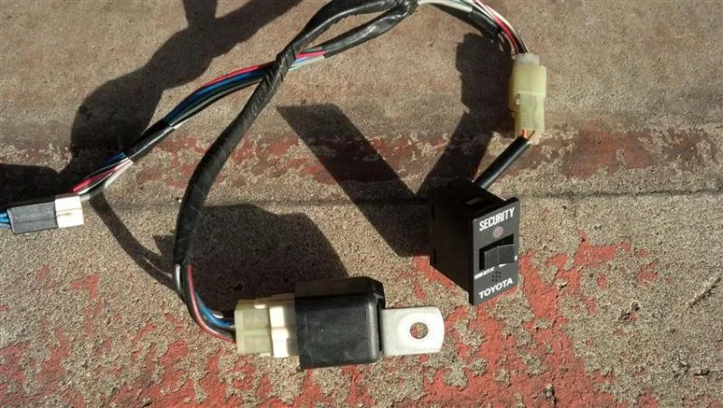

misc close ups of the TVSS harness parts
first the connectors from the kick panel
second the connector by the column... note the individual red and green wires were spliced in directly inder the column
third shows the TVSS dash switch and the ignition interrupt solenoid

I have an LX450 and want to remove as well....Im not sure about that red and green wire in red connectors? do you just cut em and tape ends? 🤔 sup?
where is the silver box that is shown in the sub-harness pic? i’ve pulled the BLACK box that is the comm with the remote but where is this black box?

or does anyone know how the two 2 wire connectors at the secureiy switch come off? i’ve been messing with these for fifteen minutes and at this point i ees to get some goo gone to get the foam tape off them and then get out a magnifying glass or something. would prefer not to cut them.

Under drivers seat zip tied to carpet
