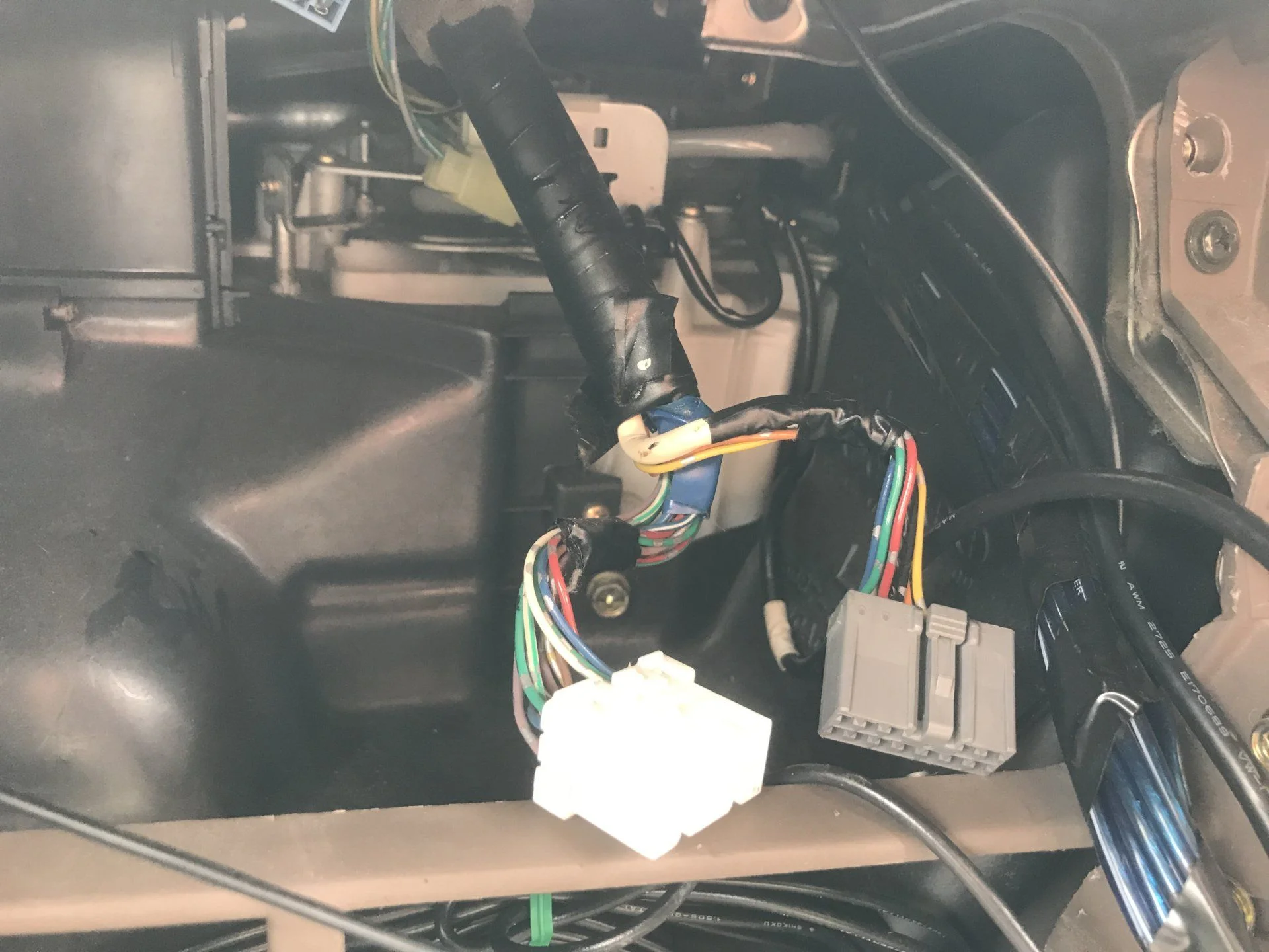

i found the CDL plug. it had a male portion with wires that was grounding it i guess. so i pulled it and just snapped the CDL in.
is this the pigtail? or do you know what this is?
here is the SECURITY SWITCH coming out. there are two 2 pin connectors that may not even be connectors. so i just unplugged it at the switch. but there are at least three or four zip ties up under the metal shield so that had to come out. one is just to the left of the stereo. one is directly under the steering column but you have to pull the harness there off it’s mounts and one is up above the DA kickpanel.

I have done probably 8-10 removal and I have it down pat and doesn't take that long, since you only have one to do and shall accept the punishment for the enjoyment of the vehicle
holy crap. one thing i know is that any time anyone on a wiring thread like this says “nice post i did it in fifteen minutes” i know i’m in for an afternoon in the heat hoping to get in for dinner. APPRECIATE the help.
for anyone looking to do this i would leave the alarm system in unless it is giving you problems. i never even got to removing all of it.
i ended up cutting bait and just moving the alarm sensor over to the left side so i could get the CDL switch in. take off that metal shield. bring a pair of scissors and be ready to cut zip ties buried far back. key in and foot on the pedal to move the shifter back to pull off or push back the trim pieces. also pull the ebrake to get more room. you have to unplug the airbag harness under the steering column. then i just fished the alarm panel wires back through the dash piece in the left and clipped the cover in.
