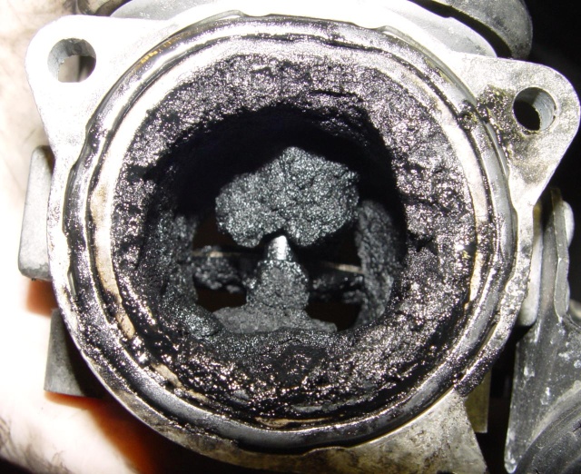

Removing something that looks like this is good enough reason for me. I don't want that goo anywhere near my engine! Plus it's really easy on the 3FE.
