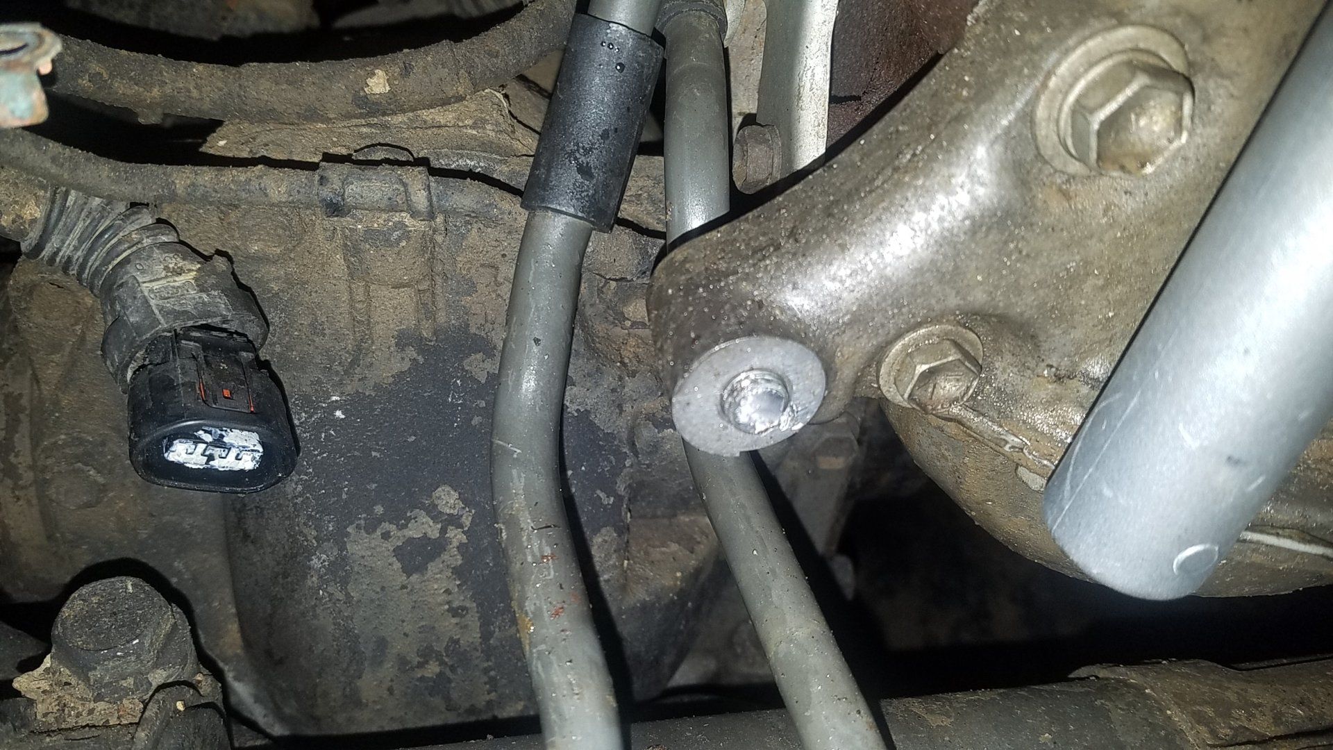

And if you are really lucky your lower alternator mounting bolt will deliver a swift kick to your nuts but breaking in the bracket :brb:. Then you can spend time and money to either drill it out and retap or just use a slightly longer through bolt with a locking nut on the other end.

And if you are really lucky your lower alternator mounting bolt will deliver a swift kick to your nuts by breaking in the bracket :brb:. Then you can spend time and money to either drill it out and retap or just use a slightly longer through bolt with a locking nut on the other end.
Oh no...........!

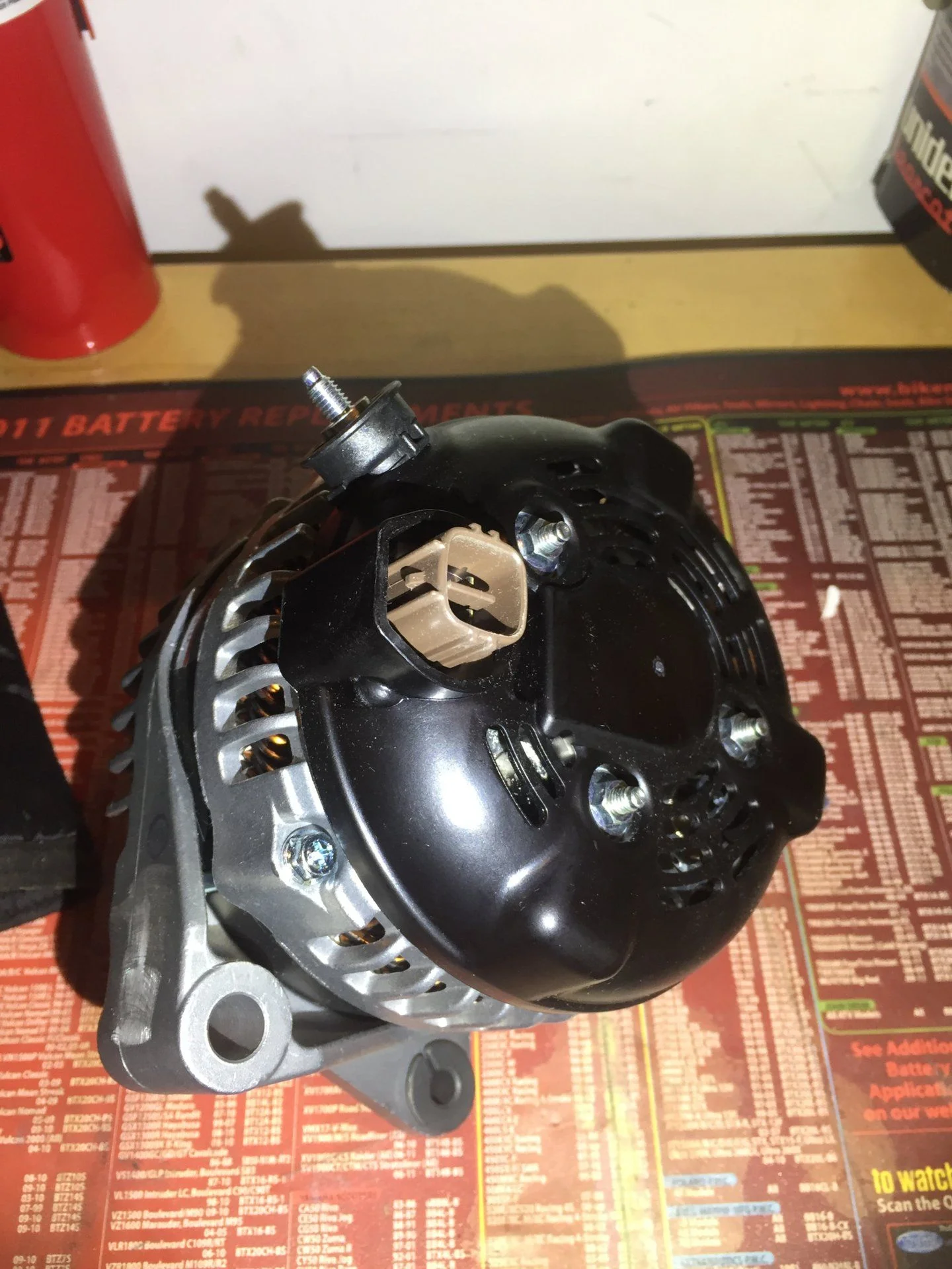

For those of us who plan on replacing only the brushes and not the entire alternator, is it possible to do it while the assembly is still in the engine bay? Does the alternator need to be unmounted and rotated in-situ to allow access to the brushes?
I read a thread post a while back that someone wrote that they changed brushes with alt still mounted. If you are nimble and patient enough to work around to the back side of the cover in confined area and remove it. Its only a few different nuts to undo the cover to replace the brushes.
That sounds ridiculously difficult given the location.

I'm just going to say, I changed my brushes a few months ago. I'm a thin dude. I don't have big hands. I considered trying to change the brushes with the alternator still in the engine bay and realized it would be easier to just heave the thing out of the engine bay instead. If someone can actually change the brushes while it's in there, more power to them.
^^^^ Hear ya! Those would be the same folks that can build a ship inside a bottle. Damn sure not me...!
