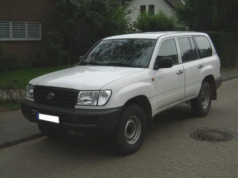

I initially wanted to pull them too, until I learned about the clips. Here's a 105 for reference.
If you take them off I need the right rear piece. Messed it up trying to get tree sap off.
Thanks for the reference pic. Actually, that looks pretty good to me. It's too bad ours have clip holes. That would be my next weekend project for sure. I still might attempt once all my other projects are finished.

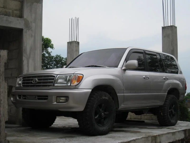

Wow! That looks really good (minus the holes). I might have to that higher on my list of things to-do. Thanks for posting that pic.

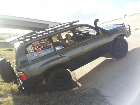

I've seen this done on an 80 series... it got the job done, at 20' away looks good but when you're close you can tell something's been removed.
