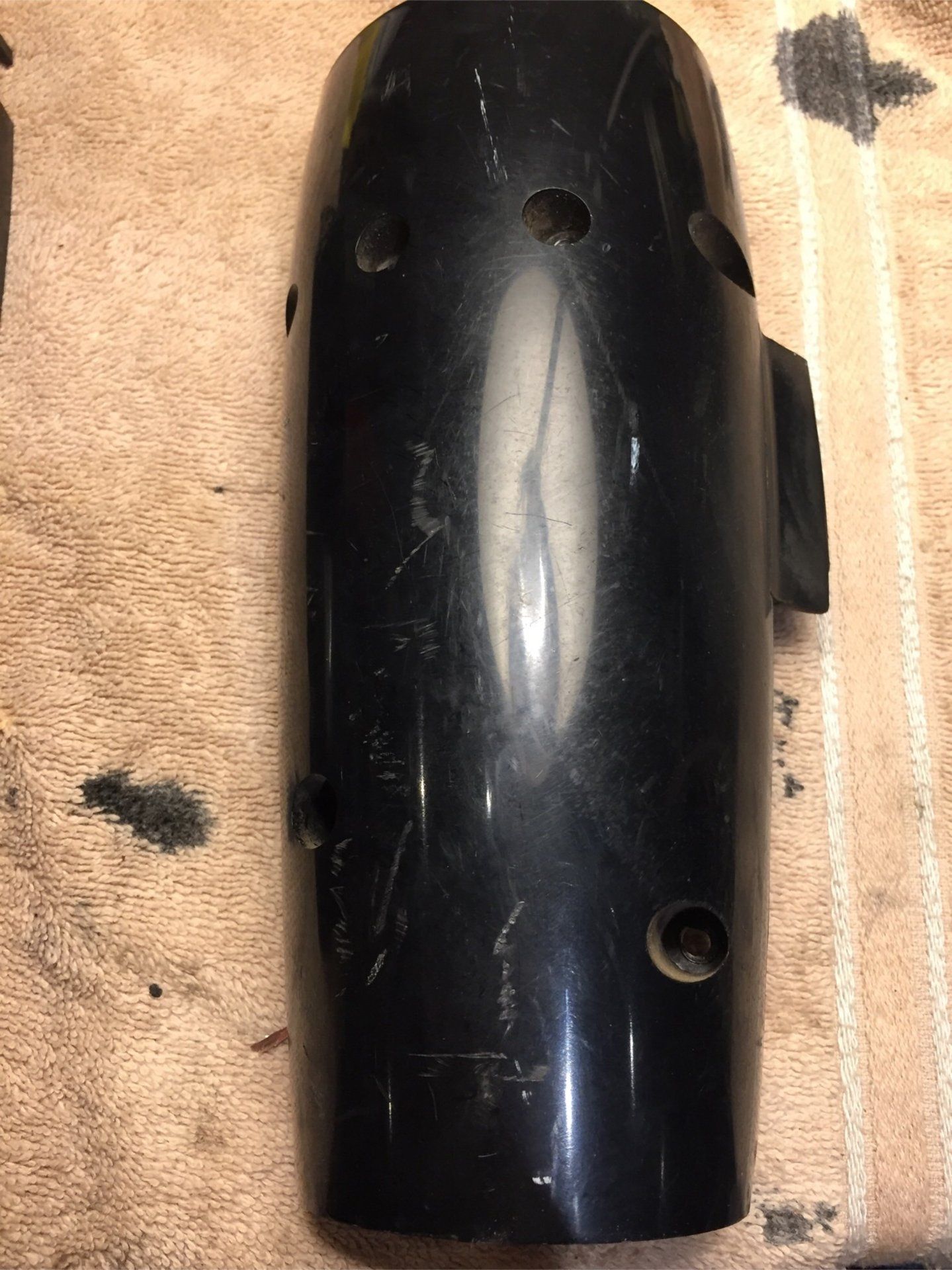

I have used the search function. Can someone link me or give me some dos and do nots on refreshing the clamshell on the steering column. Can it be sanded LIGHTLY? using what grit SP? What color gray did you paint yours/
Thanks
I show the calm shell cover still available. 45286-60907 was superceded to 45286-60909. That one may have the hole for the steering column lock with the button to allow the ignition key to be removed. It may have plug covering the hole. Depending how bad your is may make sense to replace it. Here in rhe AZ desert plastic gets brittle. This one of those parts if it not in good shape I would replace it with good used or new. Show can get the part for around $30 online. Not how much effort would put into a part could replace new for pretty cheap. Haven't checked it really available just show it good in a few places.
Yes, it absolutely can be wetsanded. Dip wet/dry paper in water to remove plastic dust or use a squirt bottle. Started with P500 on my clamshell to quickly remove deep gouges. Just work your way up. P1000 to remove the P500 sanding marks, P1500 to remove P1000 marks, ect. I like to go up to P5000. 3M makes a fine grit paper called Trizact. Meguires sells great paper made by Nikken in Japan.

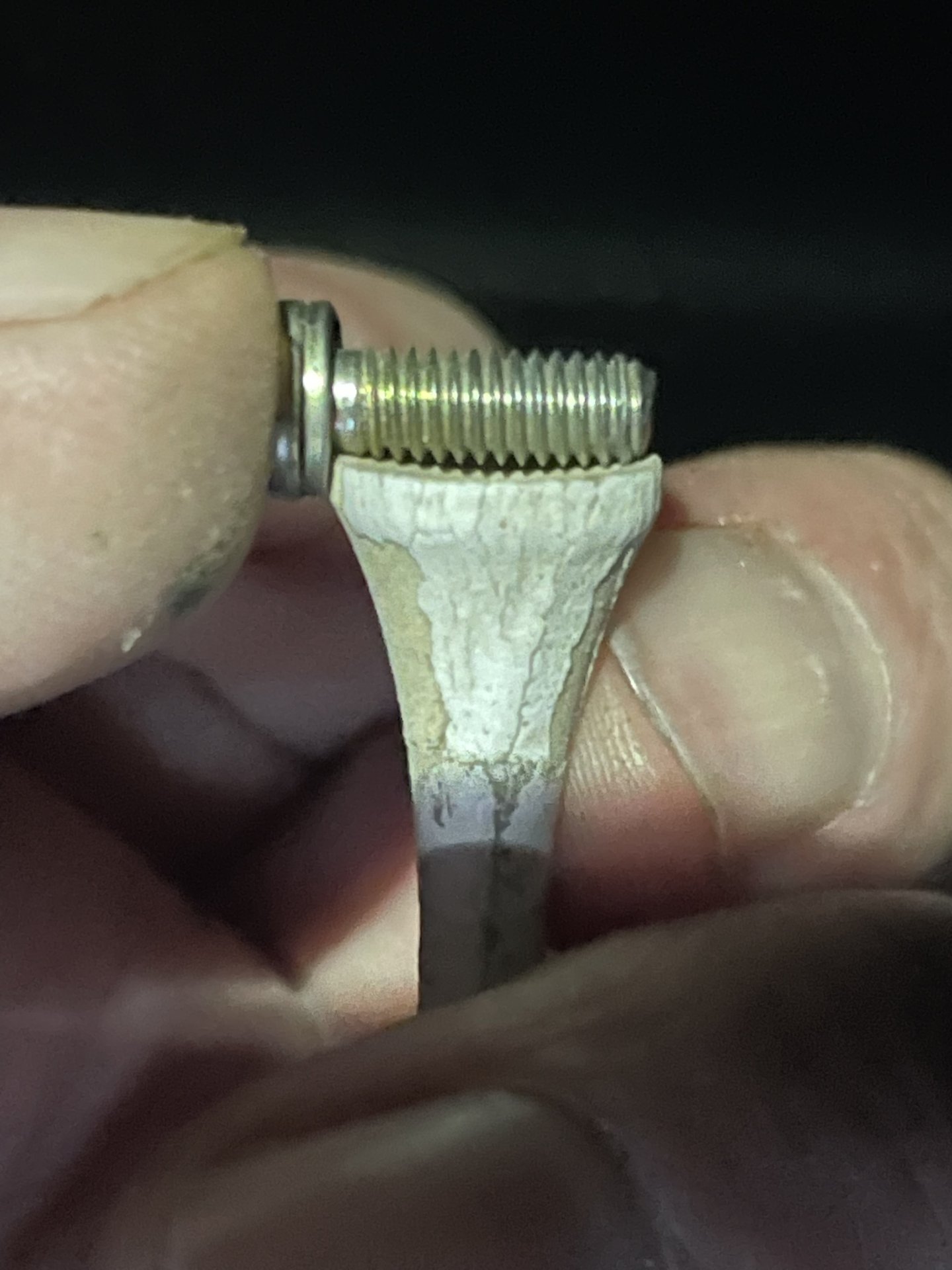

To answer folks on this one here is what I've concluded.
Originally the clamshell had 6 machine thread screws, the clamshells had steel threaded inserts (nice feature). The later version, '80+ removed the threaded inserts and went to self-tapping screws. Therefore if you buy a NEW clamshell from Toyota you get a clamshell that:
1. Has the hole for the steering lock
2. Requires 4 self tapping screws and two machine screws (these two thread into the ignition housing).
Part numbers would then be:
45286-60909 - upper and Lower with hole for steering lock (-60909 w/o hole is NLA)
90164-50048 - self tapping screws, qty 4
93319-15012 - machine screws, qty 2
