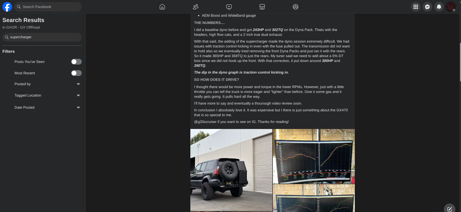

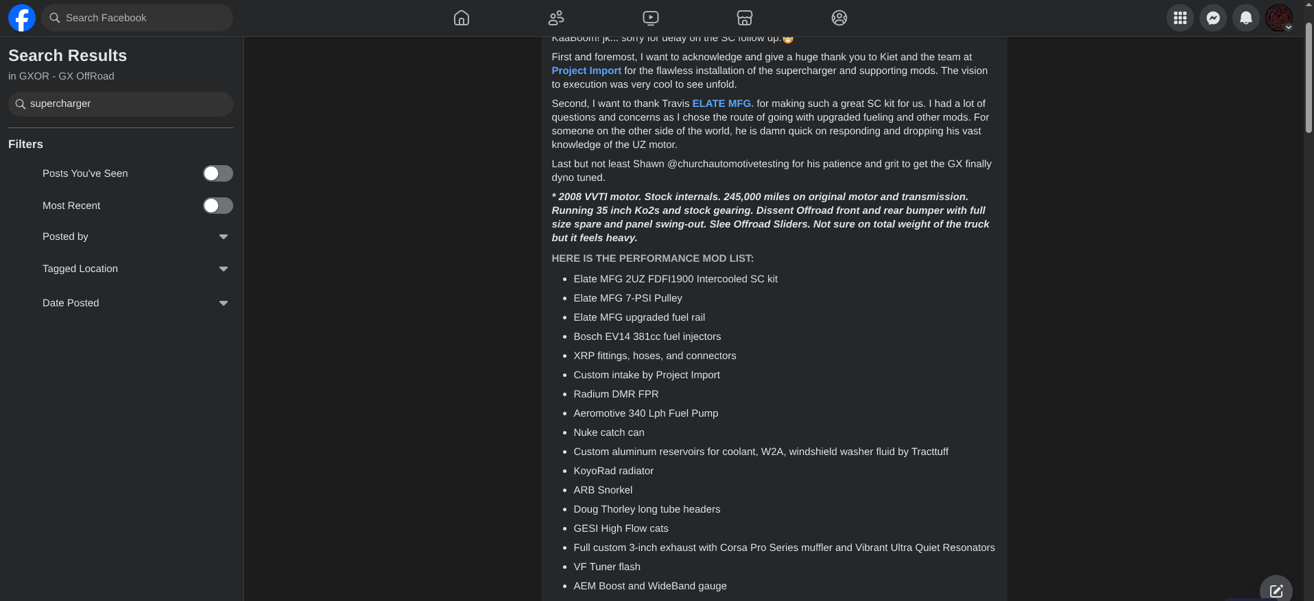

Did someone say "supercharger"? Not my build.
Now you are tempting me :). In all honestly the rig has a lot of power with a regear - and my next mods will be a snorkel and bumpers/winch....but man a supercharger would be a great way to throw away $7-8K in pursuit of pure pleasure :).
I haven't even begun to tempt. lol
Don't mind me. Just sprinkling a little chaos wherever I go.
Since he's on 35s (which reduce dyno power), I'm betting he's making a lot more power than that! Maybe one day after some things are paid down :).
Some more Ironman suspension woes from my trip....in addition to the rear springs becoming stress-fatigued - I noticed the front looked low too. Luckily I had taken all-around ride height measurements before the trip when setting up the airbags. Turns out I lost a full 1/2" of ride heights in the front! The only thing the front shocks were subjected too were some rough roads - all of the camper weight was sitting on the rear axle. The front springs are only 2.5 years old and should not have lost spring rate like that so quickly.
So, I ordered a replacement set of Ironman 3" front coils to match the Dobinsons rear coils which should bump me ~2.75" in the rear. These are probably the last Ironman products I will buy, unless I rebuild the FCP shocks in the future.

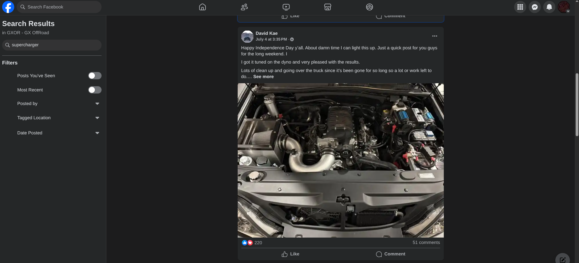

He posted a couple of clips in the GXOR Facebook group. You could barely make out the SC whine over the exhaust.
That's a bummer. If I drop that kind of coin on a SC I'd want to hear it.

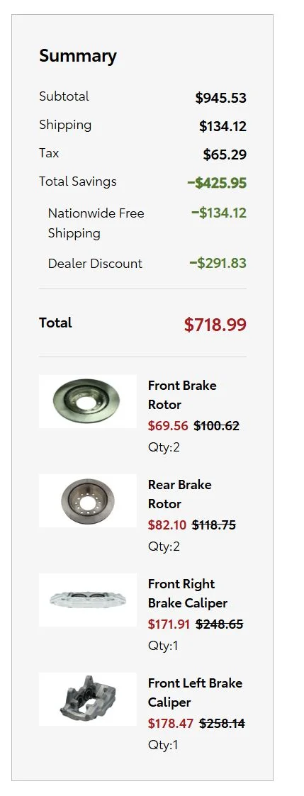

Lingering carnage from my trip keeps presenting itself. Took the rig for a spin today....and immediately noticed that the rotors are most definitely warped. The were all getting pretty thin before the trip (about 17-18 mm) and they have at least 60K on them. So, I pulled the trigger on a set of new OEM Toyota rotors (front and rear), including GX460 front rotors, and a set of new OEM GX460 early-model front calipers. OEM new calipers were within $20 of reman NAPA calipers. I'll also throw on a set of new EBC Greenstuff pads. Definitely not cheap, but these parts were all certainly getting long in the tooth.
FYI, Bommarrito Toyota in St. Louis continues to have about as good of prices on Toyota/Lexus parts as anyone else. Same as Bell Lexus in this case. I've gotten a lot of stuff from them - including Mrs. Rednexus' Highlander Hybrid.

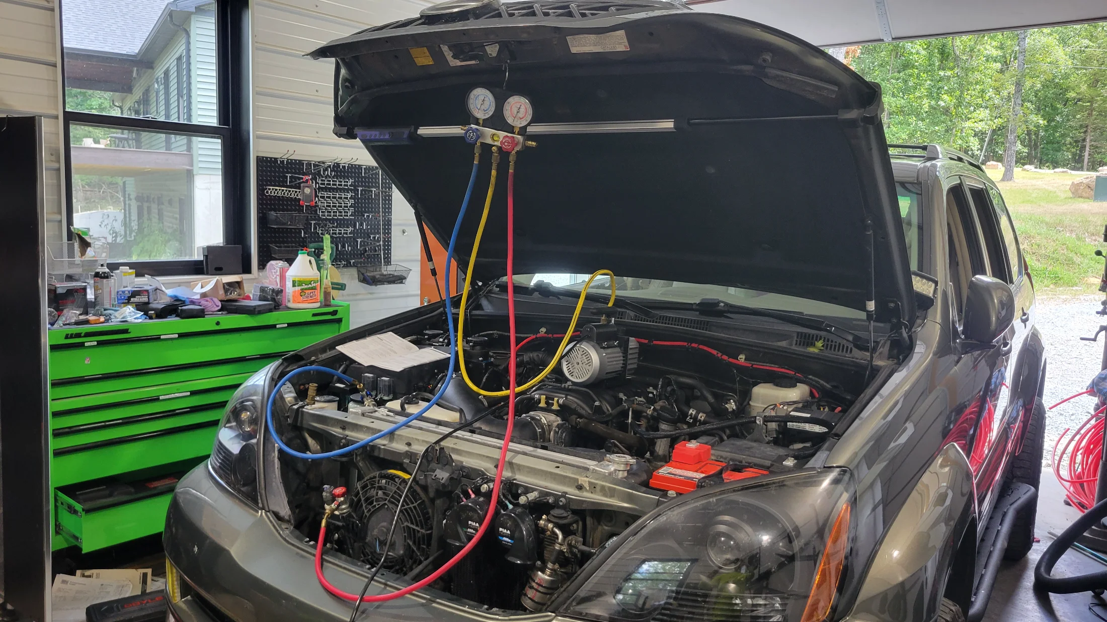

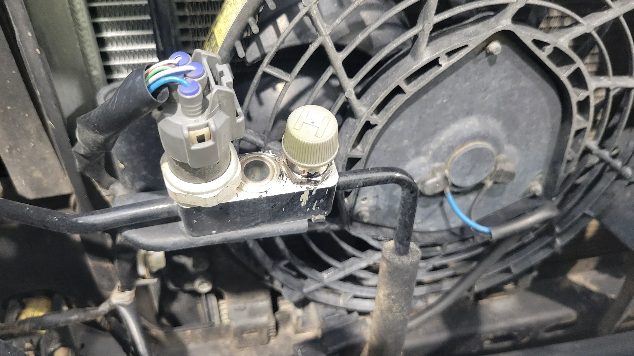

Mrs. Rednexus was driving it the other day and called to say the AC was totally dead. Blowing hot. After it had worked the day before for me. After throwing the pressure gauges on the rig and finding that it was SUPER low on refrigerant, I noticed the high-side service port cap had a LOT of UV dye on it (last time I recharged it - due to an accidental loss of refrigerant [long story] - I had put a can of dyed R134A in it). Sure enough, after removing the valve cap, some refrigerant came out, despite the actual valve not being depressed. Some more investigation with a UV light didn't identify any other obvious leaks, so I replaced both the low-side and high-side valve cores ($13 at O'Reilly's).
^The smoking gun.

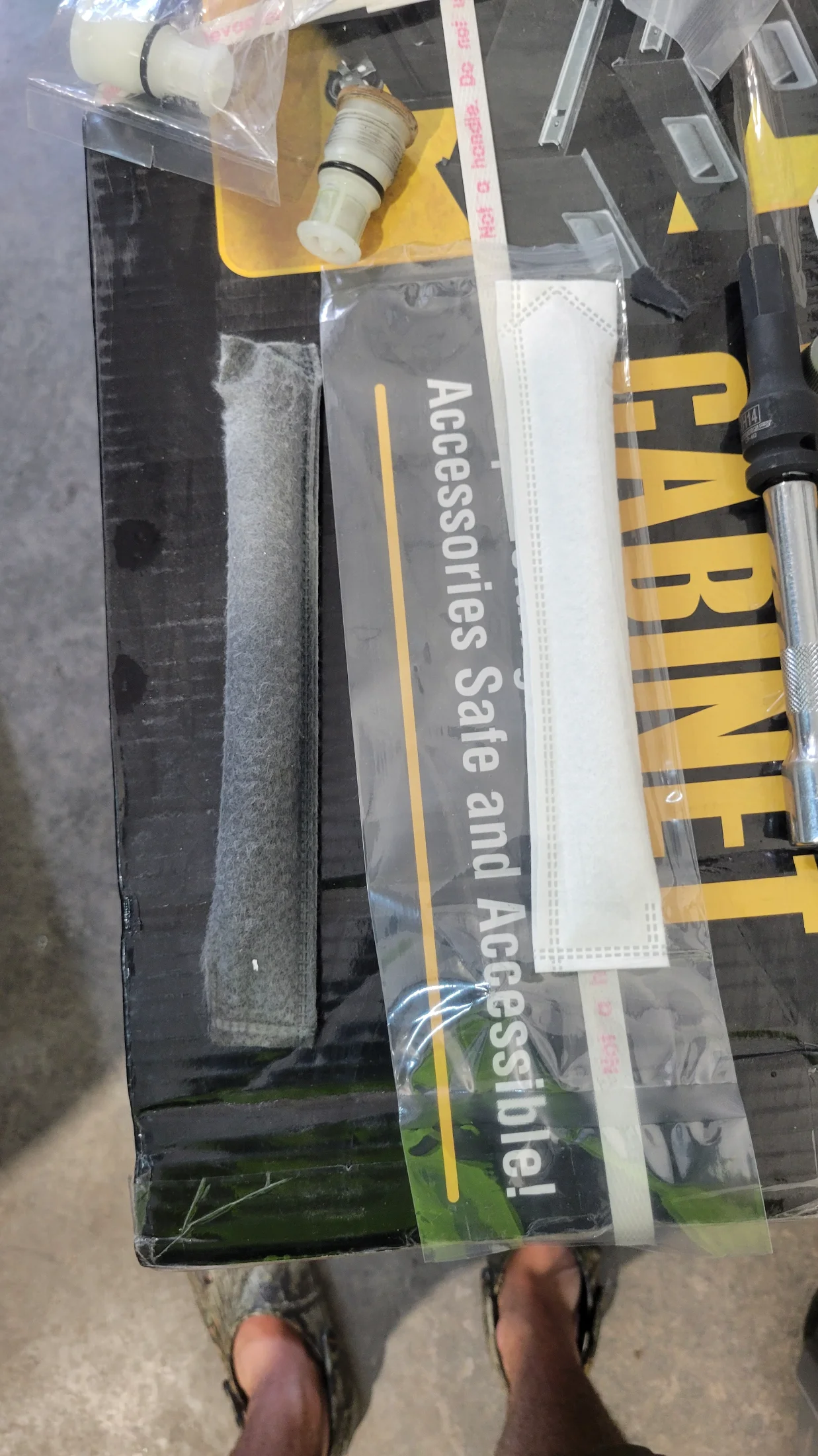

^Since the system was opened to the atmosphere (and it's a humid jungle here right now), I went ahead and put a new Denso desiccant/drier bag in the rig ($25 on Amazon). Side-by-side of the old (left) vs. new (right). The old has only been in there for a bit over 4 years. Appears the AC system on my rig is a bit dirty.

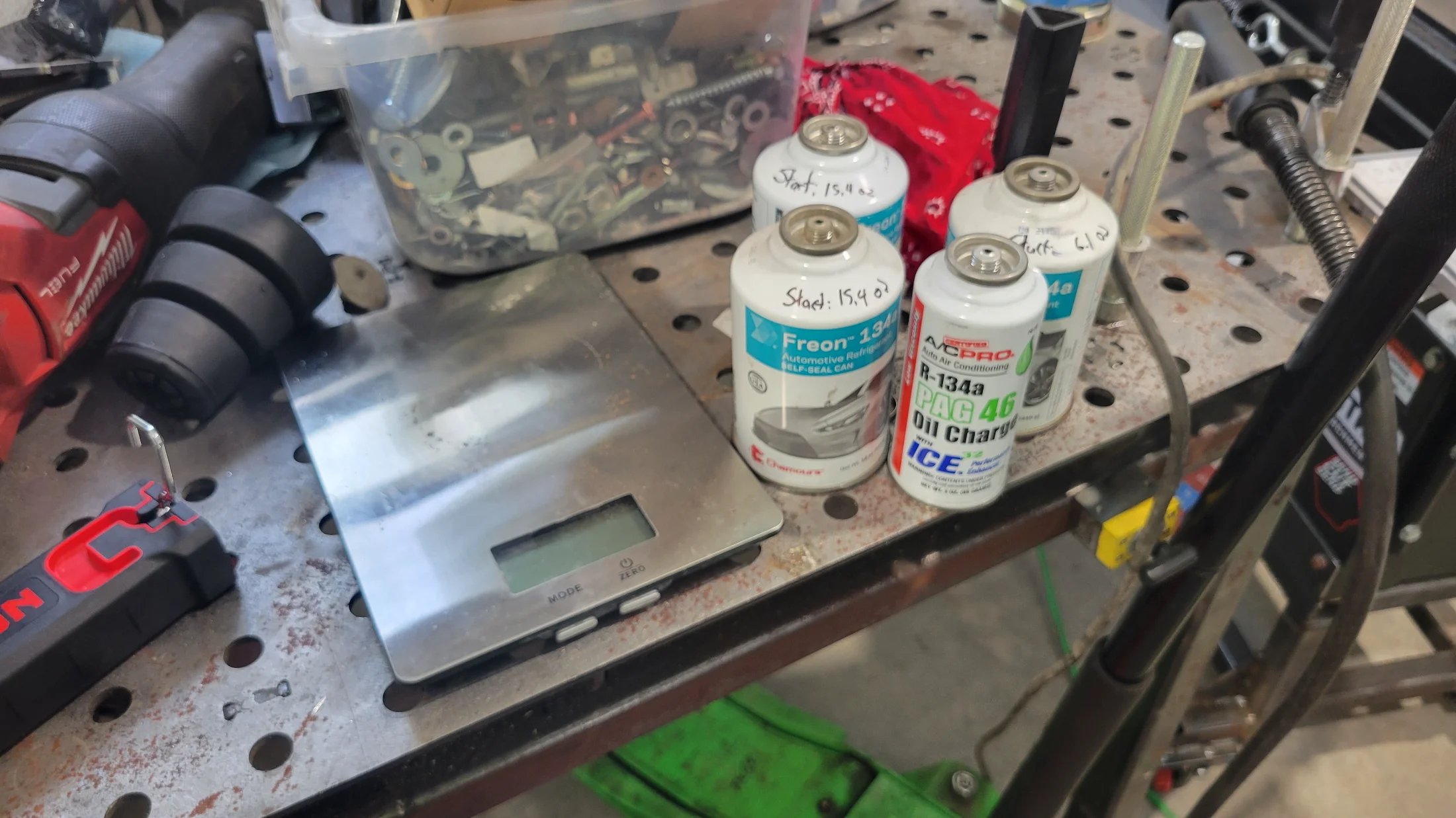

^Getting ready to charge. I'm going to add 1 ounce of PAG 46 (since this is the 2nd time it's lost refrigerant, it probably has also lost some oil), one 12-ounce can of UV-dyed R134A (expensive at $32/can), and fill out the remaining 23 ounces with non-dyed R134A. I use a kitchen scale to weigh the cans and make sure I get close to the required 23 ounces in the system.
^Harbor Freight had a ITC deal on a real vacuum pump for $70, so I splurged (before I was using a clumsy one that ran off of shop air and would only generate about 15" of vacuum). I bought the gauge set 6-7 years ago and it's paid for itself several times over. Right now the rig is in the middle of a 30-minute vacuum cycle to get all the air/dirt/etc. out of the system, then I'll do a 30-minute leak test, and (if it holds vacuum), recharge it. If it loses vacuum, I'll have to find the other leak.
