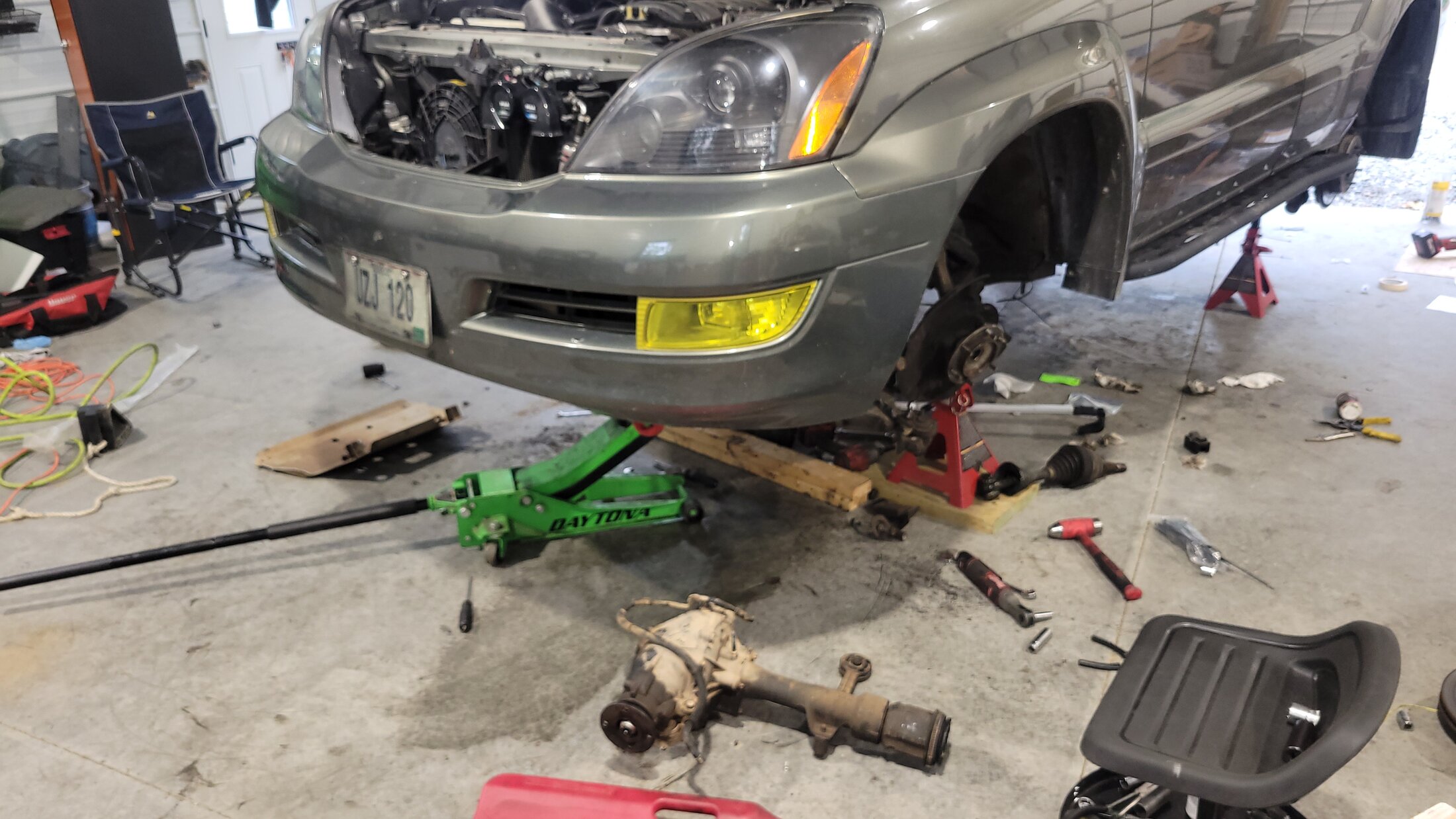

^Have the back end totally finished and filled with Lucas 85W140 per ECGS recommendations. Airbags are at 35 psi and holding steady. Toyota rear e-brakes are torture instruments. The first one was 1+ hours of futzing around - with Mrs. Rednexus again saving the day. The second one took 25 minutes.
^The front is soooo much easier. Had the diff out in maybe 90 minutes, taking my time.
Plan A is to have the diffs done on Saturday and have the alternator, cable upgrades, radiator, and trans cooler done on Sunday. We'll see if that holds.
The ebrake s*** pissed me off to when I put the 9.5” back there. Until I found an easier way to get those stupid pieces that old s*** in place with the springs. Dunno wtf they called at the moment but damn trying to get them back together sucked u til I realized an easier way to go about it.
We ended up putting mini-zipties on the springs to compress then. I'd then hold the spring pin in from the backside of the backing plate, and hold the shoe, while Mrs. Rednexus slid the spring and retainer over the pin and twisted it to lock. Then we snipped off the zip ties, and all were good.
The problem I had was that I took the old 8" apart on Monday to replace the wheel bearings. We didn't try the e-brakes until yesterday. Since both axles were stripped bare, I had nothing to go by on how to re-assemble them other than some photos/diagrams from online that I printed out. But, none of those were really specific about which side the shoe with the E-brake cable handle went on, and which way the adjuster goes. We made the mistake of starting on the PS side using the Toyota diagram, which is for the DS. So we initially put the shoe with the e-brake cable handle on the wrong side and had to re-do it couple of times.

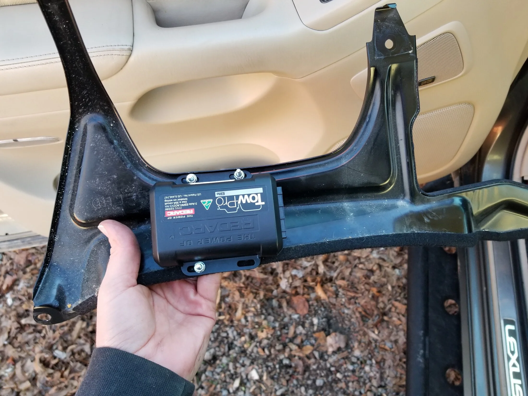

Are you running a trailer brake controller in the 470?

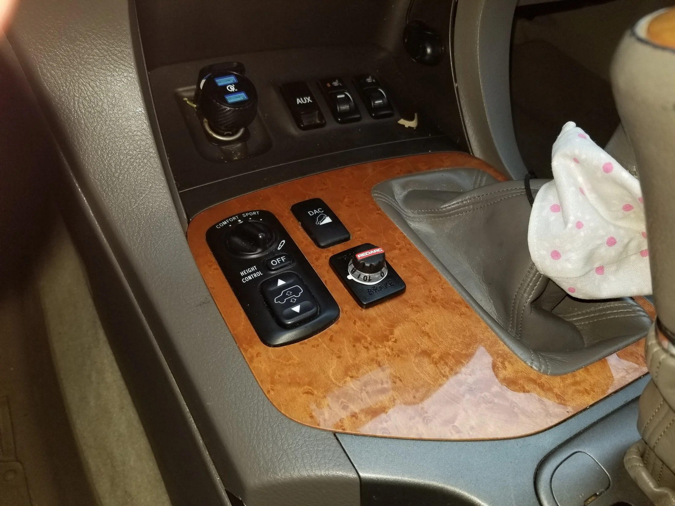

I do. I run the RedArc one with a Bluewerks bezel on the left side of the dash to add an extra switch.
I have a Redarc Elite Tow-Pro elite as well. It's mounted under the lower dash support (below the steering column). For a long time I had the switch in the stock bezel (you can drill a hole to mount it), but now have it in my custom Blue Dog bezel.

i put the pins and spring and cap in like it was suppose to be installed but with out the shoe, grabbed the spring with a pick, pull it torward me, then slide the shoe in behind the spring. amazingly that s*** worked perfectly

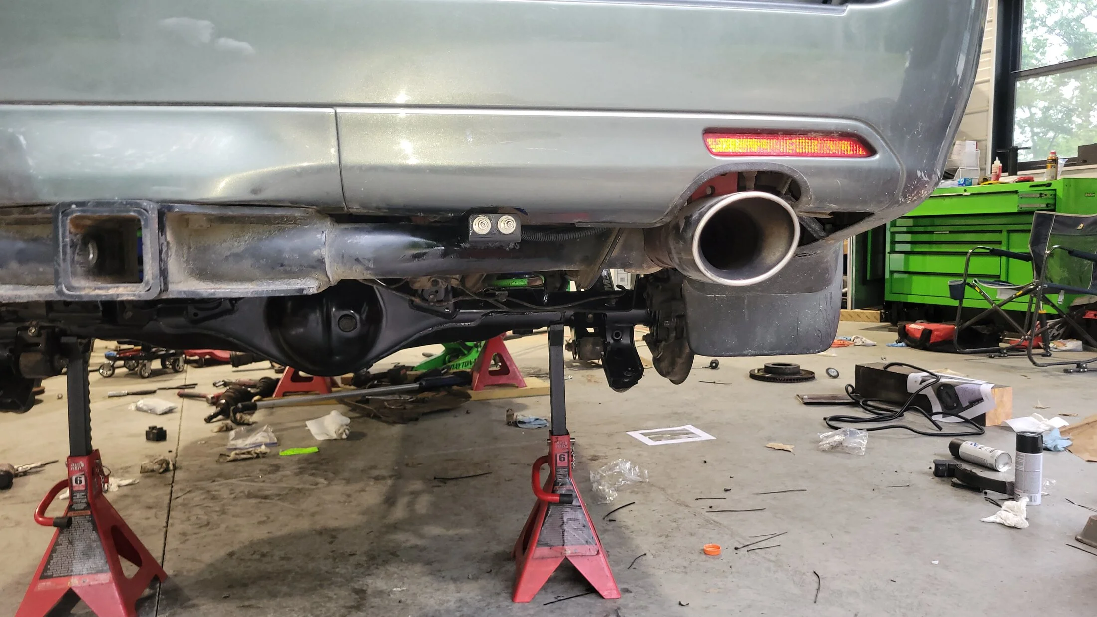

Worked for a few hours this morning and the underside is 99% buttoned up.
^Assembled 8" clamshell with my old axle tube, mounts, and breather plumbing.

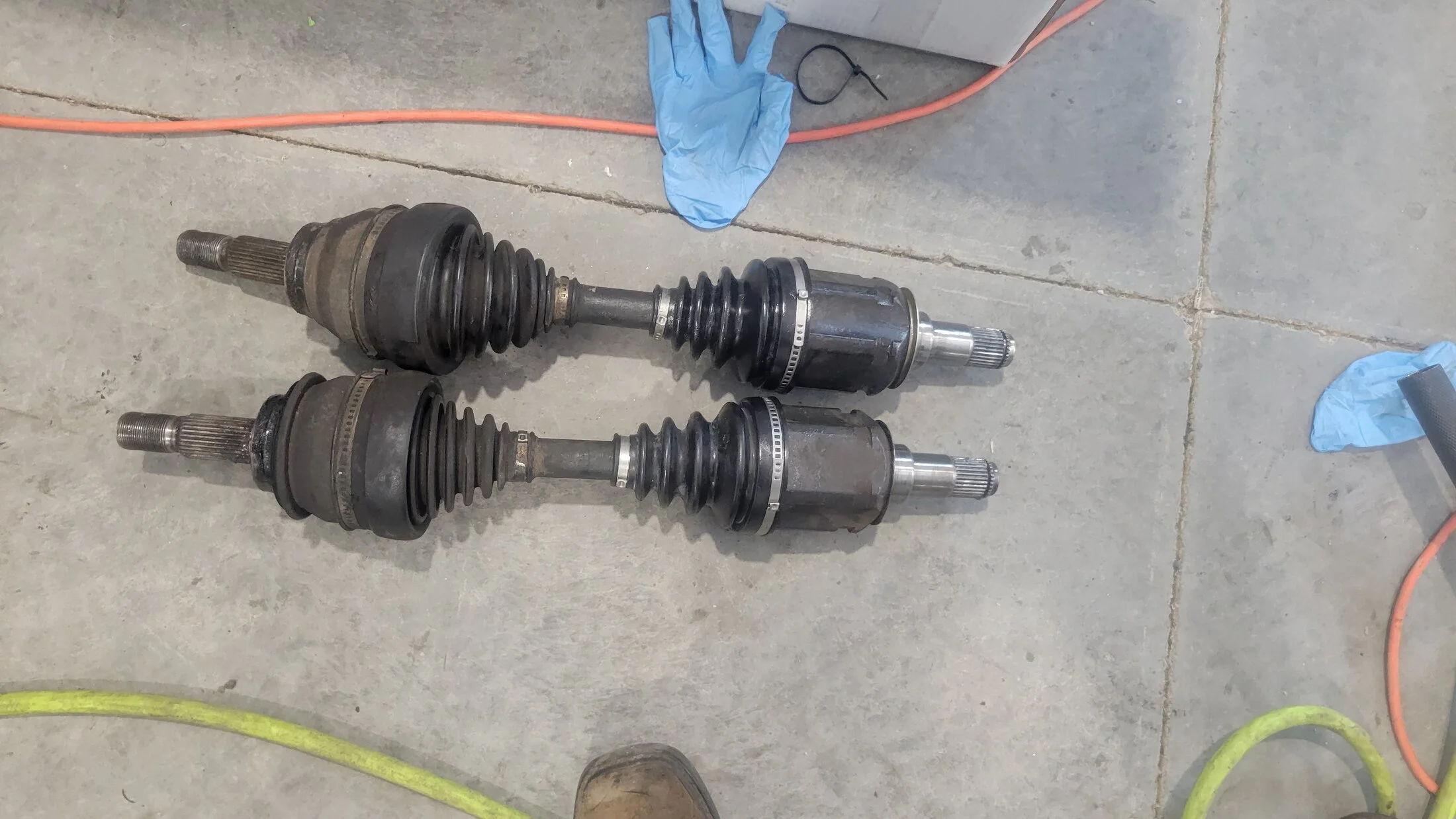

^The inners finally ripped on my All-Pro extended travel CV boot kit. So I rebooted both of my OEM axles (190K on them now). The All-Pros lasted over 3 years, which is pretty good for CVs on a lifted Toyota. Next time this needs boots it will get a set of new or lightly used 5th gen 4Runner CVs, just due to this set having so many miles on them (and the 5th gen CVs supposedly being stronger).

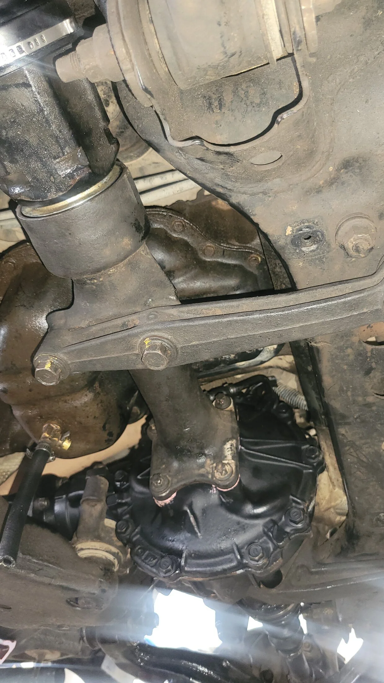

^Front diff is installed/topped off, front suspension is reassembled, and everything is torqued to spec. It was a bit tricky getting the front diff hung as it has to go up at an awkward angle to clear the front crossmember, prior to rotating the rear mount into the other crossmember, but it was doable with me under the rig and Mrs. Rednexus running the floor jack.

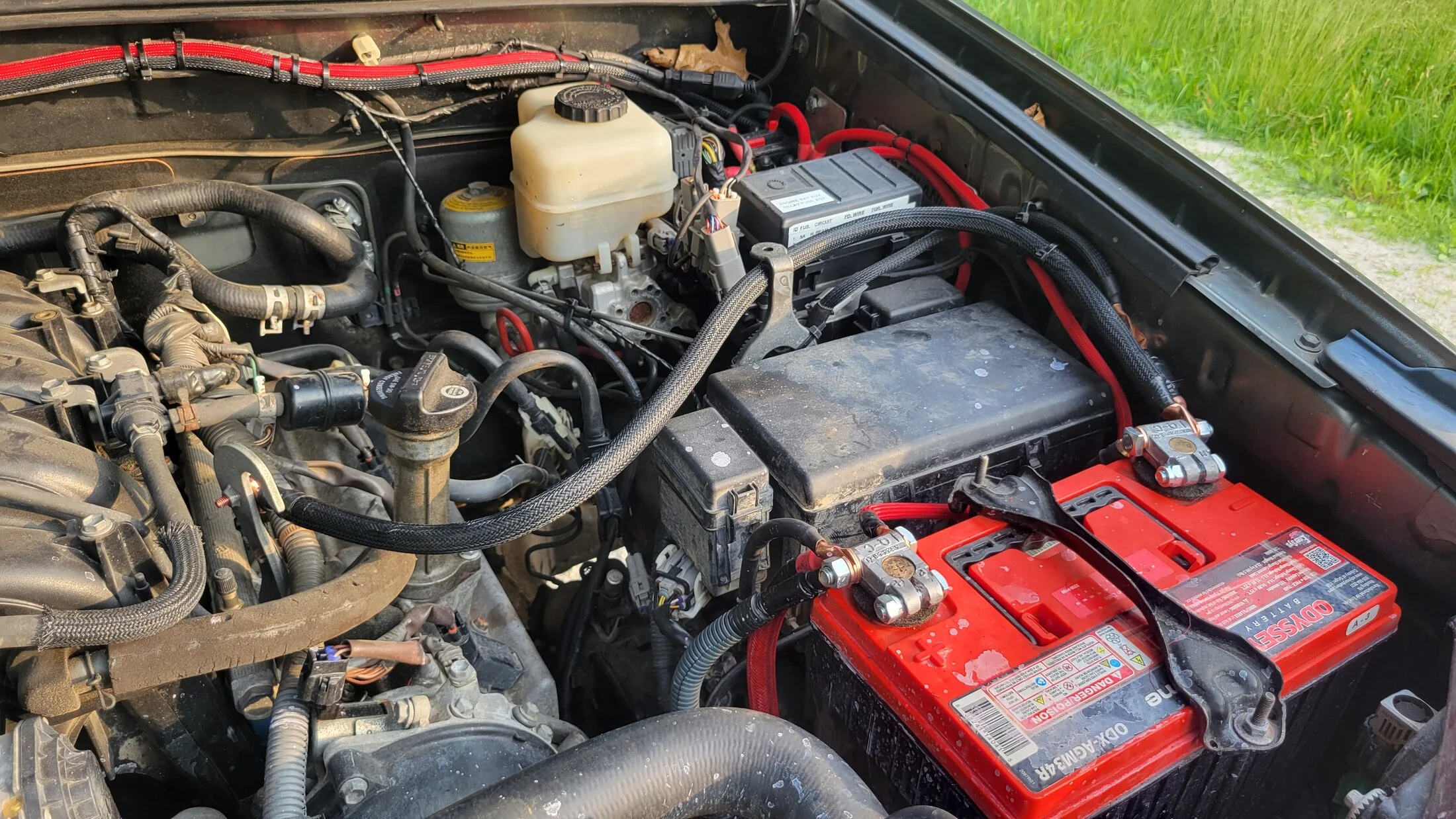

^Big 3 wiring upgrade. I DIY'd this with some 1/0 gauge wire, which is honestly overkill. I would have been just fine with 2 ga wire. The OEM alternator power wire is really undersized - basically it's only 10 ga wires. I bet they get super hot when running my ARB twin and any other accessories. I have a short 1/0 stub going from the negative terminal to the body ground by the battery, then a longer 1/0 ground wire going to the engine block. I'm not happy with the battery terminals - cables are rubbing on the battery case - so I ordered some SDHQ terminals.

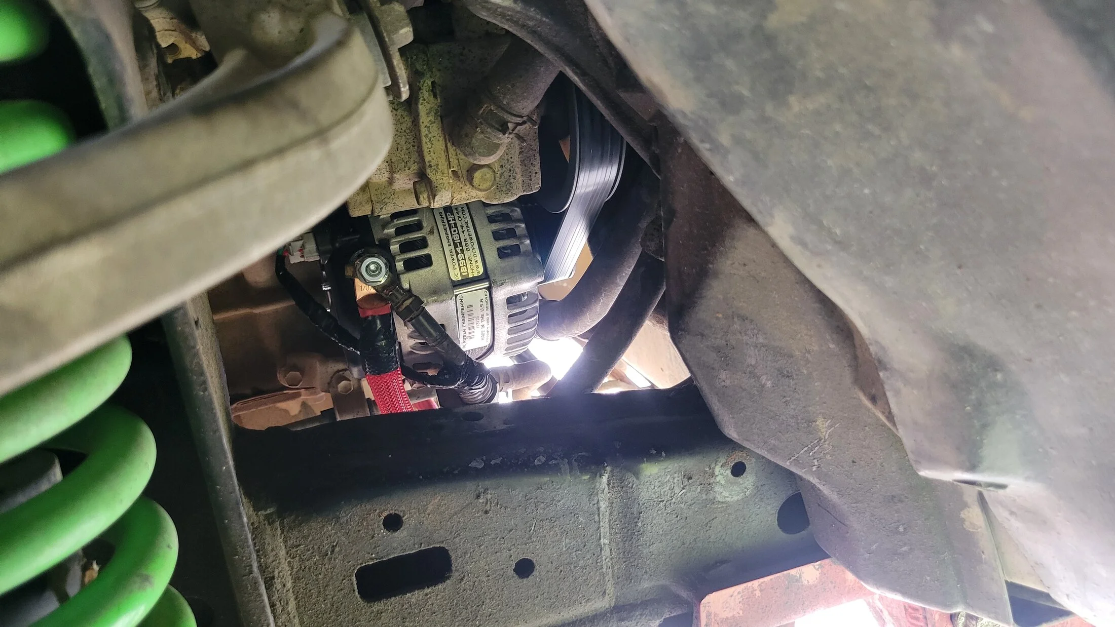

^DC Power Engineering 180 amp alternator. The Amazon 3-prong plug took just a few minutes to splice in and works perfectly. You can also see the other end of the "Big 3" cable. I ordered a terminal cover and will be installing it over both the 1/0 cable and the OEM twin 2-guage cable (which I retained and is still hooked up). FYI, It's really easy to swap the alternator when the radiator is removed. <30 minutes of work. My belt had some micro-cracks in it, so it was replaced as well.
