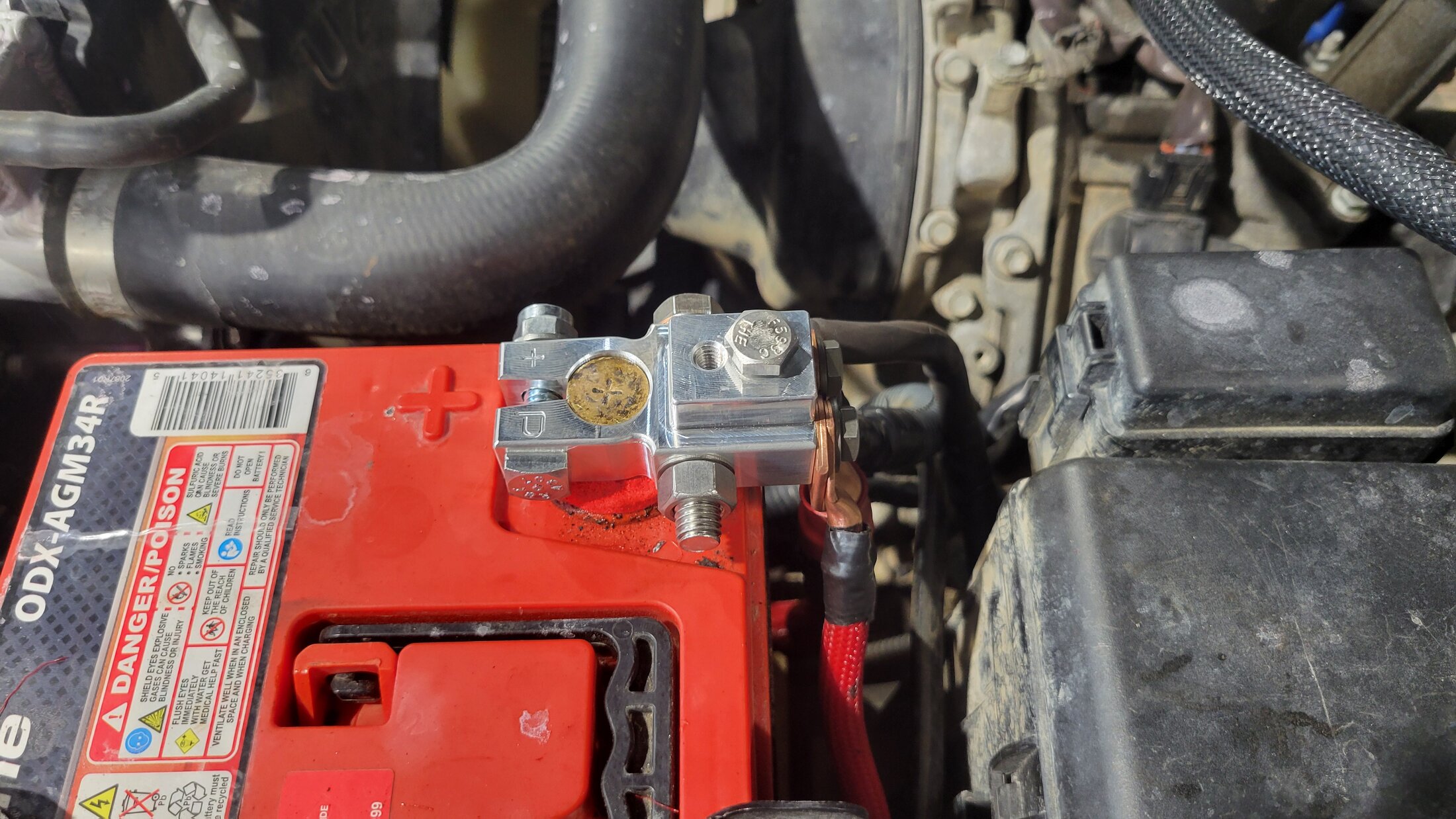

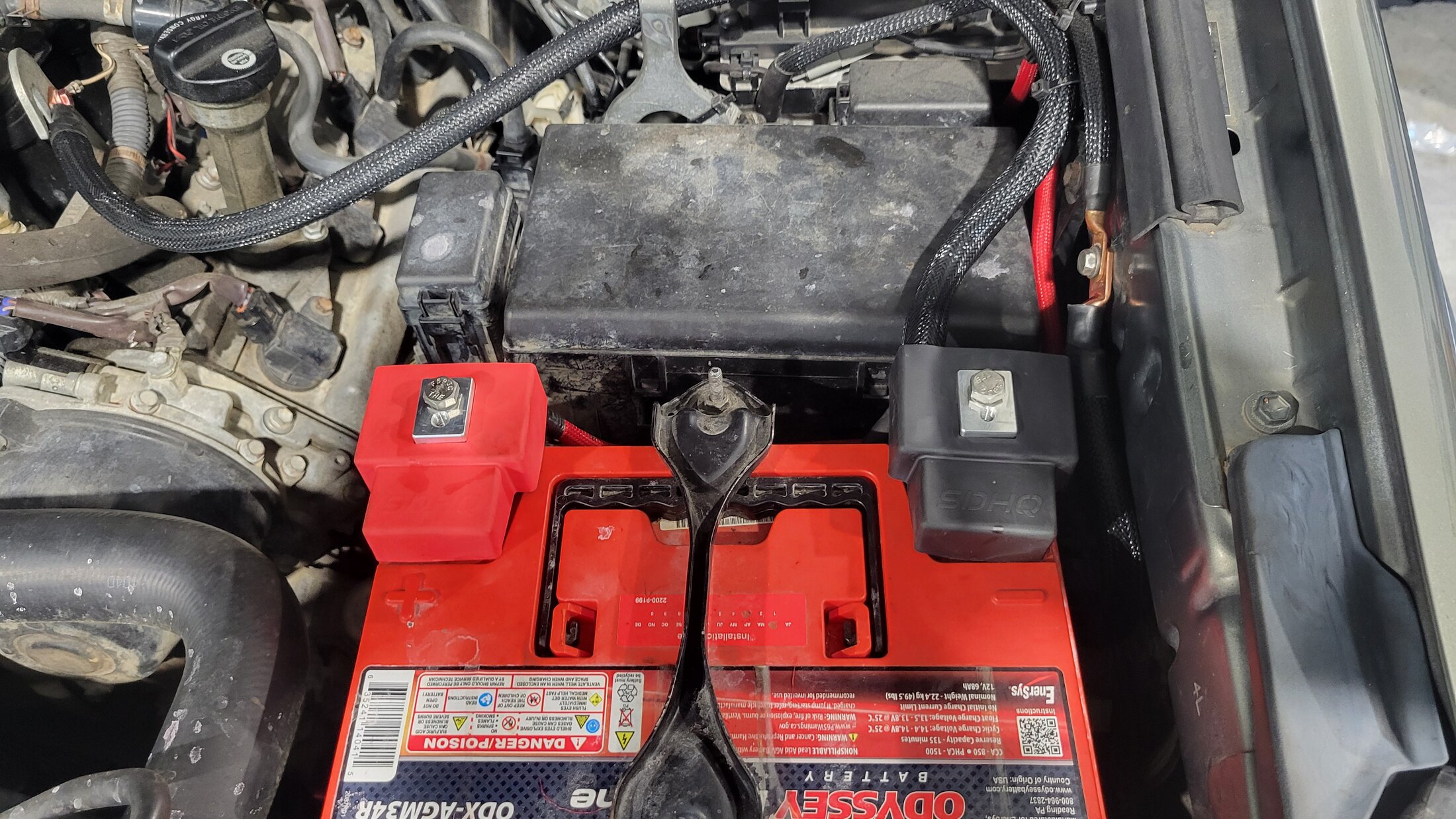

^SDHQ billet battery terminals. These things are pricey but a work of art, and have much better positioning for attaching cable lugs than the OEM or military-style terminals. I think they'll also be great when I add a winch. I'm not 100% happy with the engine ground wire routing, but it will work.

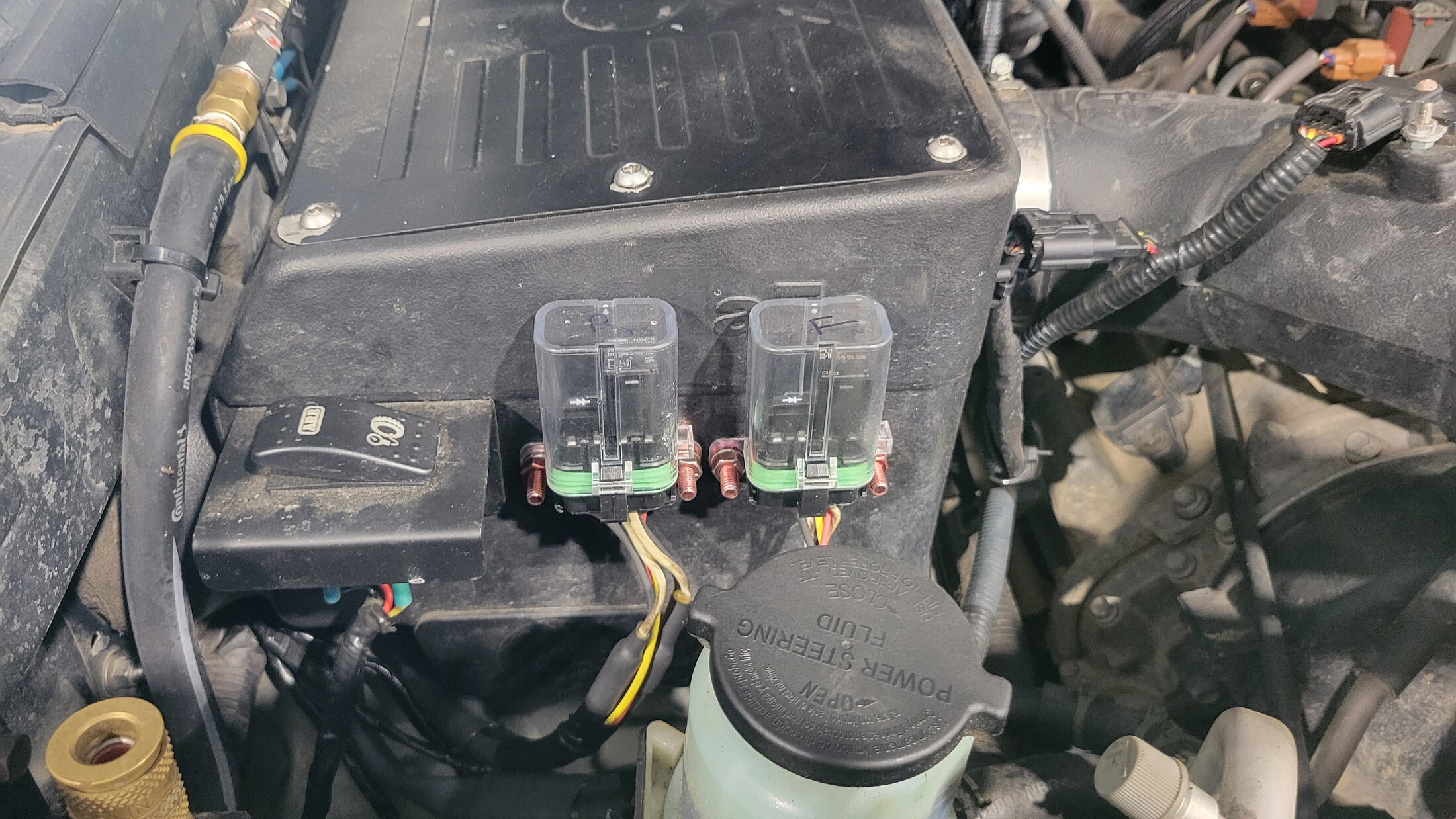

^Harrop elocker relay mounting. These are nice, sealed relays. The CAI airbox continues to be a great spot to mount things :).

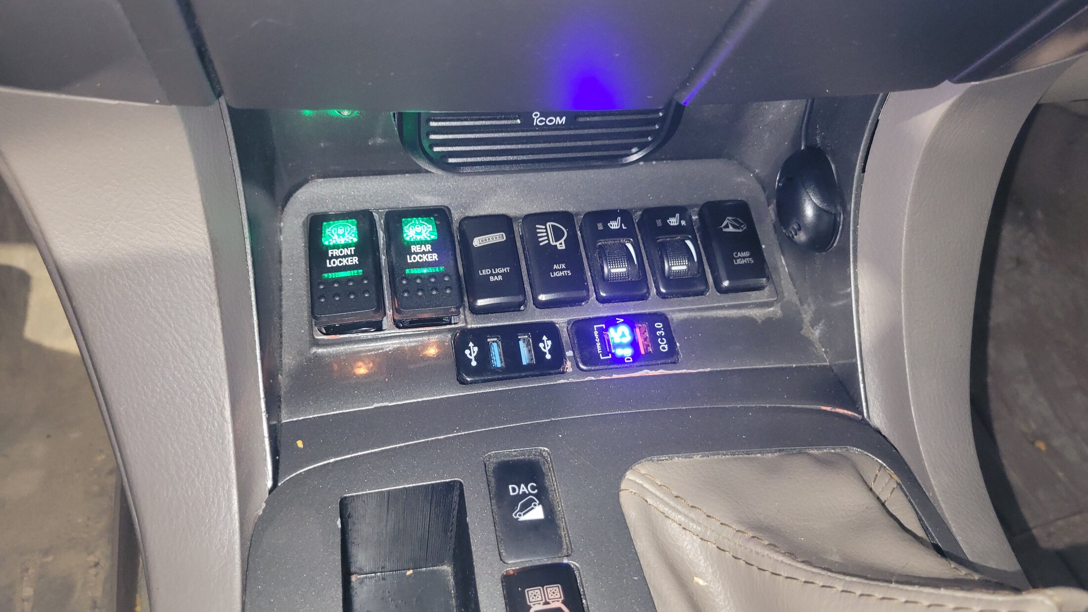

^Elocker switches in the custom Blue Dog Design Works panel I've had for some time. These are OTRATTW rocker switches and are actual Carling units. The Harrop switches are fugly and not labeled between front and rear.

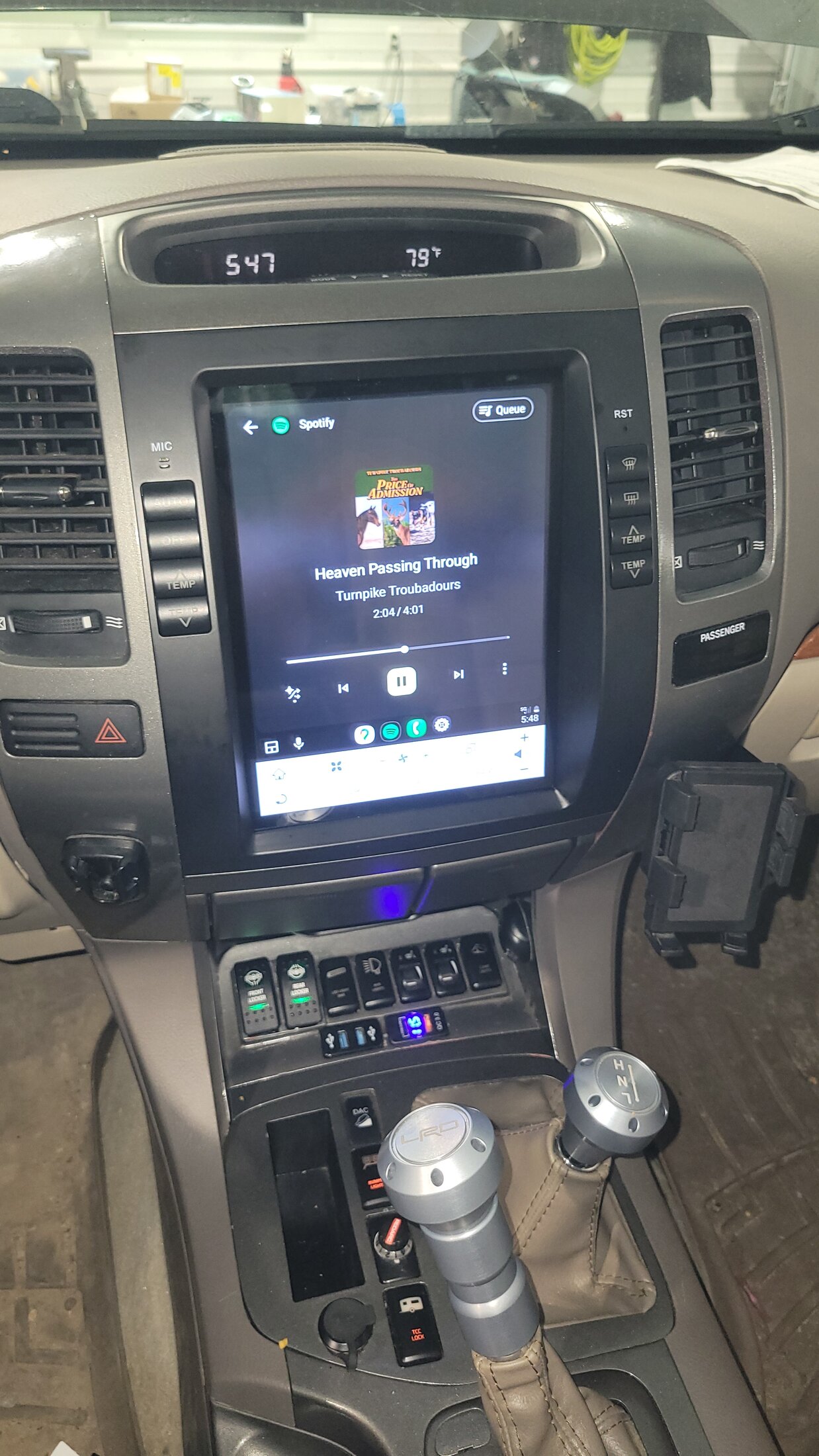

^And the new PX6! I've only had it in a box for 6 months. It was a simple R&R and everything worked perfectly upon startup - including wireless Android Auto. The OS in this is definitely improved and less buggy than my old PX6. But, I'm not having to re-download gigs and gigs of offline topo maps.

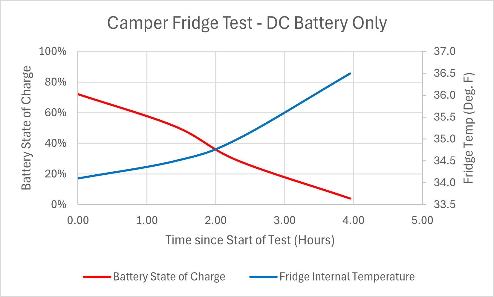

The 10-ga wiring to the fridge seems to have totally solved the issue. We ran a test today with 1) the camper closed in 90F+ heat and in the sun, 2) the fridge on 12V DC with shore power disconnected, and 3) a gallon jug of water in the fridge that had been pre-cooled in our house fridge (to replicate some food in the fridge). We monitored fridge temps and battery voltage throughout the test, which are plotted below:
Under these conditions the 50 amp-hour Odyssey AGM gives about a 4 hour runtime on the battery alone. With the GX hooked up (and not running), in theory there would be about an 8-hour runtime prior to both batteries being depleted. With the GX running and sending ~13.4 volts back to the camper, I'm confident the fridge would maintain 35F indefinitely. I did some calculations on the amp draw (based on the state of charge vs. time) and calculated the fridge was drawing around 8-12 amps DC during the test (which makes sense as the max amp draw is 15 DC per Dometic).
So @stupidchicken03 , I'd definitely suggest this mod (fused wires from your battery direct to the camper with a Anderson connector) if you are going to drive more than a few hours with the fridge on. 10 ga worked just fine for me and should be plenty large for ~12 amps DC max, even over such a long run. Your fridge is probably a bit bigger so you could go with 8 ga if you wanted. I also have a master disconnect switch on the camper battery box...the hot wires from the GX come into this so turning the disconnect "off" totally disconnects both the GX and the camper from the battery.
Tests, data, and graphs!!! I love it!
