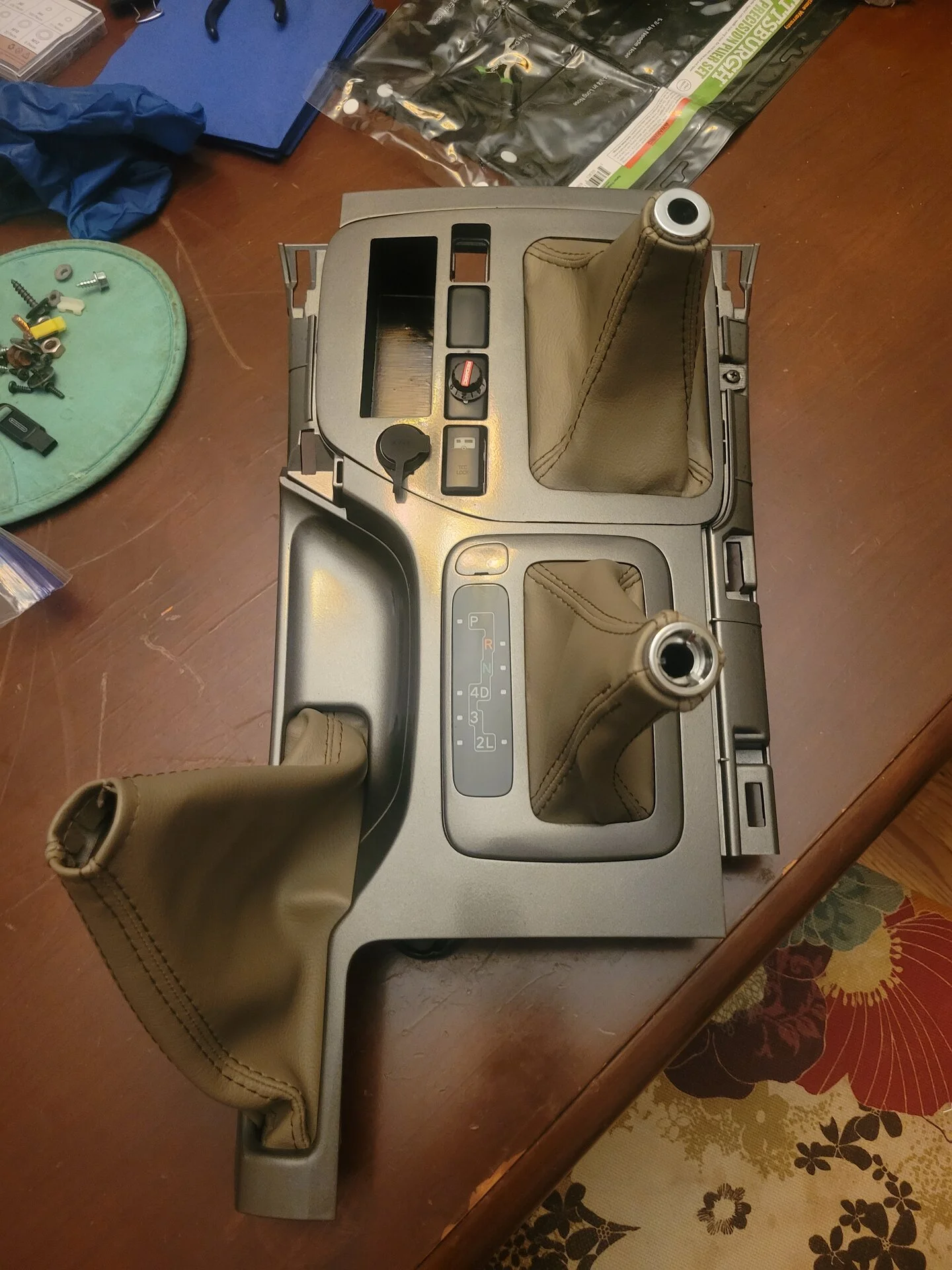

How is this gonna hold up in the heat? It does get hot in MO. I'm keen to get an aftermarket shift knob and will need to come up with a boot solution.
We'll see :). There is quite a bit of spray adhesive in the OEM interior. I think the super glue will be OK since the plastic ring sandwiches it up against the shift bezel. I definitely would have preferred to staple it, but could not find 1/8" staples anywhere.
The boots were a PITA to fit into the console top. The vinyl is a bit thicker than stock so there was less clearance around the ring and opening than stock, especially for the TC surround which was kind of rough due to being 3D printed. Prefty happy with how everything looks though. All plastic was re-painted too.
looks great!
Does look awesome. Curious to see how big of a PITA it's going to be getting back into the car - mainly with the e-brake boot since it doesnt have a zipper for easier install/removal.
It'll probably be a two-person job to line everything back up while guiding the e-brake handle in, but we'll see. Mrs. Rednexus was awesome in sewing the e-brake boot around the metal form, so she'll probably help with that too. I'm surprised how much she's helped on this job in general - maybe she just wants a nice place to spend time when we're dragging the camper cross-country with the GX.
In hindsight I might have had a upholstery shop just make some of these out of thinner material and with a zipper. Or modify the OEM nylon rings by notching them to account for the thicker stuff. I have definitely learned a lot during this project - which is outside of my normal nuts and bolts mechanical wheelhouse.

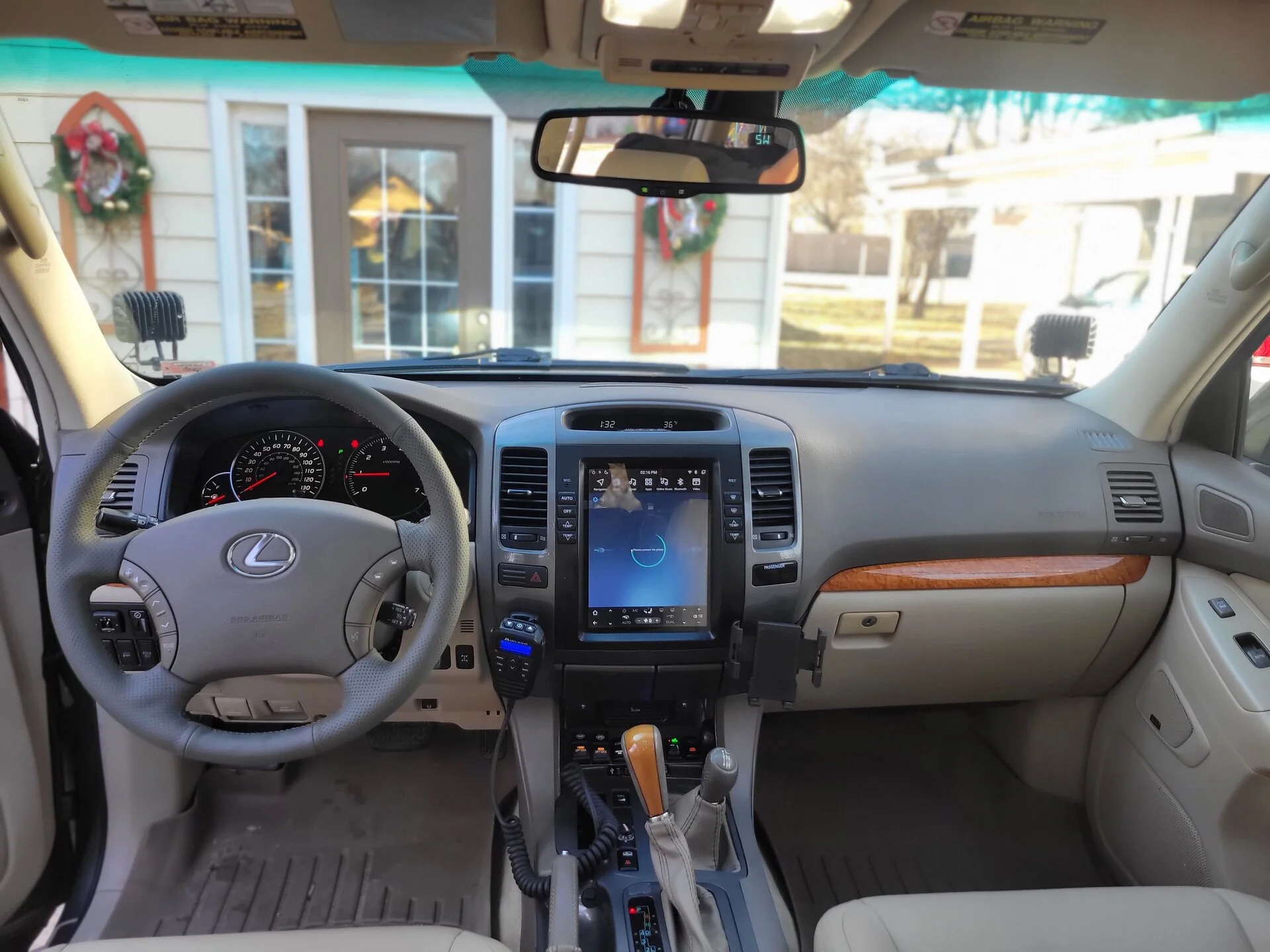

And.....DONE.....with an asterisk :).
^The whole shebang!
^From the PS side. I installed a Panavise phone holder with an AMPS mount. We had one of these in our old Outback and honestly they are great for older vehicles. 5-10 minute install. The new shift boots fought me and Mrs. Rednexus more to install, but we did get them in. Next time I'd suggest notching the nylon ring so it can accomodate the thicker vinyl - then they'd work fine.

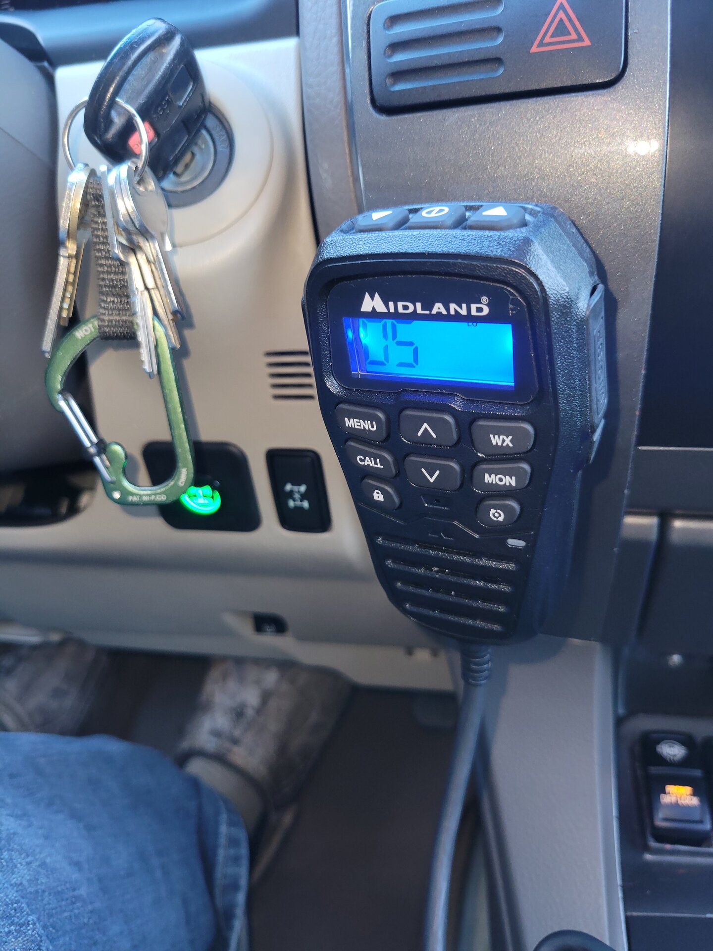

^Midland GRMS mount. It plugs into a round CAT6e connector in the custom center console which runs back to the GMRS in the glovebox. I want to be able to use the GRMS with the rig totally off, so the "GRMS" button in the Prado locker switch blank can be pushed at any time to activate the GRMS circuit. The future "Camp Lights" circuit is also enabled with this relay - those will be scene lights on a future roof rack and probably some rock lights too.
Astute observers will notice I relocated the CDL switch to the 2nd Start location. I mis-counted the number of switches in the custom dash panel and though I had one more than I did. So I got rid of the 2nd start (which I've never once used) and put the CDL in it's spot. Frankly it's easier to see/use there anyway.

^The main event. I did scratch some of the freshly-painted pieces in a few spots upon re-assembly. Honestly it was a b!tch to get everything in place with the custom panels - just a lot of wires in a very small area, so we really had to wrestle with it. The replacement center stack vents were $50 Amazon cheapies that actually seem just fine and fit perfect. I originally got them in woodgrain but the color was pretty far off. So I got them in silver and sprayed them to match the rest of the console.
The twin USB plugs are data/Android Auto/Car Play on the left (plugged into the PX6) and QC charge ports on the right (hot when the ignition is on).

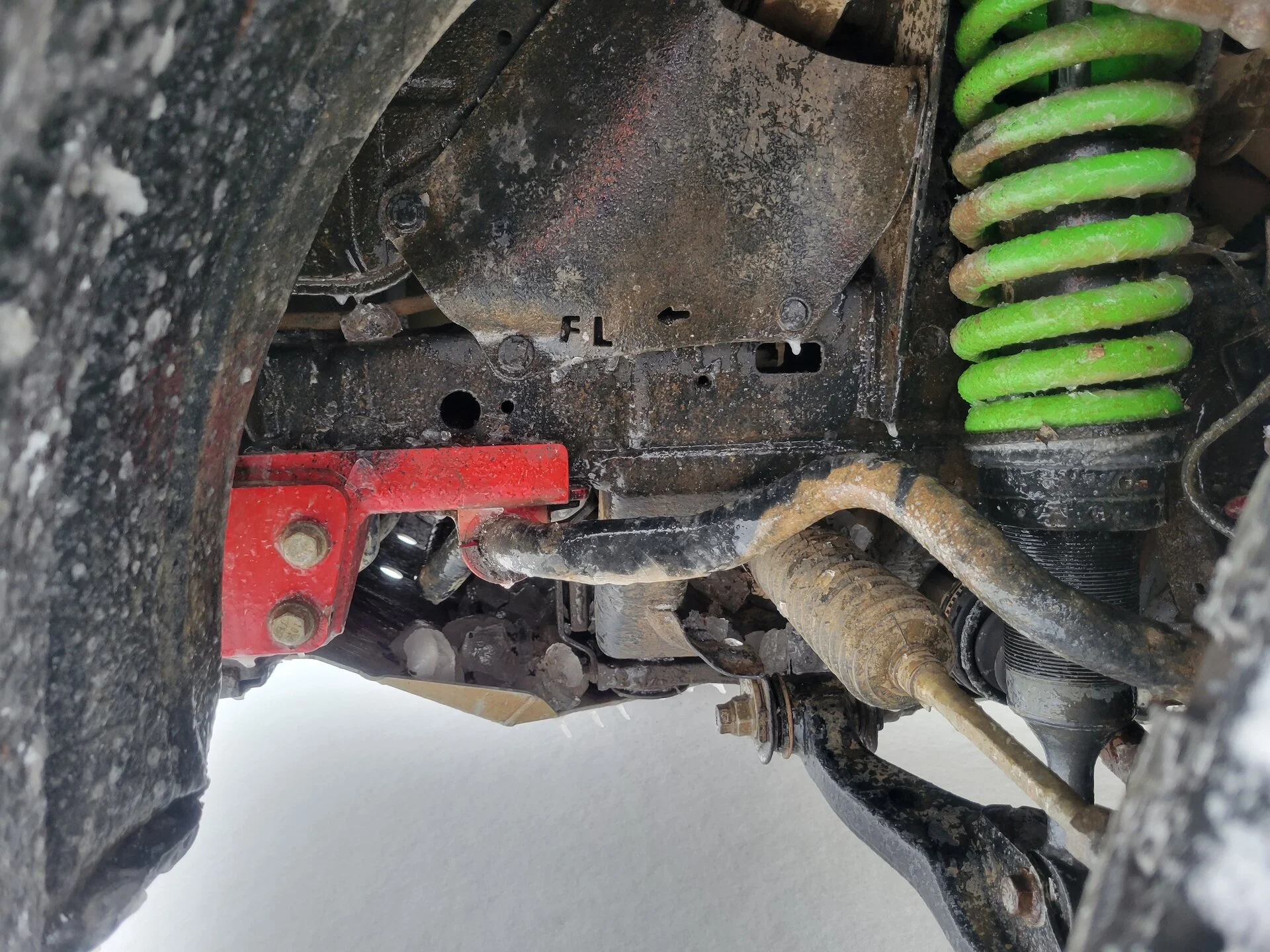

Also if you do a creek crossing at <10F, you may hear some rattling that sounds an awful lot like a broken suspension component shortly thereafter....
I’ll pass on the ice cubes in the skid plate for now!! I noticed your lower shock eyelet bushing looks collapsed or worn badly(?). Hopefully it’s just the angle of the picture.
Good eye and I had not noticed that! Just braved artic temps again to look at it - the bushing appears kind of squished out but not collapsed. Wondering if I over-tightened the lower bolt when I put the shocks in a year ago or so. Don't recall if I used a torque wrench or just hit it with the M18 impact. I may pull it next time I'm under the rig to make sure there isn't a deeper problem.
