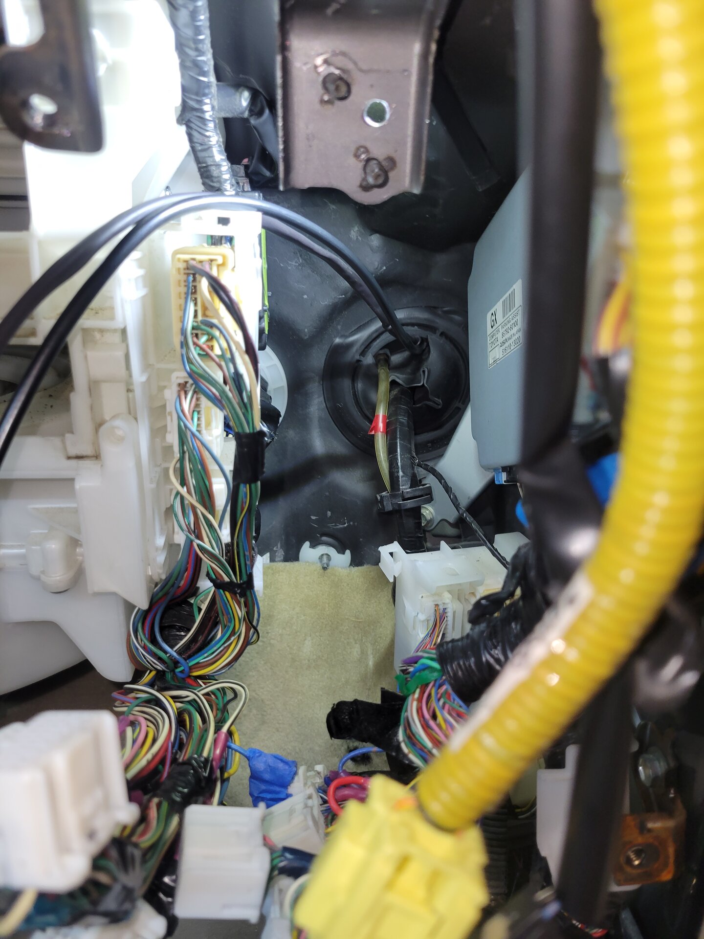

New HVAC servos were a bear. 90-degree ratcheting screwdriver from HF made the job possible. On the plus side, removing the ECU to replace Servo 19 let me realize that the PS large firewall grommet had a place to feed new wires through. So I did some Christmas eve fishing....red and yellow for future lockers, and mini-coax for the GMRS antenna.

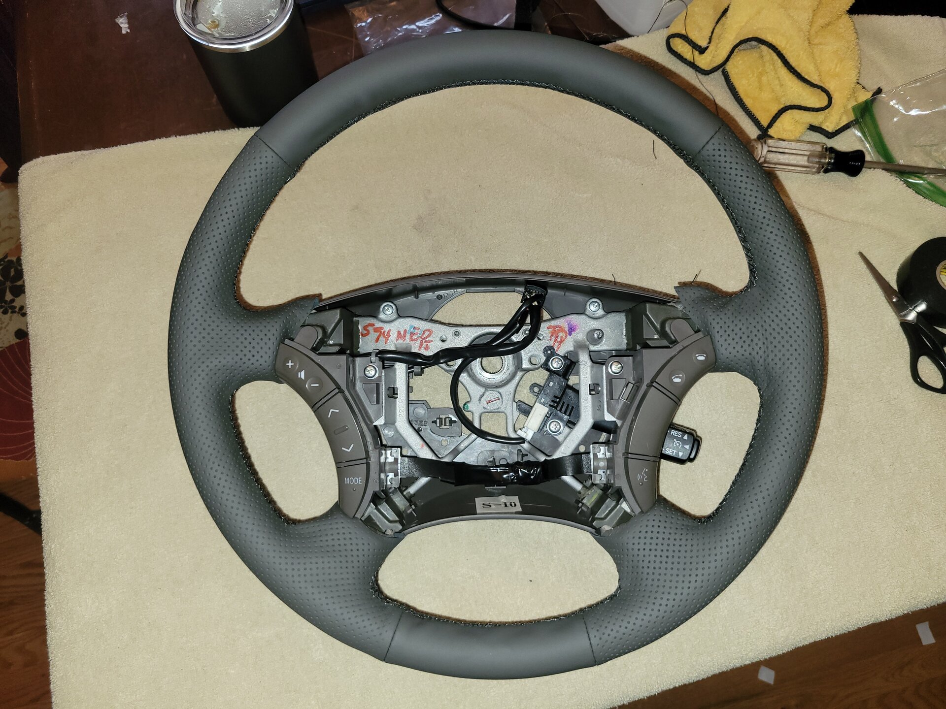

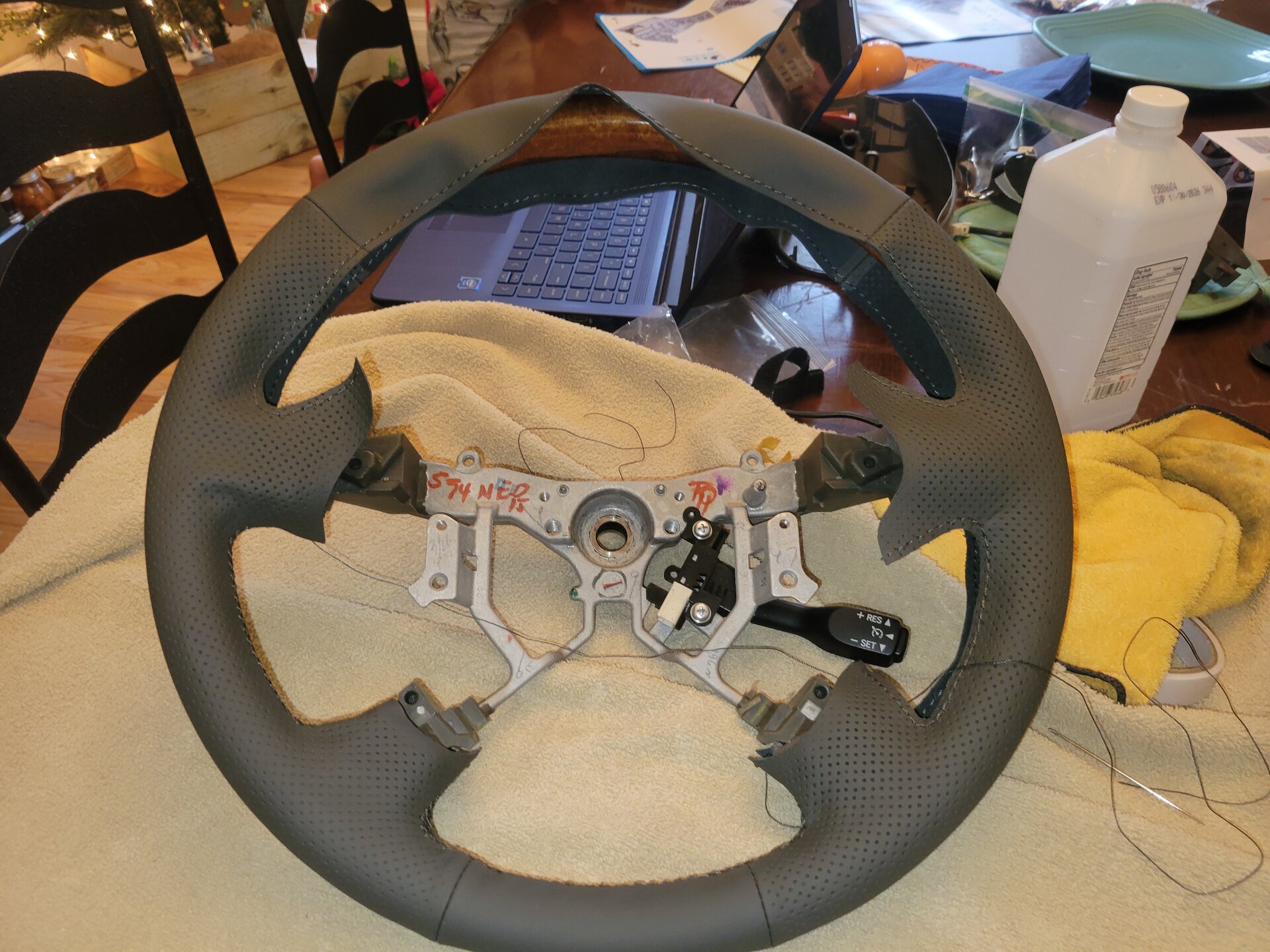

....and Merry Christmas! Santa's sleigh dropped by (decked out overlanding style - with a rooftop tent and awning) brought me a Loncky steering wheel cover. I had wanted to keep the woodgrain and send the wheel off to Craft Customs in Dallas, but the 2-week wait and $350 were kind of hard to swallow. For $65 this is a really nice cover. Mrs. Rednexus helped get me started and helped finish each of the stitch sections, but I stitched probably 80% of it myself. Took around 3 hours sitting in the house, while the kids played with their Christmas presents.
It looks probably 90% OEM in terms of fit finish, and it feels awesome (as good or better than the leather-wrapped wheel in our '23 Highlander XLE). The leather is really thick, and is smells like a new pair of boots. The grey is a little darker than OEM - don't think this is a huge deal is it should match with the resprayed console plastic, although I would have preferred a perfect match. I'll miss the look of the wood but honestly this leather feels way better.
I think if someone meticulous with the stitching and spent and extra hour you could get one of these to 95%+ of an OEM look in terms of fit/finish. The cover is cut that well, it's just that the stitching/positioning can be kind of tricky to get perfect. Seeing the labor that goes into one of these, $350 from Craft Customs is probably reasonable for paying someone to get it perfect for you, but it's also not hard to just sit at the dining room table and knock this out instead of binging on Netflix.

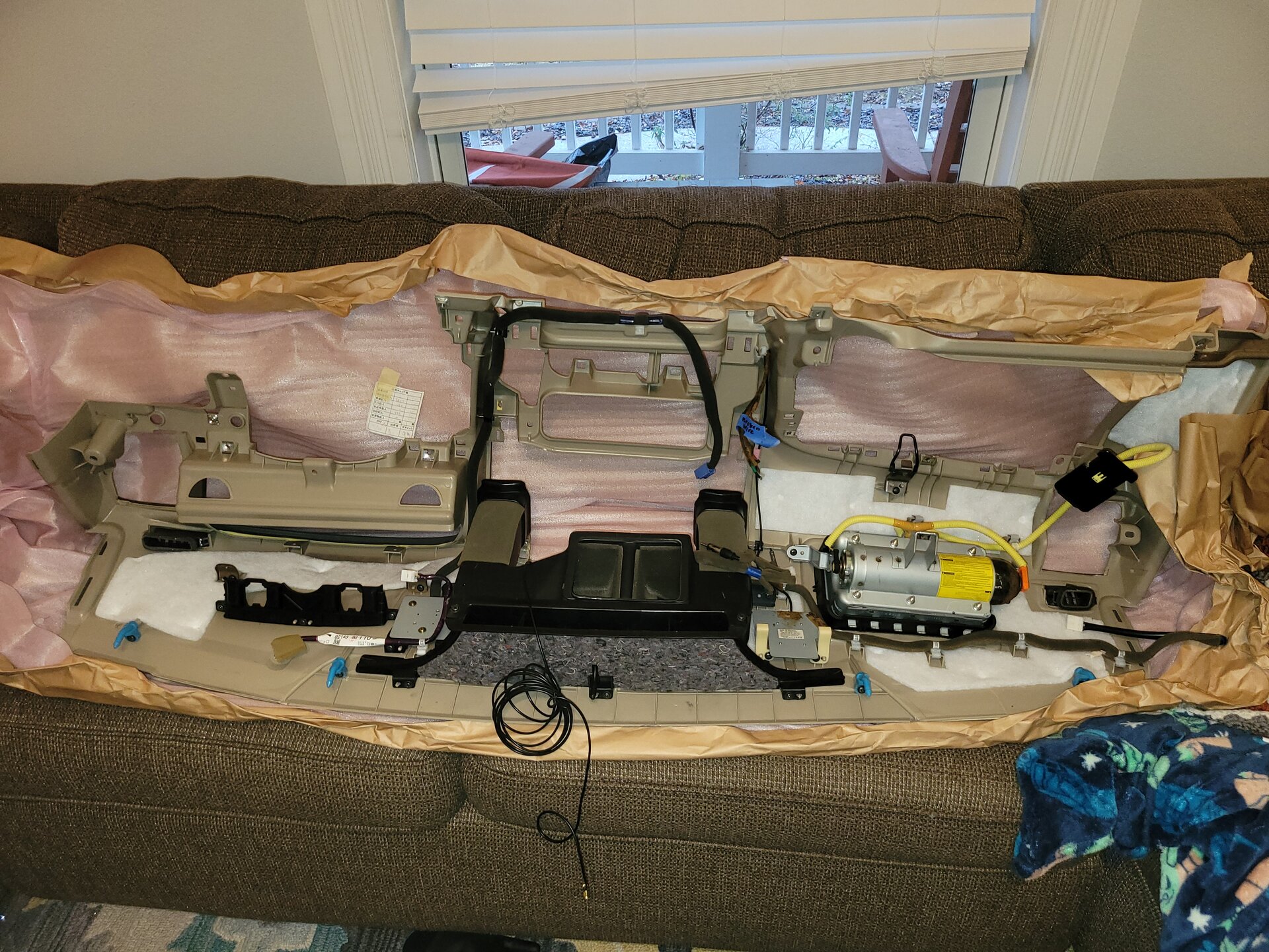

^Transferred everything over to the new dash this AM. Off now to do a final test of the new electrical systems and then start reassembly.
