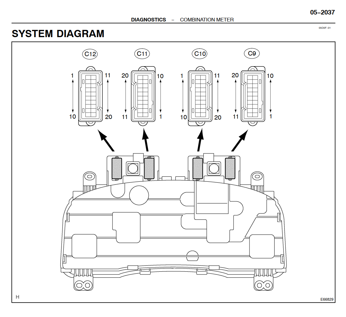

Edit/update - did a quick check of the FSM for the instrument cluster wiring and I read it backwards :facepalm:. What I thought was C11-Pin 15 (skid control ECU - speedo input) was actually C10-Pin 5 (tire pressure warning switch) so I spliced into the wrong wire. No wonder the speedometer is working but the SpeedoHealer is doing nothing!
The FSM system diagram (see below) is looking at the back of the instrument cluster, not the connectors staring you in the face when it's removed. So it's a mirror image. Should be an easy fix tomorrow.

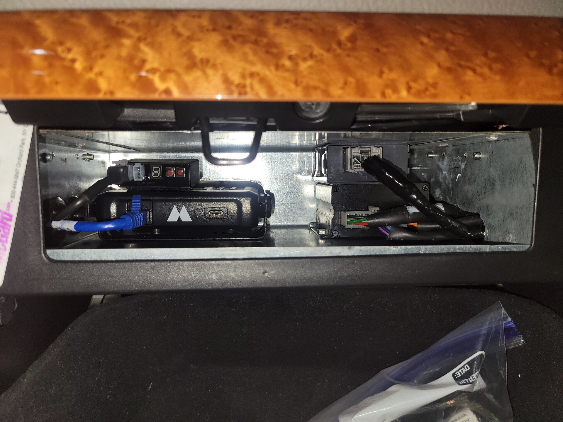

i used the posi locks to splice into wires. space is very tight back there as you probably already know. I mounted my "speedohealer" to the firewall using some 3M VHB tape. I've started using that stuff for everything.
I typically use heat shrink connectors but that might be hard with the dash on. Ended up putting SpeedoHealer the in the cubby where the DVD used to go, but its getting pretty full now! I'll get some posi locks if the heat shrinks aren't workable.
^SpeedoHealer, GMRS, WAT lockup switch controller, and a relocated CANBUS gateway.

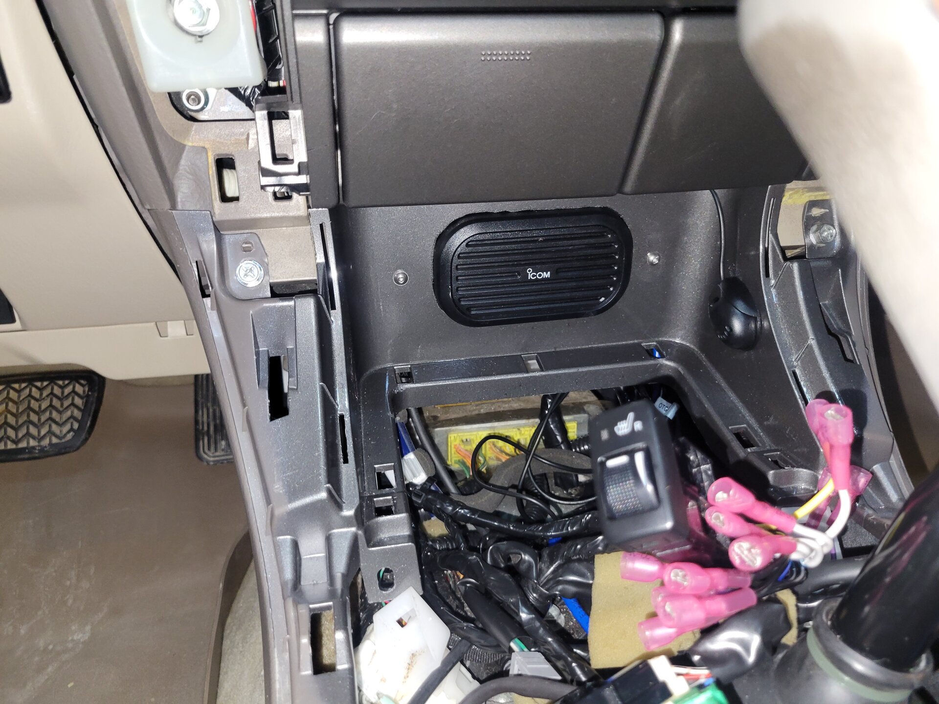

^Hardmounted GMRS external speaker. Required relocating the CANBUS gateway and notching the new dash plastic behind the console.

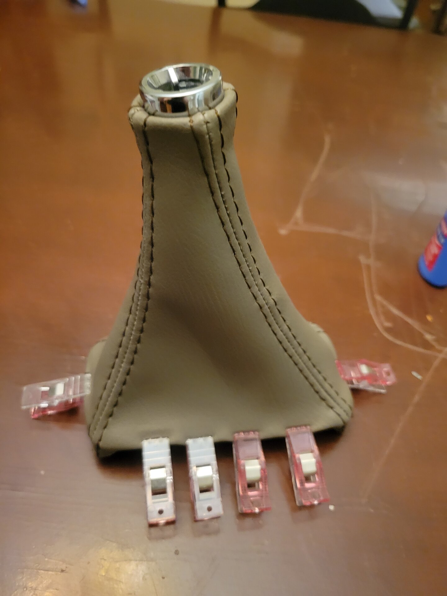

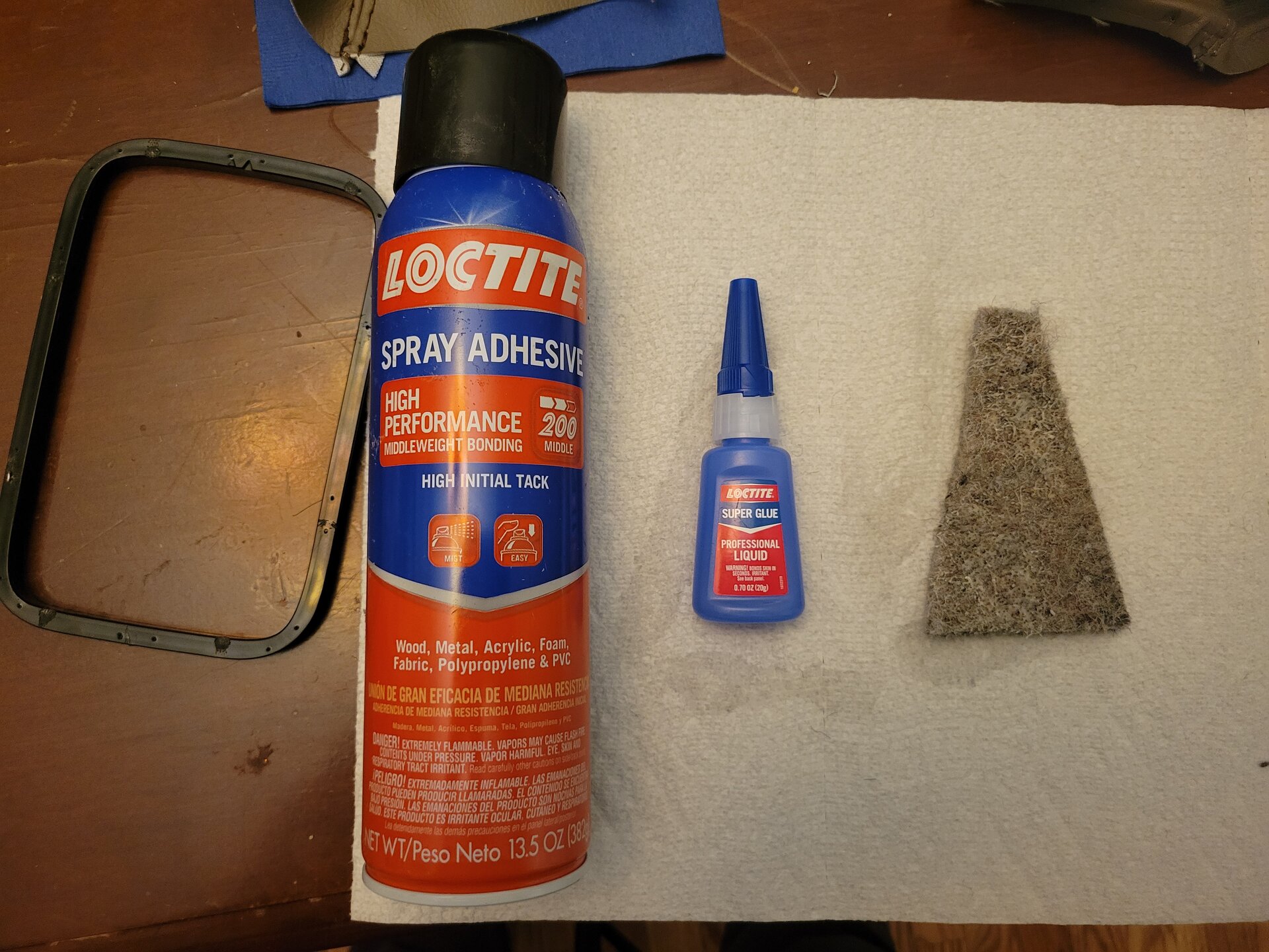

Working on the new eBay shift boots. They are cut/sewn perfectly but require some work to mount. The OEM boots are stapled to a plastic ring with super-short (like 1/8 inch) staples, which are very hard to come by. So I'm super-gluing the new boot to the old ring.

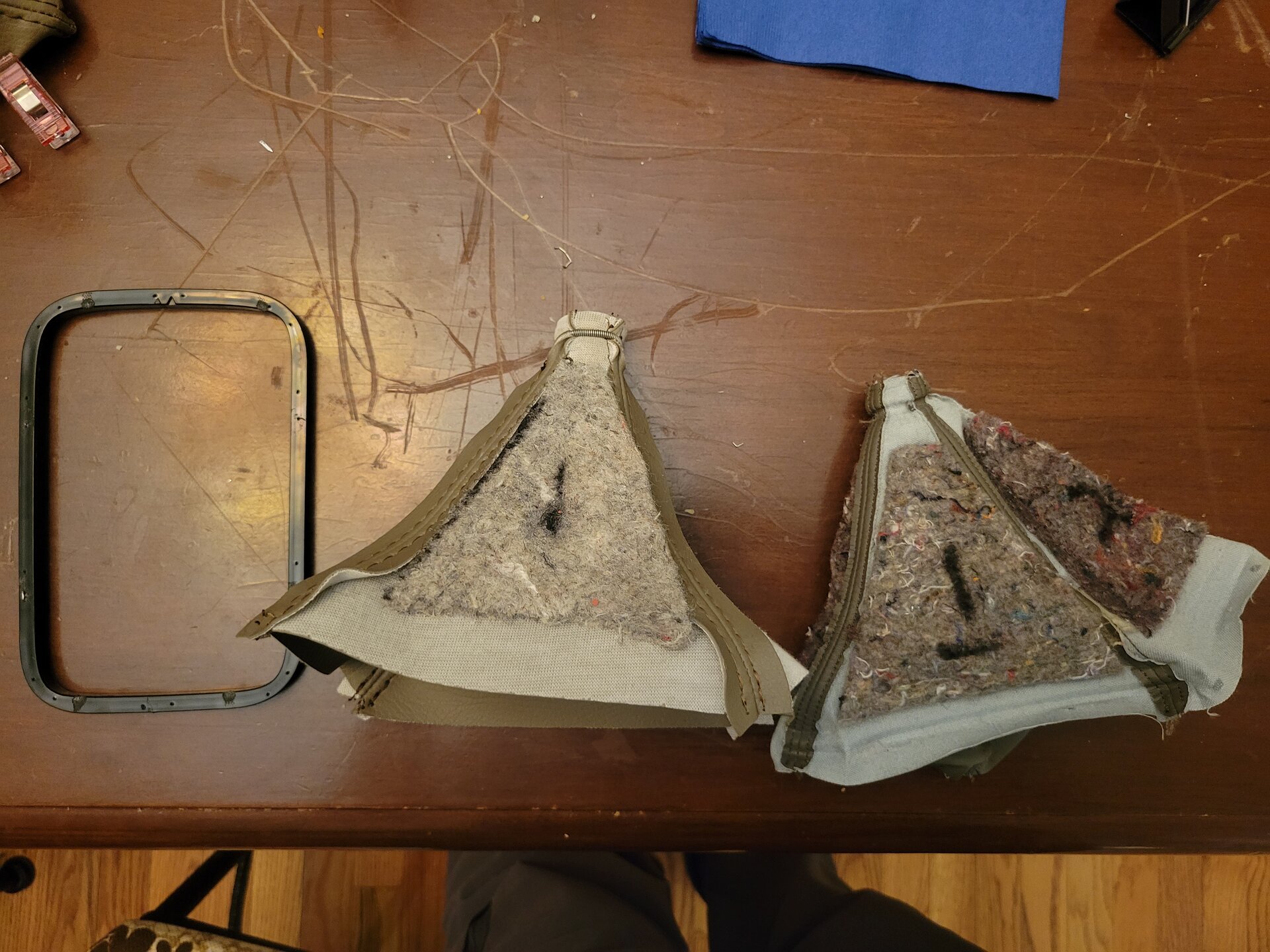

The TC boot had some jute padding on the inside, which the new boot did not include (old on right). So I bought a yard, cut some new pieces, and attached with spray adhesive.

What glue are you using? I really wanna replace the boot on my 460.
You should do it :). Not a hard job so far and pretty cheap.
