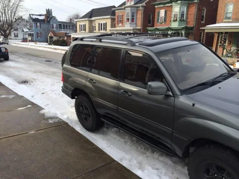

Redid my tint and found a very close match...

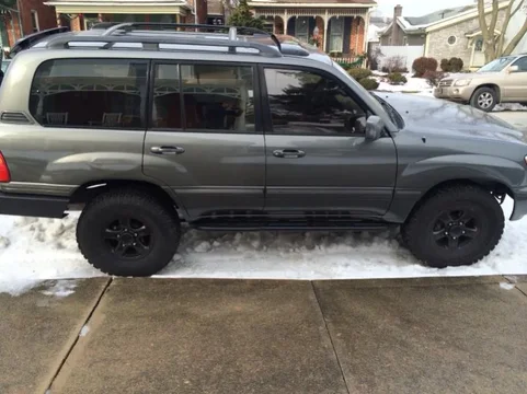

Limo tint on the back will definitely help...it is not a perfect fix. I installed charcoal 20% in the back and 35% in the front. On cloudy days and in a few other unique lighting circumstances, the match looks extremely good. In direct sunlight...not so much, but I think many would say the same about even the best bronze tints that attempt to match the color. I think that my real problem is due to the chrome/mirror/reflective nature of the OEM tint, not necessarily the color.
I obviously could have gone with 5% in the back rather than 20%. The OEM rear tint measured at 24% (presumably making me 4.8% now). It looks black (with a chrome/mirrored finish). I don't think you can see in at all, ever, and I certainly don't have trouble seeing out in the day. Personally, I've yet to be bothered by it at night, but I don't drive much at night or have kids watching DVDs in the dark. I've also lived in Las Vegas and been trained to believe that limo is the only rear tint that provides adequate protection. 4.8% sounded dark enough to me and I had some safety concerns about 5%x24%=1.2%. Other posters (and my installation shop) provided the same caution. I would definitely give consideration to 5% if I had to do it over again, but more-so because I don't like so much sun in the car, not because I really think it will help the tint match.

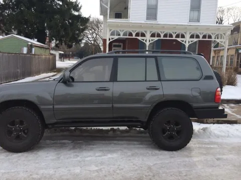

I'm out. Found a shop while I was in atlanta that did it for me. It's shops but not perfect match. In some lighting it looks great and in others not so much. That said i thinks it's the best option by a large margin!

If u guys read through this thread you can see some decent options for getting the windows black shaded. The problem in most cases was that it took a very dark tint to overcome the factory mirrored bronze. Some folks didn't mind it too much but the general consensus was that the viper ceramic was by far the closest match, with the only drawback being it is not quite dark enough. There's some great before and after pics of the various options though.

Looks good Fireball, is that the Viper Ceramic mentioned earlier in the thread?
