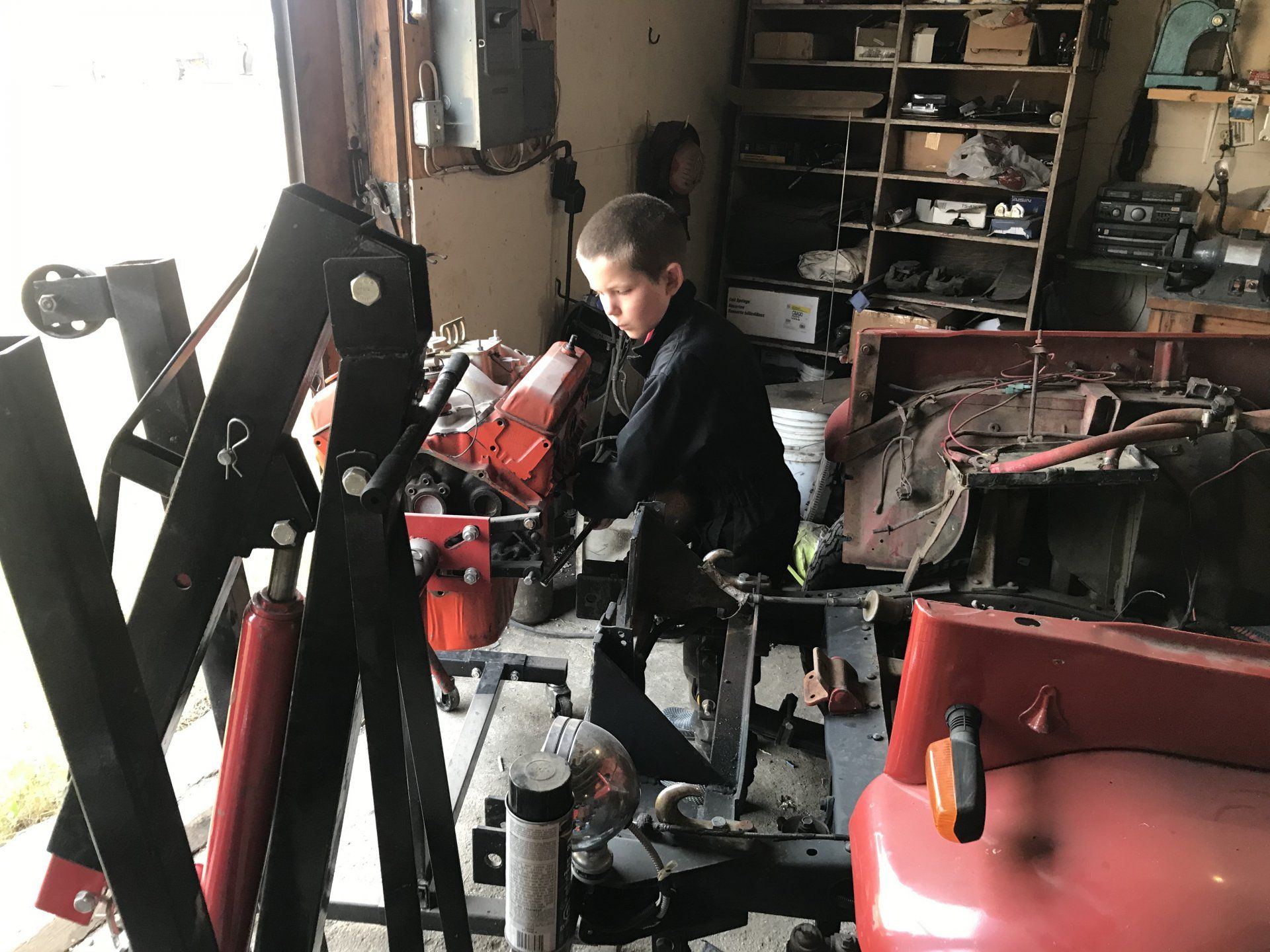

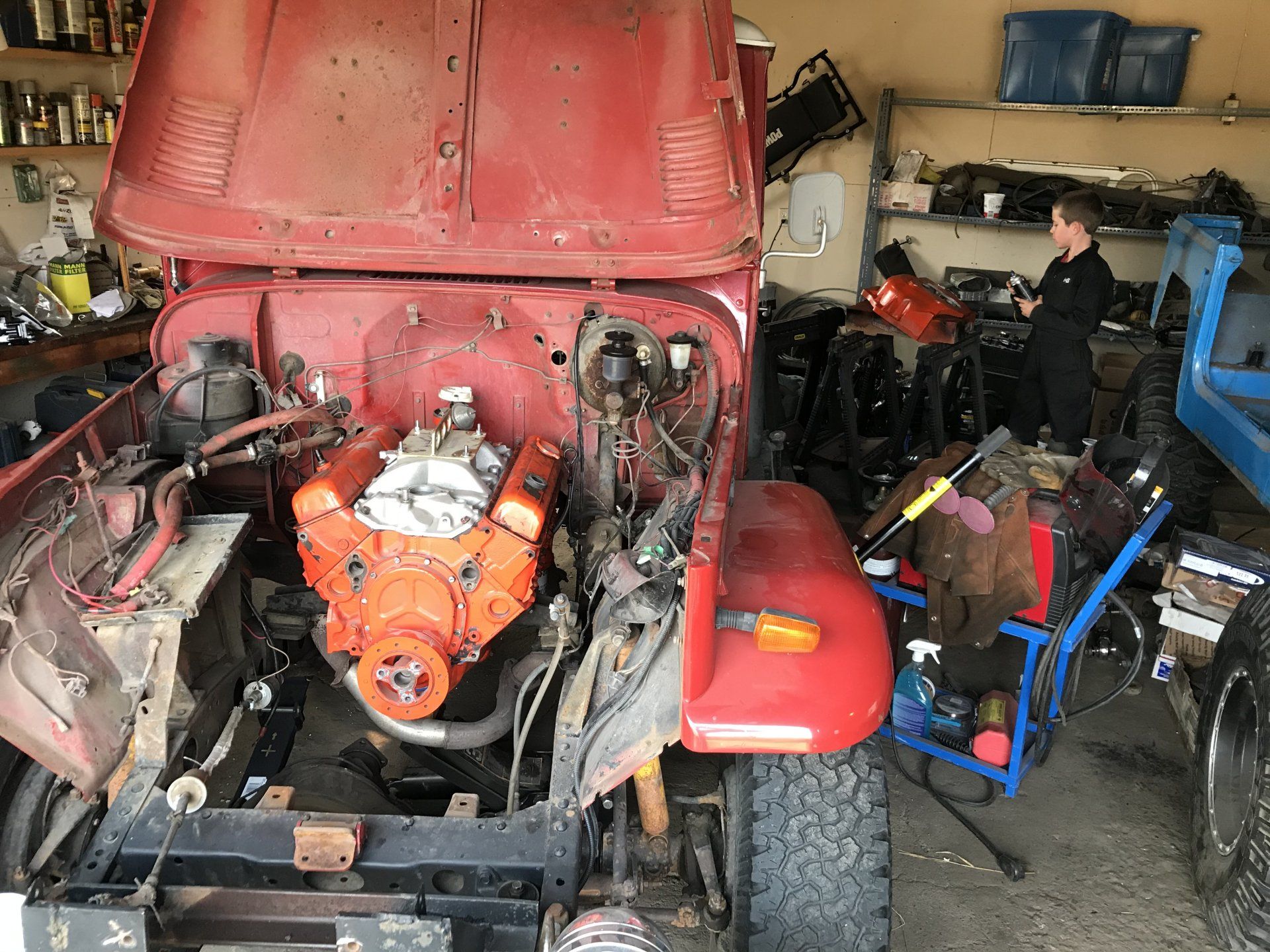

motor mounts gusseted and welded in! my engine is now in place!
and there’s lots of room along the fire wall and my fan fits without hitting the rad and my shifter doesn’t hit the heater! this just might work out!!
i did have to cut off the battery tray that was welded to the frame to get in there 🙄. there are so many things done poorly on this truck. little by little i’ll get them sorted

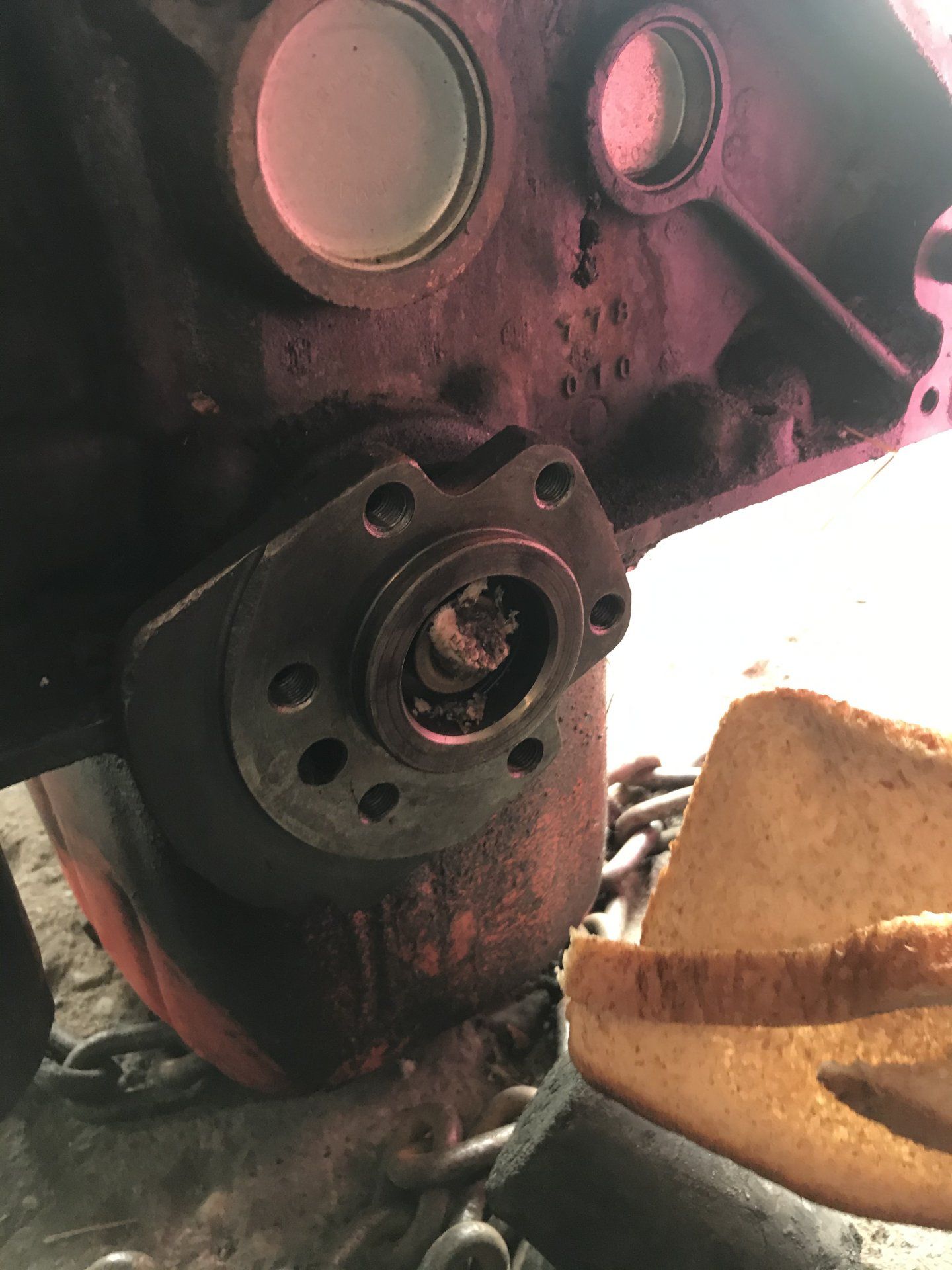

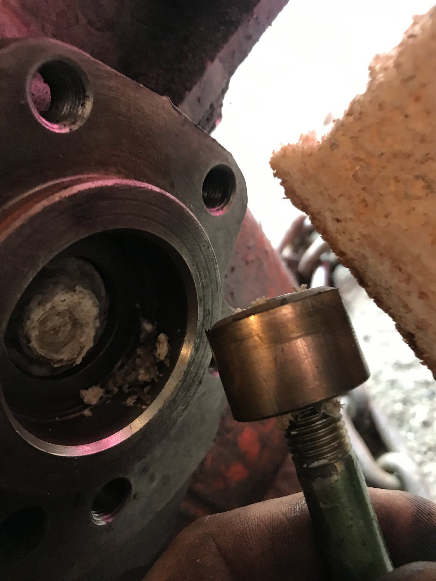

new 350 set in place. used the bread technique to get the pilot bearing out and put in in the new engine. fly wheel clutch and pressure plate on. next this afternoon is transmission. hope it all fits!! i may need to make some adjustments to the fit of motor but once the tranny is in i’ll do that.
View attachment 2440183View attachment 2440184View attachment 2440185View attachment 2440186
I've never seen "bread" used to remove a First Motion Shaft Bushing.. Neat! I have used a pile of wet Kleenexes.. It's pretty "soupy", but gets the job done (same with plain ol grease!)

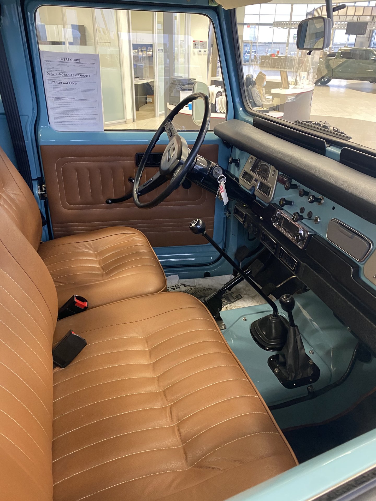

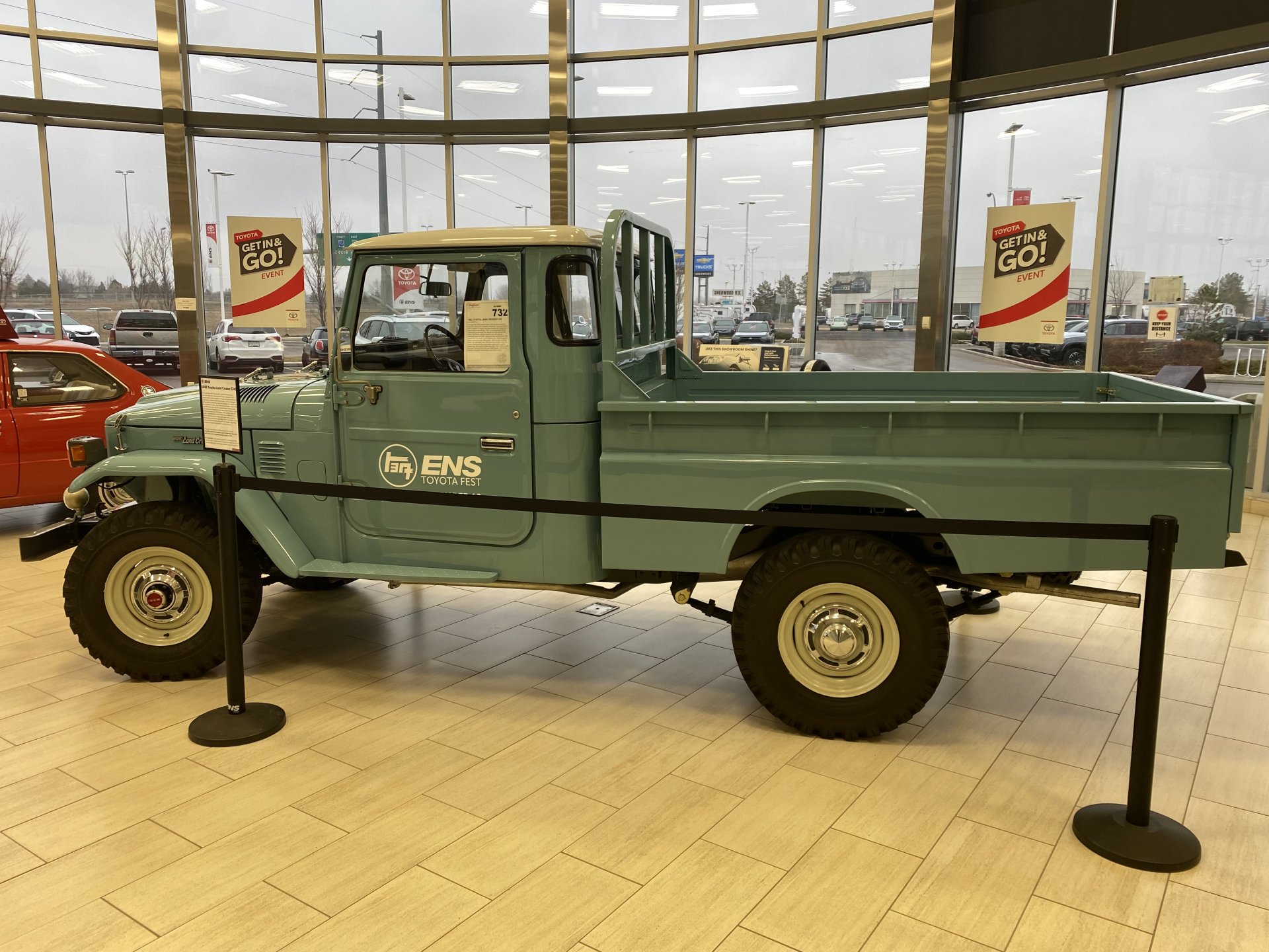

not really related to my build at all but didn’t want to start a new thread just to share these photos.
they are of a beautifully restored 82 by the owner of ens toyota. they started selling these to the underground mines here in saskatchewan in 1976. they still run ens industrial which has been a huge supplier of landcruiser parts over many years. unfortunately the mines are going to electric so my local parts options are dwindling! they still have some stuff though!

not really related to my build at all but didn’t want to start a new thread just to share these photos. View attachment 2835587View attachment 2835588

Yes ens used to supply 45s for the mines. They would sell off the beds and heache rack for 2k or less cause the mines wanted flat decks. I know a guy who got 2 complete beds off them back in the early 90s or mid 80's. The 45 in the showroom was purchased at BJ auction a couple years ago for north of 100k

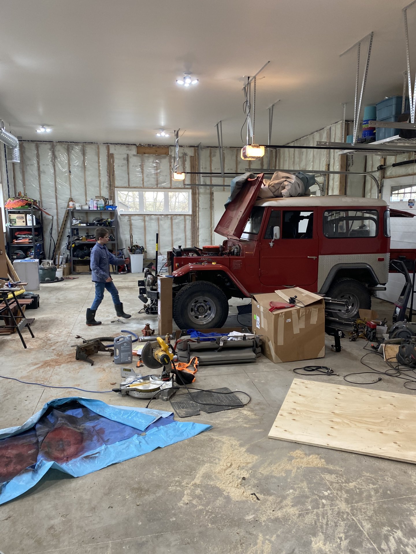

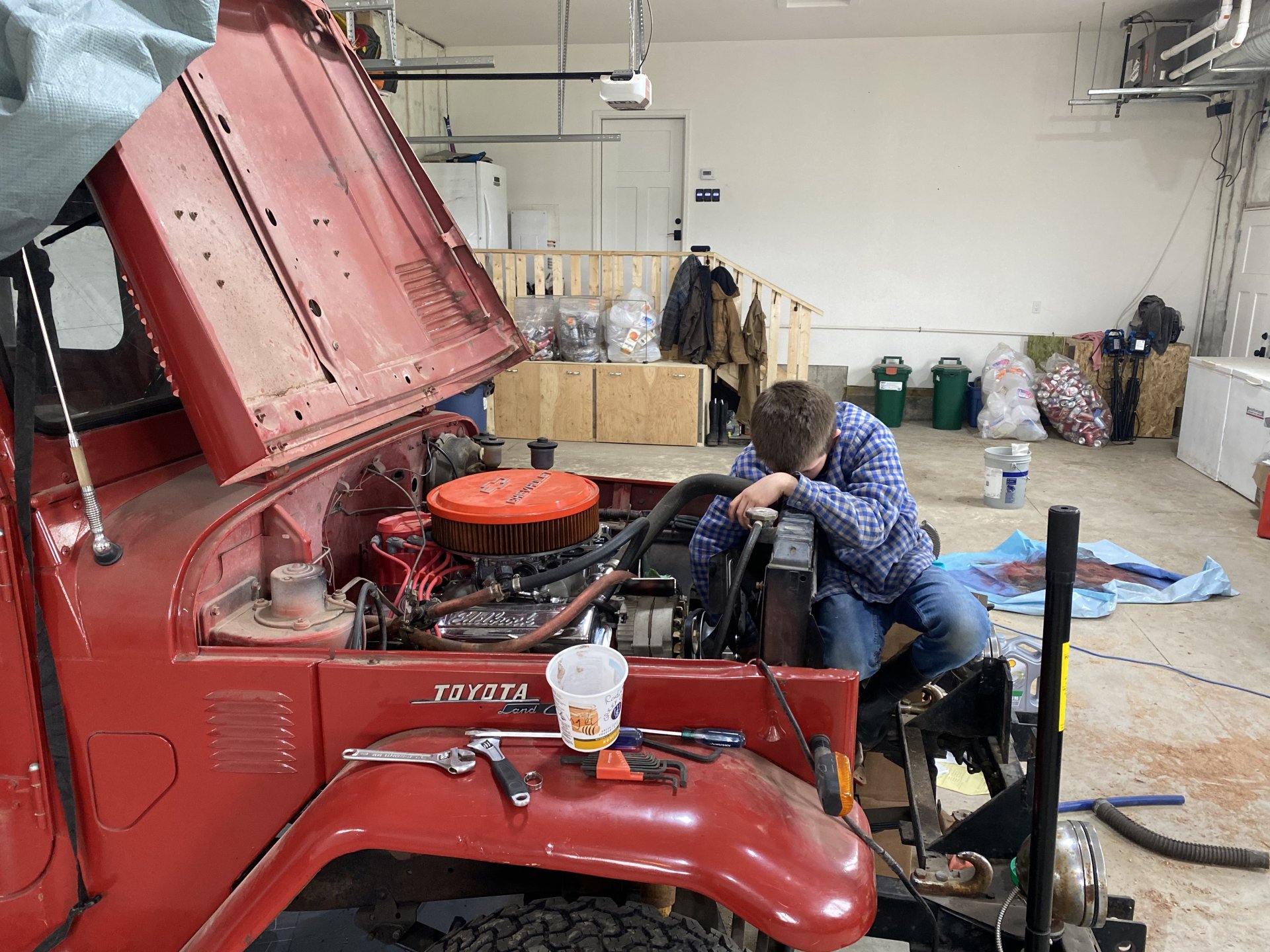

got the clutch line built installed and bled! my clutch works!! so pumped about that i i wasn’t sure when i went to i stall it. i can have my son press the pedal and when i turn the output flange i can see the clutch plate spinning. clit h out and it all locks up! that’s a relief as i didn’t really want to drop the tranny again to put a new clutch in.
we also got all the engine plumbing done and some new fire wall grommets thanks to @Racer65 . exhaust was lengthened 4 inches for the new engine location. radiator installed. now i think i just have to sort out the rats nest of wiring and we’re in business! (oh and i have to adapt my 77 ebrake cable to the 72 pull handle)
sorry garage is a mess from another shelving project i’ve been working on. just overlook it!! 🤪
