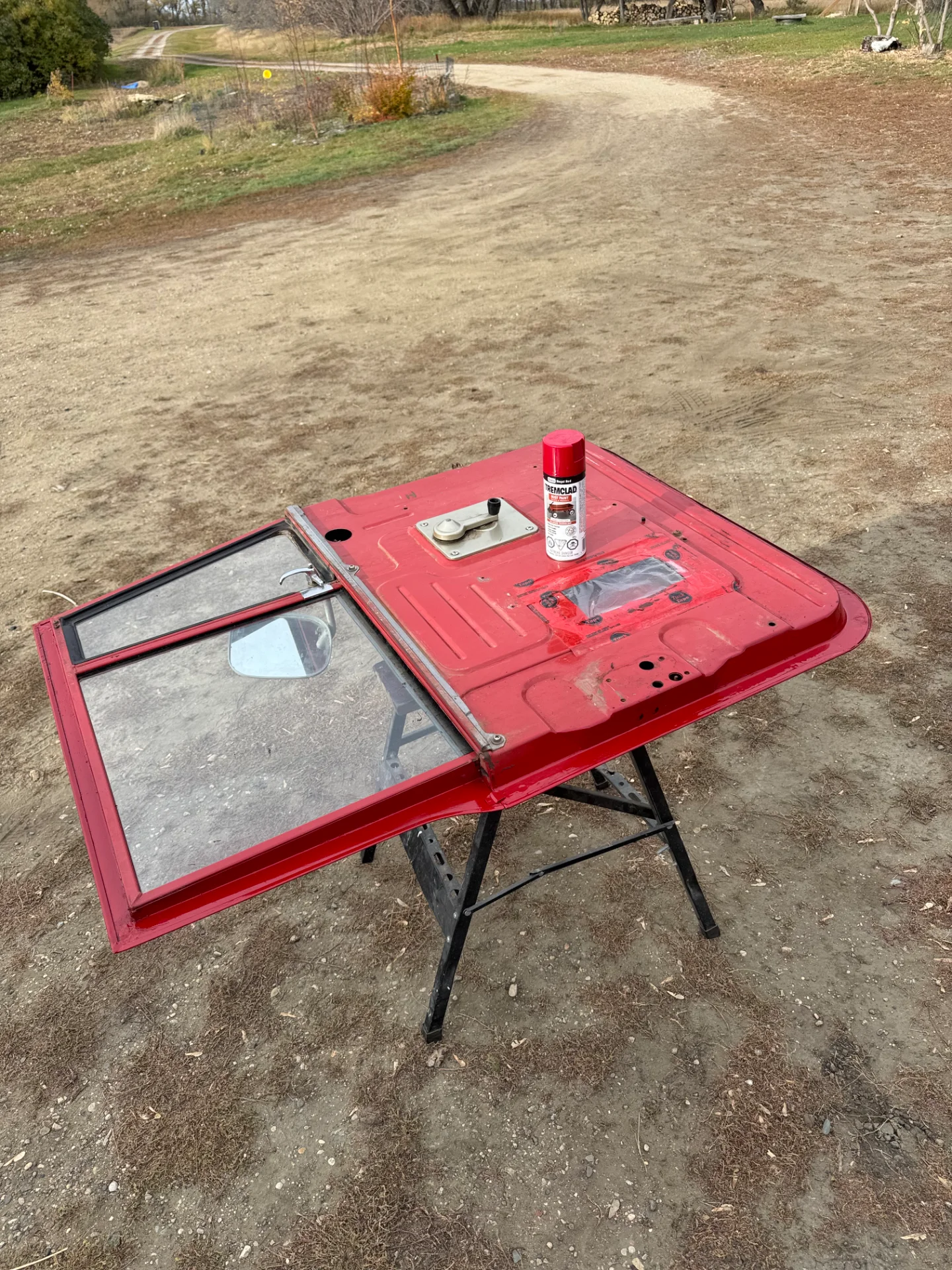

with winter coming though i need to get door seals done. i did some of them a while ago but didnt prep it right and didnt glue it right so they didnt stick. live and learn. the adhesive is supposed to be used like a contact cement and not just a glue. i guess i should have read the instructions. i’m also trying to clean all them oxidation off the paint this time too to get a better bond. so here’s door number one getting cleaned up again
