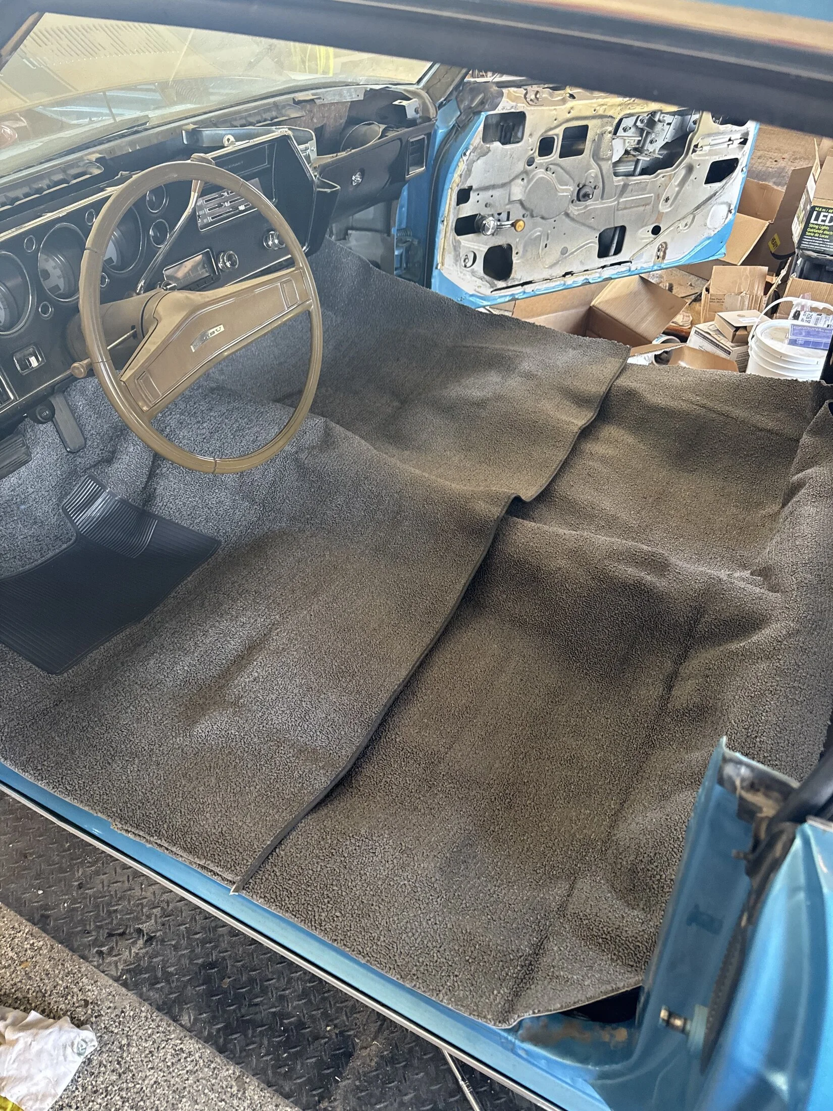

played a little with the fan shroud. it’ll fit side to side but my fan on the 350 is a little too low. i’ll have to make a bracket that’ll drop the shroud down a little. it’s probably less than an inch or need but i’m using the 40 as my daily driver so can’t take the time to actually pull the rad etc. it’ll be a project for when i have my other cars running. today was sound deadener and carpet in the chevelle day.

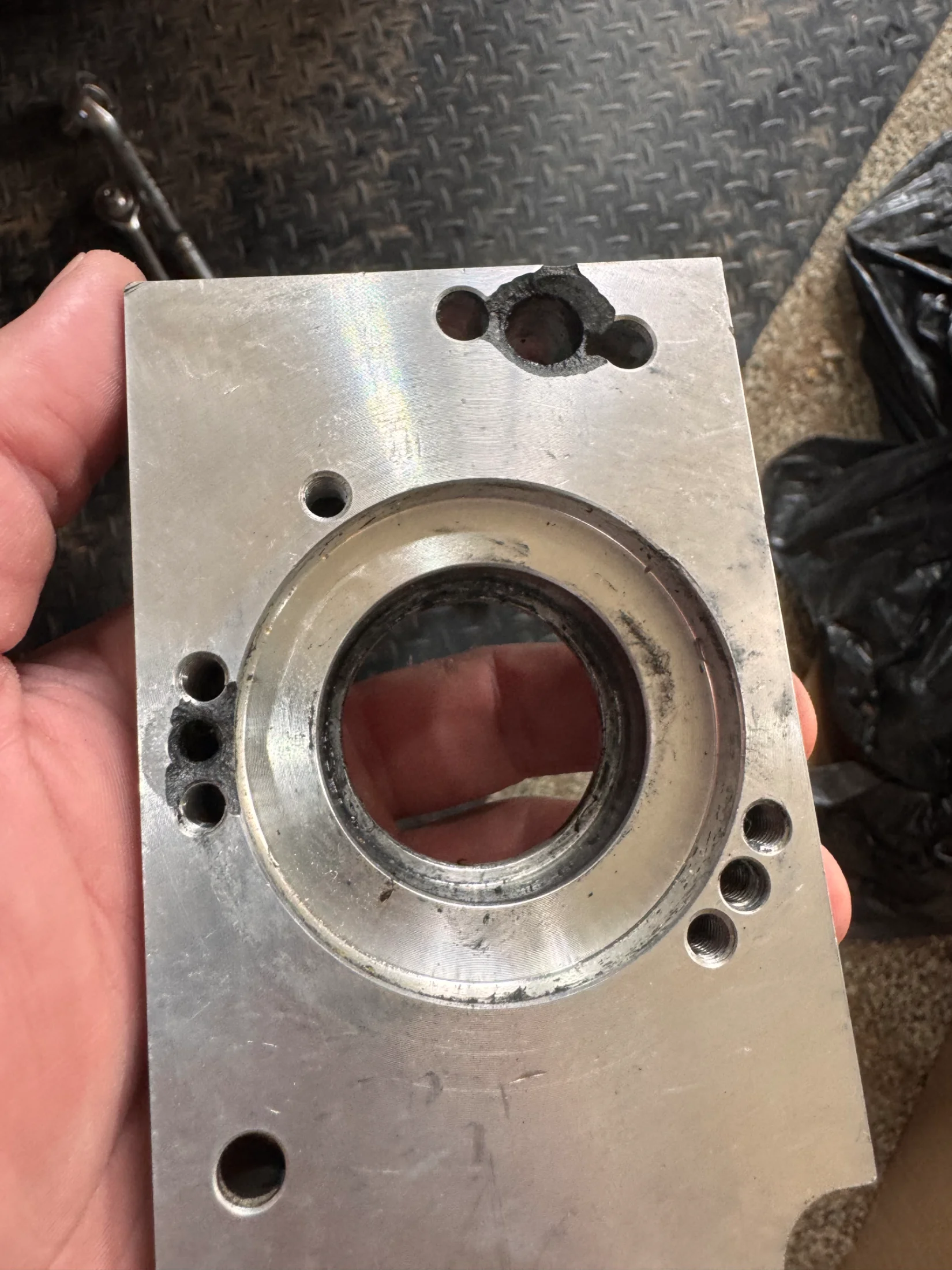

went to drive red to work sunday and my starter literally broke in half. heard it just free spinning so climbed under and the body was hanging off the wires and the mounting block was still on the engine. it’s a proform mini starter. the mounting blots pulled right through the aluminum mounting block. they must have come loose at some point. anyway for a new starter and my son had it installed in the time it took me to pull a stone out of my wife’s sienna brakes!
you can see where the aluminum failed and the bolts pulled out.
proform will sell me a new mounting block for about $10 so i’ll do that and keep it on the shelf for a backup

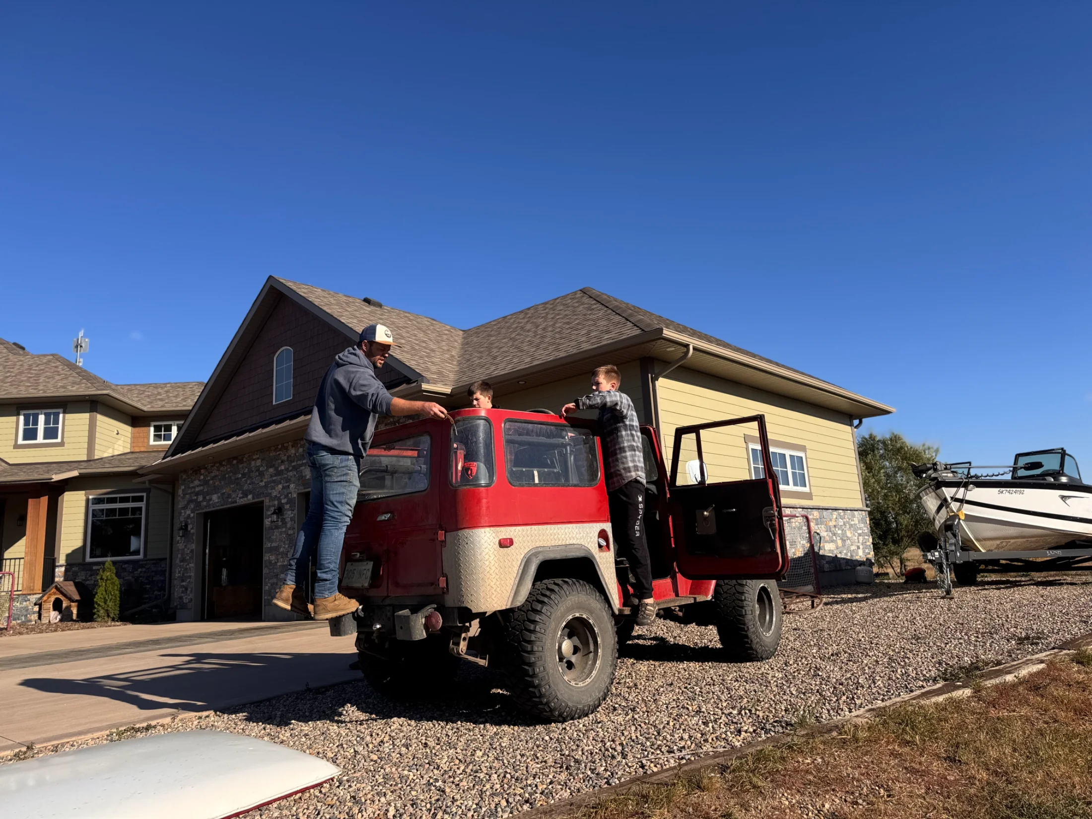

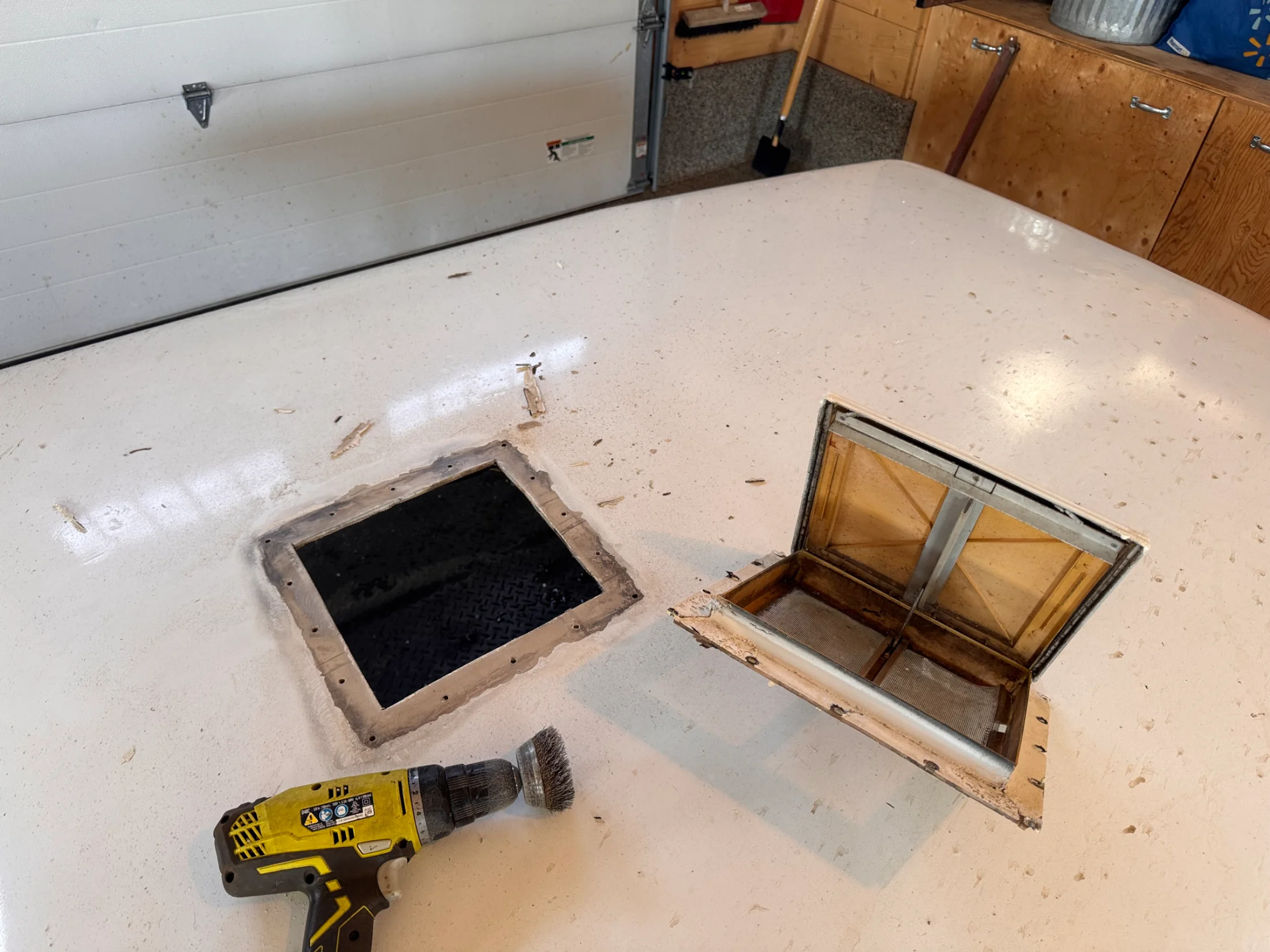

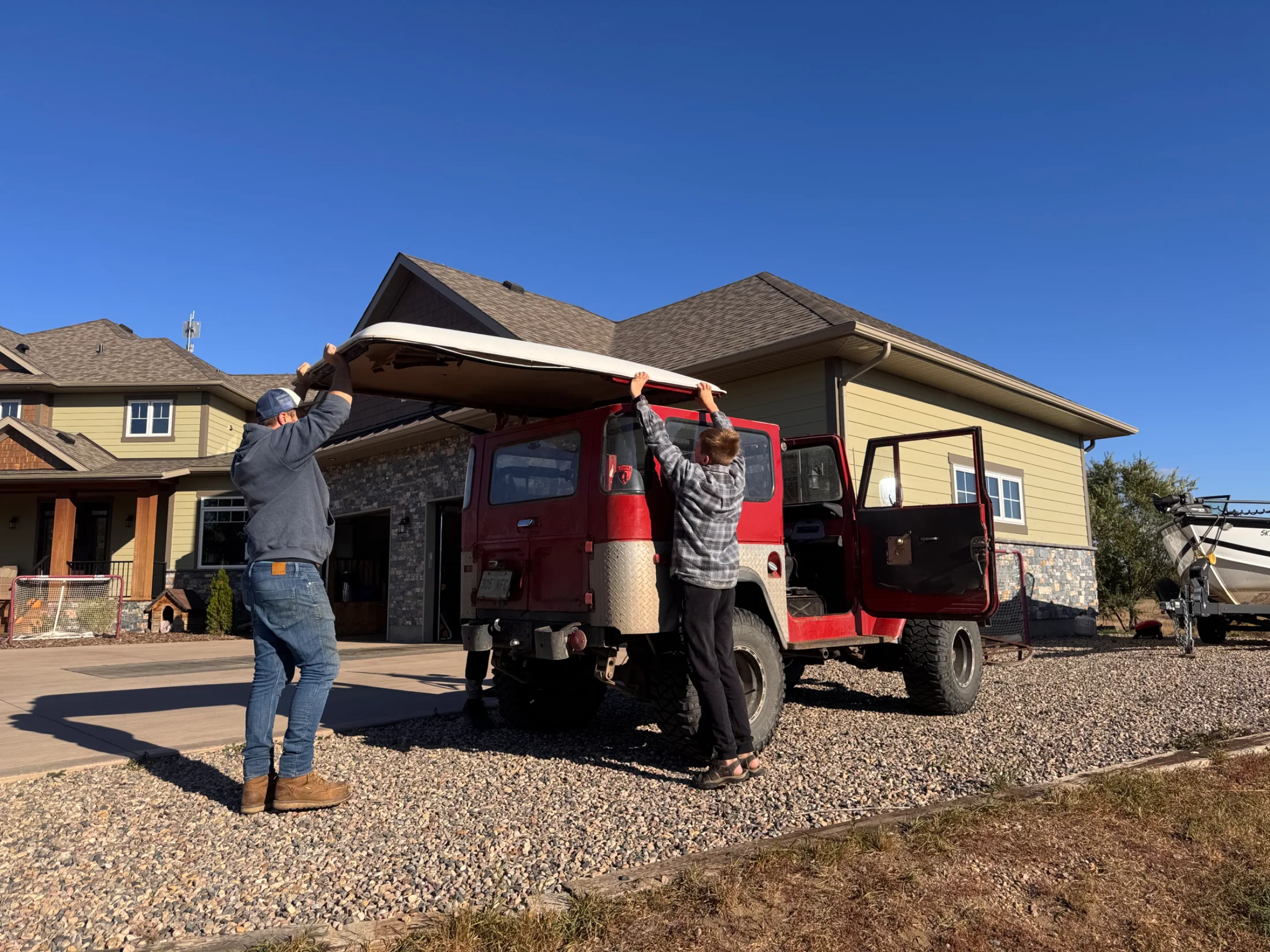

now that i have my fj62 back my son wanted to start pulling red apart to get it sealed up properly. first thing was to take the roof off to patch the sunroof hole a PO had installed that leaks like crazy! so today he pulled the roof off

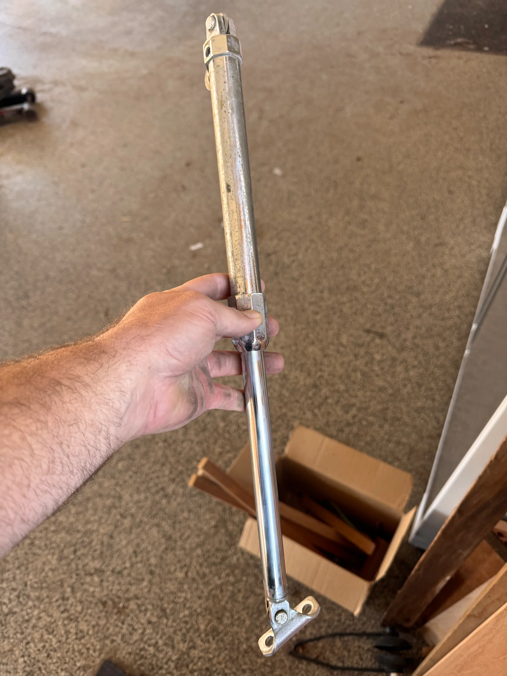

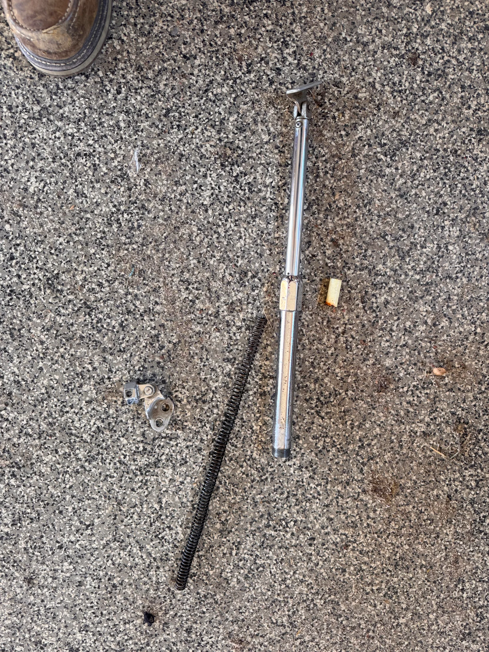

we also put some gas struts in the chrome tubes of the rear hatch

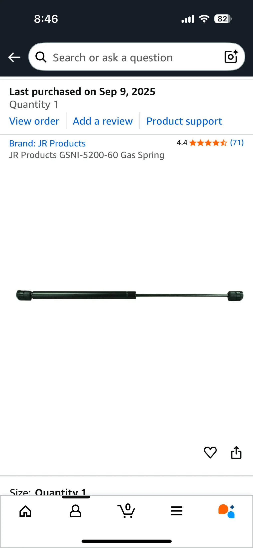

i used these gas struts
you just have to take off the plastic caps
on the ends and they fit perfectly
