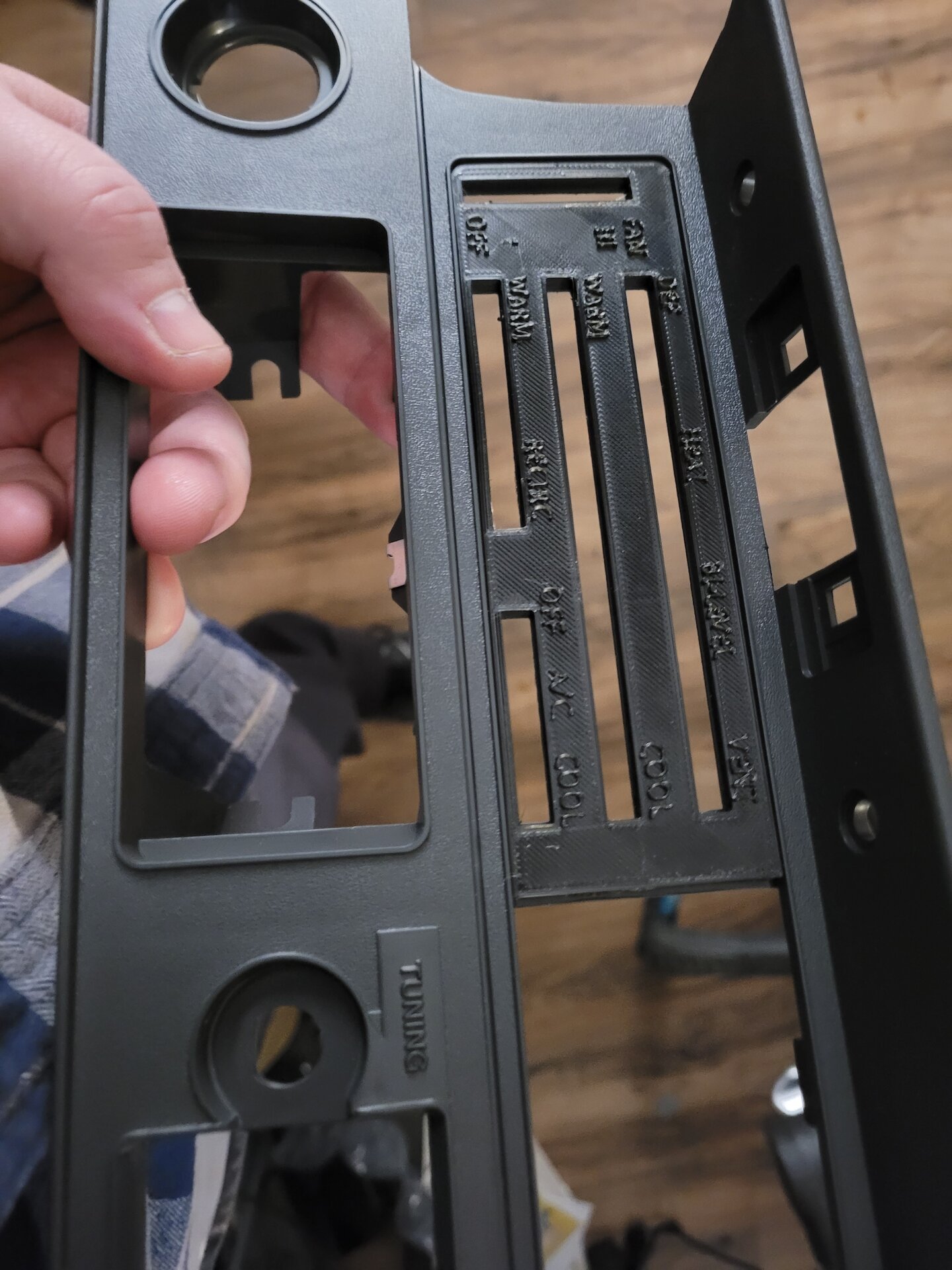

2. My truck is a 79 but I bought a new dash bezel for a 81-83 I think. I was going to Vintage Air for A/C so this style dash bezel worked better for my needs with the opening for A/C controls instead of solid area with openings for sliders. This came without the cubby above the radio so I 3d printed a bezel for Vintage Air controls that screw right into the bezel and 3d printed a cubby that is deep enough to hold my phone and I added a mag safe wireless charger.

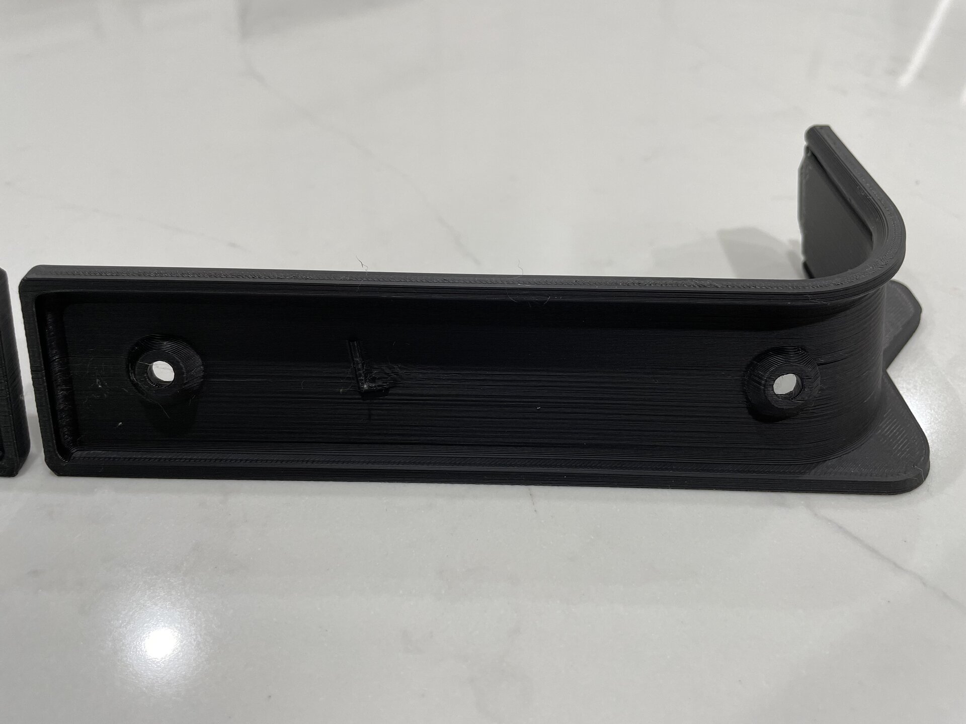

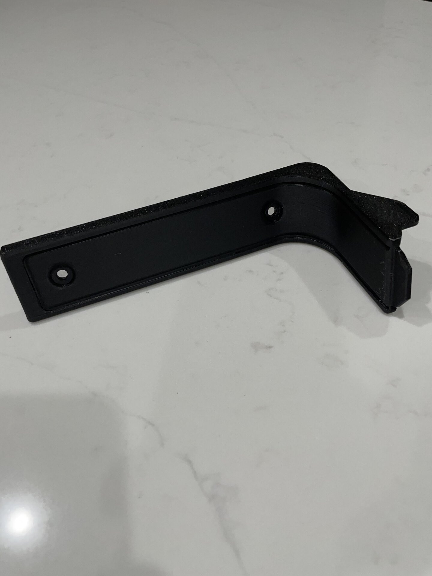

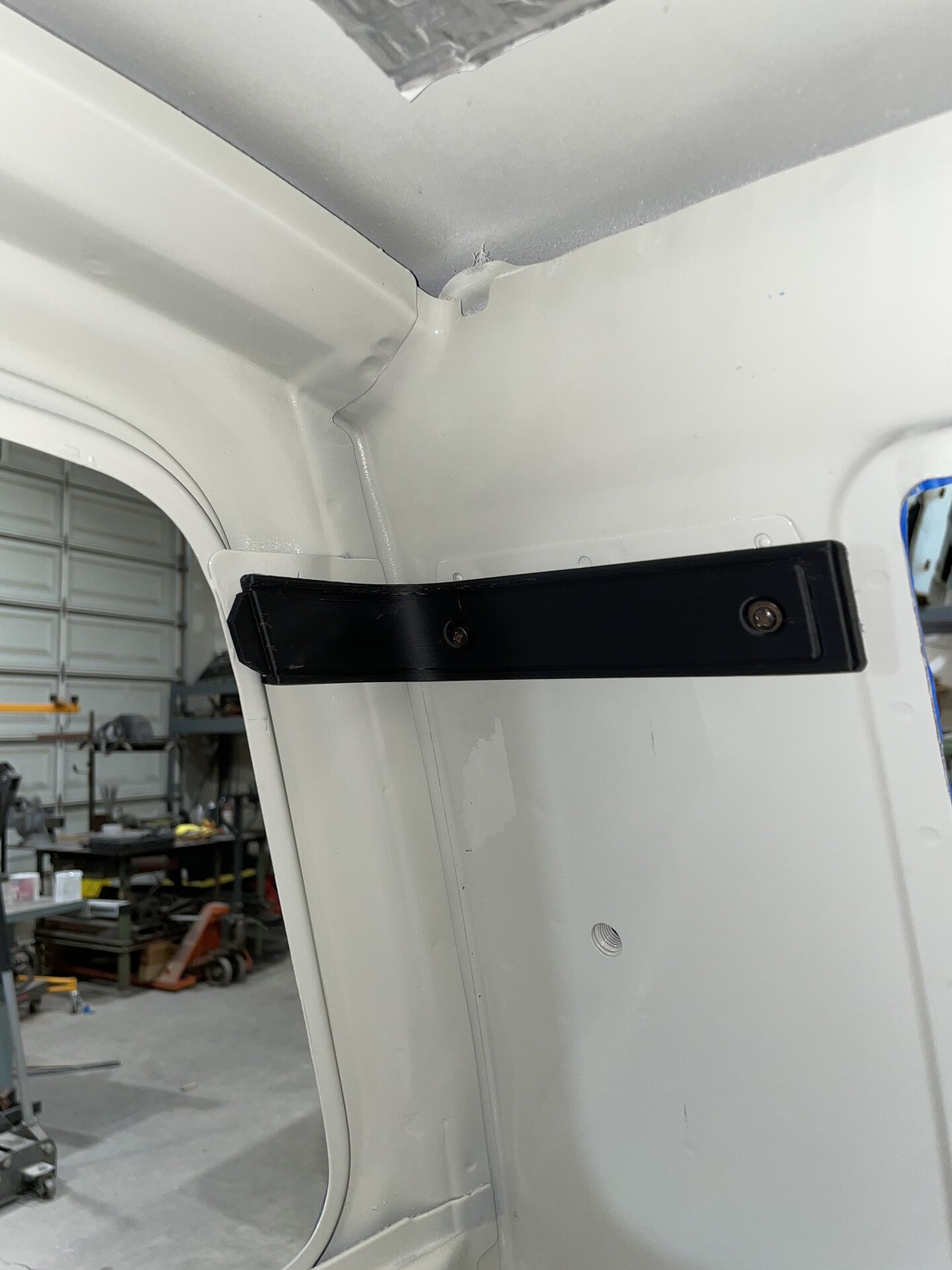

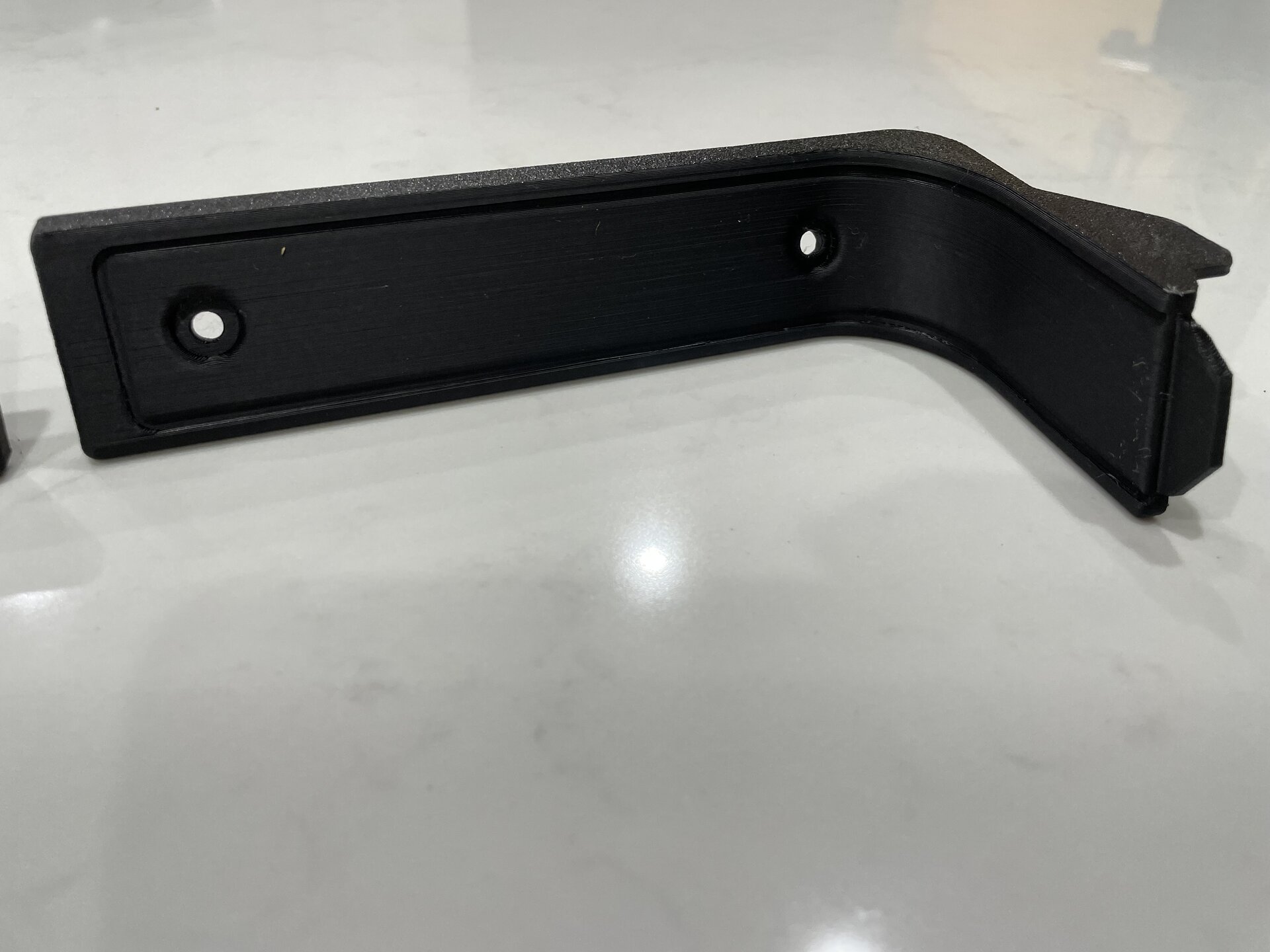

The current project for 3d printing are the small L shaped plastic pieces that are in the back corners of the head liner. I only have 1 and it's super brittle.
3D Printing: I also only have 1 of those L pieces and would really love 2 new ones. If you're open to it, I'd gladly pay for materials, your time, and shipping. It drives me nuts every time I sit in the truck. If I upgrade to Vintage AC, I might not need them, but my defrost ducts (connected to dash pad) are complete toast. I'd love some new ones, since it might be a while on AC.

I’ve made these and I’m selling them here: RetroReviveParts - Etsy - https://www.etsy.com/shop/RetroReviveParts Pretty much spot on with original minus the texture.

So my unfinished ones arrived. I am good with black and the texture is good, so do I need to put something on these as a UV blocker? Maybe a clear coat of some sort, or do you recommend some black epoxy paint (since it seems to stick to most things) to protect it from indirect UV rays? Otherwise they look good the way they are to me.
The one's I've been finishing I do a light sanding, use a filler primer (any kind should do) and then paint. I'm sure you could just shoot with a clear coat if you'd like that would be fine.
