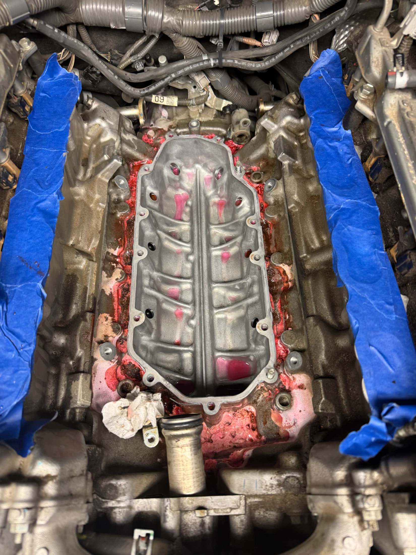

Just did mine, and it is definitely a PITA, but a great way to learn!
How long did it take you? I mean I am sure I could do it, but it looks very tedious. What all did you replace?
It took me 12 or 14 hours the first time, maybe 6 hours the second time. If you can get it right the first time, go for it. I had an o-ring roll or pinch, resulting in coolant dumping out the trans area. Lying and kneeling on top of the engine that long help me discovery profanity I did not know I had in my vocabulary.
I followed this procedure by Faye Hadley, with lots of petroleum jelly on the o-rings the second time.
If I had it to do over again I would consider an SAIS delete kit from Hewitt to avoid putting the bypass valves back in place.
