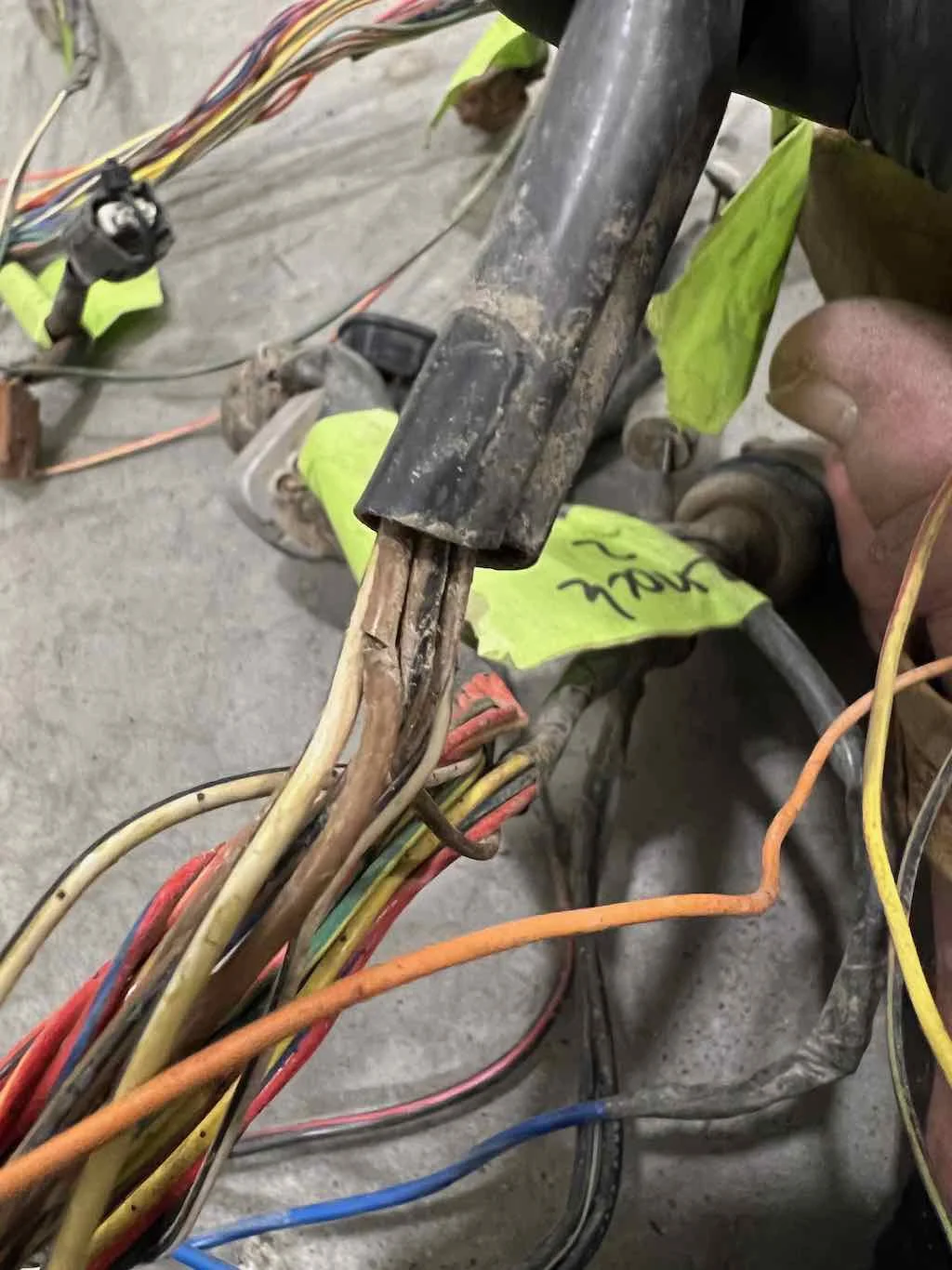

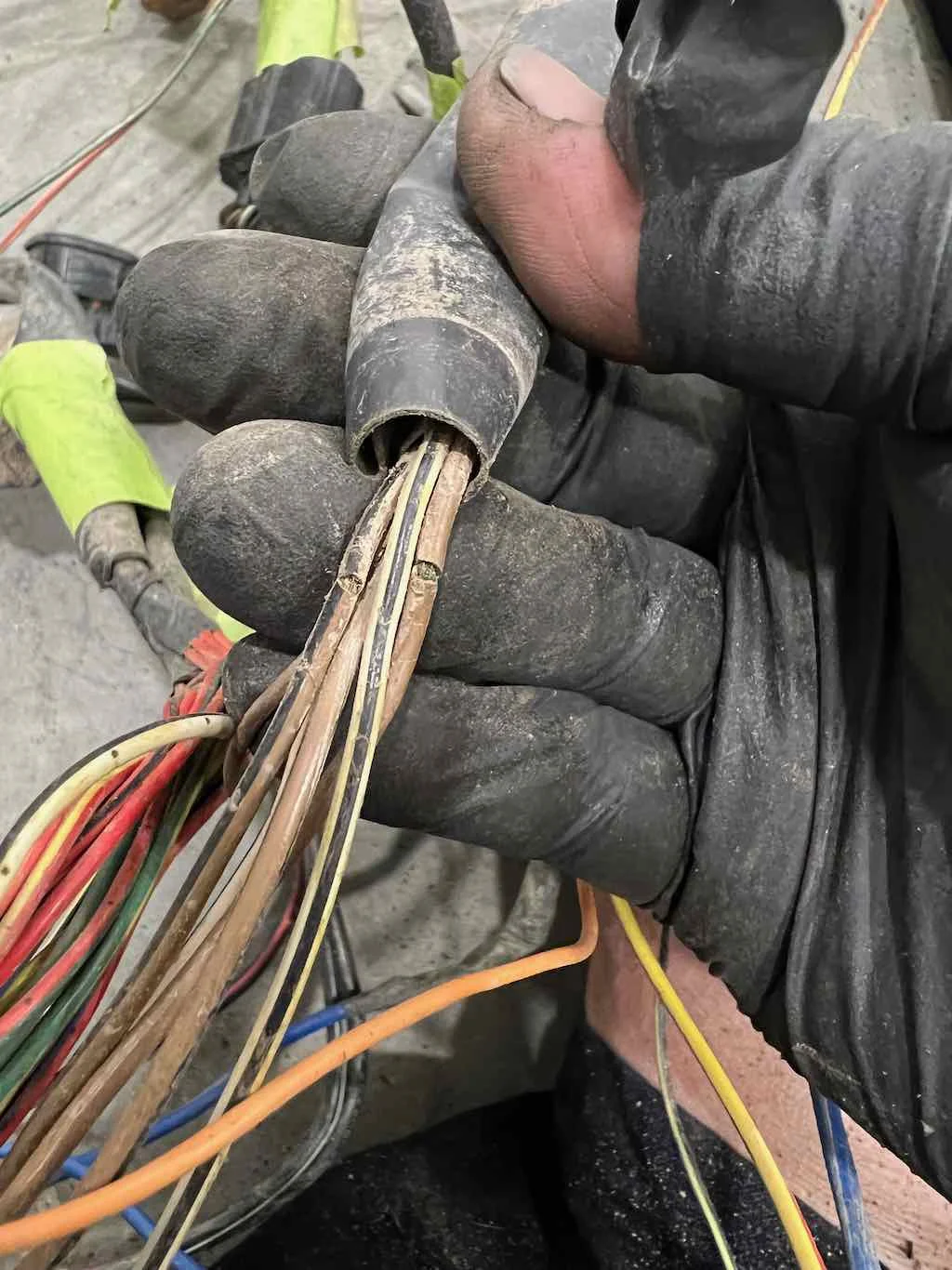

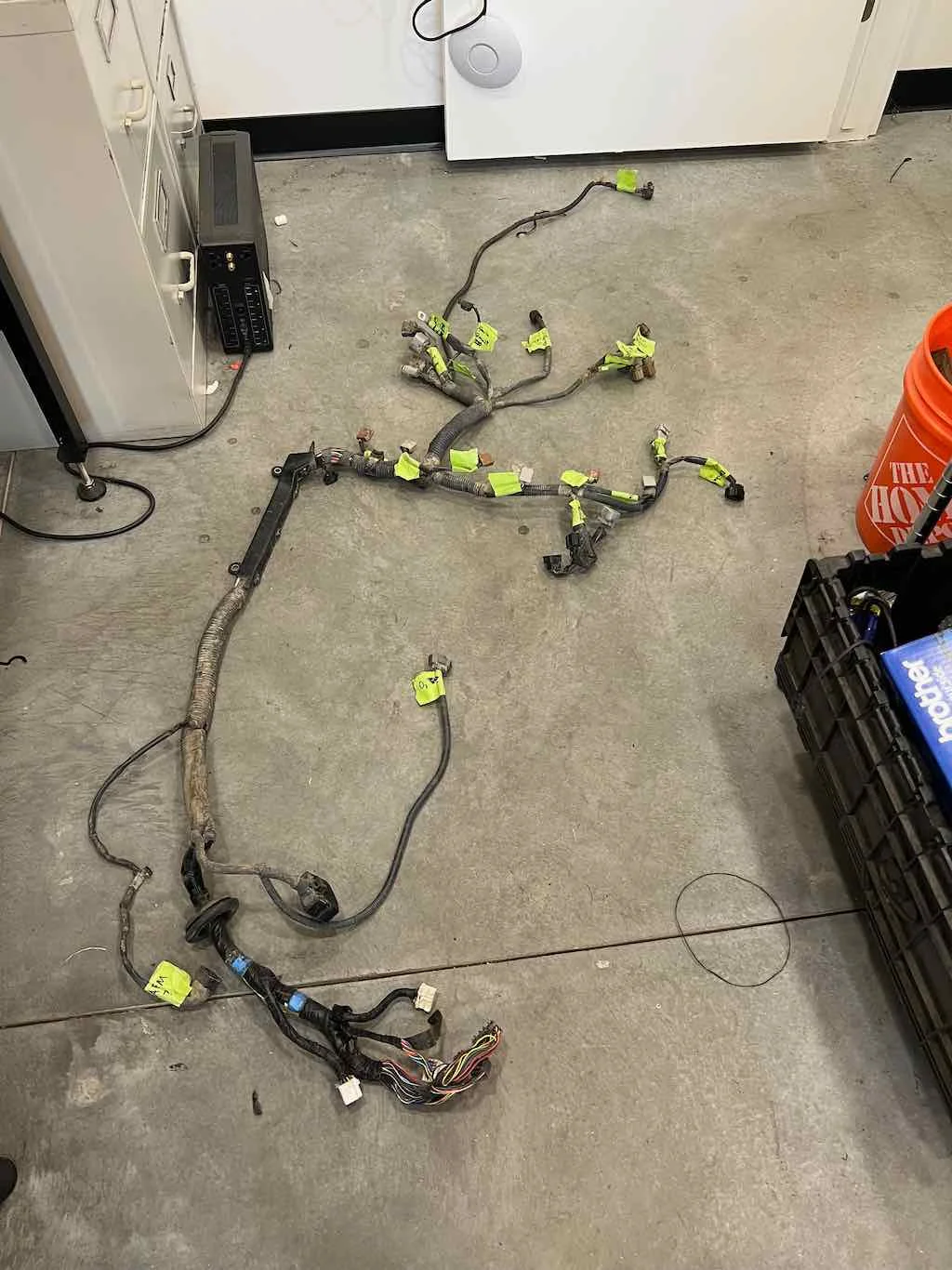

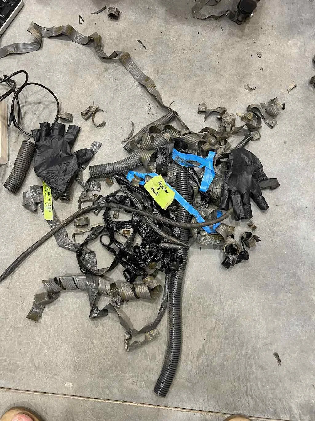

was going to attempt to pare this down before firing but decided to not mess with harness until after engine fired up and all systems are functional. would suck real bad to pull some needed wires.

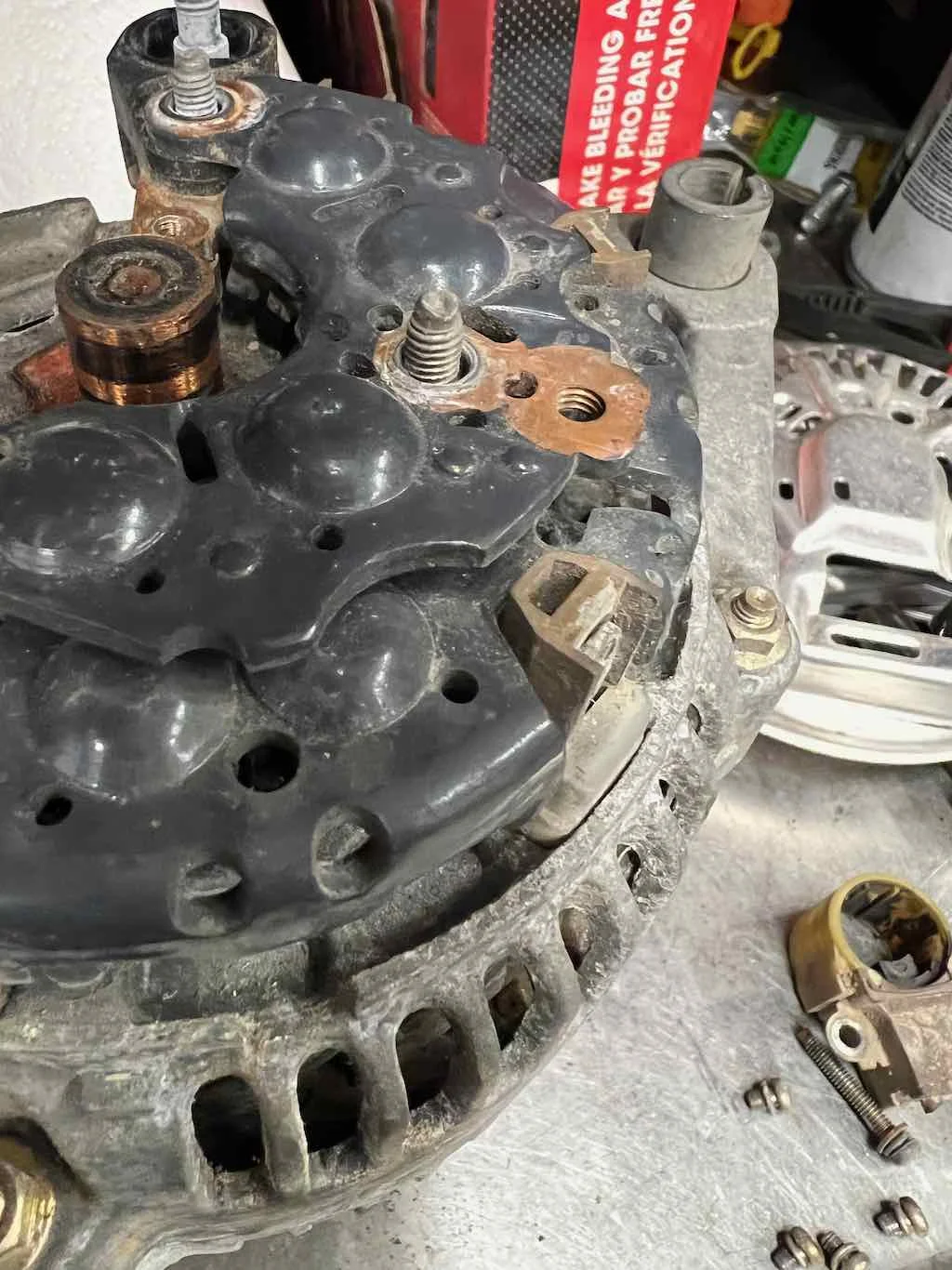

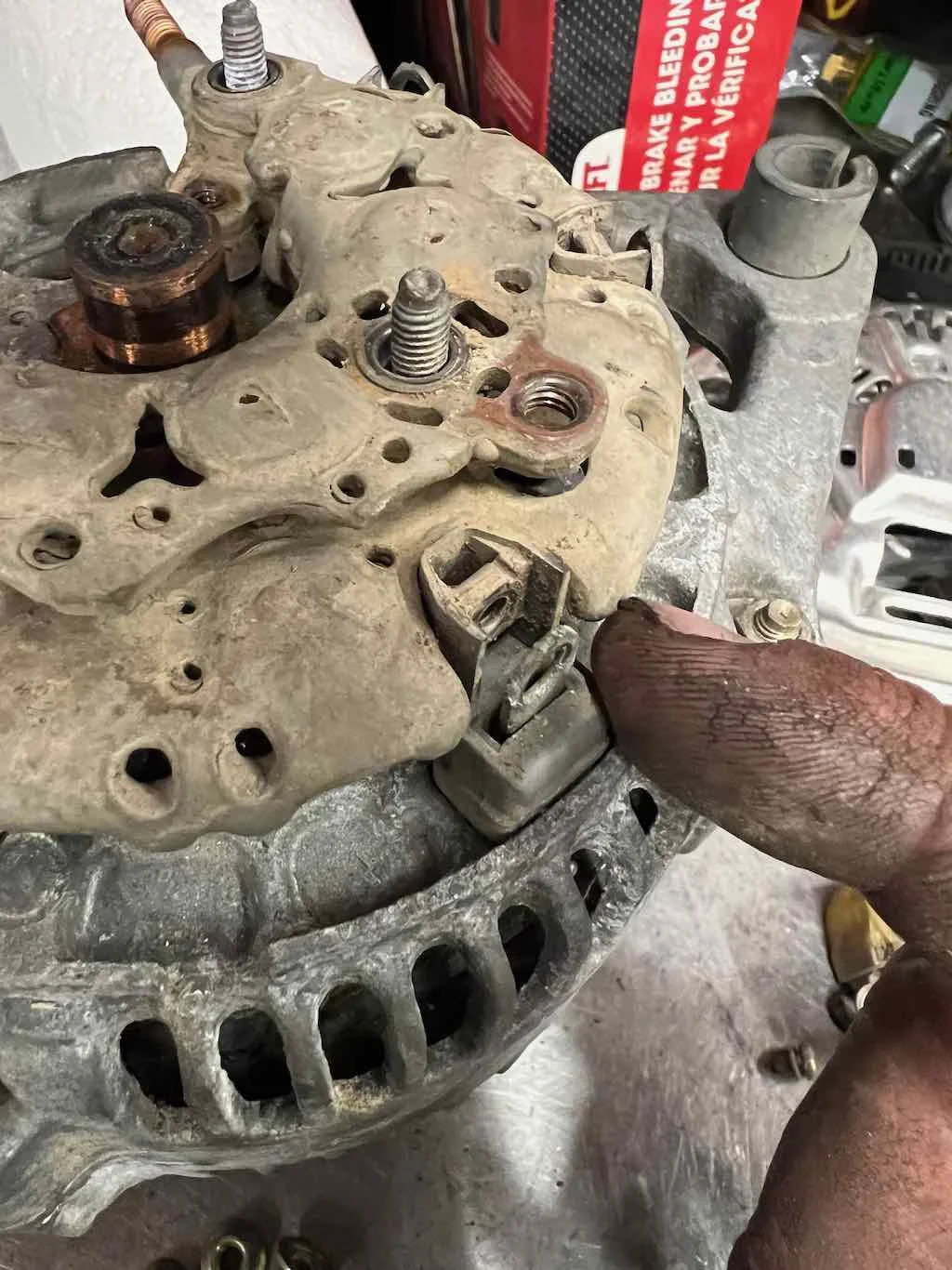

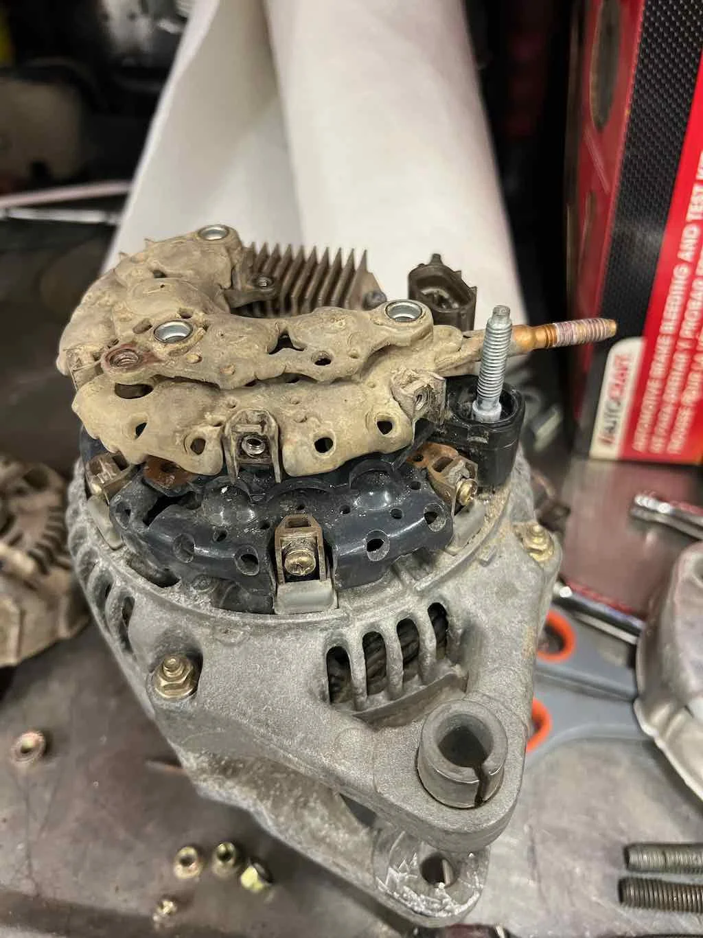

used the same approach as @Dirty Koala thanks to his build thread to swap the voltage regulator from Toyota to Cummins alternator. working so far. had previously done the @Photoman alt upgrade so I wanted to see if whatever this part is called would swap over as well so the back cover of alt could be used without altering it. pretty close, and could've with some spacers, but now was not the time to go down that rabbit hole.

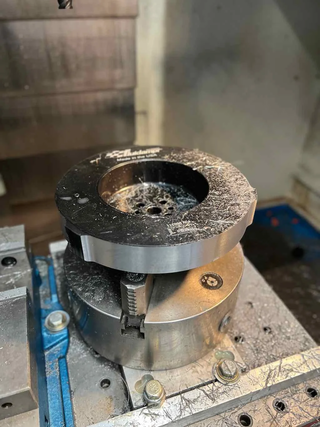

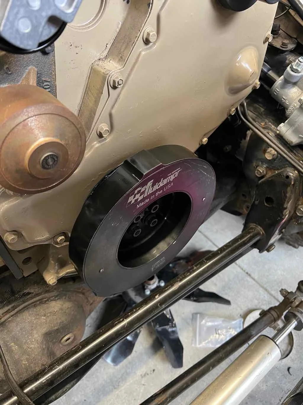

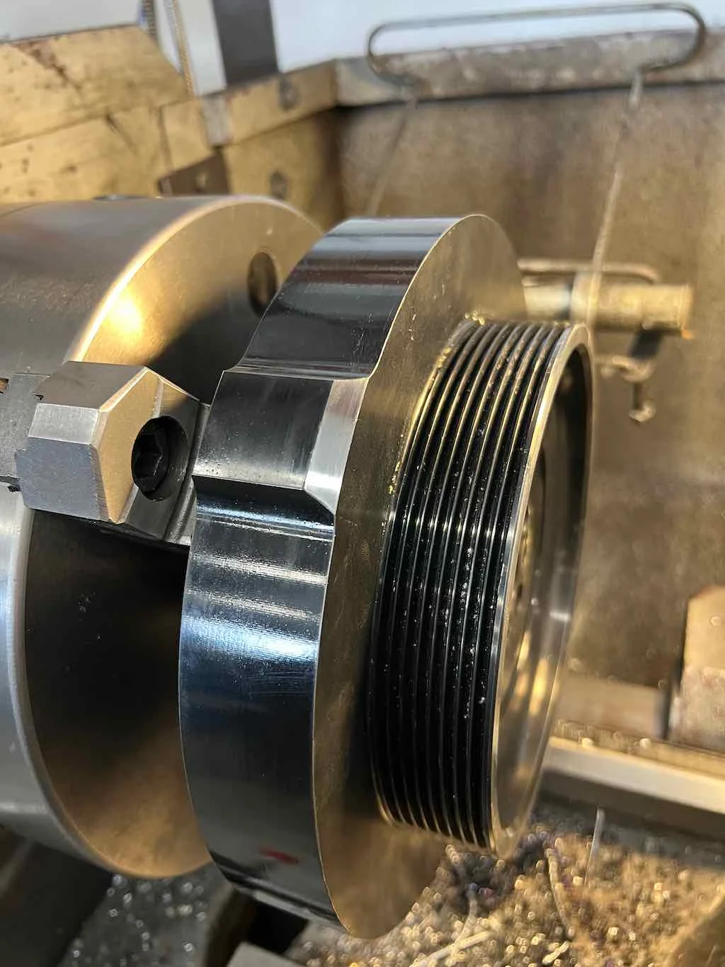

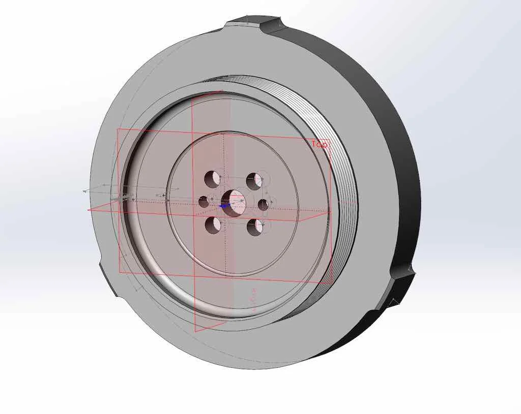

also from @Dirty Koala 's build thread, I knew I needed to make crank damper work with Toyota tach which requires three pulses. no way in hell I'm running a cummins engine withOUT a Fluidampr on the crank, and all of those either come with two notches or no notches. time to hit the drawing board.

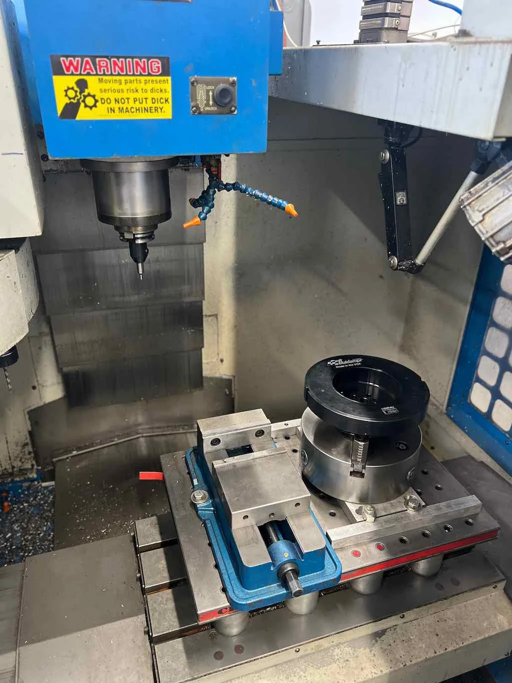

had to get the mill fired up for the first time at the new shop, so that took some extra time but we got it dialed.
turned out quite nice
spray painted the machined edge to match, hopefully it is stable.

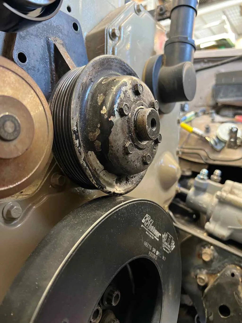

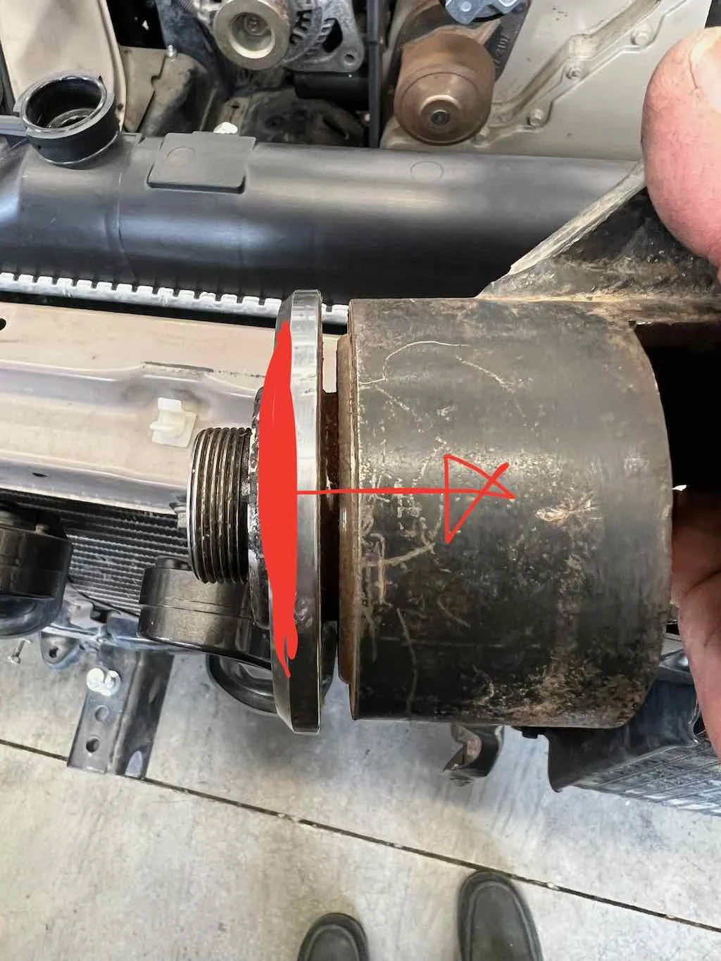

next step is to install fan (another favor from @Dirty Koala, he sent me his offset fan mount since the stock one puts the fan into the steering gear). BUT, it contacts damper :/ (this damper was the test fit one, no notches but same OD as the bumps I machined)
did three things to address issue:
1. seated the bearings into the fan mount a little bit more

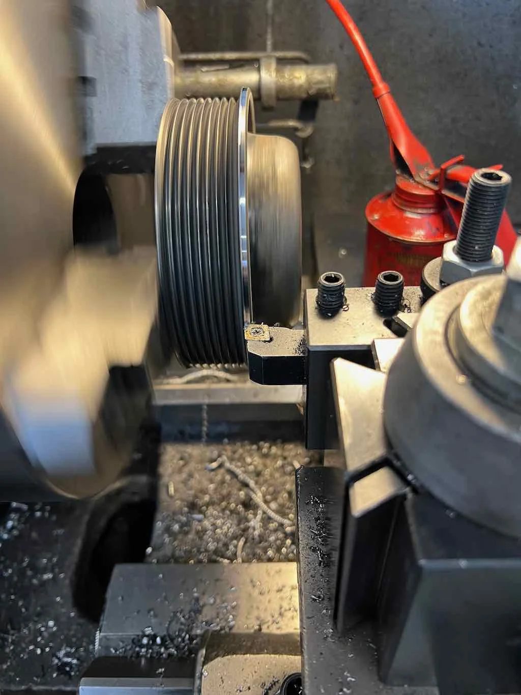

2. turned down the fan pulley as much as I'm comfortable
3. when that wasn't enough I just went the other way and took the material off the damper. plenty there to deal with the situation. problem solved.

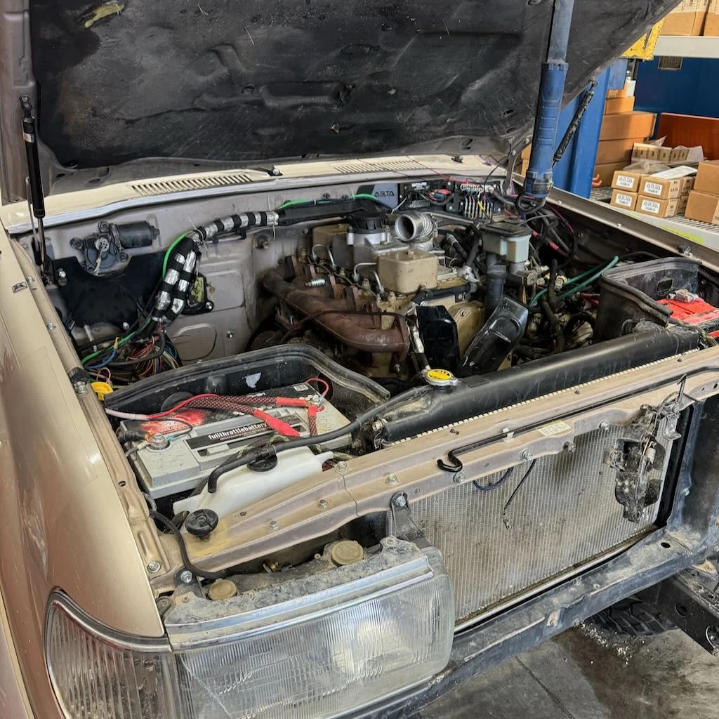

Apparently I need to update this thread a bit. Got everything running, drove from Boise to Bend for Overland Expo, Boise to Rubithon (and did Rubithon), a couple cross-Idaho dirt road trips, then half of a south-north Idaho trip.
4BT does AMAZING on dirt roads up to about 45mph or so. Just sings. Sips fuel. Did AMAZING on the Rubicon (could pretty much just idle over most things if I wanted to). Driving around town and on the freeway, it SUCKS. Big time.

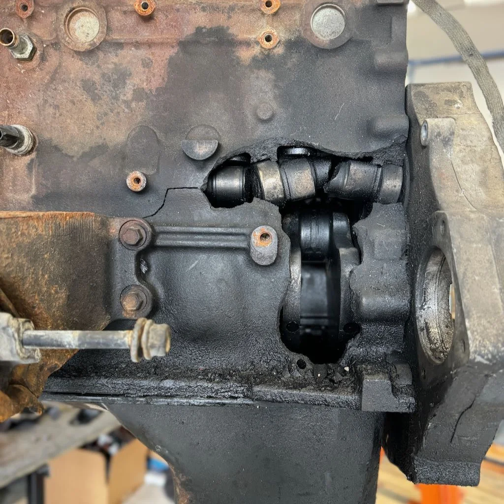

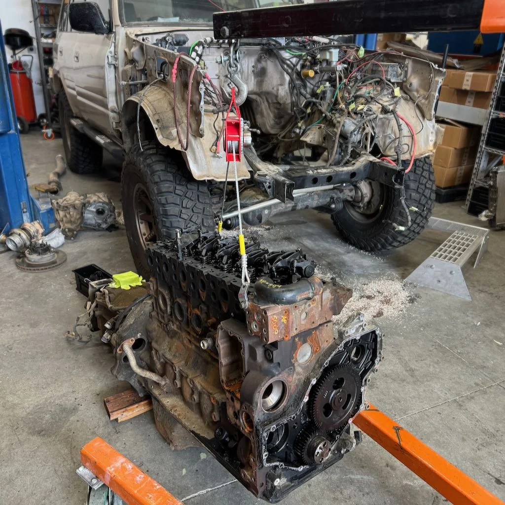

Then, on the aforementioned south-north Idaho trip, it inexplicably dropped a valve. Finally pulled into shop this weekend to start tear down. Going to attempt to stretch the motor by a couple cylinders and put it back in.

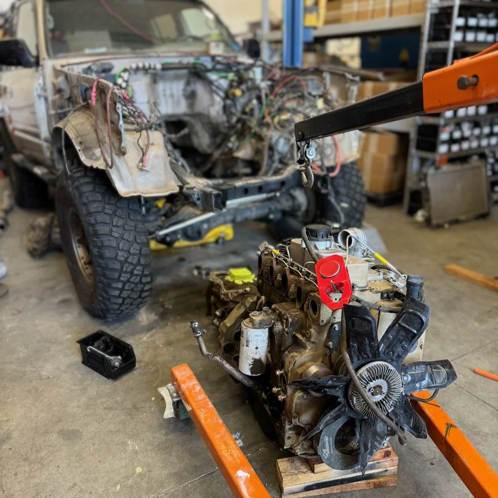

Finally got this prick out. Looking forward to having the time for disassembly to see what the damage is.

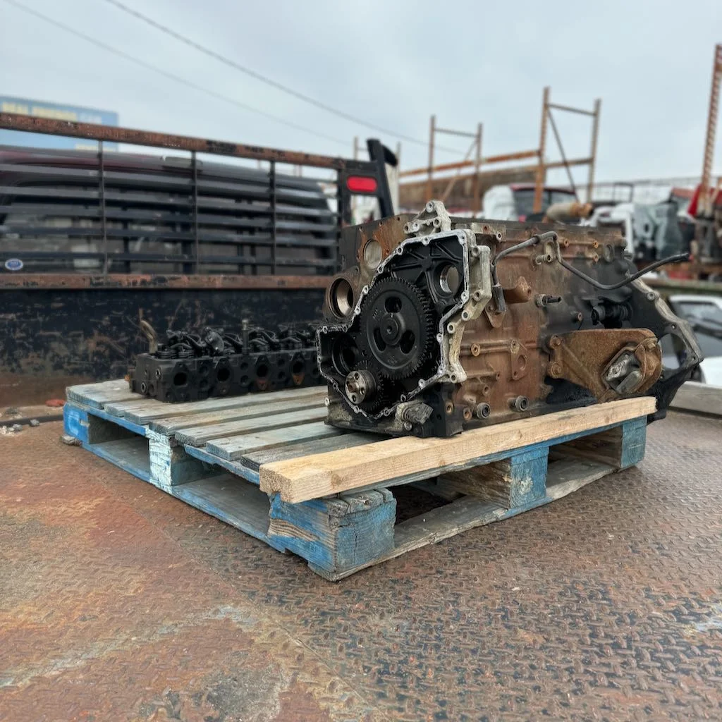

Picked up a used good head that came with a free block so I can start test fitting stuff and getting measurements while waiting for the new engine to be done at the machine shop.
Why the block was free...

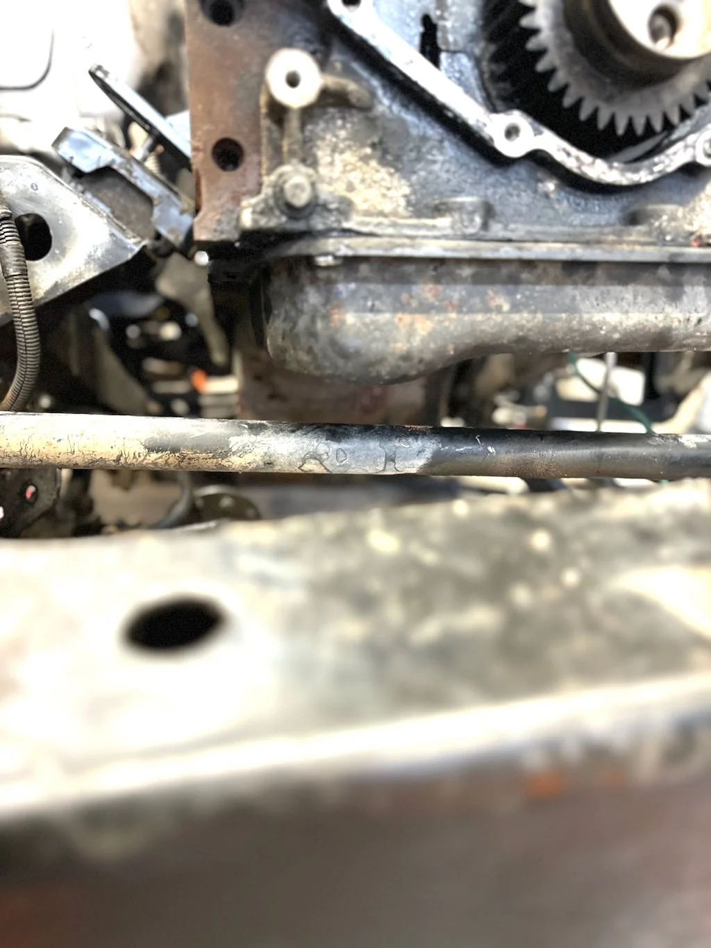

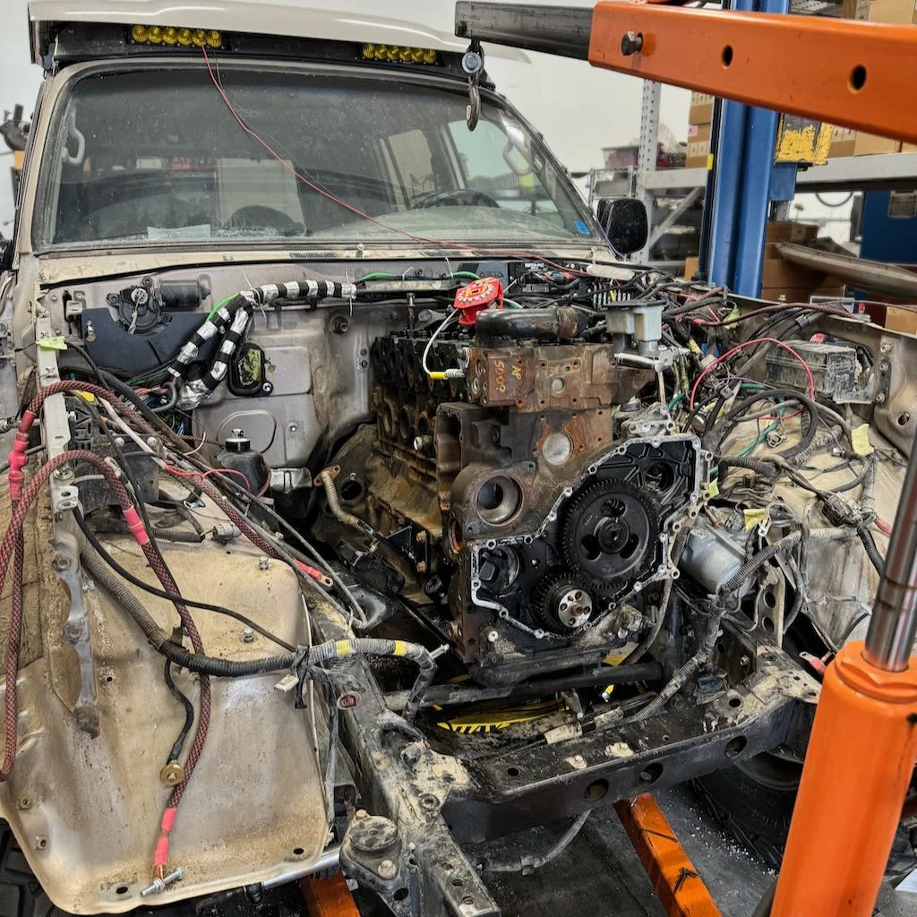

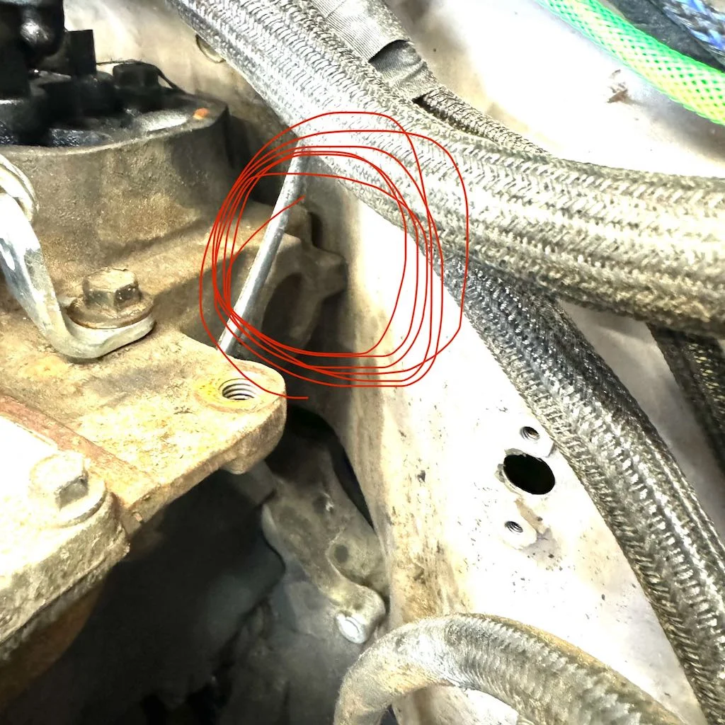

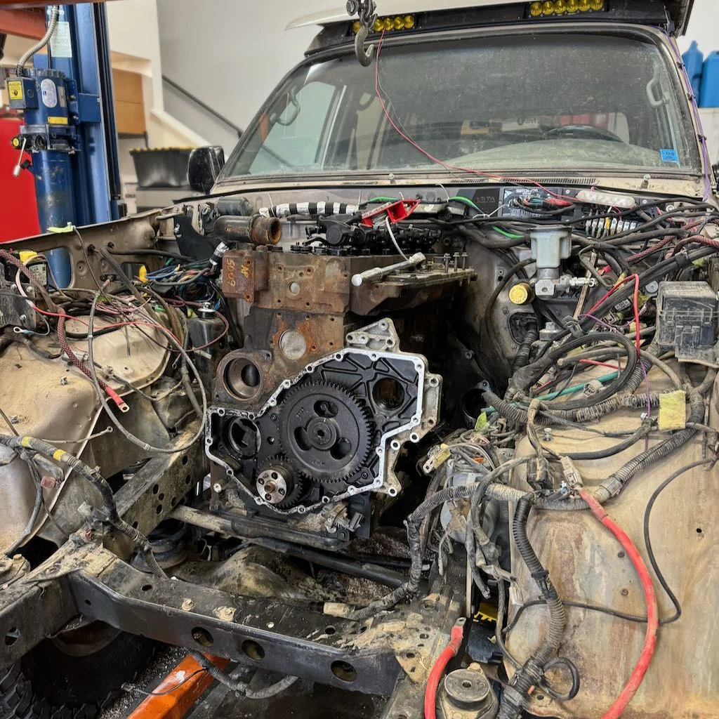

Got it "in" but not "in", since there seem to be some clearance issues different from the 4bt engine. Engine mounts @Will Van sent me to test out need to go back about one more inch to drop on the OEM isolators but there is a boss on the back of the head that is making some hard contact. Will be investigating how much of the boss can be ground off before deciding if need to make some different mounts that push engine forward some.
This is where the interference is. Trans mount/cross member is in same place and engine mounts are about an inch off.

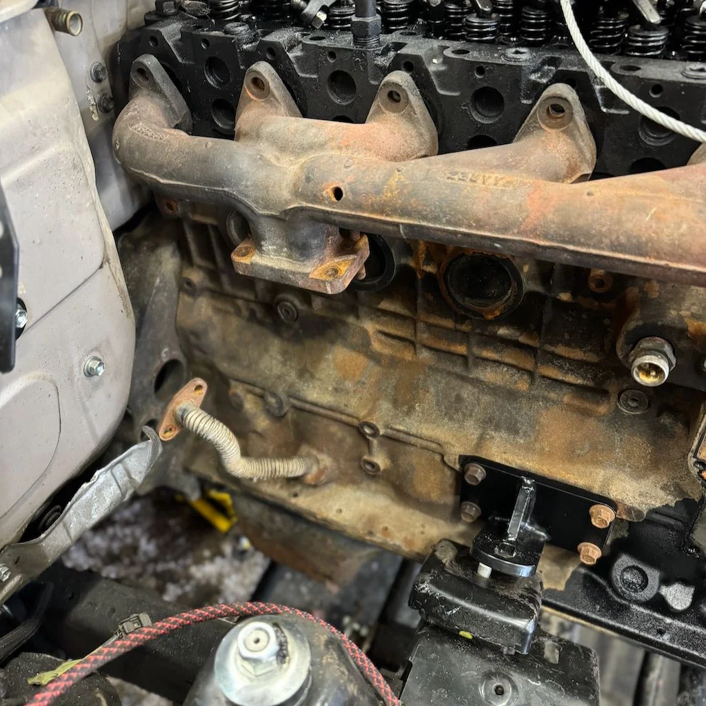

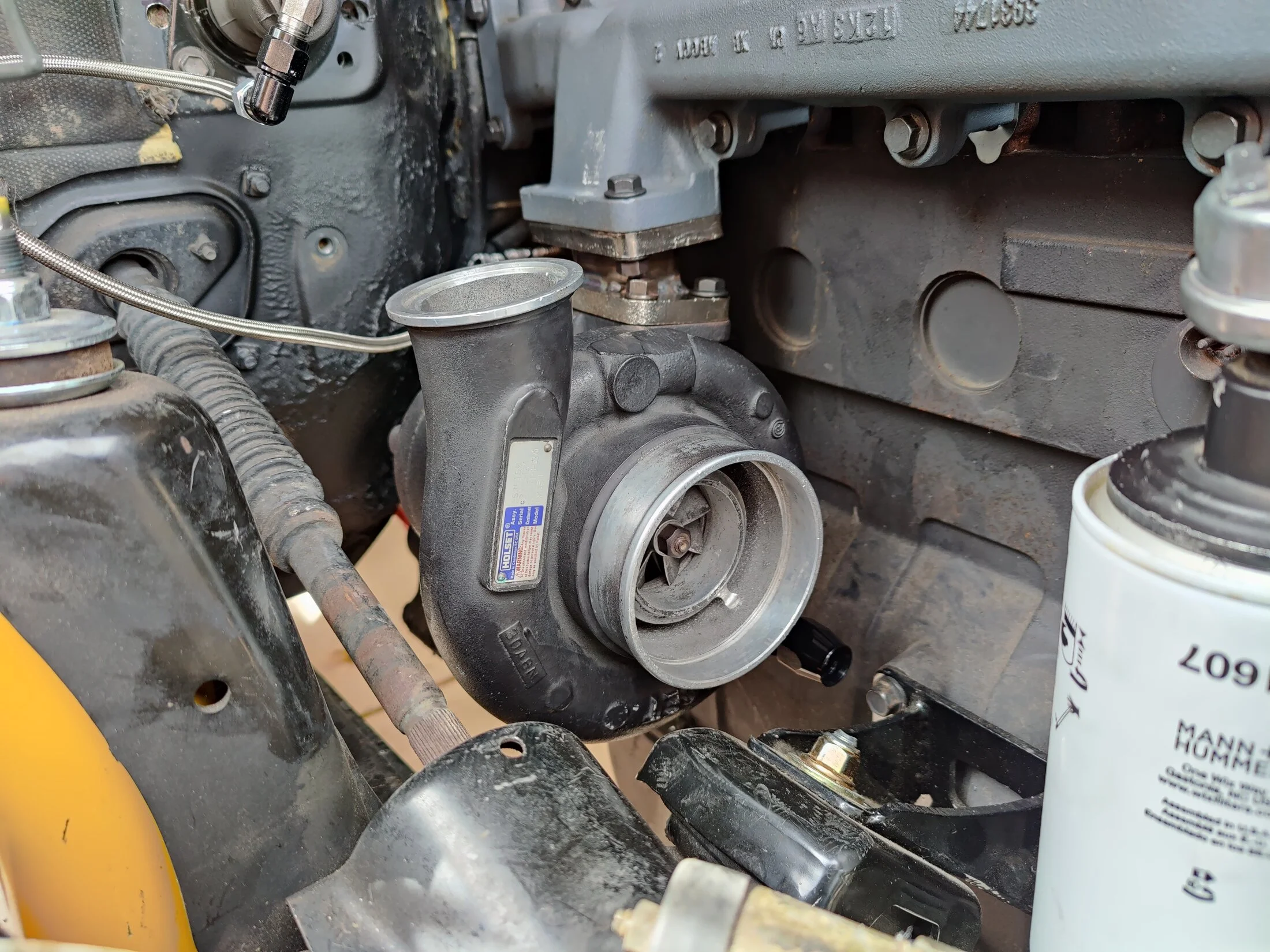

Last thing tonight was eyeballing the exhaust situation. Looks like a spacer to drop turbo down slightly will make this fit nicely. Since @Dirty Koala is paralleling this build we have a good dialogue going of how to deal with issues as they come up, with his experience fitting a 6cyl previously coming in clutch.

As expected the steering support bar is going to have to get f'd with in the near future but I wan to get the engine in place first.

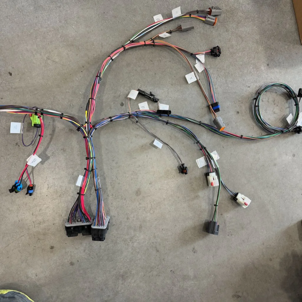

Got a couple Painless Performance harnesses and will modify both as needed and document here

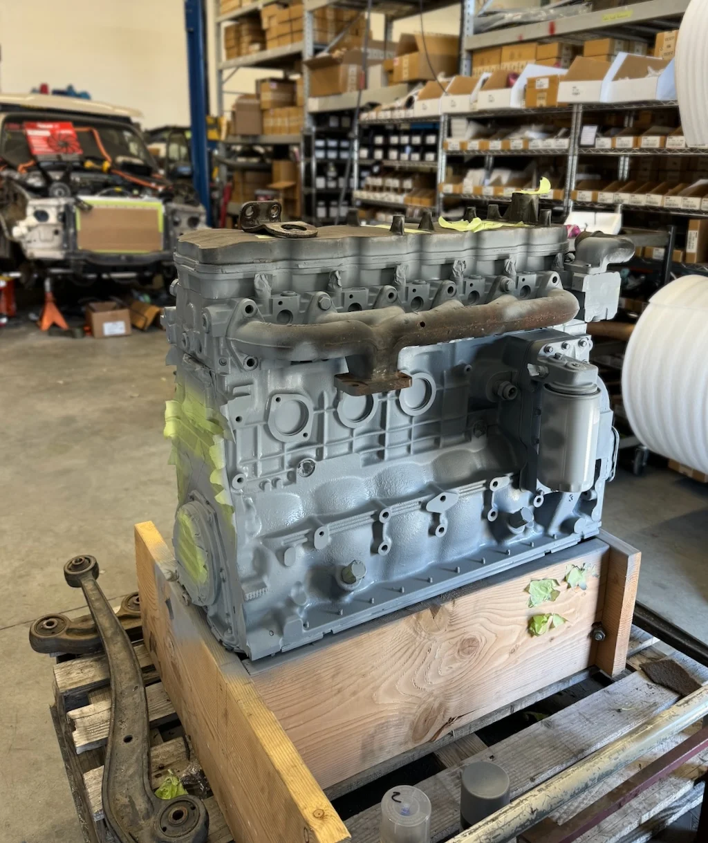

Lots been going on for the last couple months, finally have a chance to look at this project a little again.
First full coat of paint on this badboy. Valve cover and exhaust manifold just there for overspray, getting replaced with different stuff before install.

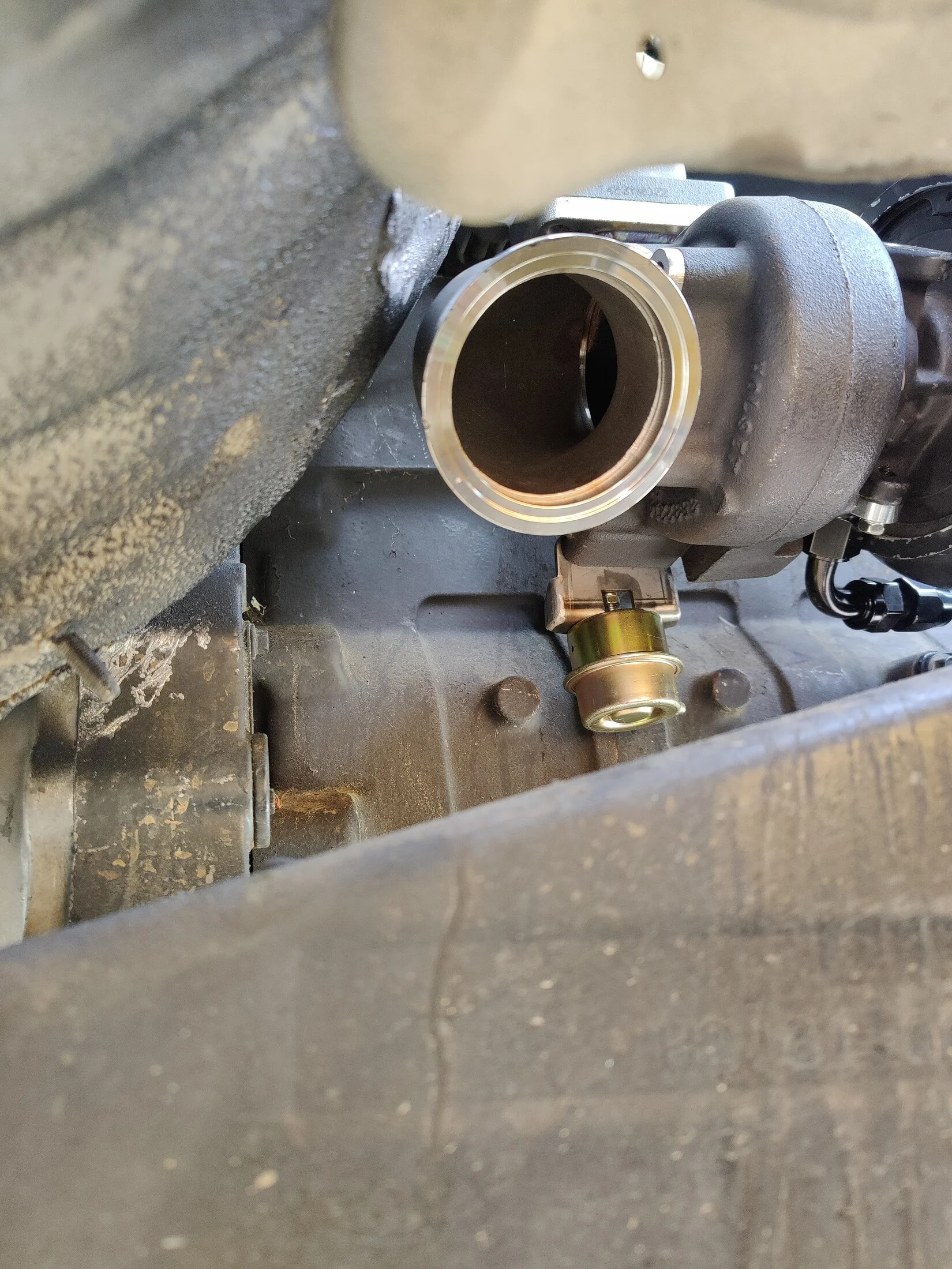

I used a spacer for my 12 valve when I was running a manifold like yours. I bought one of those cheap spacers on Amazon or ebay and cut / rewelded it to get the angle I wanted. Also added a bung for my egt gauge but I see you got a hole already. I wish I had a spot for the drain on the rear of the block like you do though. That caused me issues....
Nice, that’s a pretty tight setup! How was the exhaust work? I’m planning to keep the turbo up high for the potential of twin turbo setup. The common rail block having both drain bosses remained is nice for sure.

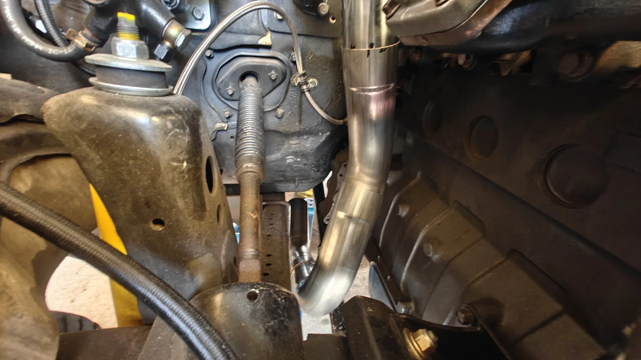

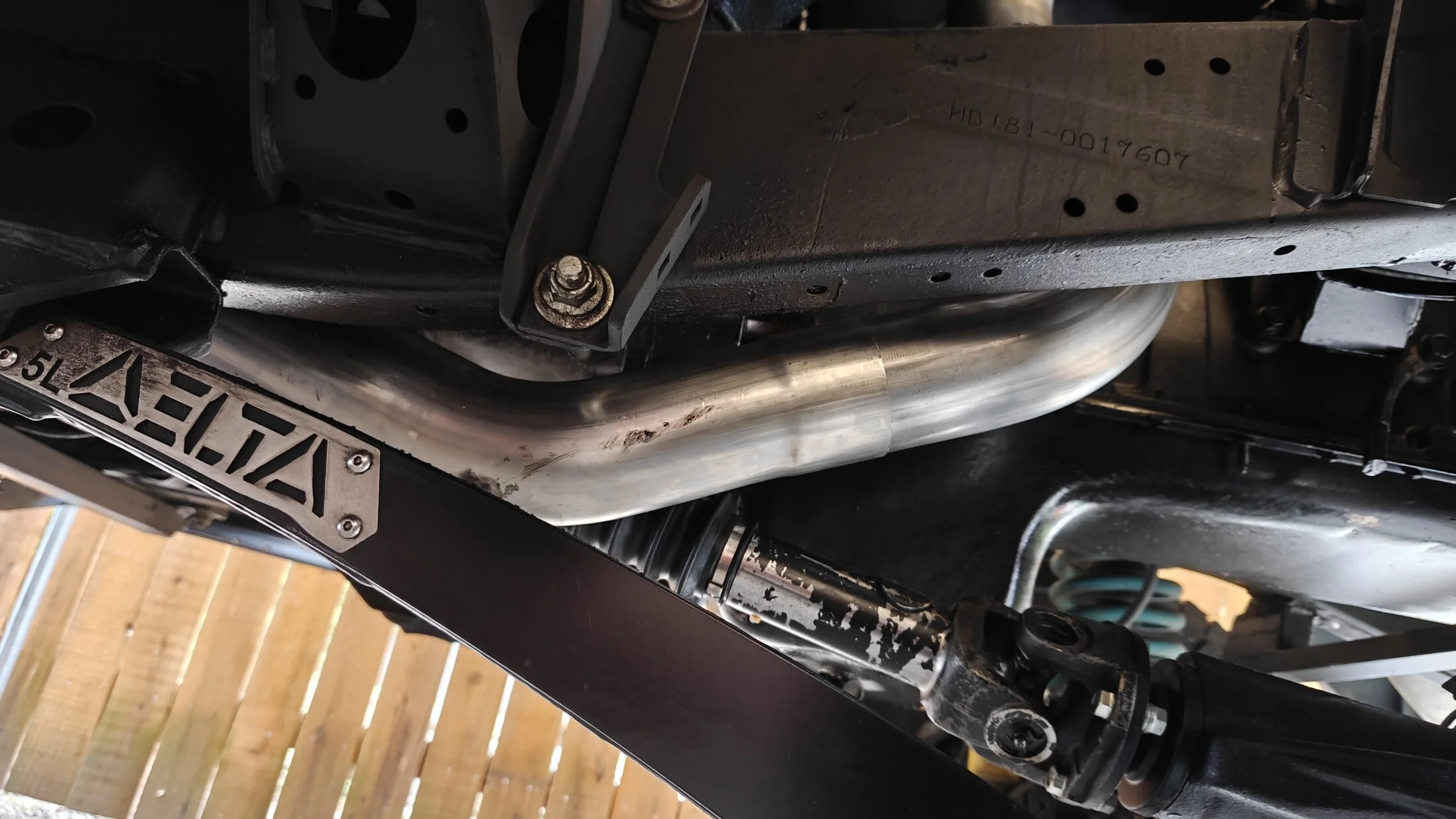

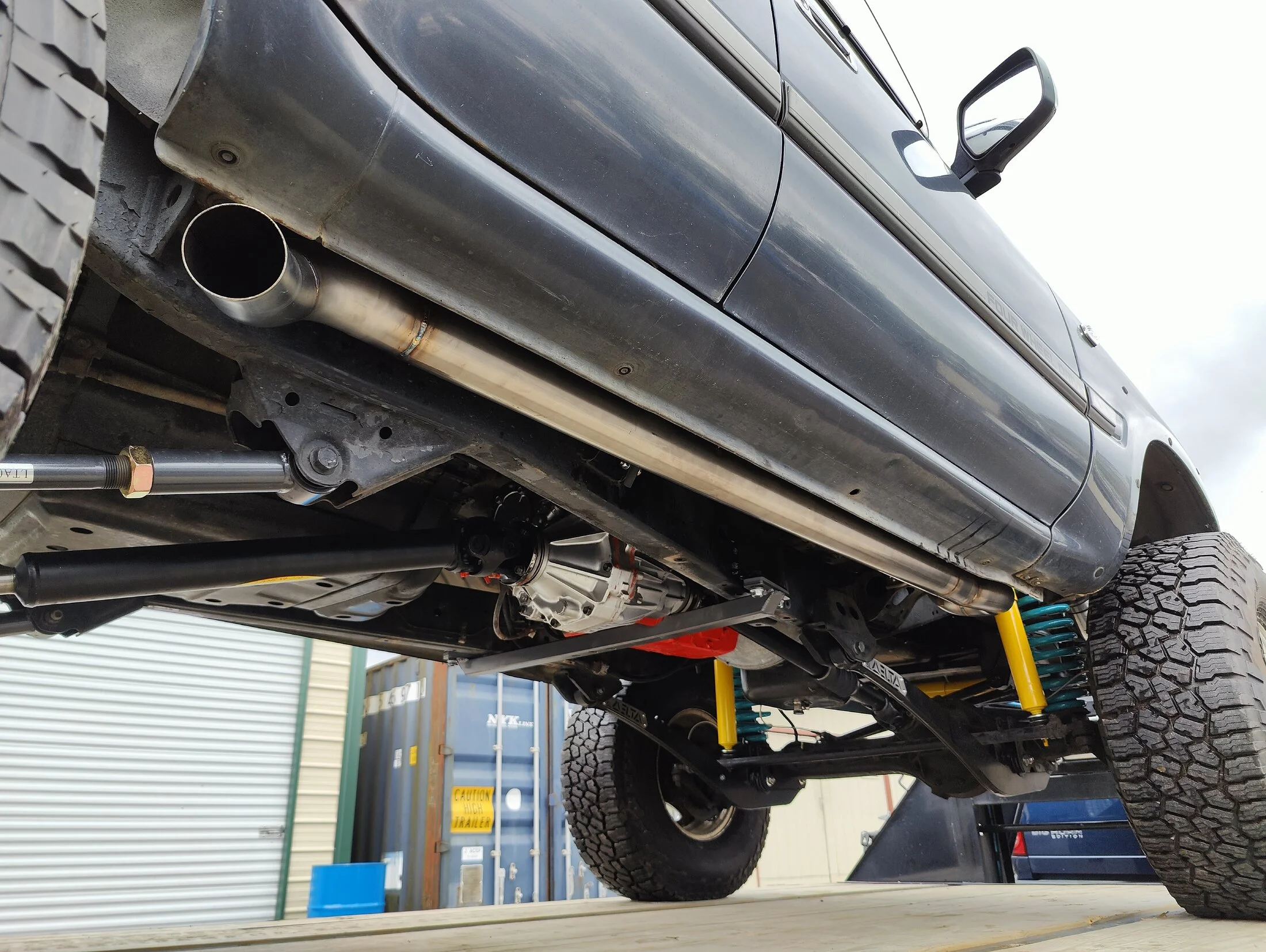

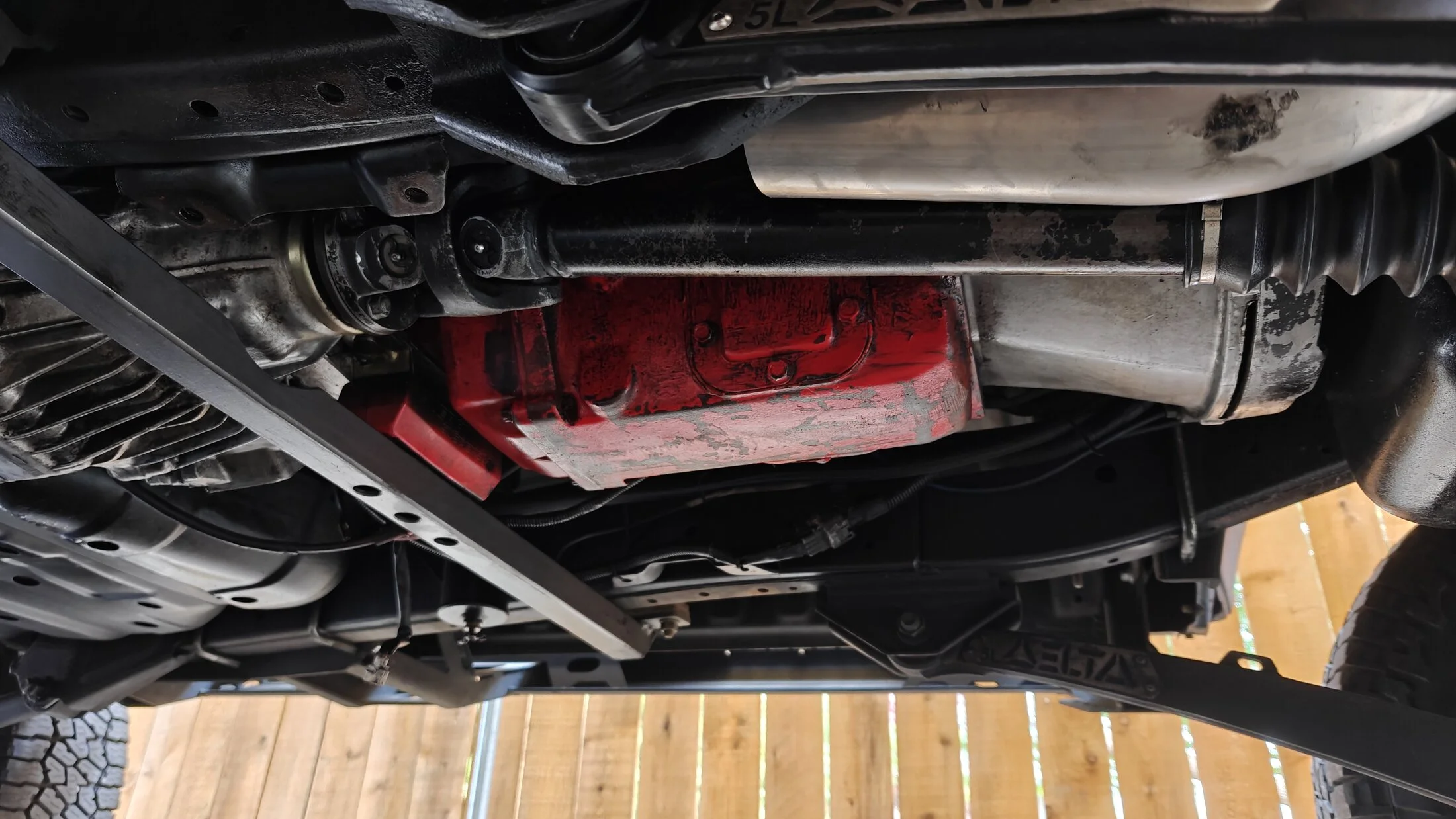

Fitment was alright, I did poor planning and routed the exhaust outside the frame where it was factory which backfired on me because I didn't account for the fact I was getting sliders. It looked neat but I had to chop it :/ with the new turbo I'm rerouting fully inside frame I think.
Clean routing! What diameter exhaust was that? 3 inch?
Yep! Figured 3" would be plenty, especially for the hx35w. I'd love to do a 4" with the he351 but it's extremely tight and I don't think I could fit it in a clean and tucked up manner. I don't do really intense wheeling so I'm not super concerned with clearance but I'd like as much as possible just so if I do end up bouncing off rocks and logs it's one less concern.

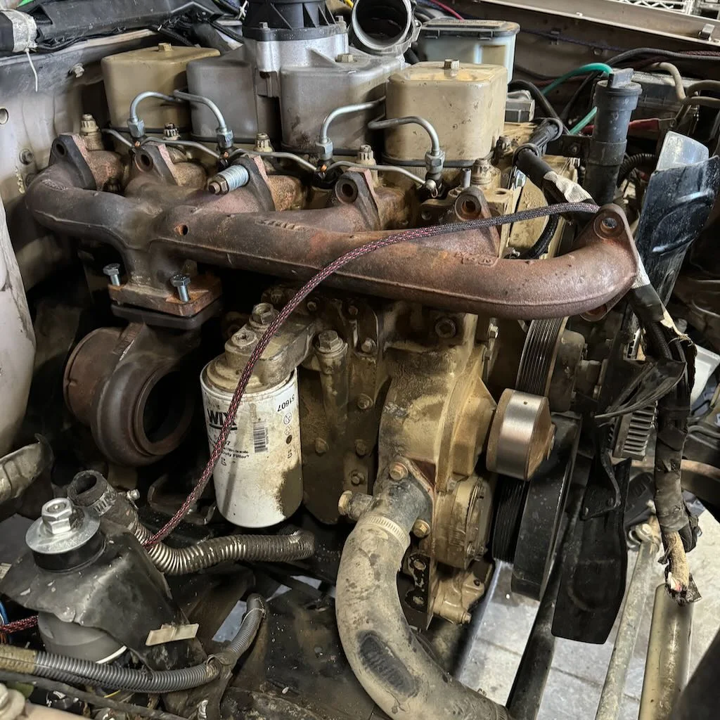

I * should * be getting my new one built and installed this week and will update accordingly. Here's a few snapshots of my current test fittings with one of those cheap universal exhaust kits. Definitely going to shorten some of it and bring it up closer to the frame.
