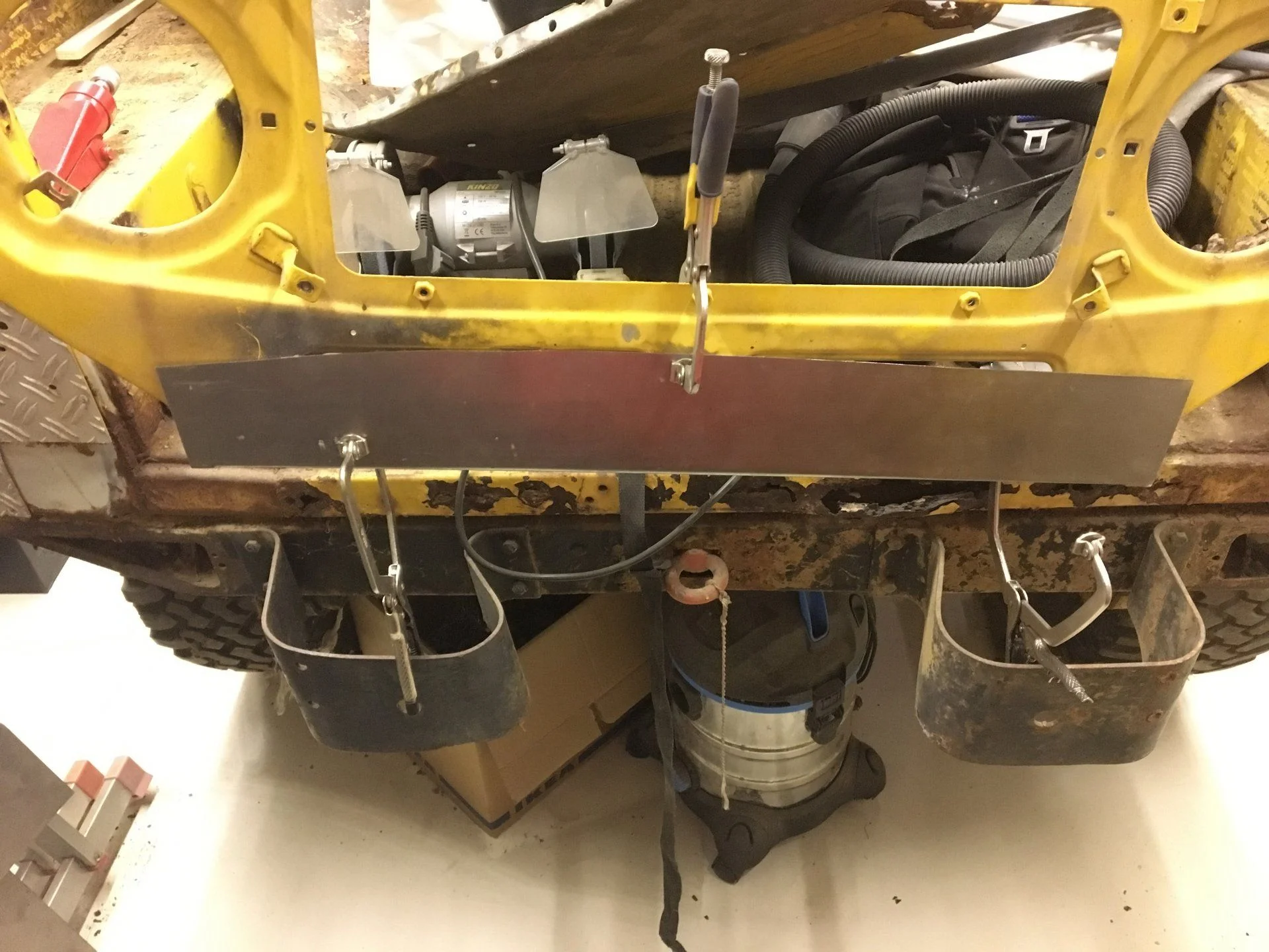

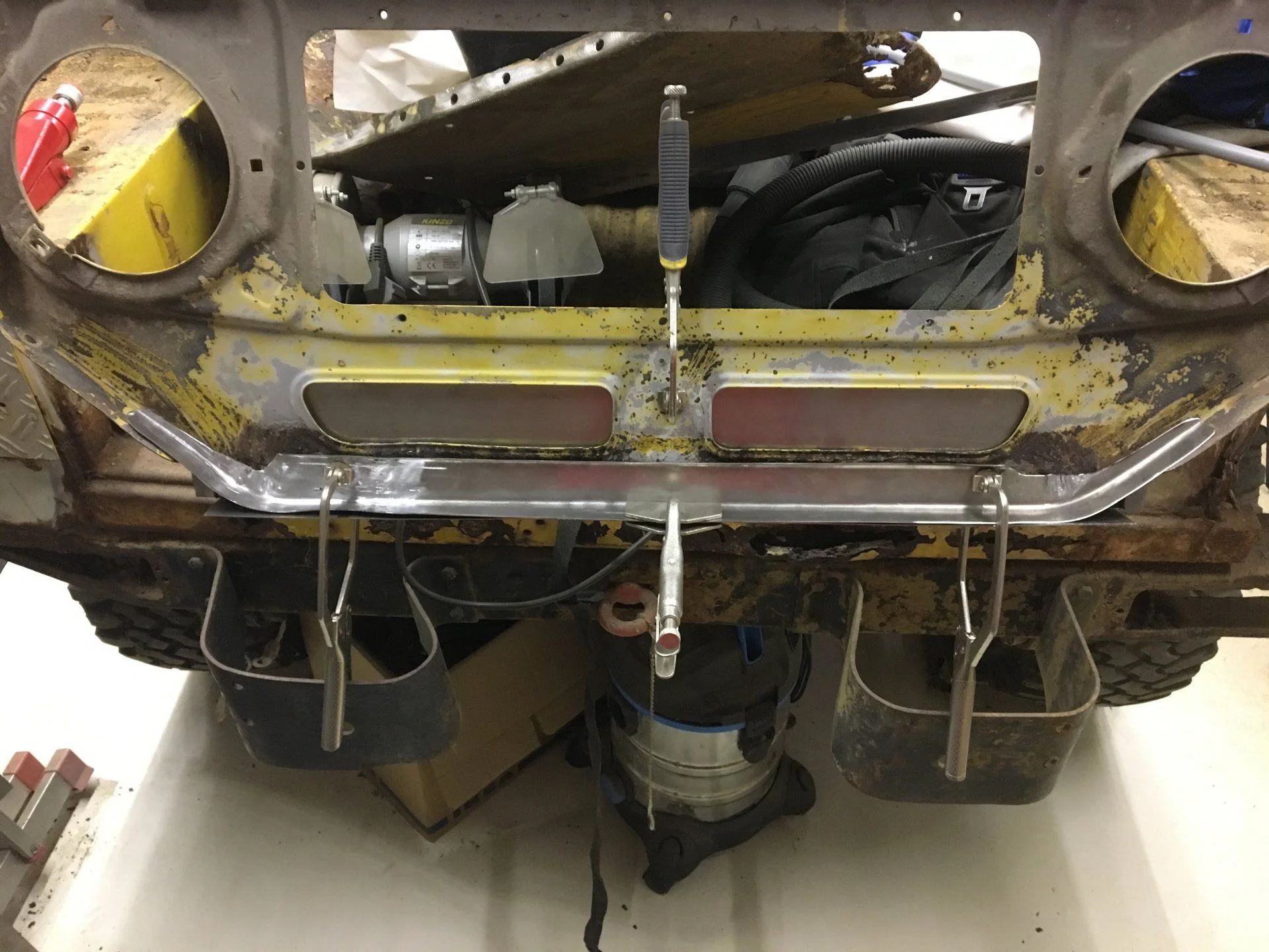

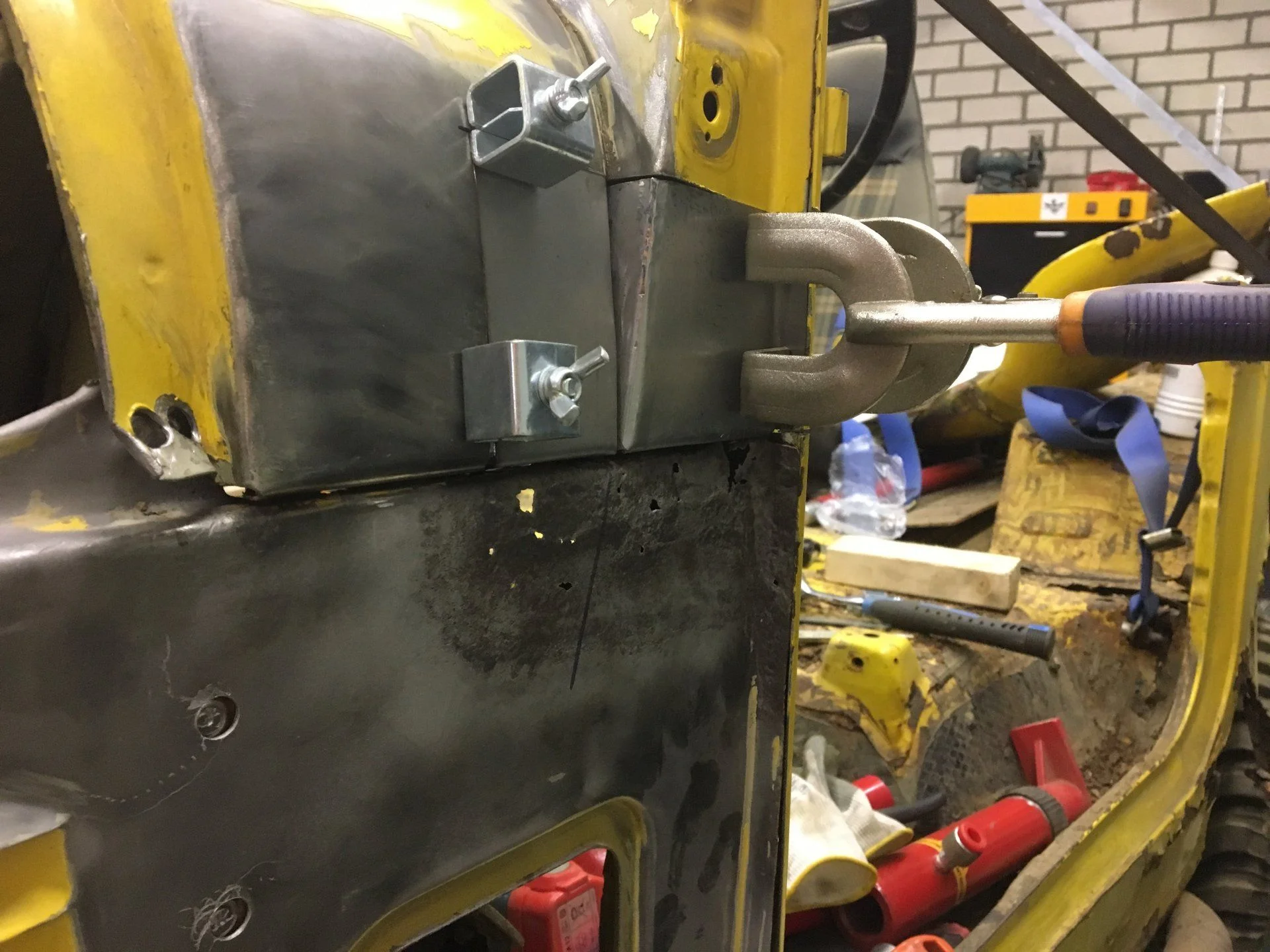

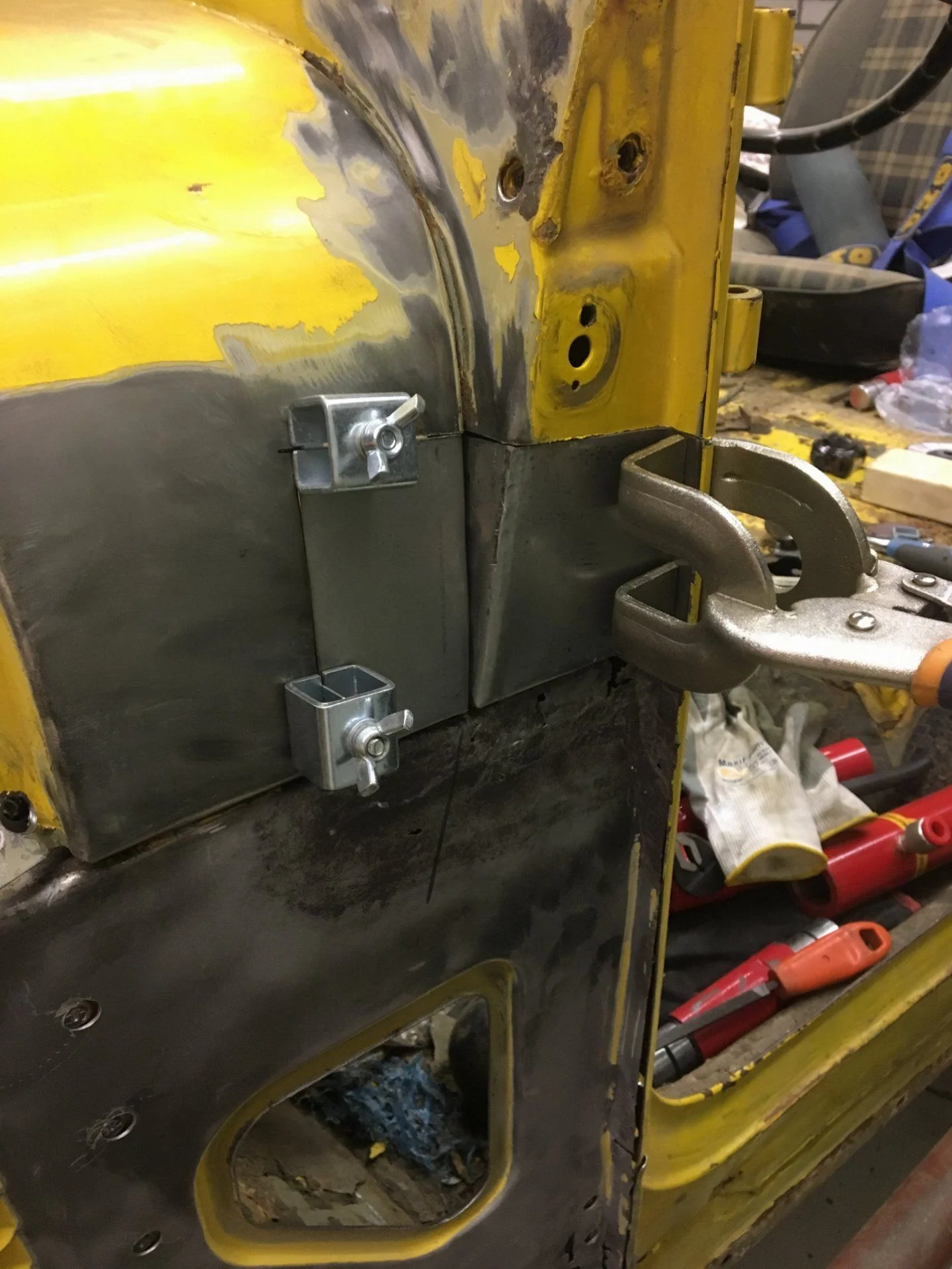

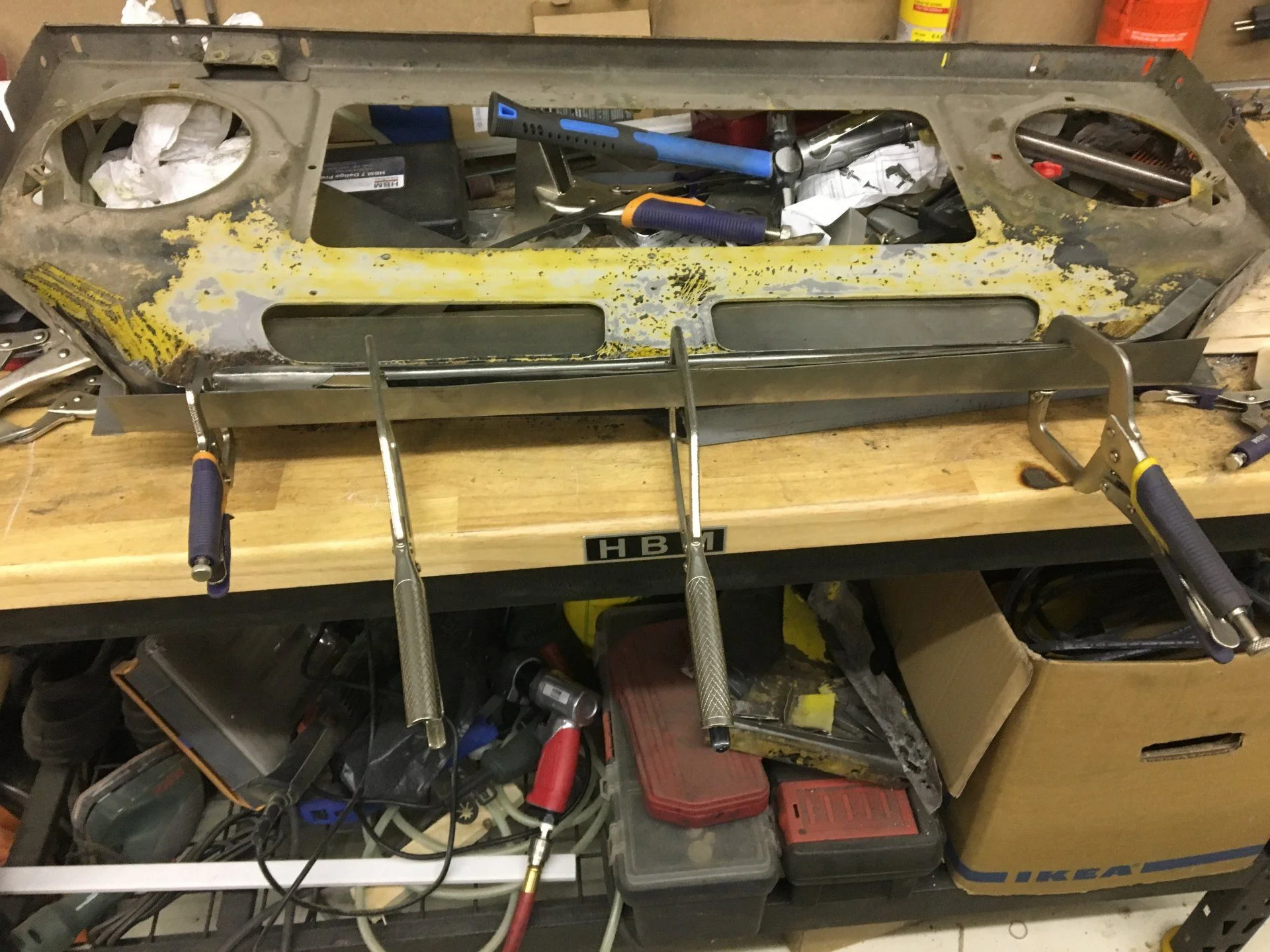

Went ahead with the botom of the bib.

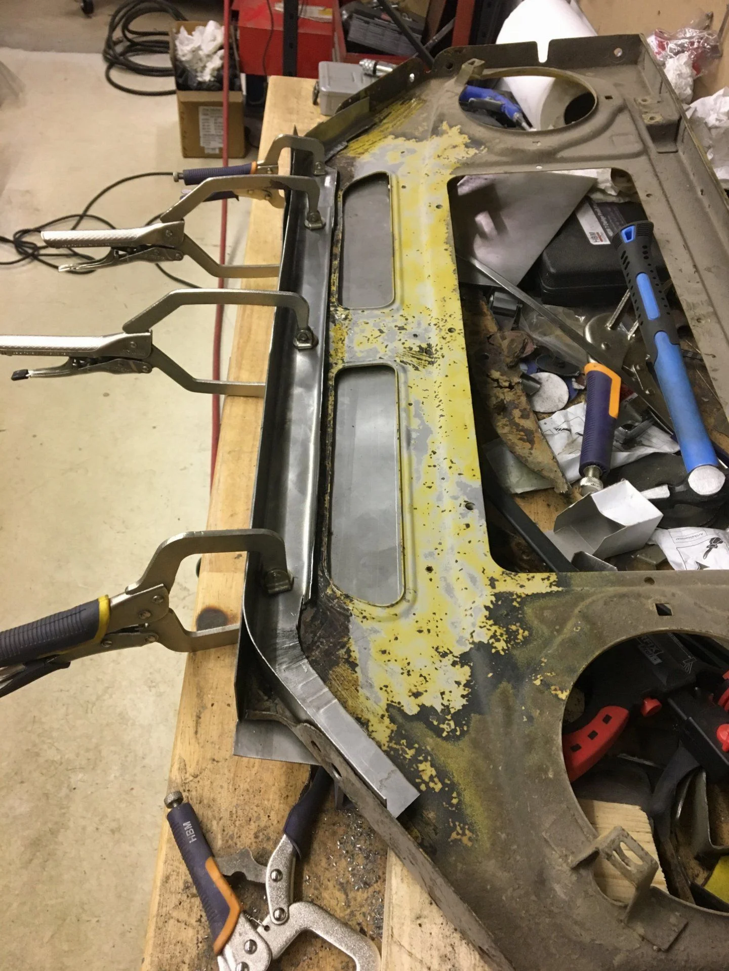

Reinforcement made from two pieces that fit over each other positioned, cut line drawn and cut to size.
Welded together and cleaned up.
Now I have to get my bead roller dies and sprockets and chain for the bead roller so I can finish the front lower part of the bib.

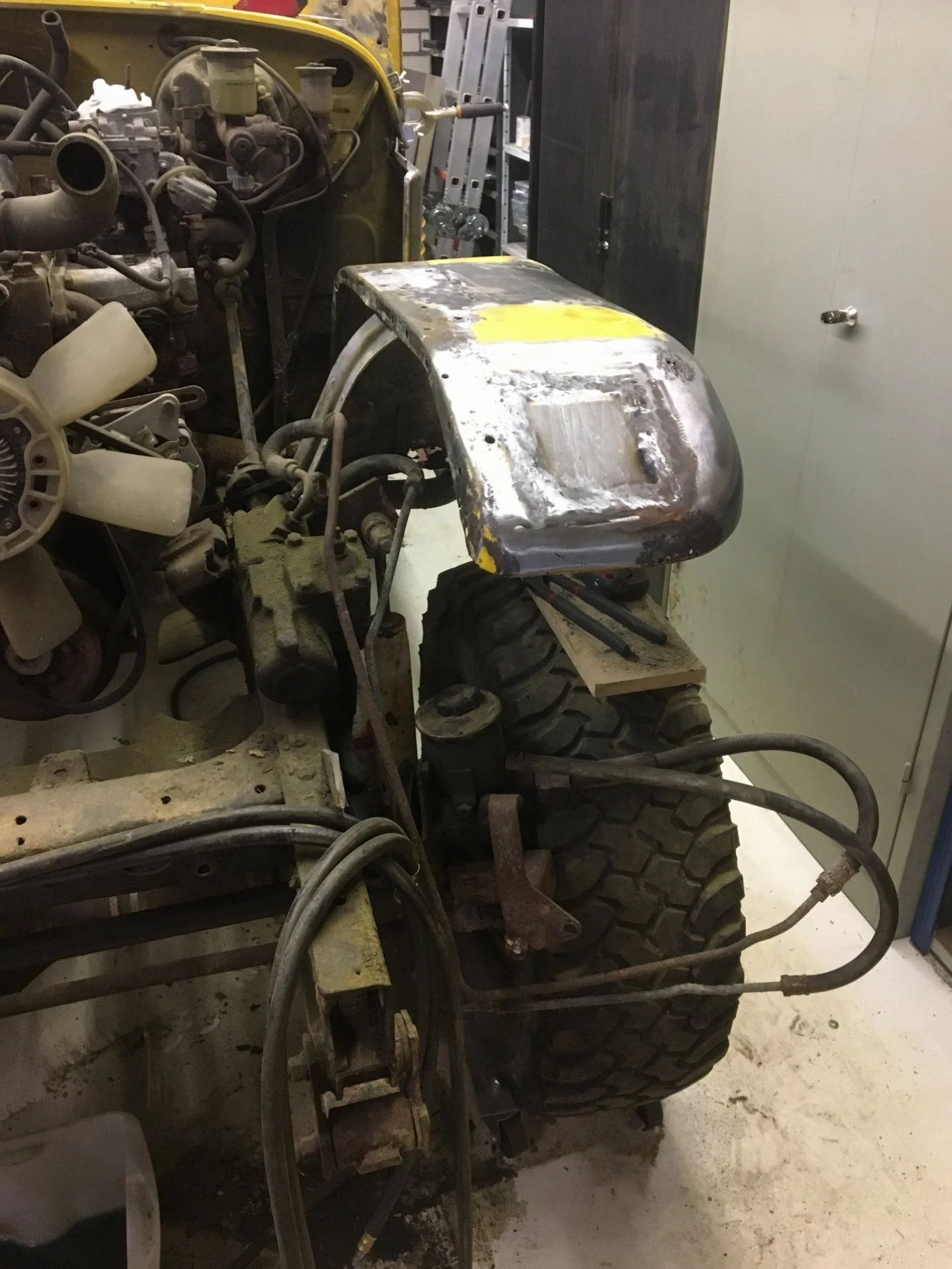

To know everything fits I needed the fender in position.

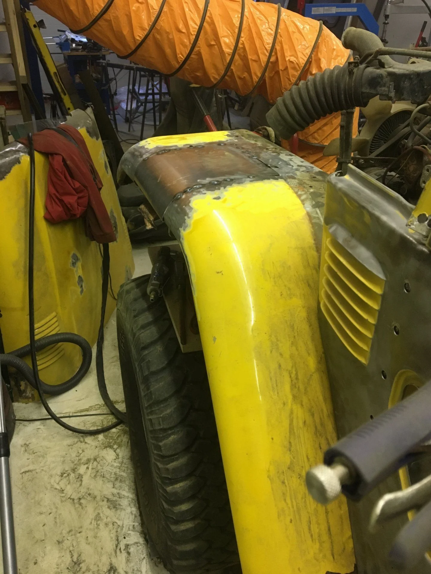

Started taking it appart earlyer and got some of the dents out.
Went a little further this time, looks like it can be saved.

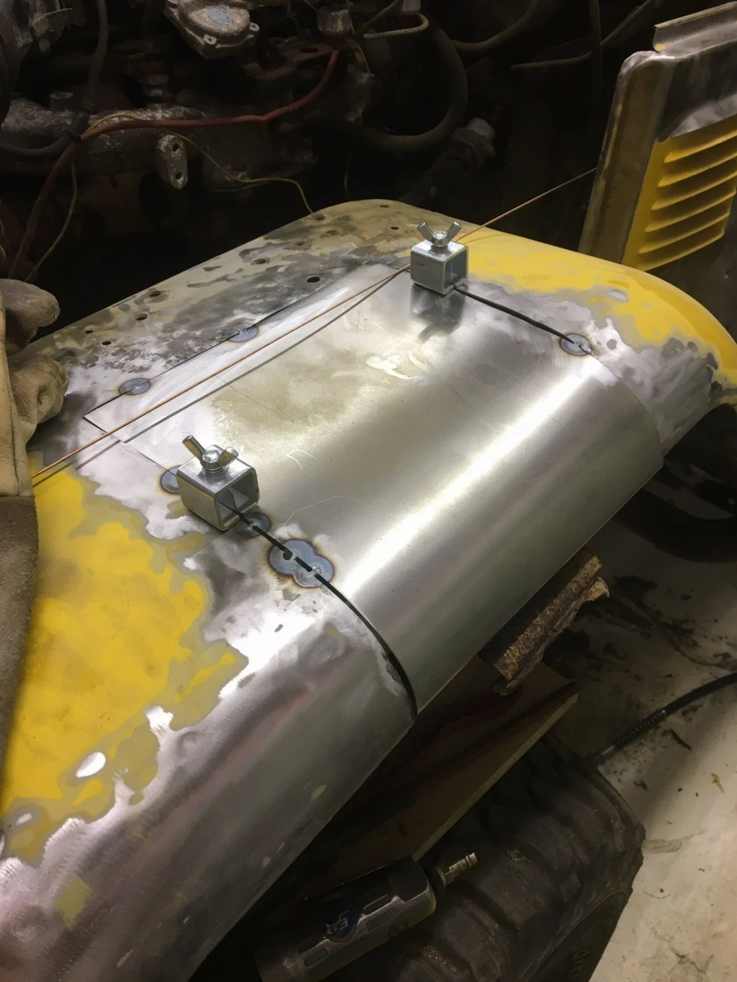

After some hammering, cutting, grinding and bending........
The shape is just a bend for the bottum and then hand forming until it is close enough.
It actualy starts to look like a fender again.

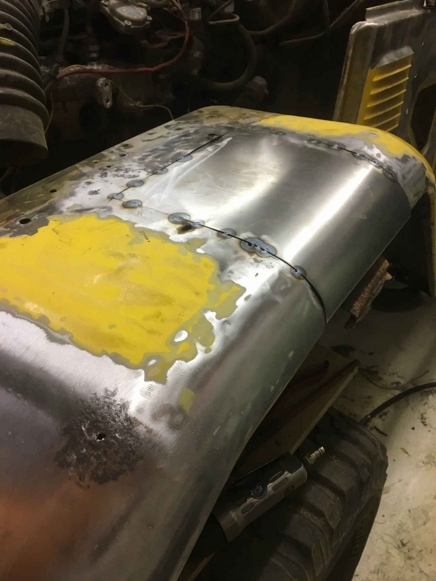

Just curious, are you using weld through primer or something on the seams b4 you weld them up?
With overlap steel yes.
I plan on brazing the seams to close it up.

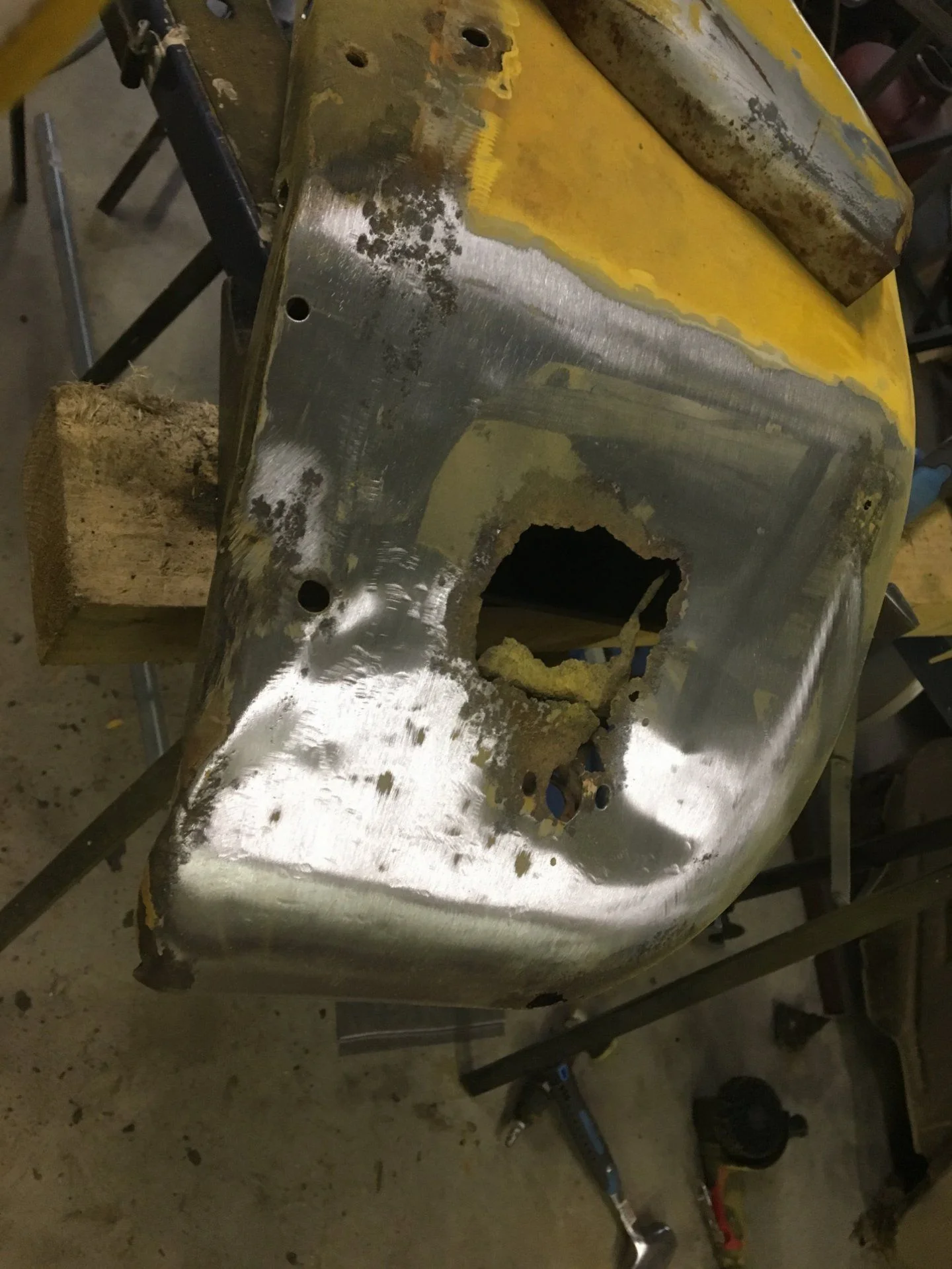

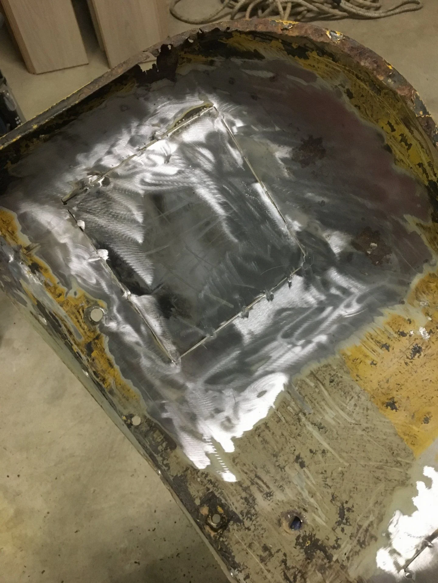

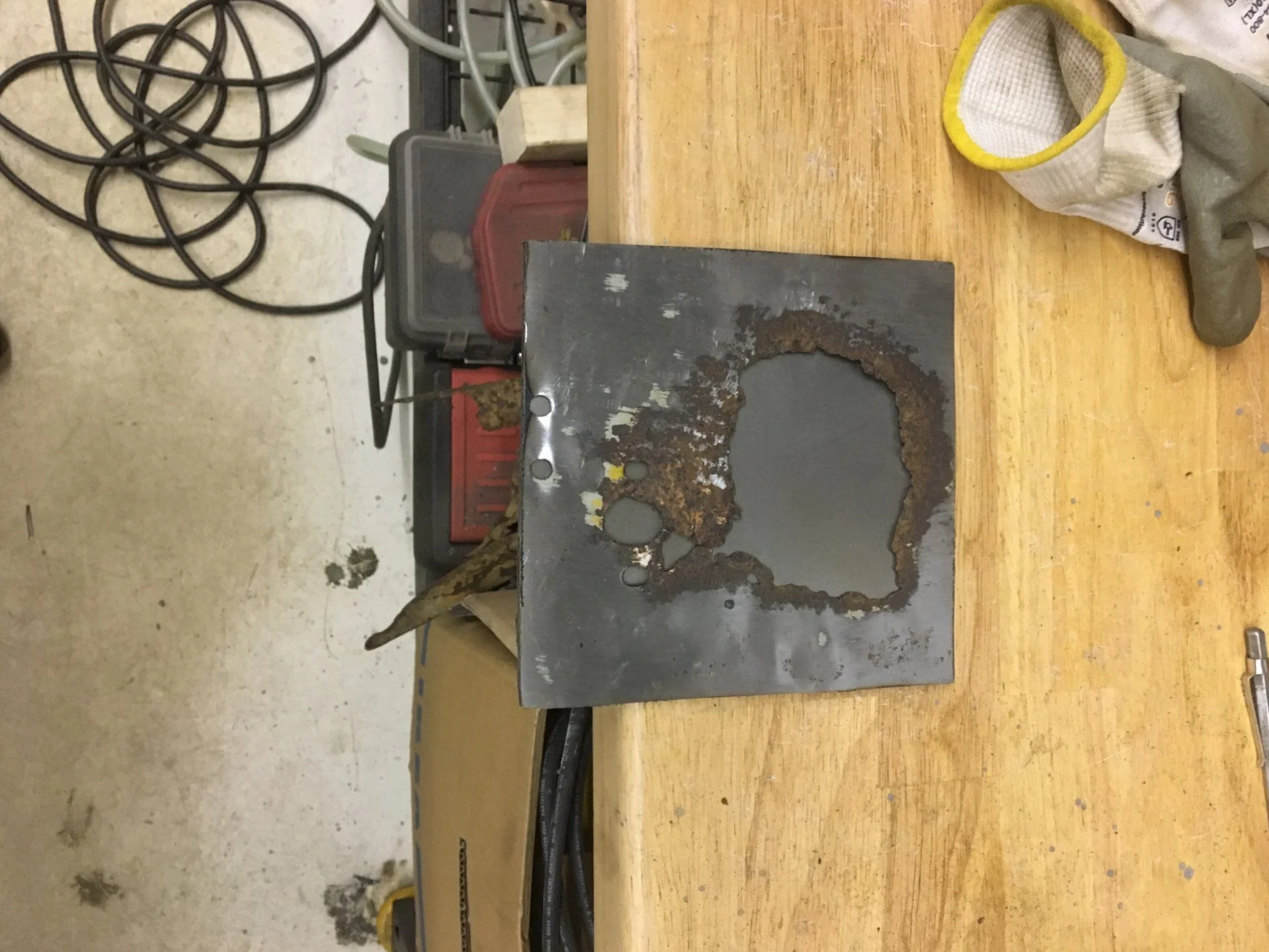

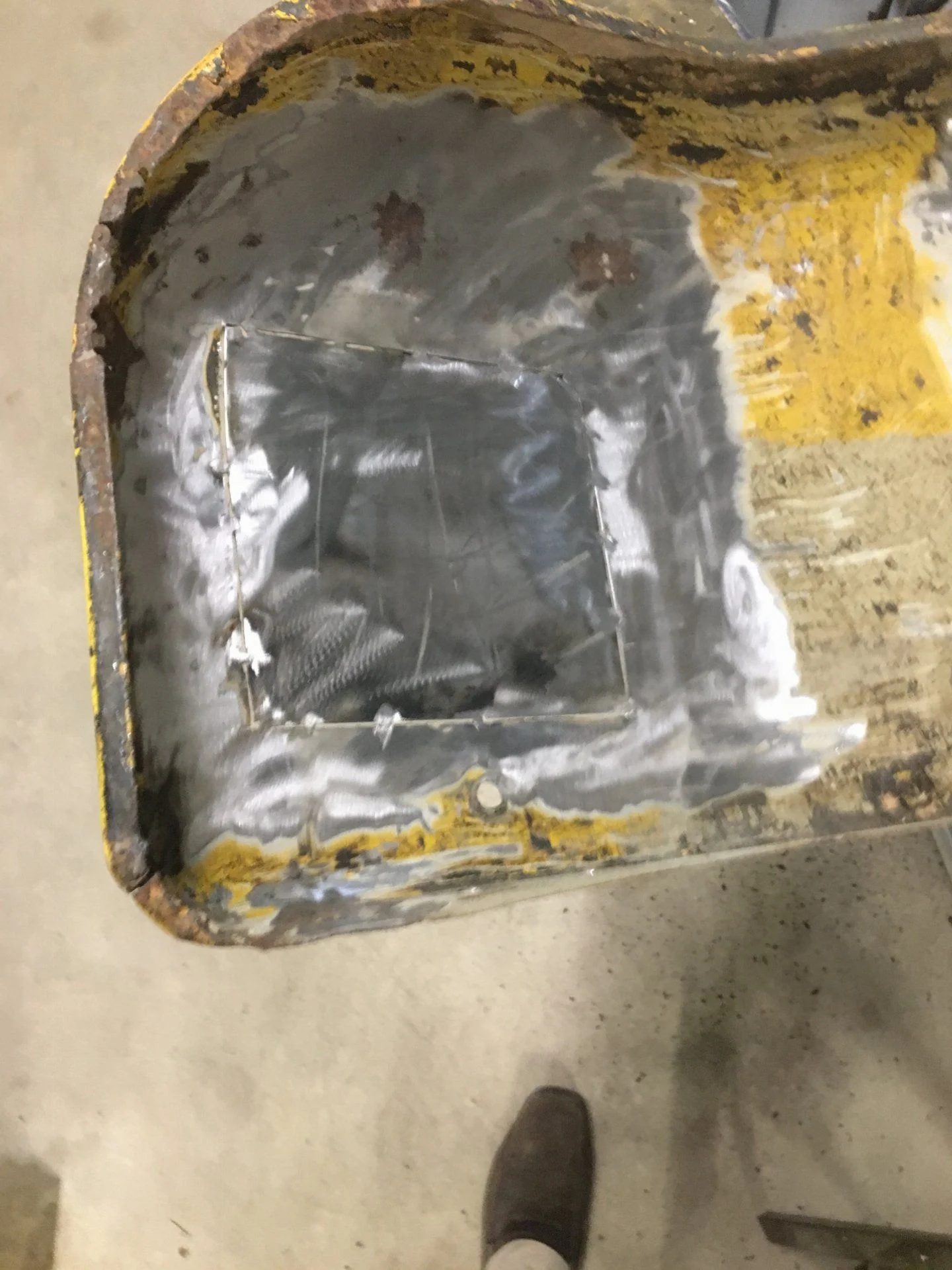

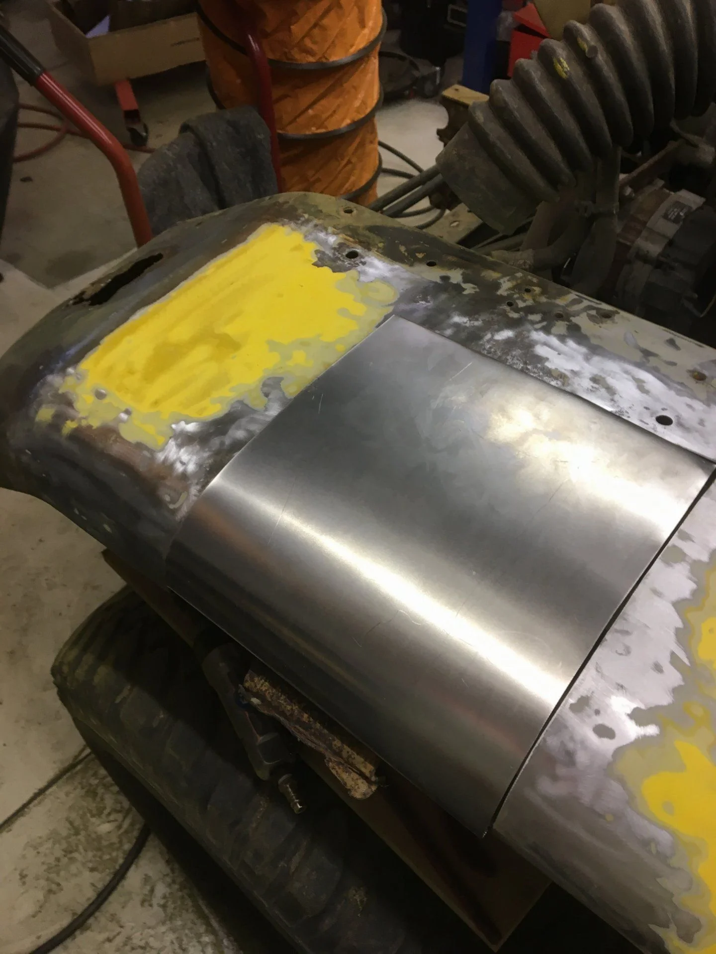

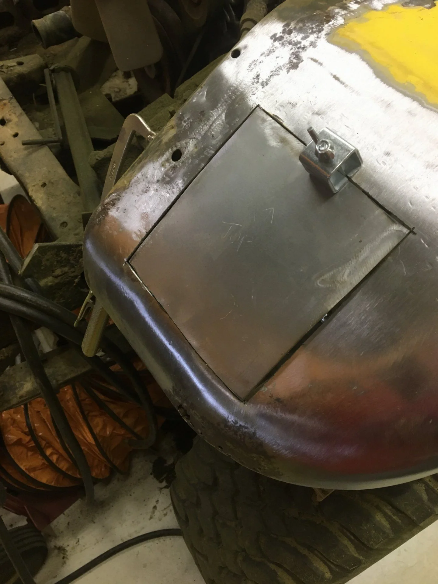

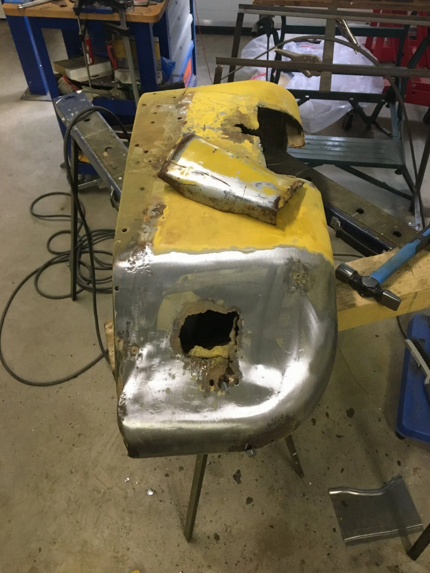

Front hole cut and patch made with old part as template.
Fits like a glove.
Tackt in place, didn't clean the underside.
Cleaned
Welded and roughly cleaned.

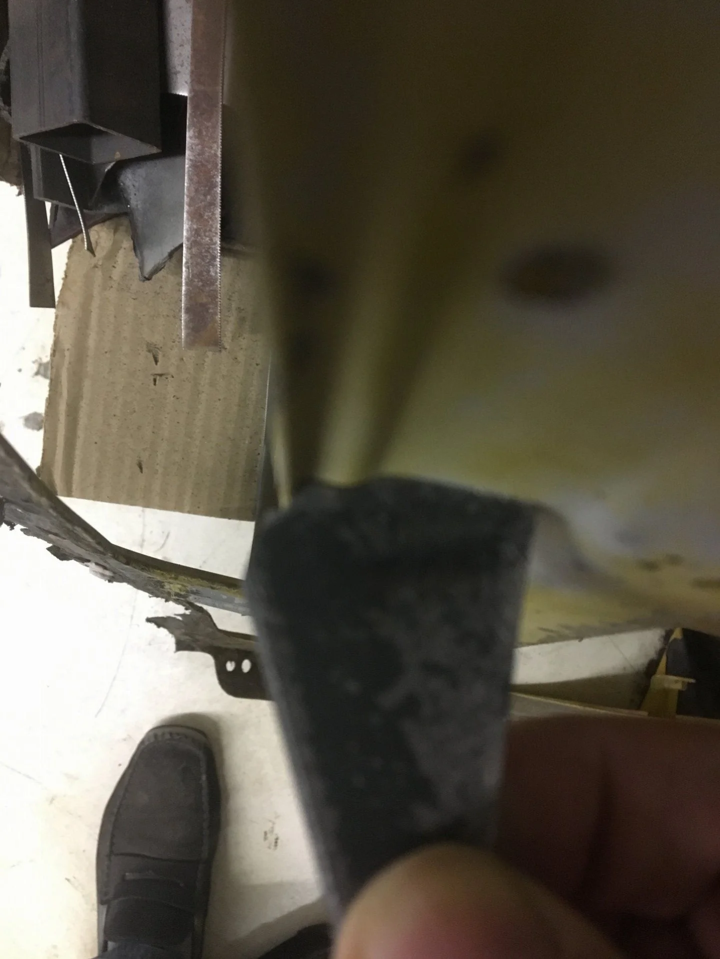

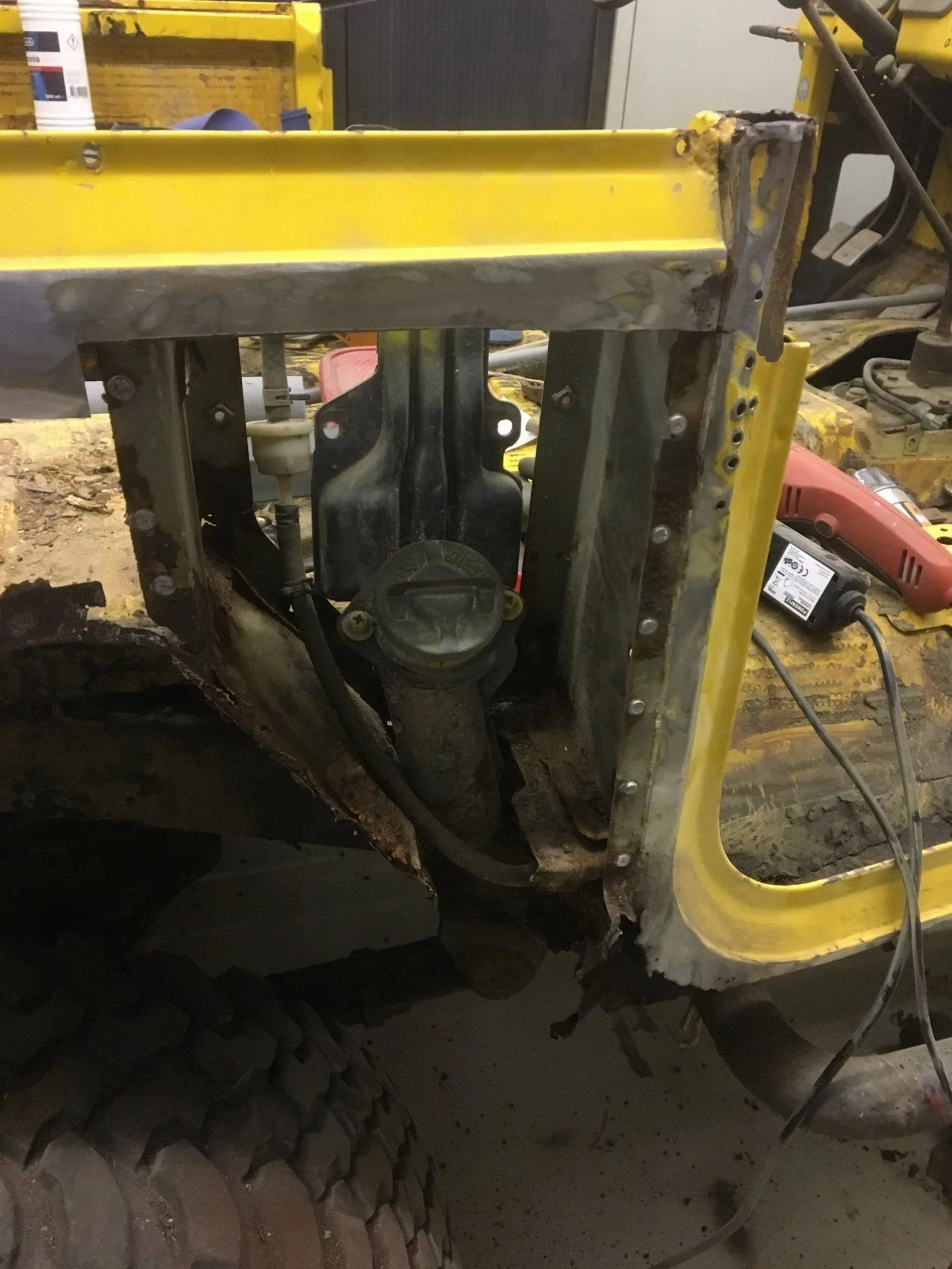

Inside fender drilled off the brace, there was no corrosion on the inside fender, the brace had only minor corrosion.

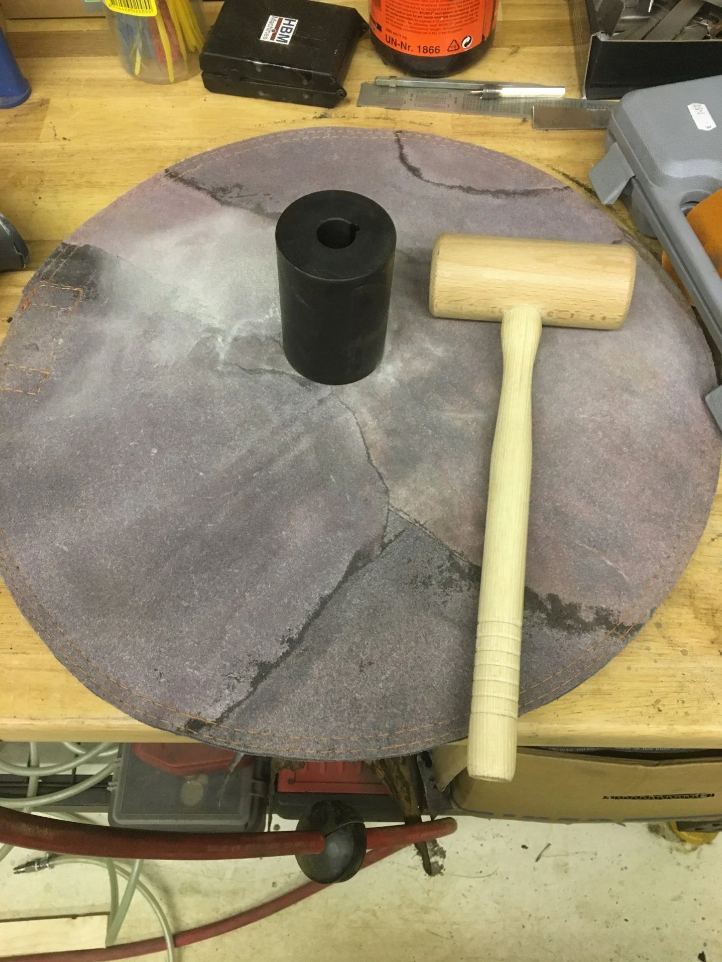

Creating a shape,
Turning it into this.
And the opposite side.

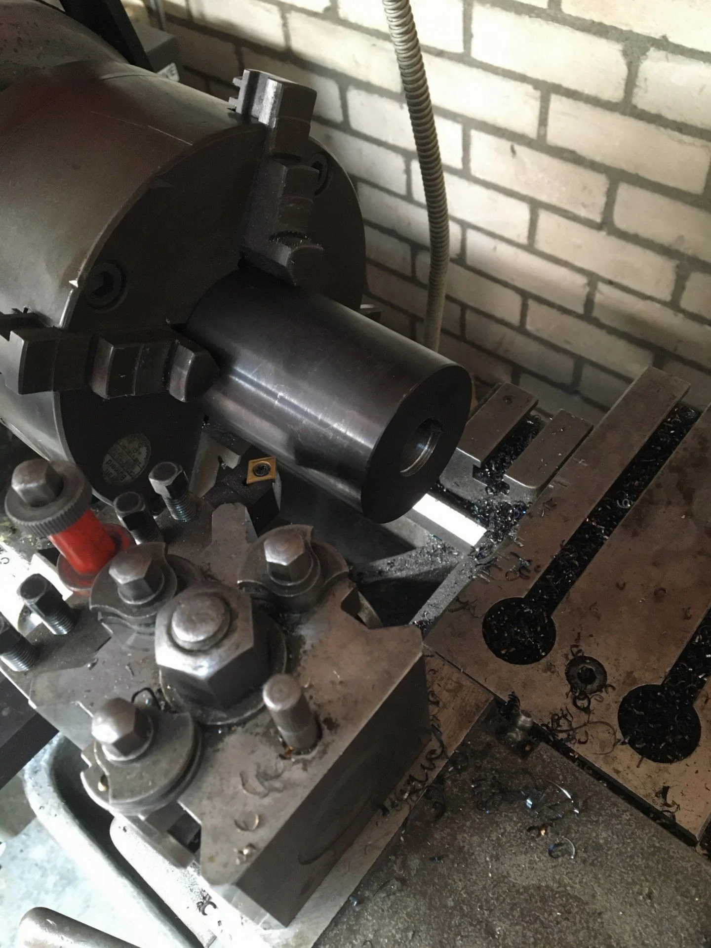

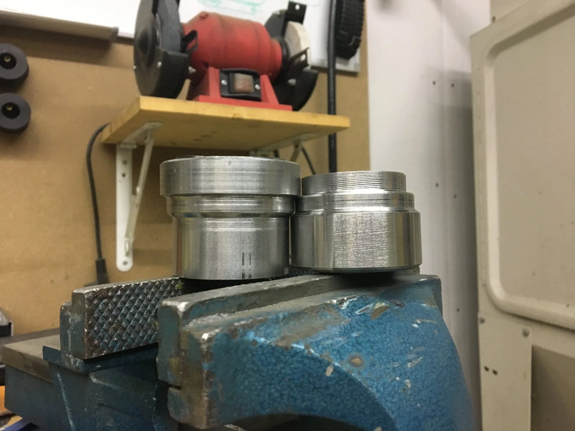

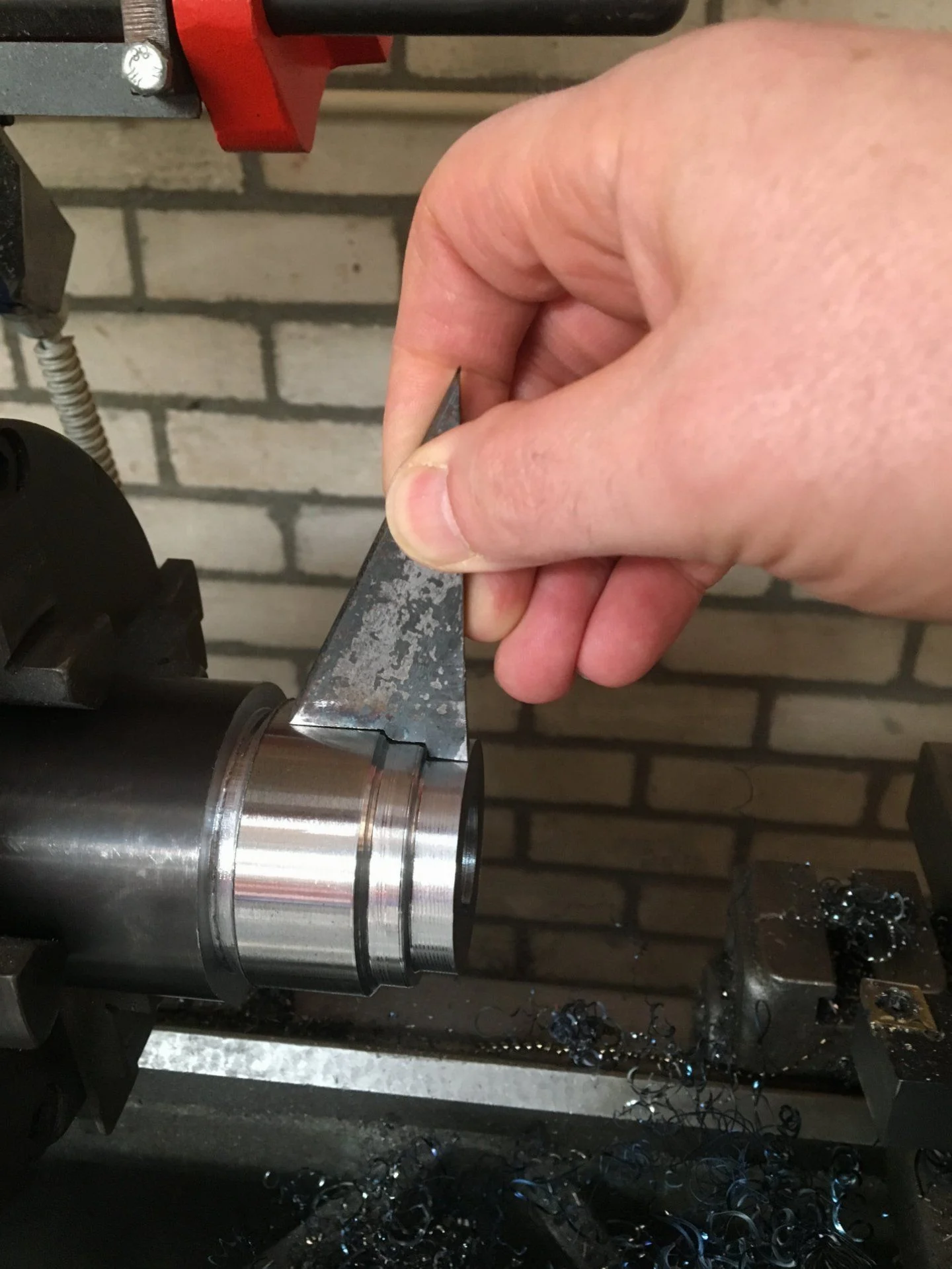

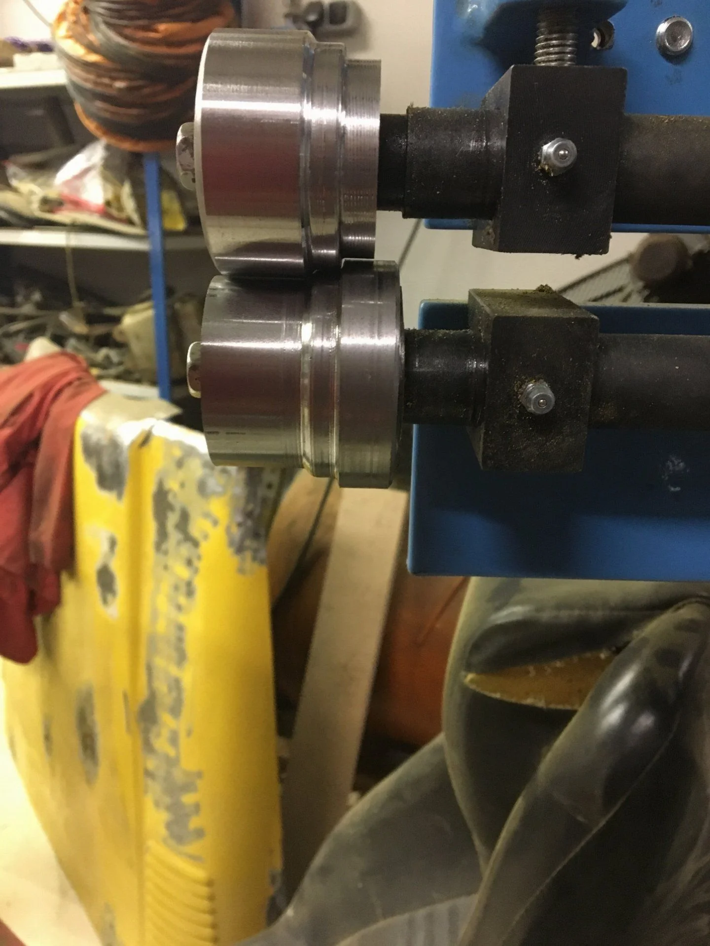

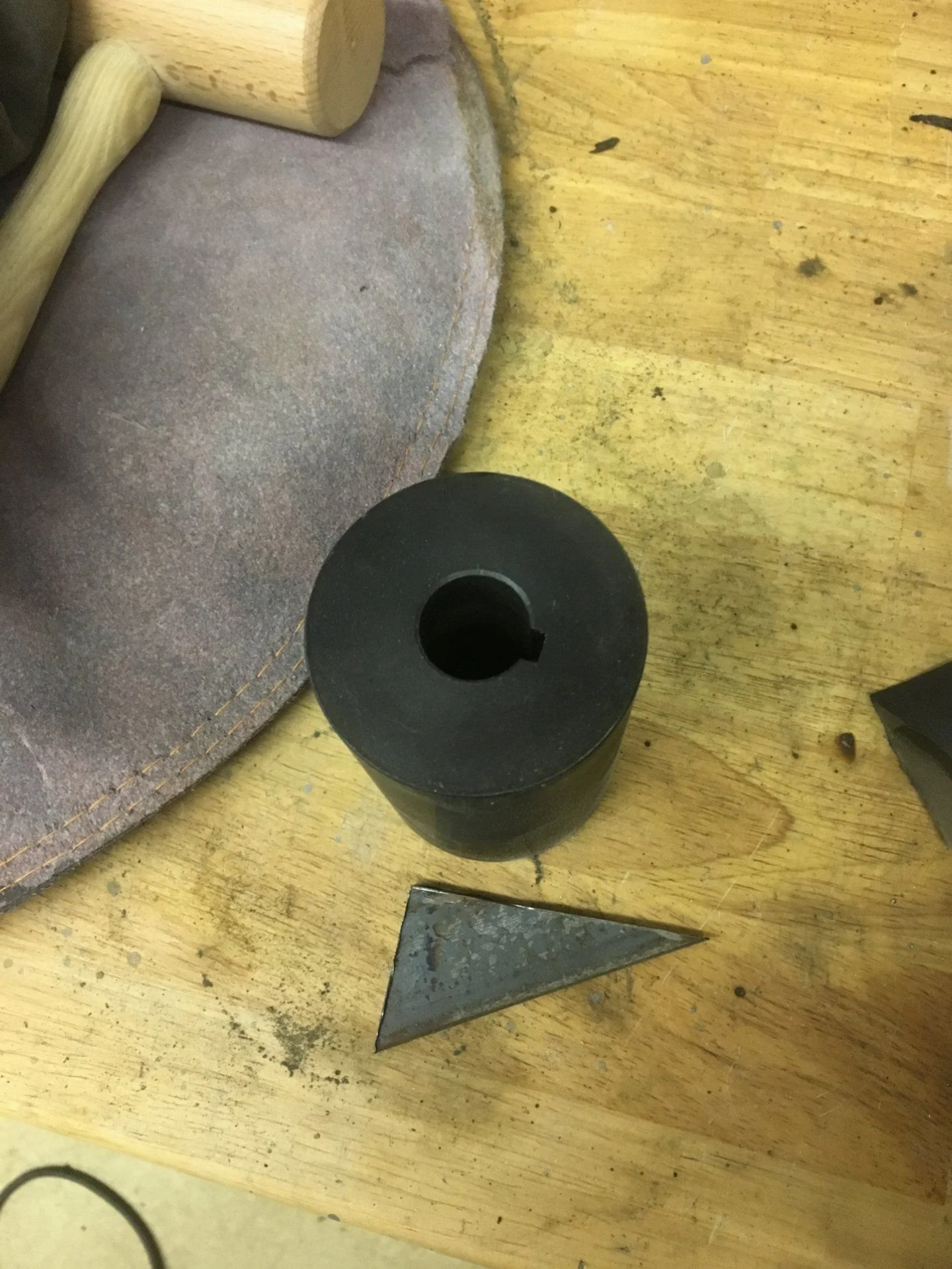

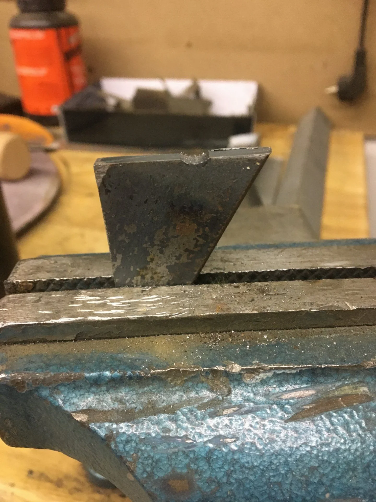

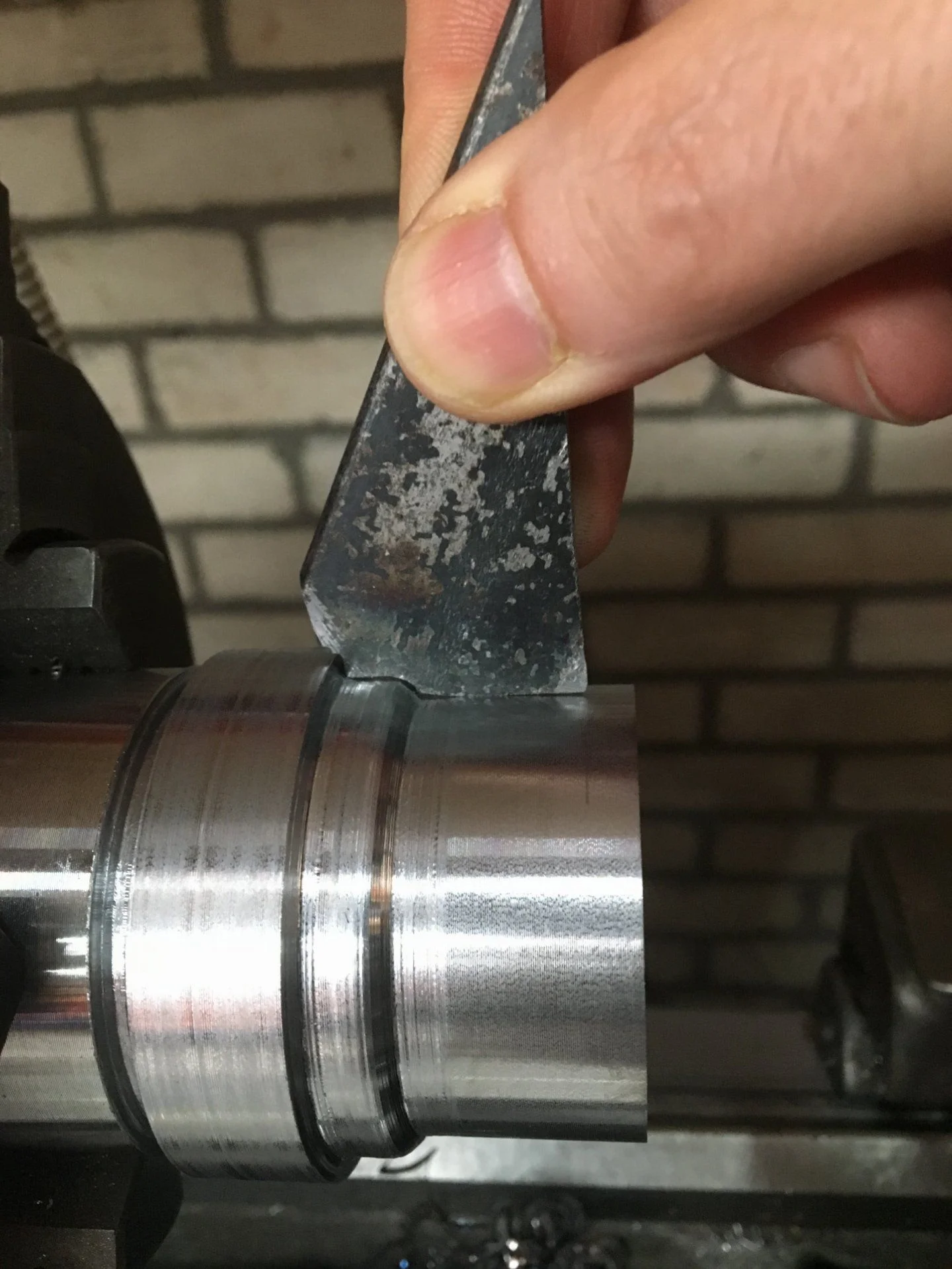

I'm using these as a template for the rollers.
I will shape them in the lathe at work if I can find the time this week.
They are to create the edge on the lower part of the bib that I need to replace.

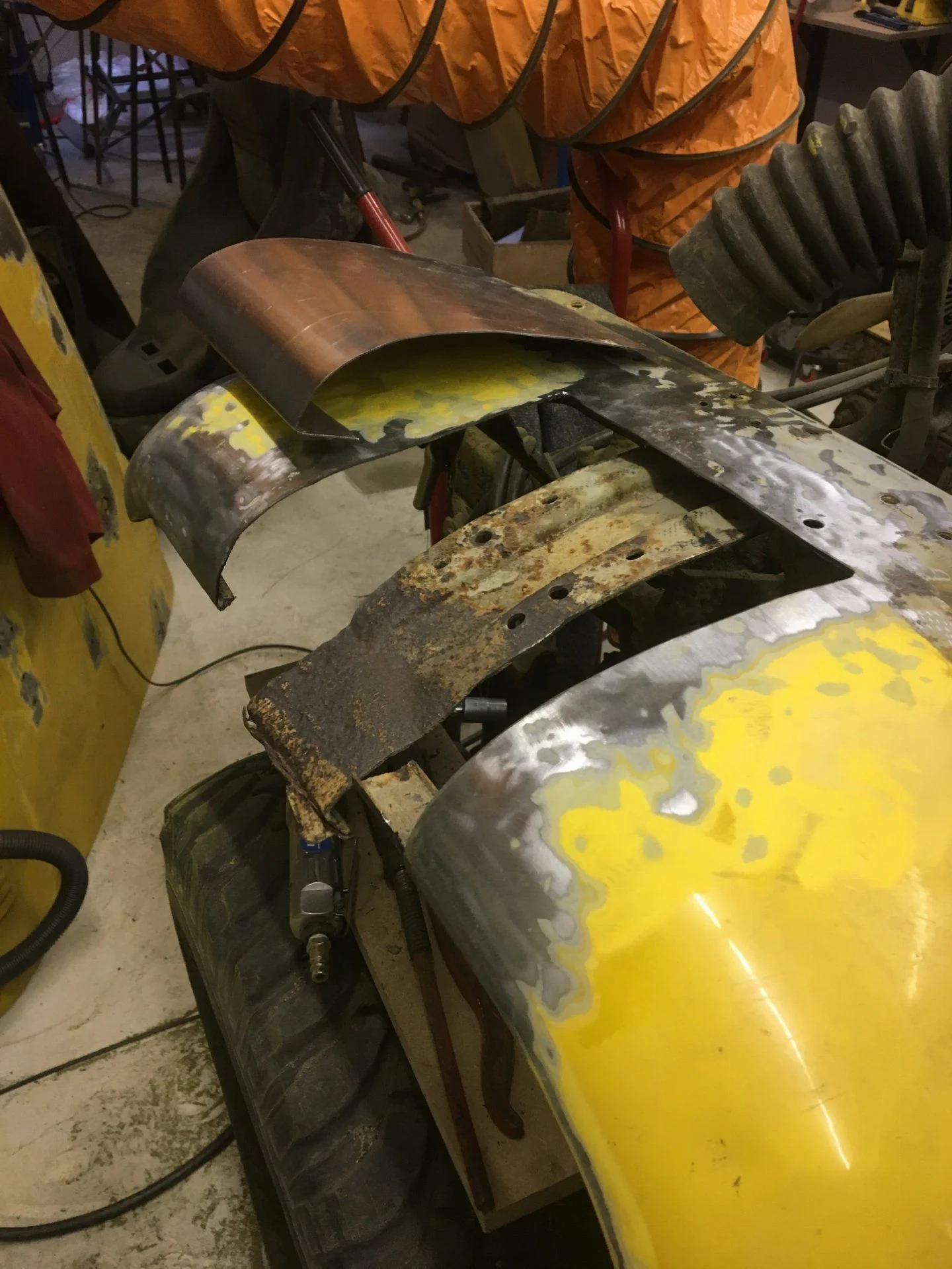

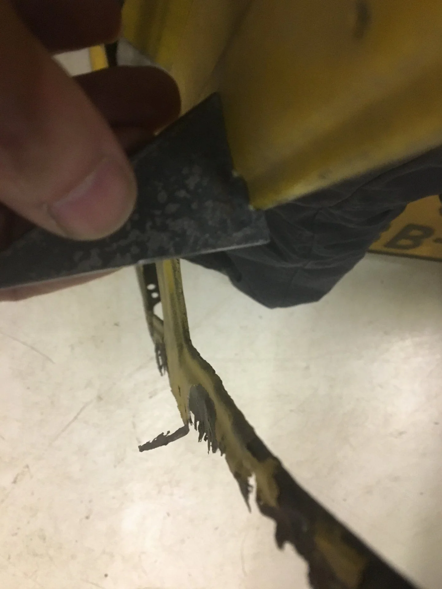

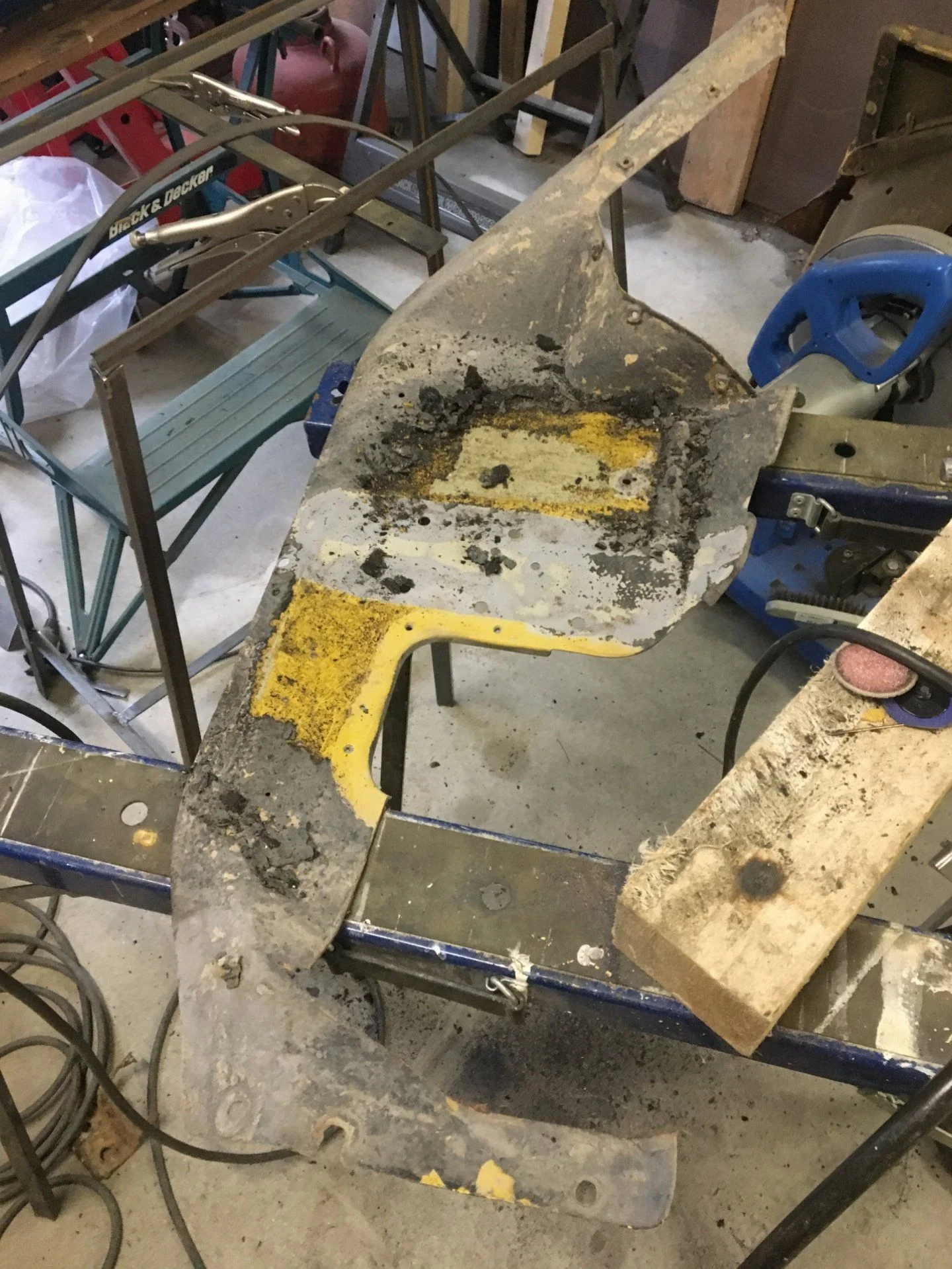

Cutting away all the bad.

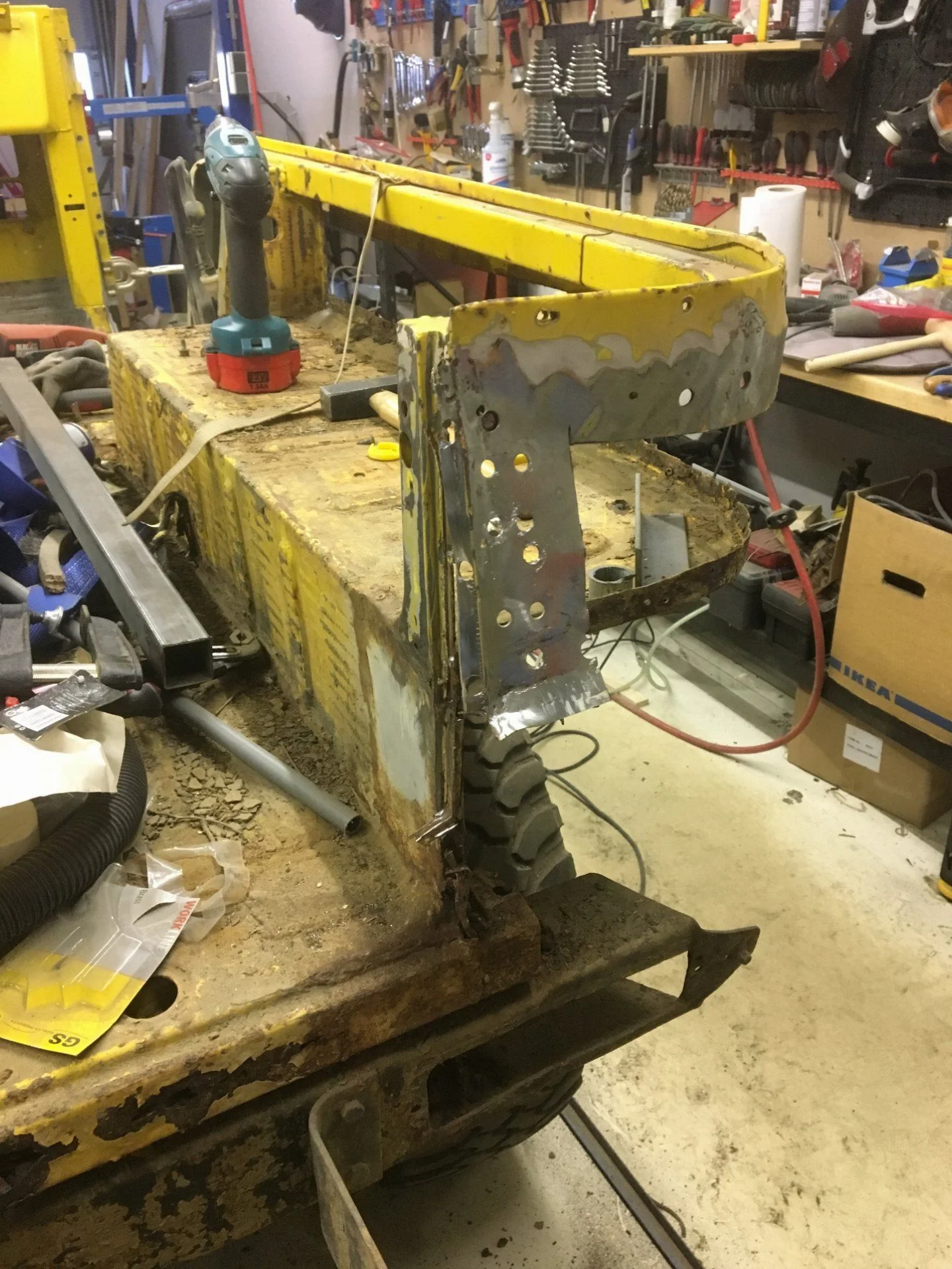

I'm going to cut just below the curve and remove the top of the rear fender.

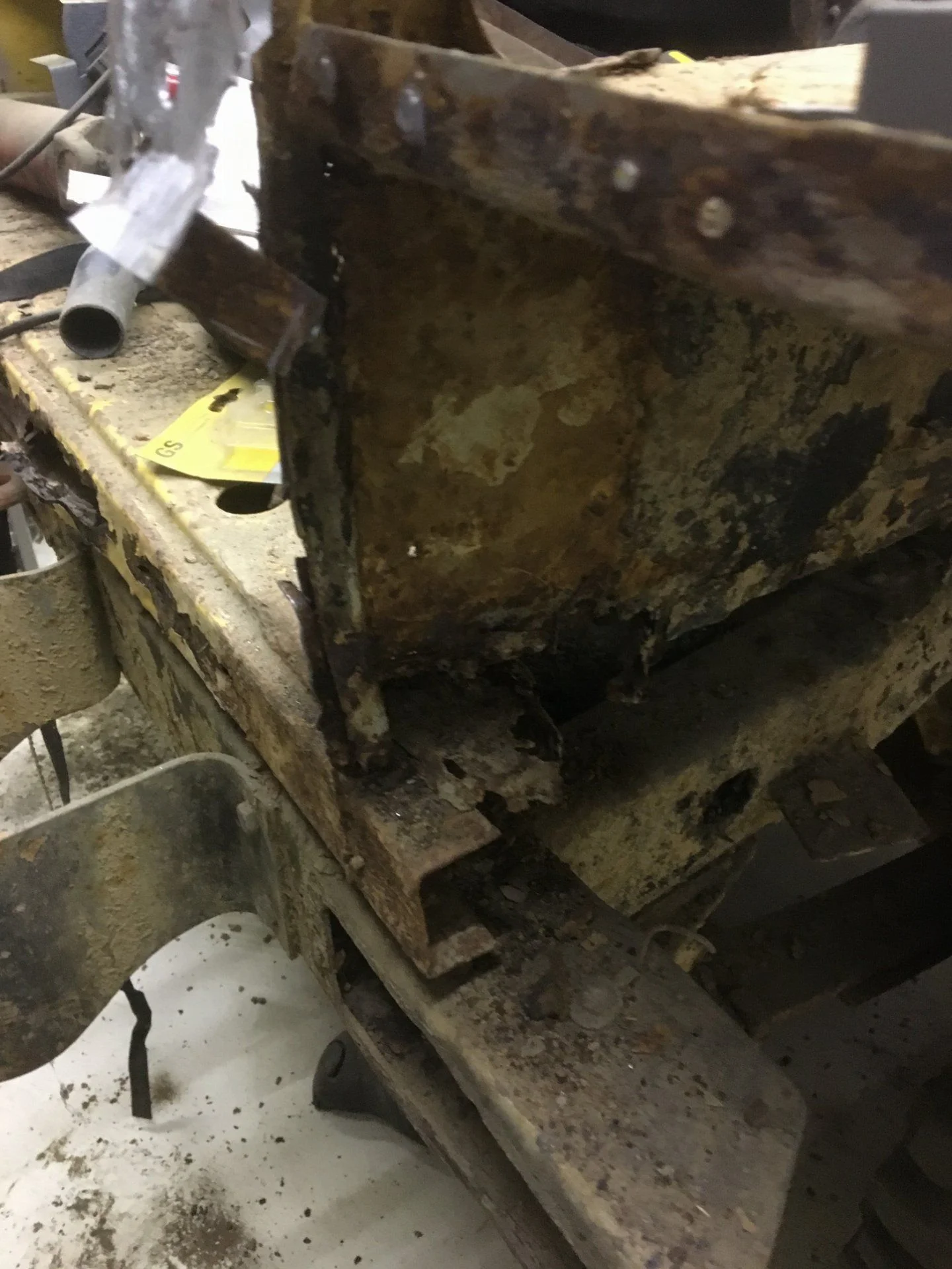

The rear has ro be replaced, the inside rail is bend from the crash and needs to be straitened.
Rear sill is gone.
I would like to see how this section should look.
If anyone has pictures of this without the fender in place please post it.

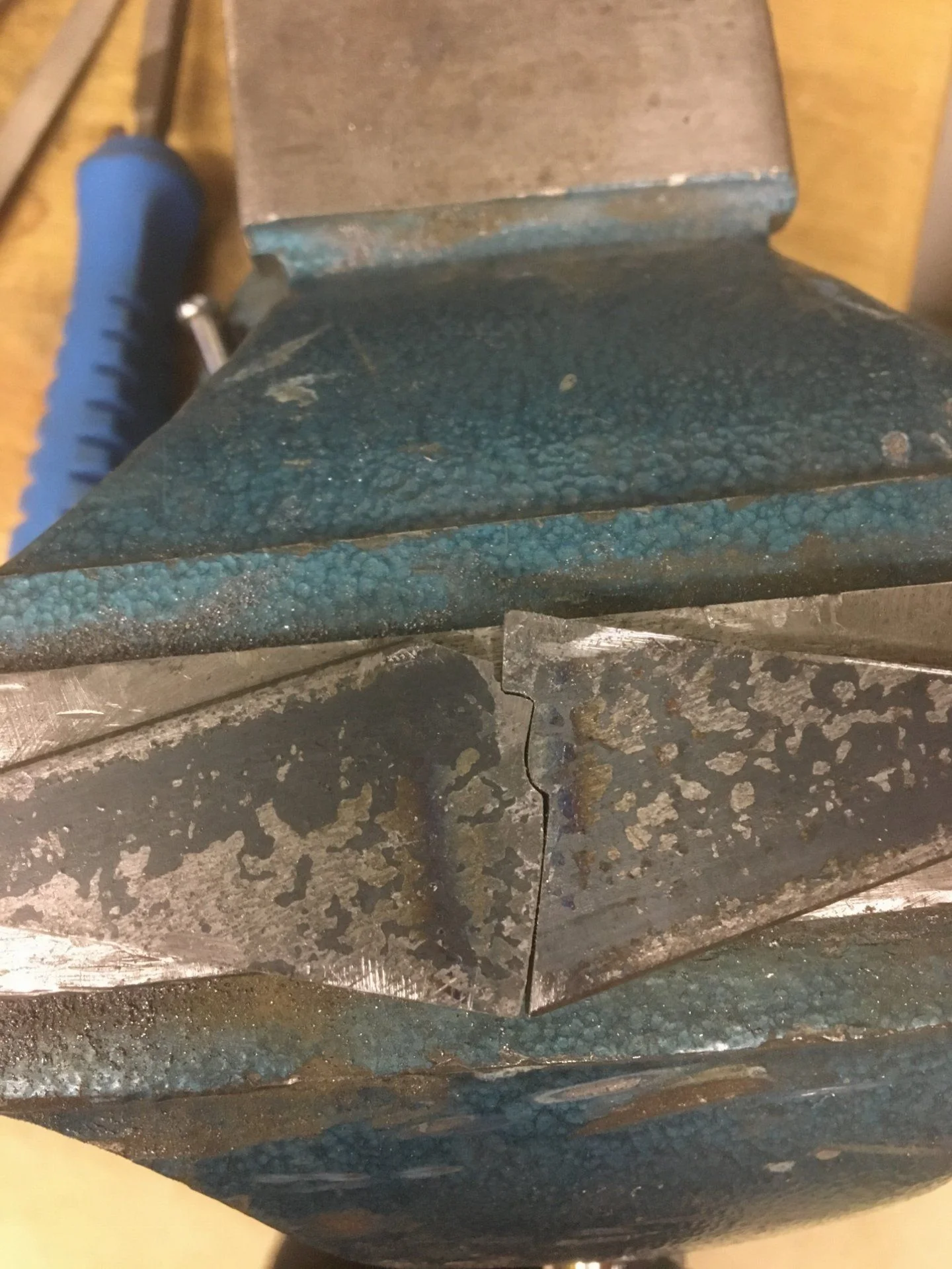

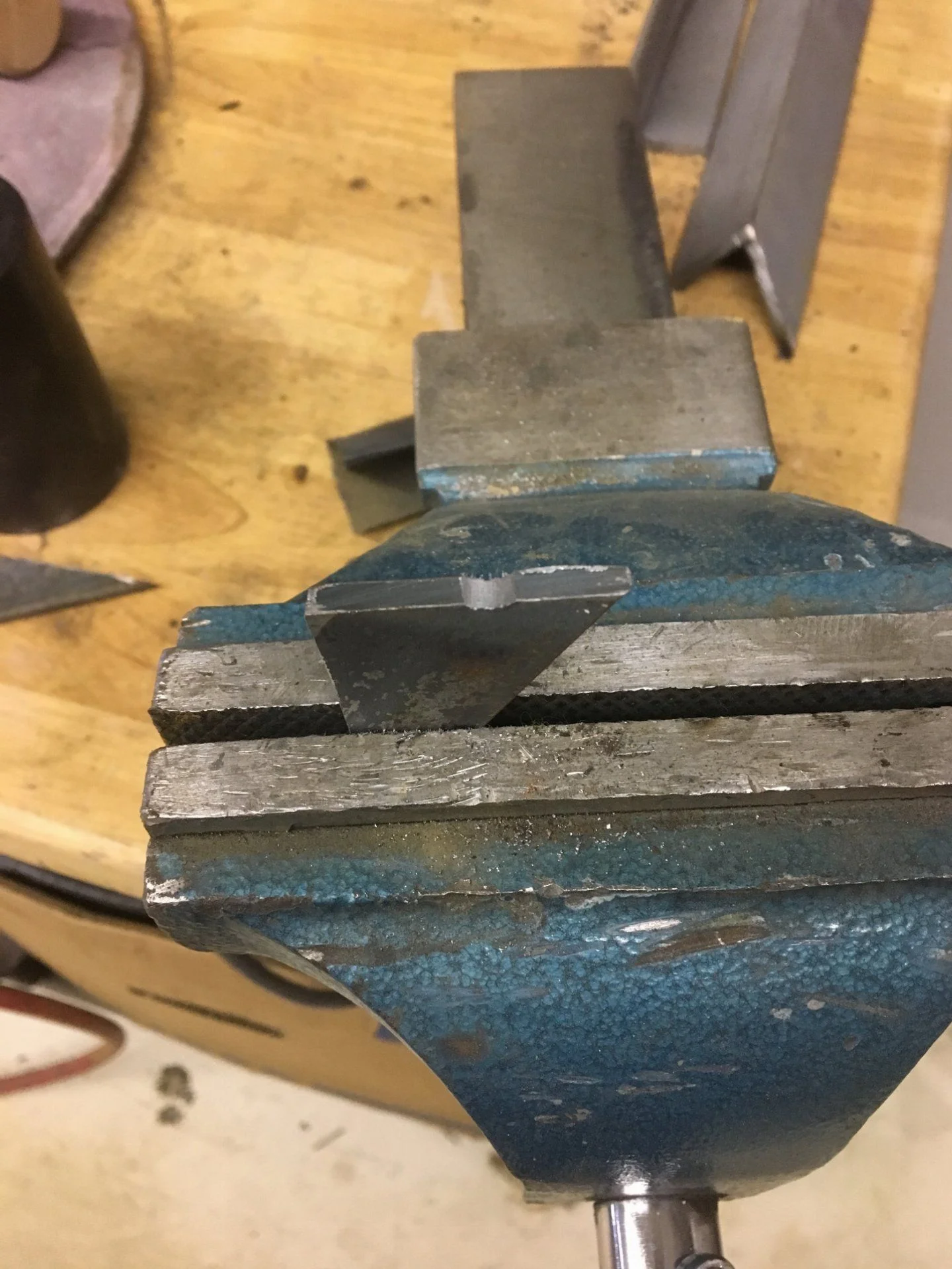

Took it to work
One side turned down,
And the other side.
Cut in two
I will try to finish the tomorrow
